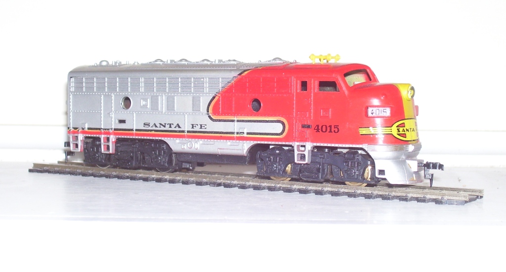

I just ran some trains today for the first time in a while. I decided to get a plastic motored MU2 SF F9 and run it. It was one of my earlier wins from the Internet and it never ran very well but was a nice looking example. When I cleaned it up I made sure the nonpowered wheels were very clean and did that improve the performance. I would say that it ran alot like a regular MU2 powered Mantua Tyco.
It occured to me that I don't see many of these at auction. Also that these might be a good way to repower old Power Torques. If using to repower an Alco you'd have to deal with the sideframes since they used the Blomberg truck. Also when were they made in relationship to the power torques? I'm thinking they came out around '74-'75 according to the catalog. Btw they were produced in Austria.

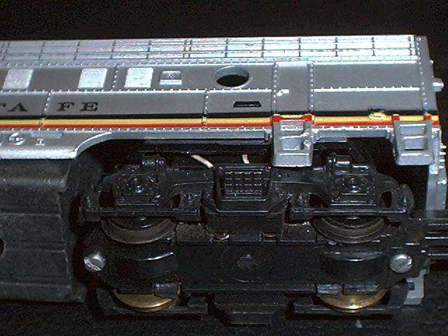

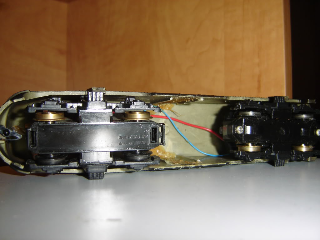

 Posted - January 08 2010 :  3:36:50 PM Link directly to this reply  Show Profile  Add Alco Fan to Buddylist
Here you can see the Plastic MU2 style motor and that it uses the same truck bogey as the PTs. I haven't tried to fit it into an Alco 430 since this is the only Plastic MU2 I have. I believe there is a better picture in the Tyco Collectors Resource Site.

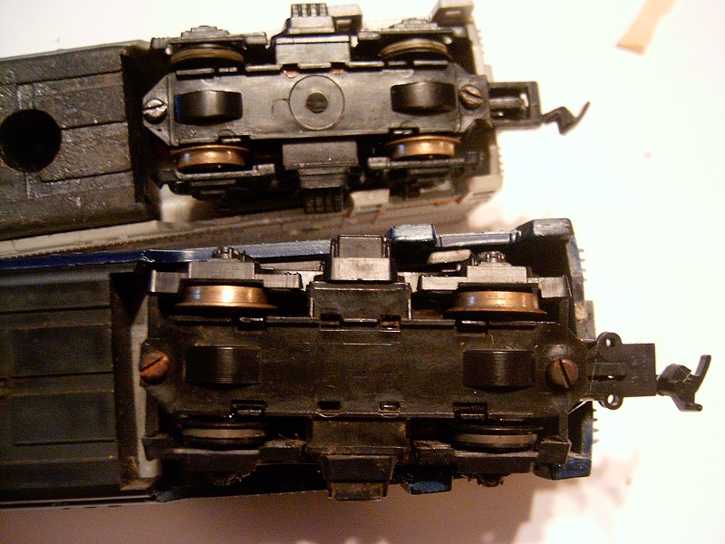

 Posted - January 09 2010 :  11:33:32 AM Link directly to this reply  Show Profile  Add Ray Marinaccio to Buddylist
I posted photos of this in another thread that discussed this topic.

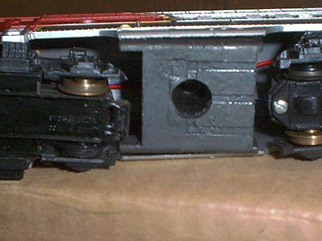

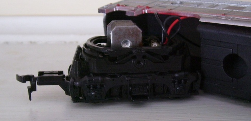

The shells and weights of the Austrian and Hong Kong MU-? F9s look the same. But the drives have minor differences and most parts DO NOT interchange.
These are the Hong Kong trucks.
These are the Austrian trucks.
Ray
 Posted - January 09 2010 :  1:04:46 PM Link directly to this reply  Show Profile  Add Alco Fan to Buddylist
They do look the same. Thanks for the pictures.

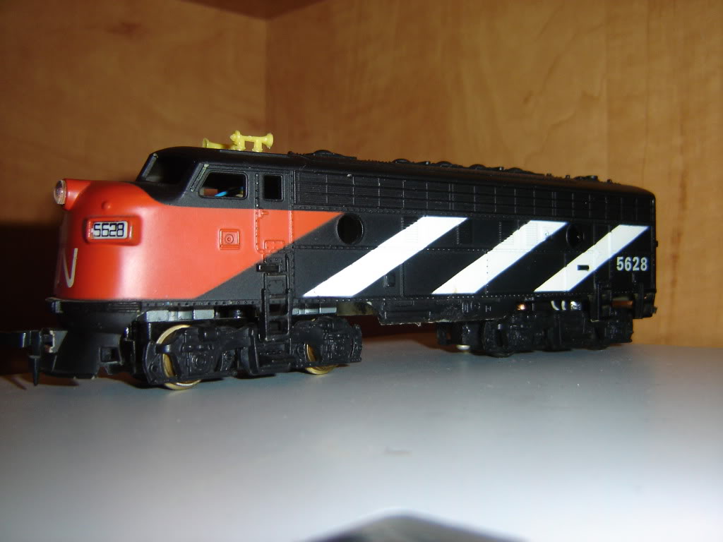

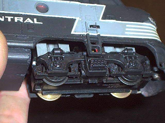

Originally posted by Alco Fan-January 09 2010: 1:04:46 PM
Look a little closer at the side frames. Particularly the journal boxes. Where they mount to the bottom cover are different so the side frames do not interchange.
I believe you can put these drives in a Power Torque shell without modification.
Yea, the NYC is a costom paint job. Thanks.
The tank on that shell is home made (carved from a block of wood) and the shell was modified to mount it. The plastic post on top of the shell that holds the original weight broke off.

 Posted - January 09 2010 :  7:07:15 PM Link directly to this reply  Show Profile  Click to see DaCheez's MSN Messenger address  Add DaCheez to Buddylist
Would you post some pics of your CN?
Here's one of them...I'm pretty sure there's a second one hiding somewhere. Both are in need of some repairs.

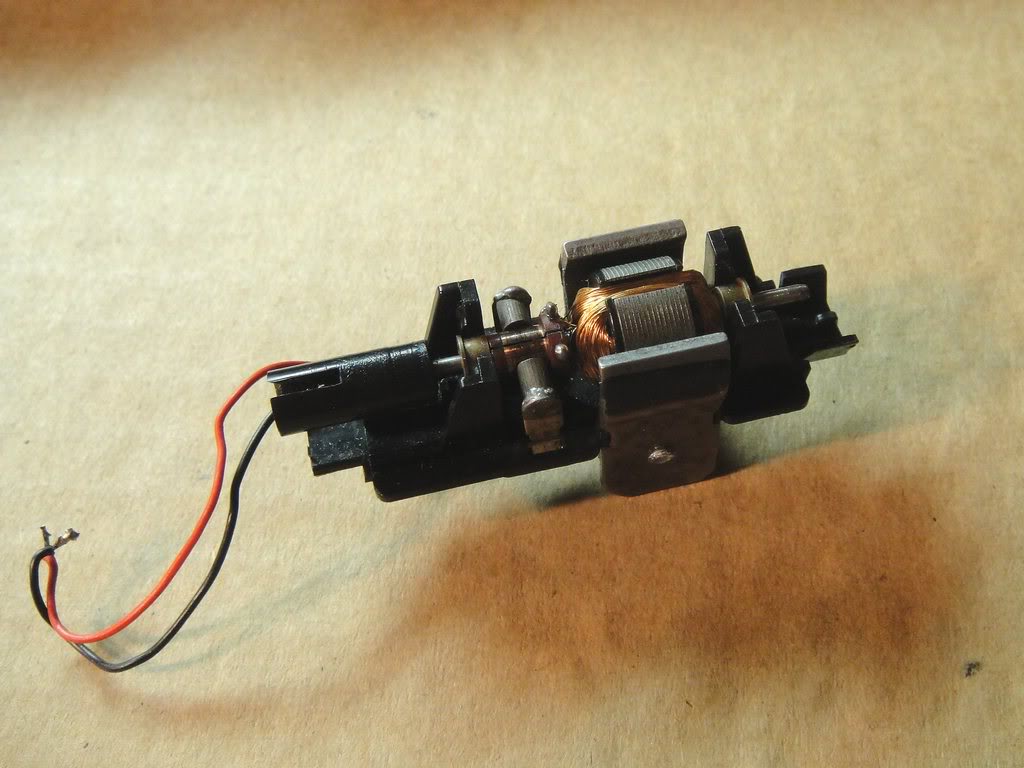

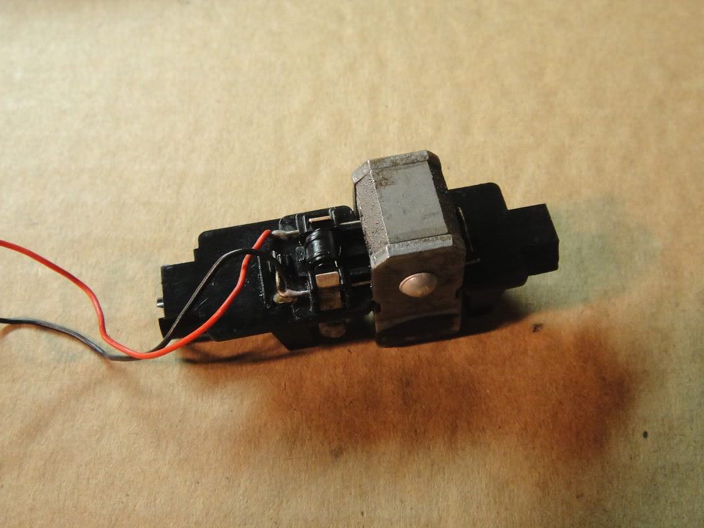

 Posted - January 12 2010 :  7:55:20 PM Link directly to this reply  Show Profile  Add NickelPlate759 to Buddylist
Curious to find an AHM C424 with one of these drives in there. Tyco must have known it was crap if they licensed it away!
Originally posted by GoingInCirclez-January 09 2010: 11:36:07 PM
Tony, I didn't mean to imply that the AHM Century had a plastic MU-2 truck. It had this MU-2 style motor that snapped into the center of the chassis, powering the front truck.
They ran pretty well, but were very noisy. I replaced this with a can motor and flywheel.

 Posted - January 12 2010 :  10:19:27 PM Link directly to this reply  Show Profile  Add Alco Fan to Buddylist
Nelson,
I see the PMU2 and the AHM MU2 type motor are similar. The AHM is mounted upside down compared to our MUs.
I also think the PMU2 I have is quieter than the MU2 in my Prez Seal Alco So'76 and it seems to perform good pulling the same load.

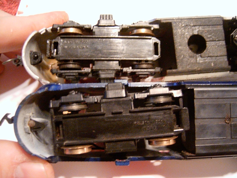

 Posted - January 24 2010 :  8:12:53 PM Link directly to this reply  Show Profile  Add burlington77 to Buddylist
Here are the two locos I have. Sorry it took so long to get pics. Neither loco is in great shape, they're both things I "salvaged" so to speak:
Santa Fe and Spirit of 76 (the sticker was ruined):
The rear trucks. Santa Fe on top and So76 on bottom. The So76 had a broken coupler pocket, so for a quick fix I glued on a Kadee gearbox with an Athearn coupler. Don't judge me.
The front trucks. Hong Kong on top, Austria below.
That's about it. The Santa Fe runs fair, but the So76 has serious issues. I'm surprised it runs at all given how rusty the motor was.
 Posted - January 25 2010 :  9:01:13 PM Link directly to this reply  Show Profile  Add Alco Fan to Buddylist
Thanks for the reply Burlington77. Interesting your SF is Hong Kong and mine is Austria.

 Posted - January 26 2010 :  12:30:48 AM Link directly to this reply  Show Profile  Add burlington77 to Buddylist
It seems to be original, but of course I can't make any claims since I got it in a lot on ebay. It was really just an afterthought, because it came with some Athearns that I wanted.
 Posted - January 26 2010 :  5:22:18 PM Link directly to this reply  Show Profile  Add Alco Fan to Buddylist
Burlington77,
I'll bet it is original just as you found it. It makes me wonder why Tyco would have the same roads built buy 2 manufactures in different places. If one collects Tyco then that gives you more to hunt.
