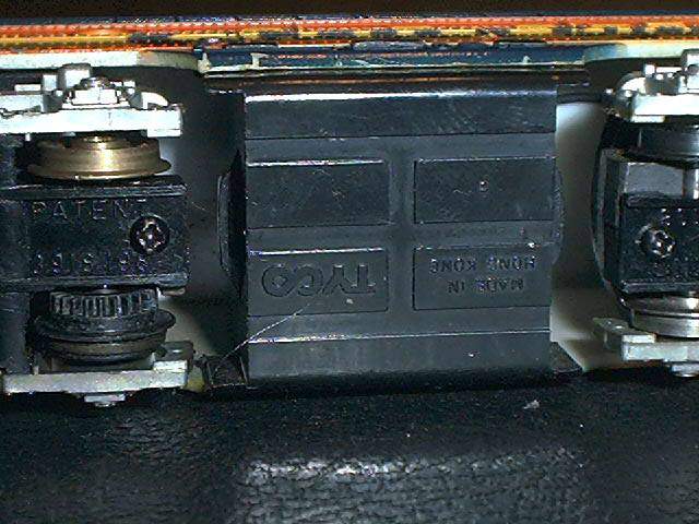

 Posted - February 19 2006 :  02:03:33 AM Link directly to this reply  Show Profile  Add Ray Marinaccio to Buddylist

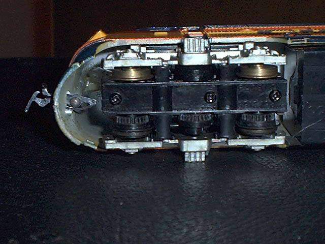

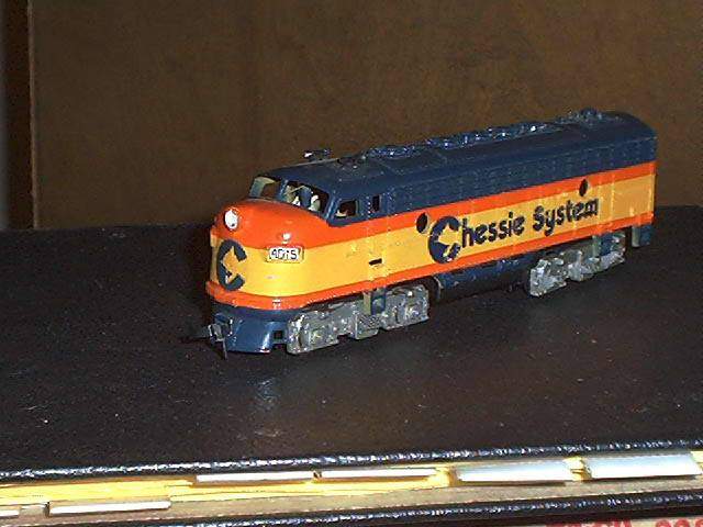

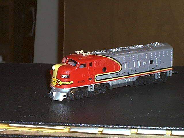

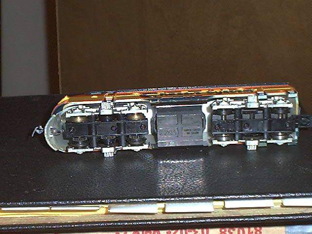

Now that we figured out why I couldn't post the photos, here are some photos of some F units I have.
This would be a Mantua style sideframe.
It has a metal framed power truck.
This one has the tab mount to the shell on the trucks and fuel tank.
This one has the tab mount to the shell on the rear truck and fuel tank and screw mount on the front truck.[?]
Ray
Edited by - Ray Marinaccio on February 19 2006 02:34:47 AM
Ray Marinaccio
RayAvatar
 Posted - February 19 2006 :  02:21:26 AM Link directly to this reply  Show Profile  Add Ray Marinaccio to Buddylist
This is a Hong Kong version with plastic framed worm drive trucks.
The fuel tank and weight are a solid casting held on by one screw. The origin of manufacturer is on the front truck.
Note the shell changes. Steps, grill, # boards, larger side windows and railings on the cab roof.
Ray
Edited by - Ray Marinaccio on February 19 2006 03:03:42 AM
Ray Marinaccio
RayAvatar
 Posted - February 19 2006 :  02:48:12 AM Link directly to this reply  Show Profile  Add Ray Marinaccio to Buddylist
From what I see the Austrian version has the same shell and fuel tank as the Hong Kong version however the trucks look similar but are different.
Compare the side frames, the journals are the easiest difference to spot. The side frame mounting tabs are spaced different and some variations in the motor also.
This model was custom painted and as a home made fuel tank.
Ray

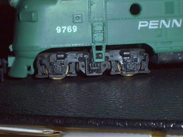

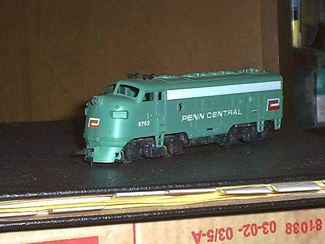

Ray Marinaccio
RayAvatar
 Posted - February 19 2006 :  03:00:00 AM Link directly to this reply  Show Profile  Add Ray Marinaccio to Buddylist
This is the Hong Kong version with the Power Torque motor.
The fuel tank seems to be the only other major change.
Ray
