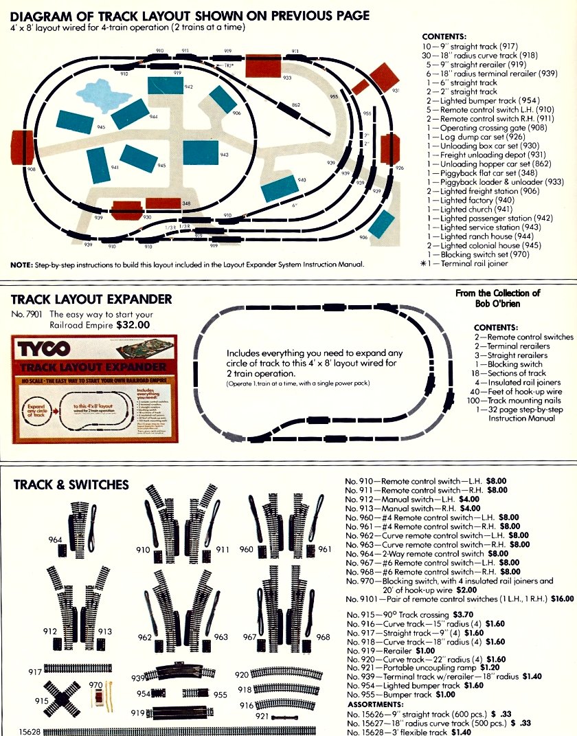

I remember seeing that during the brown box era, Tyco offered their Track Layout Expander for anyone who purchased a train set with just a circle or a 45x36" oval of track to wire it for two-train operation. But then there is the instruction manual describing their "railroad empire" that can be constructed via the Layout Expander System...
I wonder if anyone here has ever tried to construct that track plan of sorts? If you don't want to use Tyco track, Atlas Code-100 snap-track would also do the trick nicely.
The manual describes how to do it in stages, first assembling it as the track plan the Track Layout Expander makes out of an ordinary track circle, and then adding more track and accessories as you go on.

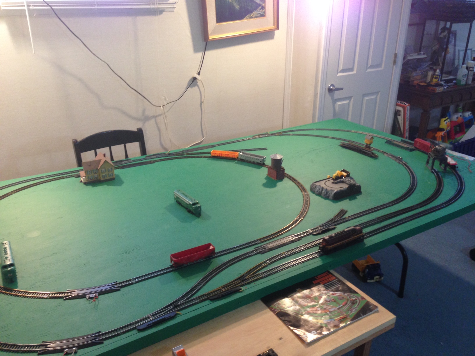

I was planning on doing this on my layout, but I discovered that Atlas True-Track can't really handle what Tyco had in mind. HOWEVER, the Layout Expander System manual showed a few "Other Suggested Track Layouts," and there was one track plan I figured I could do on my layout with a bit of modification...
That has since resulted in THIS:
Complete with blocking switch set, but done with terminal rail joiners instead of terminal track sections. Nonetheless it still looks very interesting, and does offer some expansion possibilities.

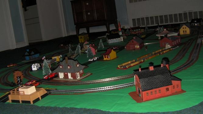

That is a very nice layout that you have there Wiley. It brings back to mind a lot of old memories for me. It features a lot of things I also have or have had in the past. Thanks for sharing it.
I have wanted to build the Railroad Empire layout since I was a youngster and I had first seen in back in the seventies. School, family, and job life has kept me from even attempting it. Well, the time has finally arrived with the last child about to leave the nest in another year. Although a large railroad pike is in the plans, I need something to play with sooner then a large pike will allow.
One day I ran across my copy of the Layout Expander System book and I knew that I needed to get that item crossed off my bucket list. For the past six months I have scouring the attic, basement, workshop, and garage for all my old goodies. In addition to a few auction purchases, I pretty much have what I am going to need to get started, and get it built.
I have expanded the original plan a bit, it's basic footprint will be 5' x 9'. It will also have an additional 1-1/2' wide fold under shelf along each 9' length. One shelf will be for a yard and the other will be for an engine facility. With my current inventory of TYCO track, and the lack of finding any 22" radius curves in Tru Steel, I am planning on using old TYCO brass track. I think I am going to go old school and use cab/block control as we did back in the day. I think it gives a person a more "hands on" feel to a layout. Blane

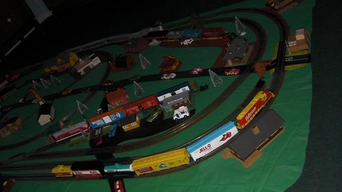

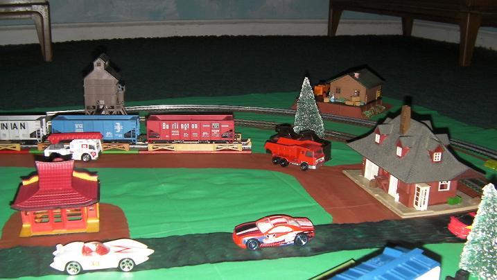

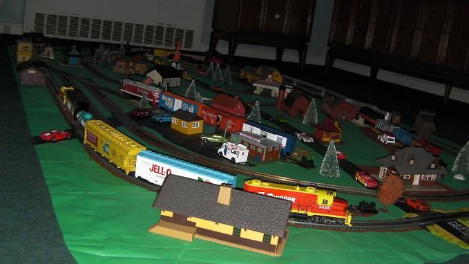

 Posted - September 02 2014 :  3:39:02 PM Link directly to this reply  Show Profile  Add wks to Buddylist

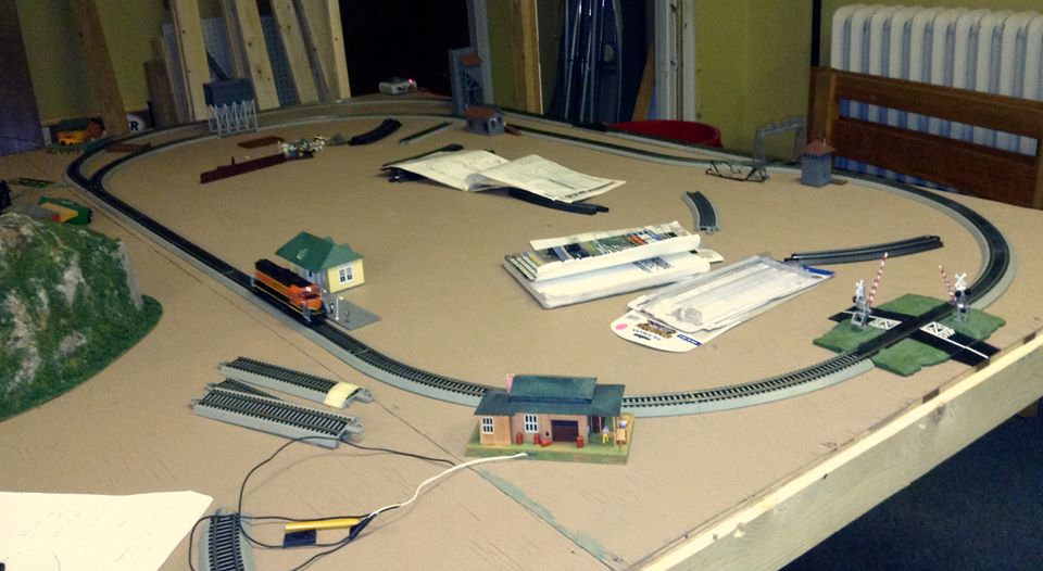

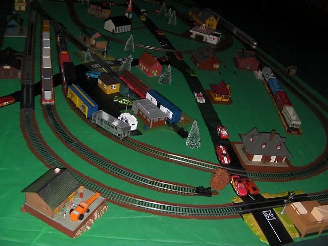

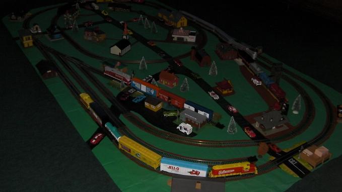

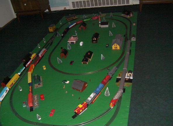

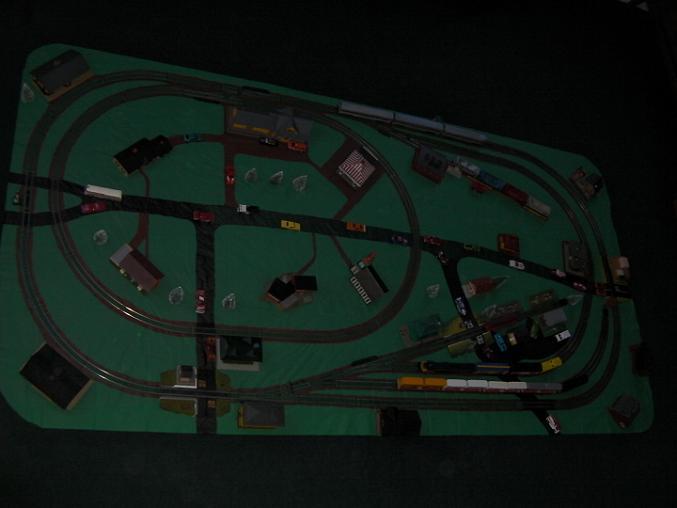

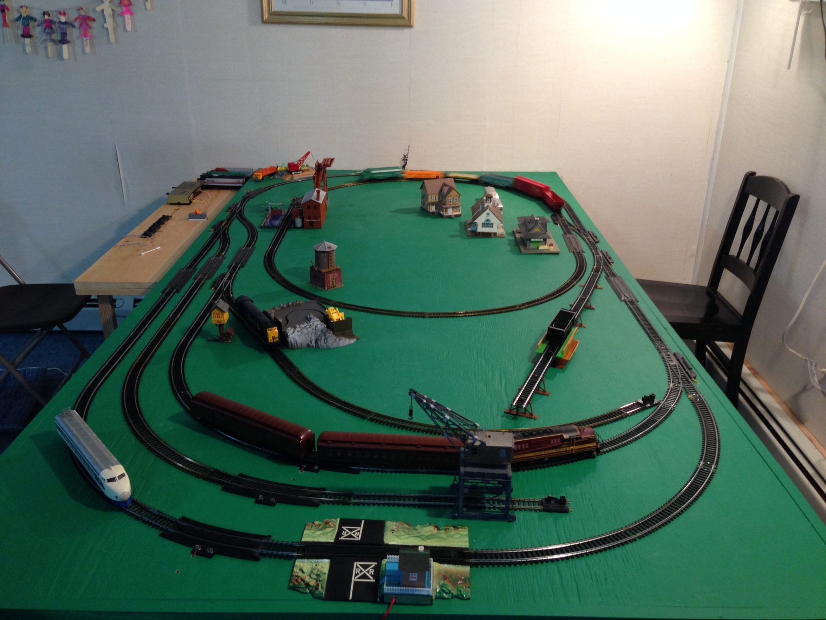

Had some free time over the weekend, so I somewhat recreated the layout plan with some changes.
The scenery and effect is minimal but still fun to run. Easy to take apart after use.
The benefit of this plan is you do not need a permanent layout. You just need imagination and patience.

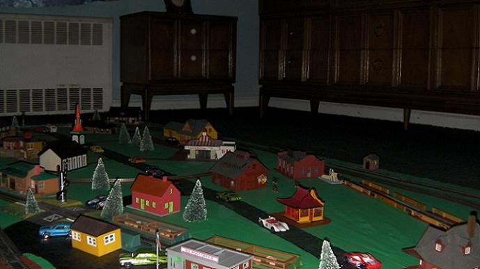

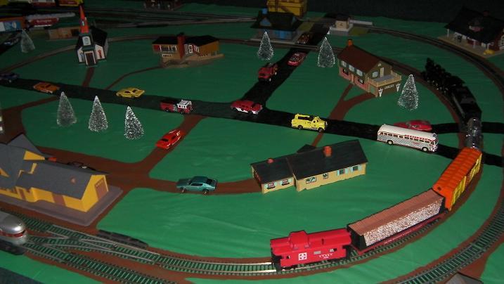

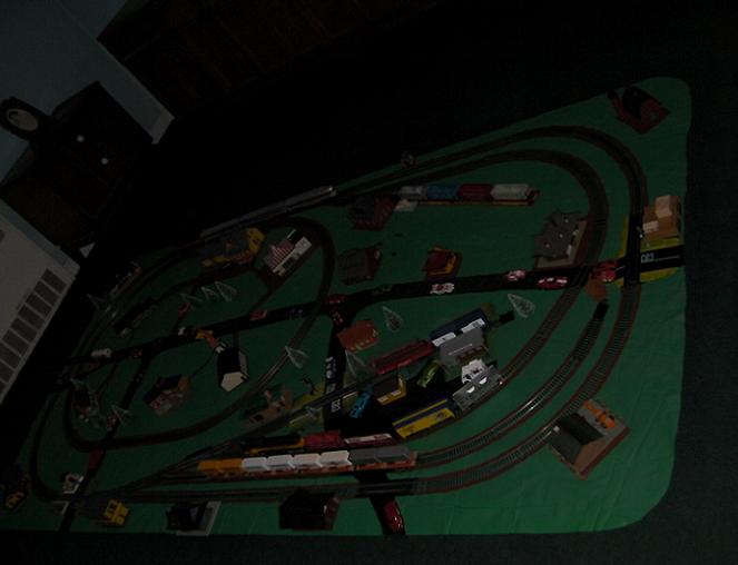

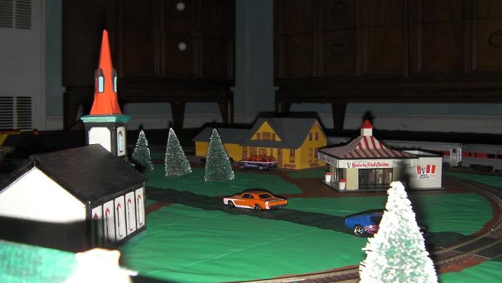

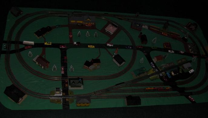

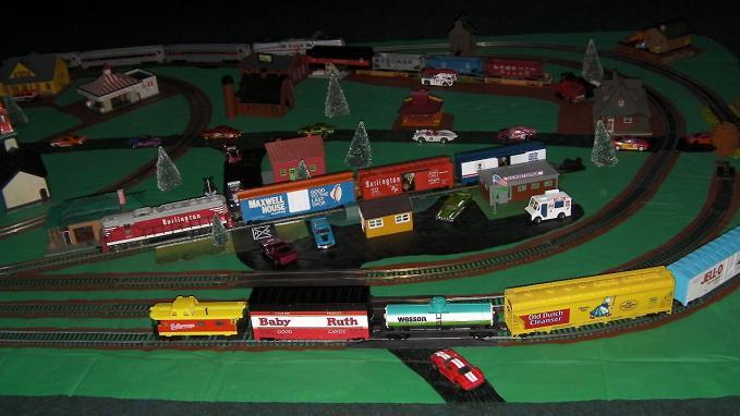

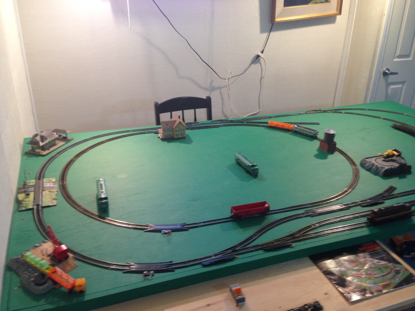

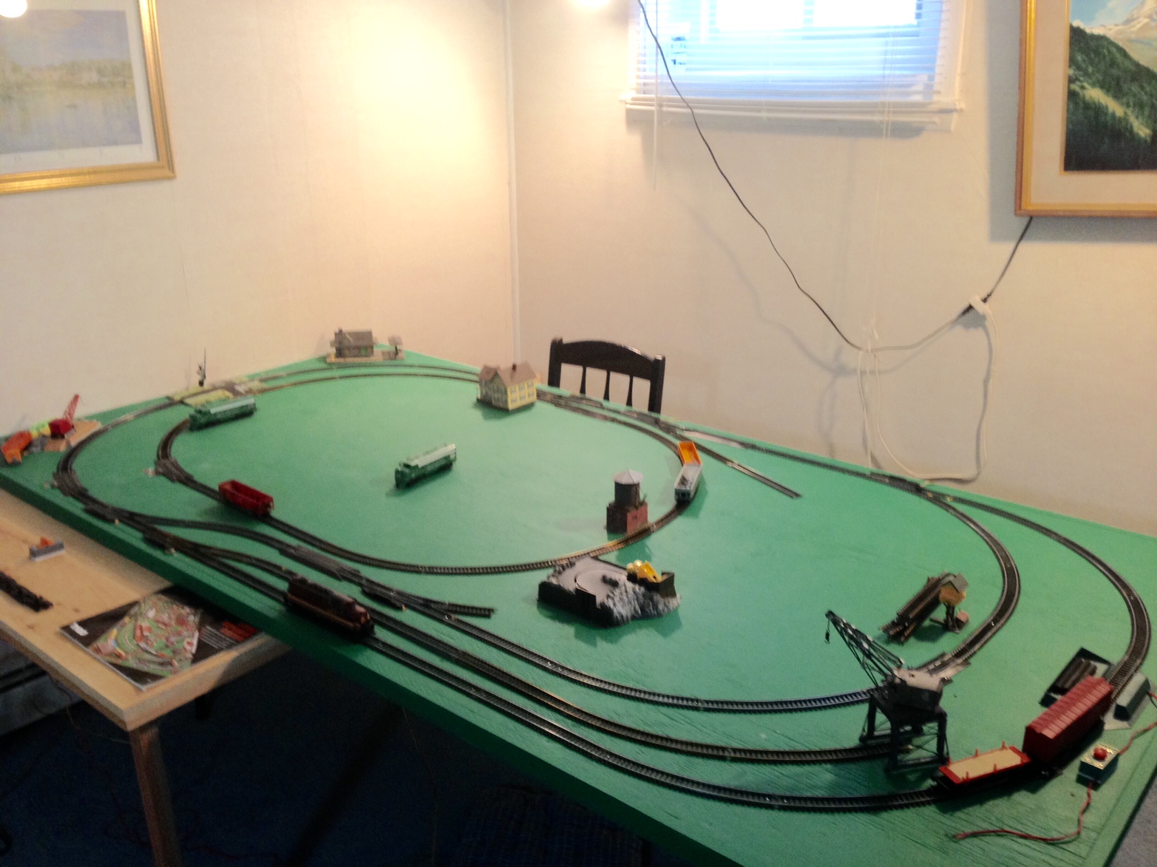

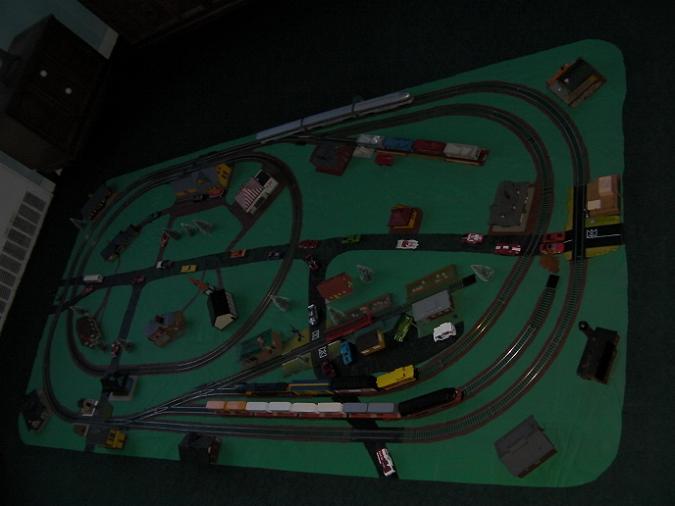

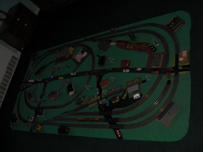

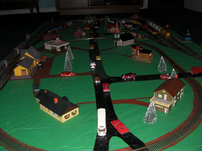

I've been working on the Tyco Layout expander for a little while now. I am up to stage four. Ive followed the directions exactly. Next step is wiring and decoration.
 Country: USA  ~  Posts: 16  ~  Member Since: March 01 2015  ~  Last Visit: March 28 2015 Alert Moderator  Go To Top Of Page

COOL layout, BPD! Looks like a lot of fun as is

 Posted - March 03 2015 :  3:06:10 PM Link directly to this reply  Show Profile  Add BPD2144 to Buddylist

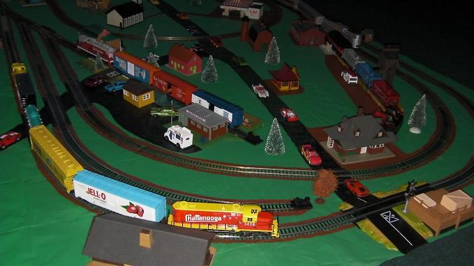

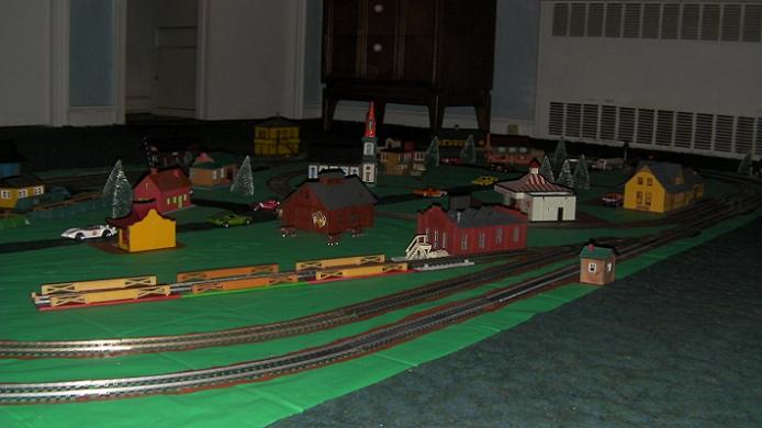

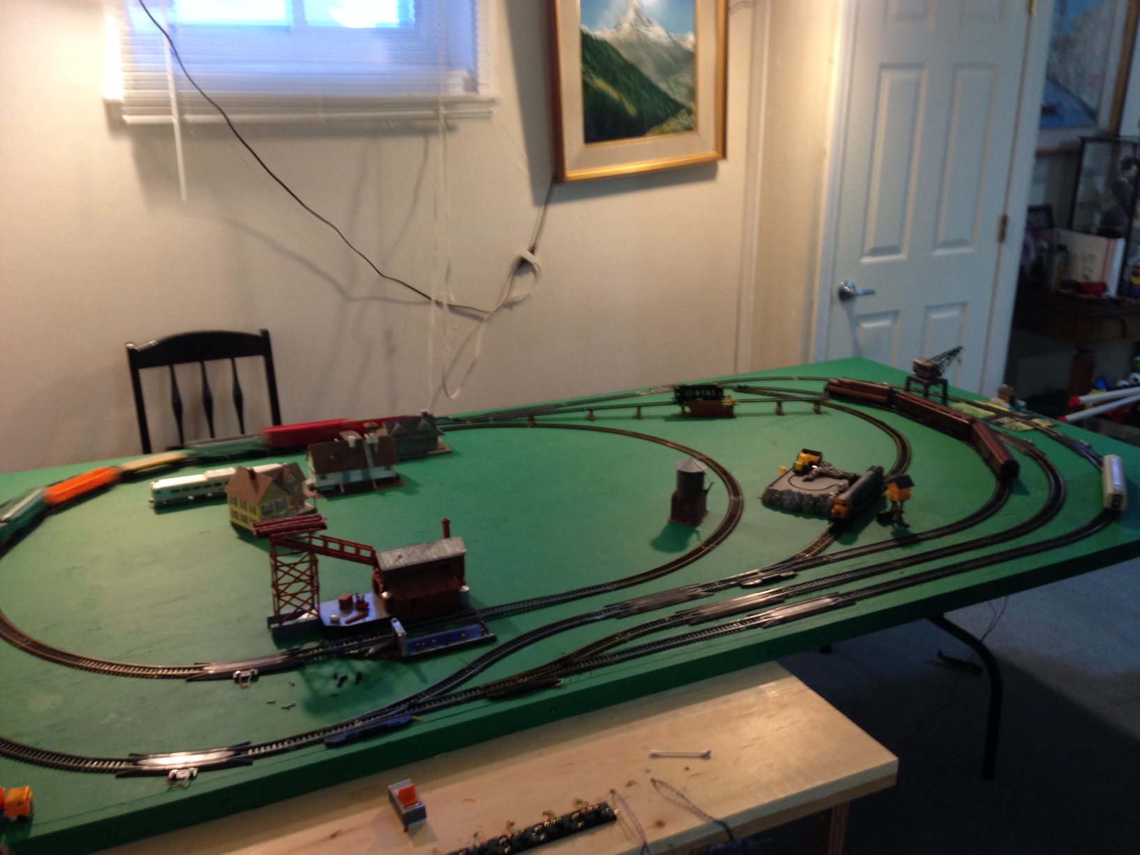

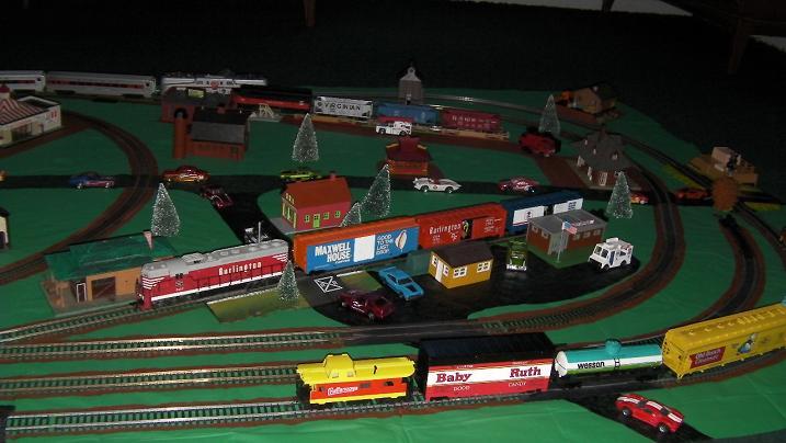

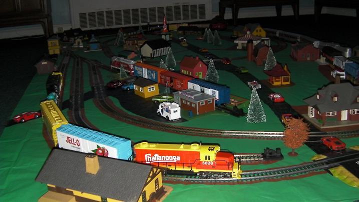

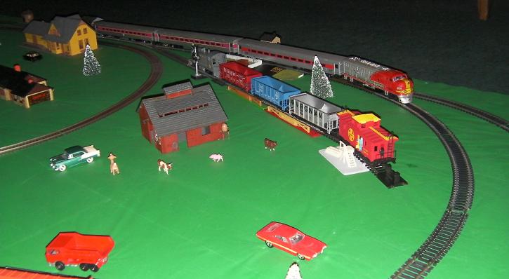

Update of my "Tyco Layout Expander" layout. The last three sidings are laid out including the dumping ore car. Waiting to get uncouplers before I nail it down.
One question I have is how is a train expected to back on to sidings 3 & 4(The ones with bumper track)? The pictures Tyco has on the cover has the trains backed in. Pardon my ignorance I'm totally new to all of this. Thanks for the previous compliments.
Edited by - BPD2144 on March 03 2015 3:41:10 PM

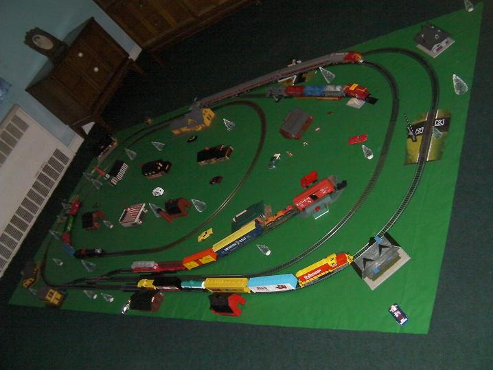

BPD2144:
I'm not sure what you're saying, but I'll take a shot. Does your layout have block wiring? I mean, are the separate "loops" of track insulated and wired separately on switches? That allows you to "park" some trains and run others, in whatever direction you want .
With a layout like this, you should be able to have separate sections of track "blocked off" so that you can activate/deactivate them as necessary. That way you can run a couple trains at once, while the others sit still.
On the layout in the picture, the loop that the SF passenger train is on would need to be electrically isolated from the inner loop, which would run separately. The sidings where the other trains are parked would also be isolated. On/off switches activate the track. This is a lot easier to explain in person, but I'll do what I can.

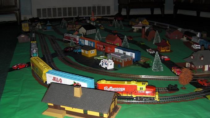

 Posted - March 05 2015 :  12:14:46 PM Link directly to this reply  Show Profile  Add BPD2144 to Buddylist
Thanks for the reply.
By following the layout expander direction the two trains run together on the outside loop and the inner isolated loop (the loop with the KFC) using two separate powerpacks.
If I put the "Chattanooga" on the outer loop and parked it. The "Santa Fe" on my layout would still run counter clockwise on the inner loop. (Both on one power pack with blocking switch)
If you look at my pic the B&M engine is running counter clockwise with the Bullet train parked on the outer loop.
My question is how do I get the B&M to run clockwise? Did I miss a step in the directions? (Quite possibly) Is this as simple as running the train in "reverse". (placing the train on the track in the opposite direction).
Thanks for the help.

In case you didn't notice, you still have another siding to add to the layout to make it complete. There should be another siding between the two outer loops. That would allow you another place to spot that extra train, and open up one of the outer loops. The siding should be in the area where you have the station and railroad crossing.
You have five trains on the layout, and the track work as currently laid out, is designed for only four trains. Not that you can't run five trains, but it would take some extra block sections and additional wiring. You would have to set it up so that one of the loops has two block sections in it, so that you could park both the Chattanooga and the Santa Fe on the same loop. Then you could pull the B&M out to make it's deliveries. With the direction that you have it facing, it could only run counter clockwise, unless you run it in reverse. And local freights are often seen operating in reverse.
Remember that this layout was designed to show off as many of the operating accessories as possible, and they crammed everything they could into it. It wasn't really designed for true operation. In fact the layout was only designed for four trains, with only two trains operating at one time. It was designed to use four power packs, but two are for the accessories, and the other two are for running the trains. It was designed for the average person, easy for them to put together and have some fun with their trains. It is a great 4x8 layout and it is perfect to show off our Tyco stuff. But unless you want to really complicate things, and add a reversing section of some sort, you will not be able to get you trains to run in the opposite direction. That and dealing with the limited 4x8 space it would be tough to lay the track out and have it look good.
Don't give up on it, you have a great looking layout. Think about getting that last siding added, and it will help open things up for you.
It is a great layout to just "have fun" with, things don't always have to be complex. I have an expanded version that I am planning to build for the grandsons, that will include a freight yard and engine facility to help alleviate some of the congestion on the main route and allow more variation to the trains. Hope to get started on it soon, and I share my progress as soon as I can get started on it.

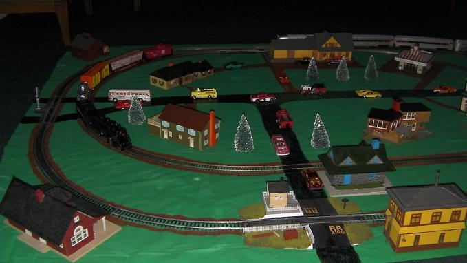

Thanks for replying. I think you were looking at wks layout.
Mine does have the two sidings. (the pic w/ the black chair in it) I have 4 trains not looking to run 5.

If you look at the Tyco layout expander booklet cover you have trains running in opposite directions. If you look at the pic from wks there is a Santa Fe running on the inner loop in a clockwise direction.
Following the directions: power pack 1 runs the inner and outer loops. If the power pack directional switch is put in forward a train will travel counter clockwise on both loops. Therefore if I park a train on a siding the engine will go in head first facing in up against the bumper.
I'm asking how do you get a train to run clockwise on the layout? Do I park a train on the outer loop, then place a train on the inner loop facing clockwise and run it in "reverse" to have it go clockwise? Therefore being able to back the trains in on sidings 3 & 4.
 Posted - March 06 2015 :  8:21:37 PM Link directly to this reply  Show Profile  Add JNXT 7707 to Buddylist
Any way you can scan the directions and post them? Because I don't quite understand the concept.
What does Power Pack 2 do?
If you have a train running on the outer loop AND the inner loop - controlled by ONE Power Pack - and they are going opposite directions, then the two loops need to be isolated from each other. Are they?
AND...if they are indeed isolated, then you would have a set of wires running from the Power Pack to both loops. IF so, then simply reverse the wire connections on one loop.
Or have I missed the whole thing entirely?
 Posted - March 07 2015 :  12:17:40 AM Link directly to this reply  Show Profile  Add gmoney to Buddylist
Originally posted by BPD2144 - March 06 2015 :  7:34:39 PM
The short answer is "yes."
The problem is that the polarity switch on the power pack is labeled "Forward" and "Reverse." This is fine if you are running one train on a simple loop, but with multiple trains facing different directions, those labels are basically useless. Instead, think of the polarity switch as choosing between "East" and "West" or something similar. That way, in order to run an eastward-facing train forward, set the switch to "East" and to run a westward-facing train forward, set the switch to "West."
I hope this helps, and doesn't confuse matters more instead.

wiley209
 Posted - May 02 2015 :  3:54:35 PM Link directly to this reply  Show Profile  Add wiley209 to Buddylist
Originally posted by BPD2144 - March 03 2015 :  3:06:10 PM
That looks great! As I said, my current layout is partly based off it, but doesn't have any of the blocking, as it's a DCC railroad. (Even building the 4x8 Layout Expander System as is but without the gaps and blocking would still make a pretty good layout for a beginner to DCC!)

wiley209

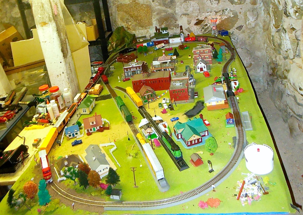

 Posted - May 31 2015 :  7:12:26 PM Link directly to this reply  Show Profile  Add wiley209 to Buddylist
Here's the initial Layout Expander track plan, as done with Bachmann's E-Z Track!
This is kind of a temporary track layout we have at the local hobby shop for running our equipment on before we begin actual construction of the layout (we need to order some 22" radius curves for the actual track plan.) But this is pretty good too; we even used it with an E-Z Command unit, and it was indeed ideal for DCC usage.
Status: online

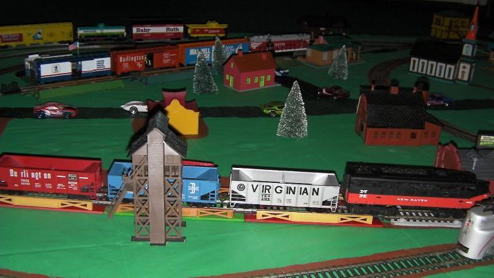

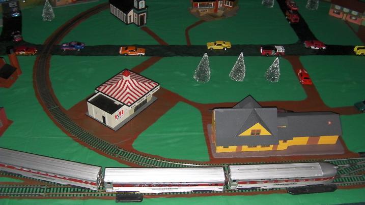

 Posted - March 03 2016 :  7:38:43 PM Link directly to this reply  Show Profile  Add wks to Buddylist
Nice photos. I built a temporary layout based on the design for fun. I will put it away
shortly but I hope these next photos will inspire others to do the same. This is perfect
for those who do not have the space to build a permanent layout. They can set up
something similar to run and showcase their collections. Are you listening Ben.
Will post more photos before I put the items away. This is also a good idea
for those people who plan their new layouts. They can experiment with various
designs on the floor before picking the right one to build.

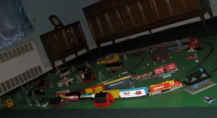

 Posted - March 04 2016 :  10:25:55 AM Link directly to this reply  Show Profile  Add wks to Buddylist
Some more photos.
Bulk of track are 18 radius and 9 inch straight. Few 15 radius
and 6 inch straight. Fun to do and very easy.

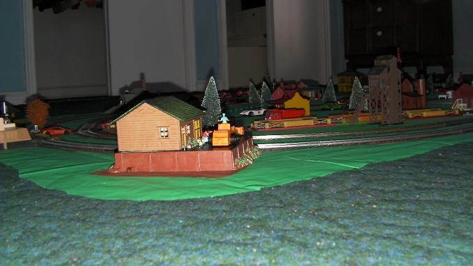

 Posted - March 08 2016 :  5:30:28 PM Link directly to this reply  Show Profile  Add wks to Buddylist
Some aerial photos as well.
Nice track plan for starting your railroad empire.

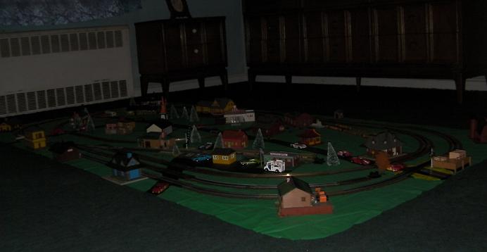

 Posted - March 09 2016 :  5:32:40 PM Link directly to this reply  Show Profile  Add wks to Buddylist
More photos using the 1977 sets with some changes.
Should bring back memories.
 Country: USA  ~  Posts: 8131  ~  Member Since: February 12 2014  ~  Last Visit: November 24 2026 Alert Moderator  Go To Top Of Page

 Posted - March 10 2016 :  12:54:53 PM Link directly to this reply  Show Profile  Add wks to Buddylist
More photos.
Will post a few more before removing it for a later day.
