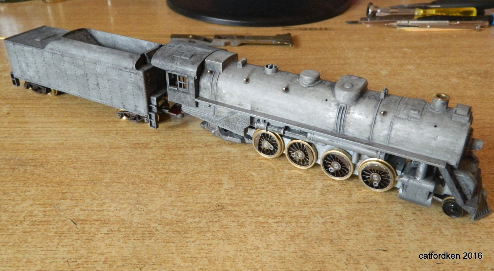

 Posted - October 23 2016 :  09:55:23 AM Link directly to this reply  Show Profile  Send catfordken a Yahoo! Message  Add catfordken to Buddylist

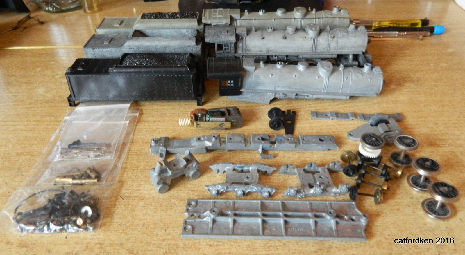

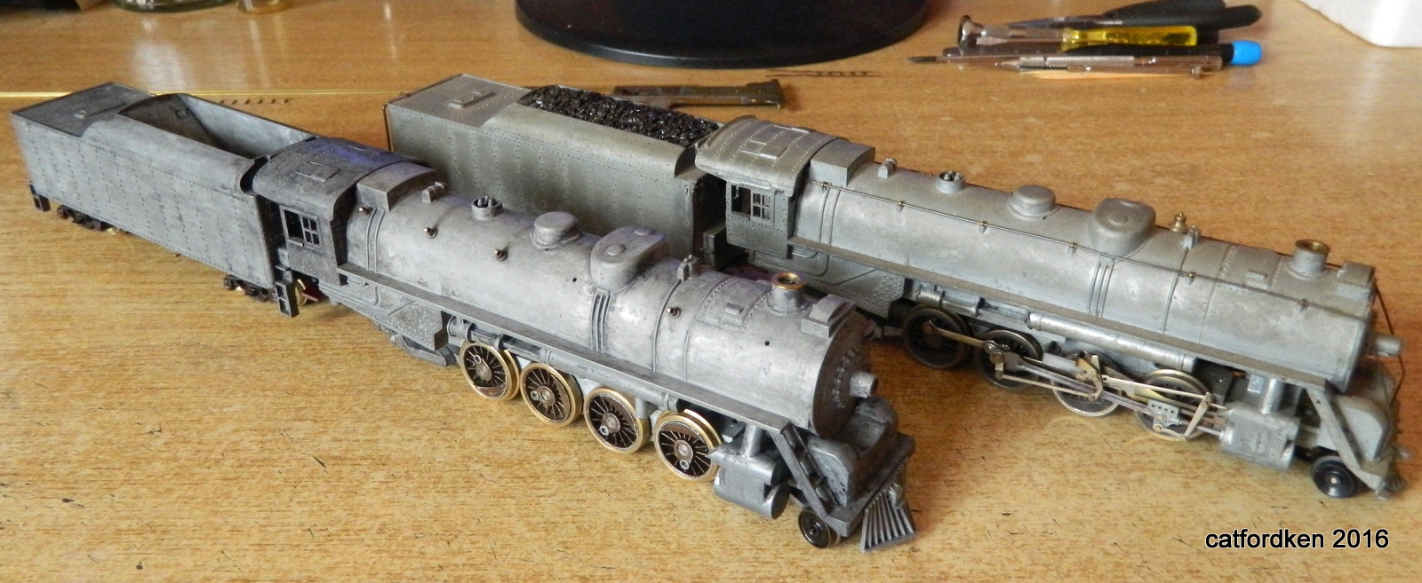

stripped and ready for the drive mechanism to be added,had to get a friend to strip the drive assembly,as previous owner had rounded the heads on a few bits,he has better eyes than me,ken
with her sister the 2nd version
another difference i have noticed is that the 2nd version onwards has the newer handrail fixings,ie you still get the posts,but no need for the spacers
lastly one that was sold as a mantua but is most certainly a tyco,different in respect of construction

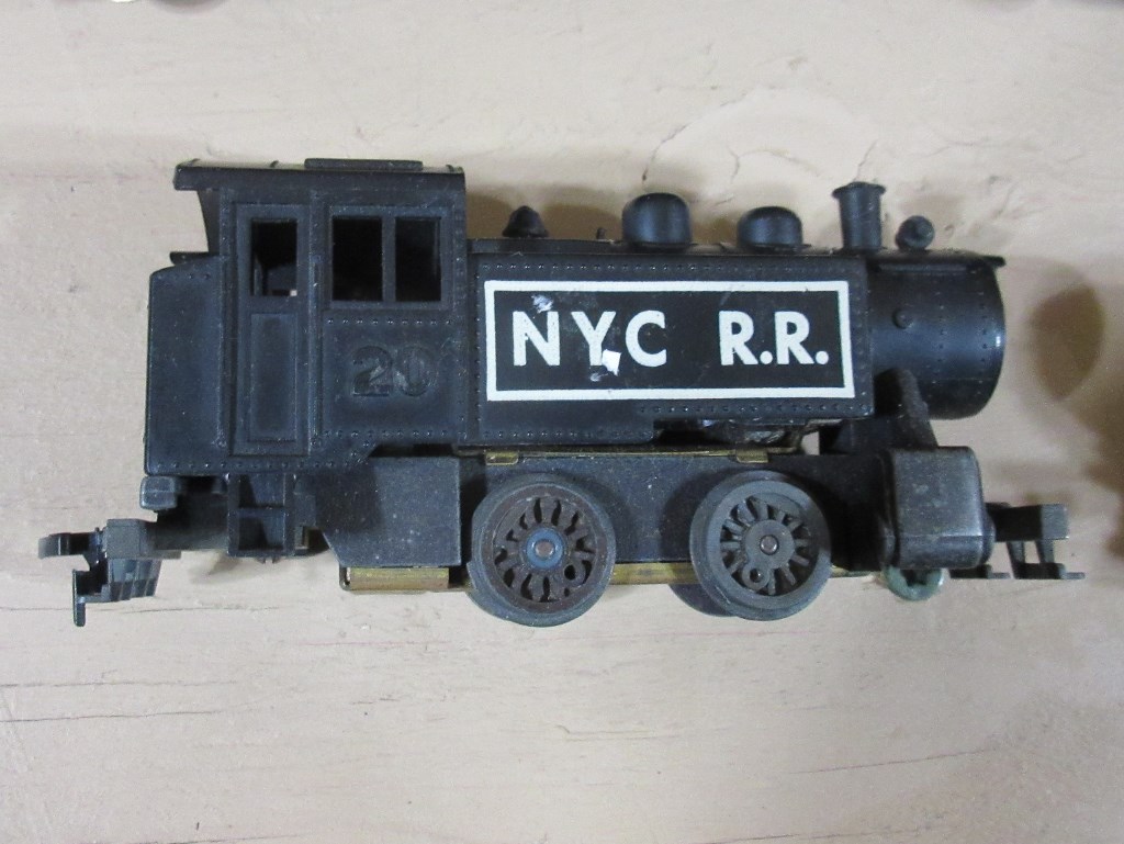

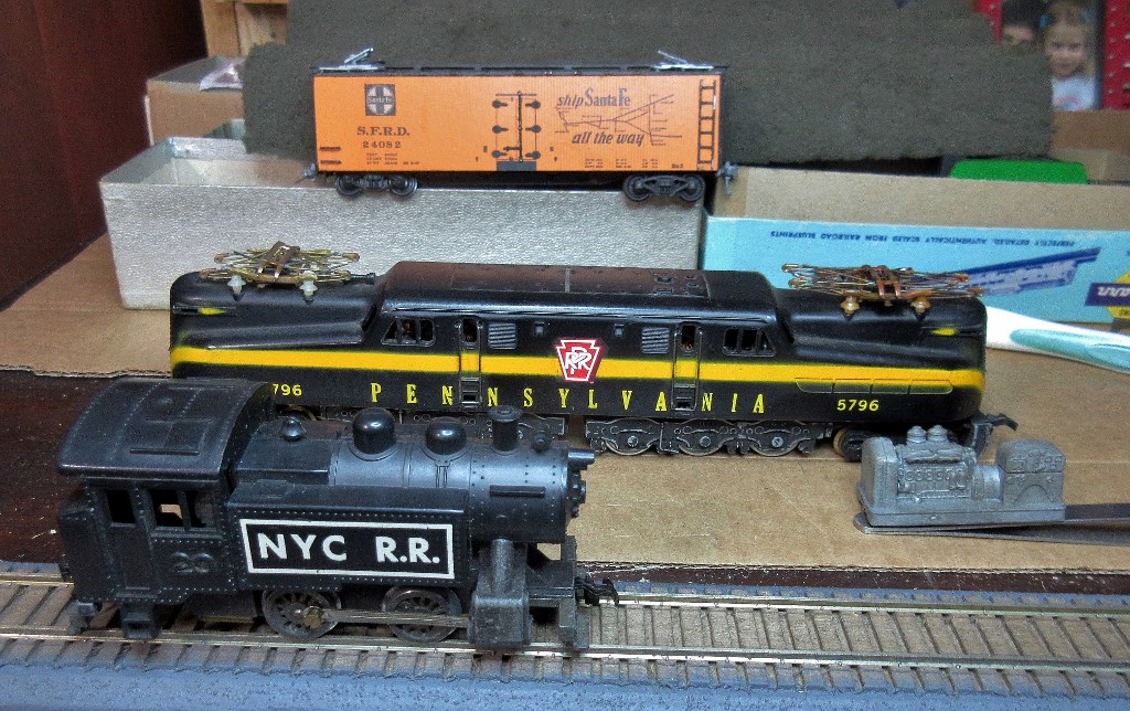

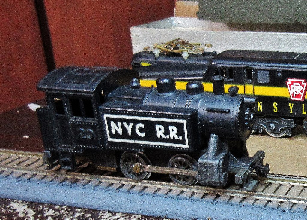

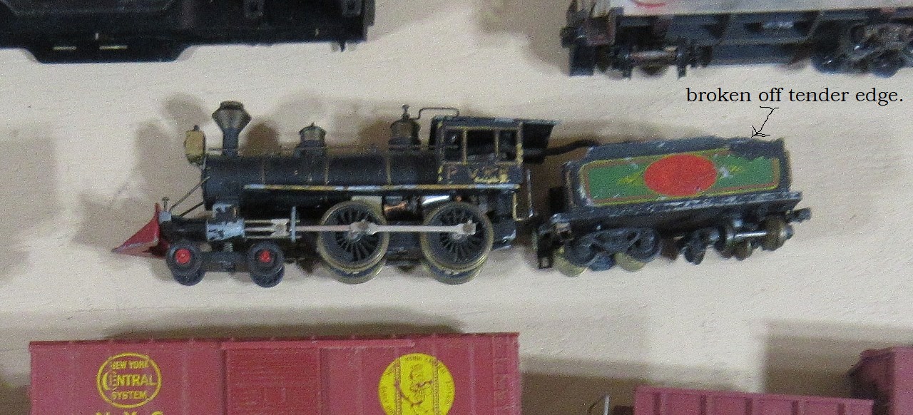

* You may have seen the photo of the Marx NYC 0-4-0t I got runnng again. Well lurking behind it is my next project a Penn-Line - Varney GG1 in need of some pentagraph work and as always a good cleaning and lube. This old shorty has had its main drives rebuilt with Bowser metal parts, bringing it back to the original Penn-line quality. The only plastic parts under that metal body is the front and rear trucks. Dont ask me which it the front and which is the rear for I dont know. A guess is the one in the front when it is going in one direction.
*** Here it is still lurking !
Edited by - toptrain on January 18 2017 08:26:43 AM

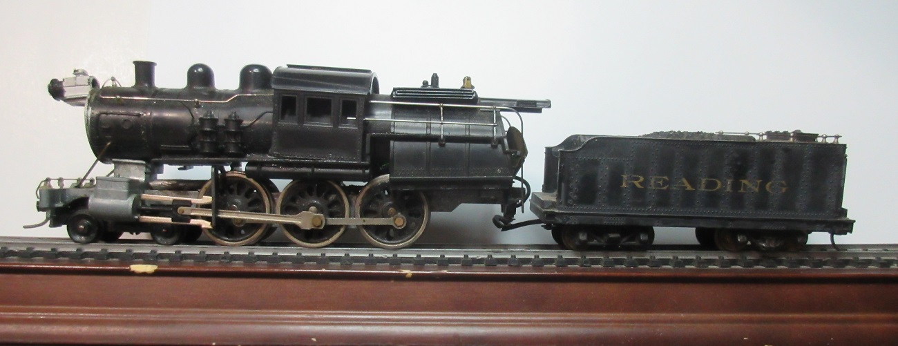

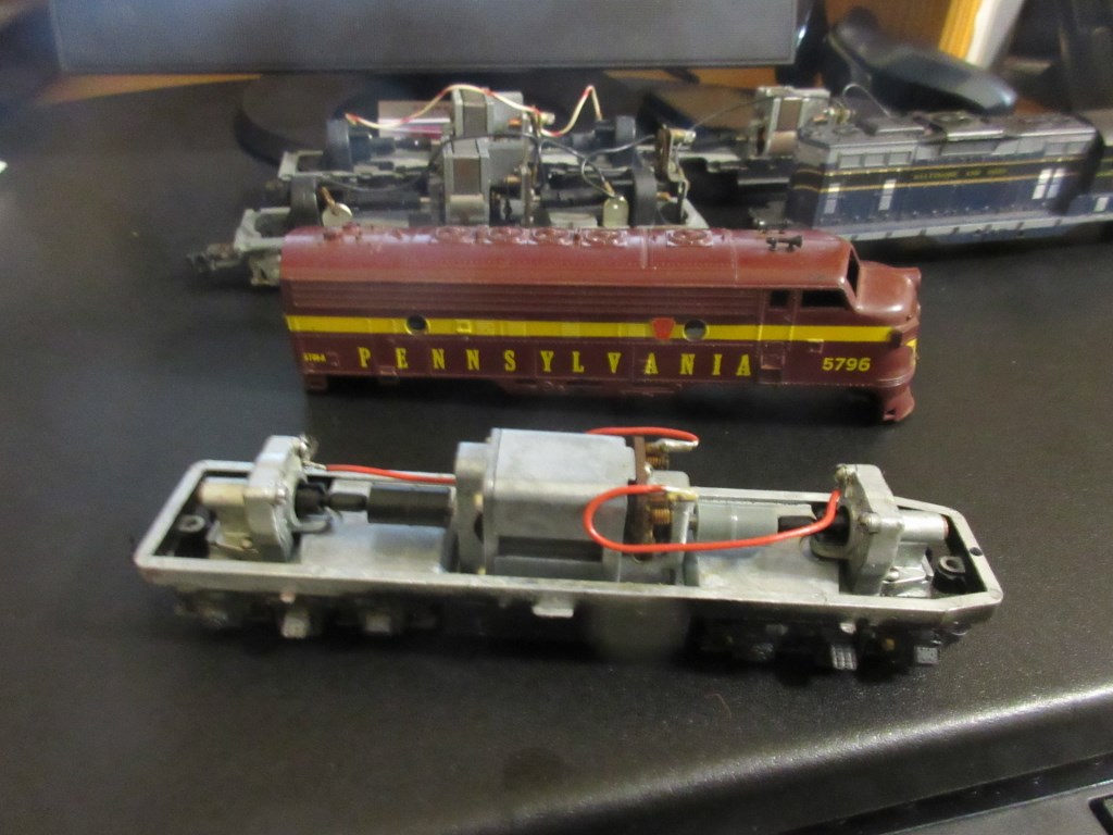

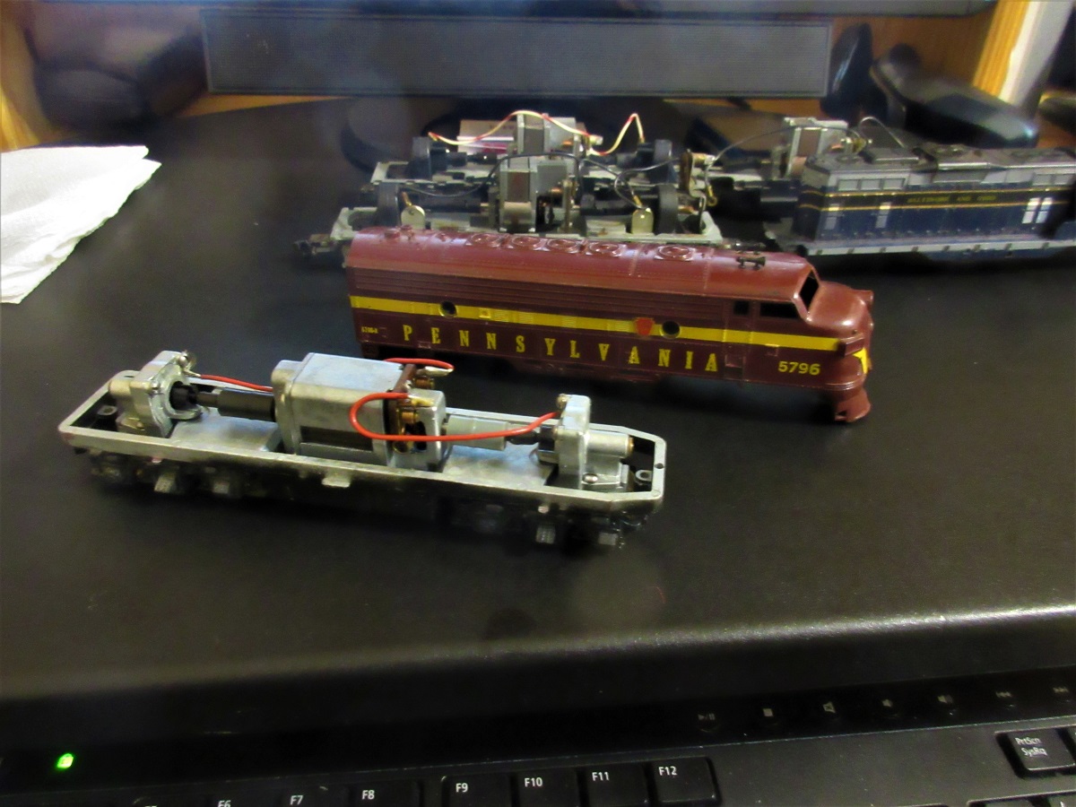

Here is a odd locomotive. The PRR F7 body is a Penn-Line. The drive looks like a early Athearn Geared drive. The motor is different to me. I have seen it before and didn't know what it was then either. I just knew it ran very well.
* It is possibly a re-motored with a after market motor.
Edited by - toptrain on January 25 2017 6:04:52 PM
 Posted - January 25 2017 :  6:02:52 PM Link directly to this reply  Show Profile  Add toptrain to Buddylist

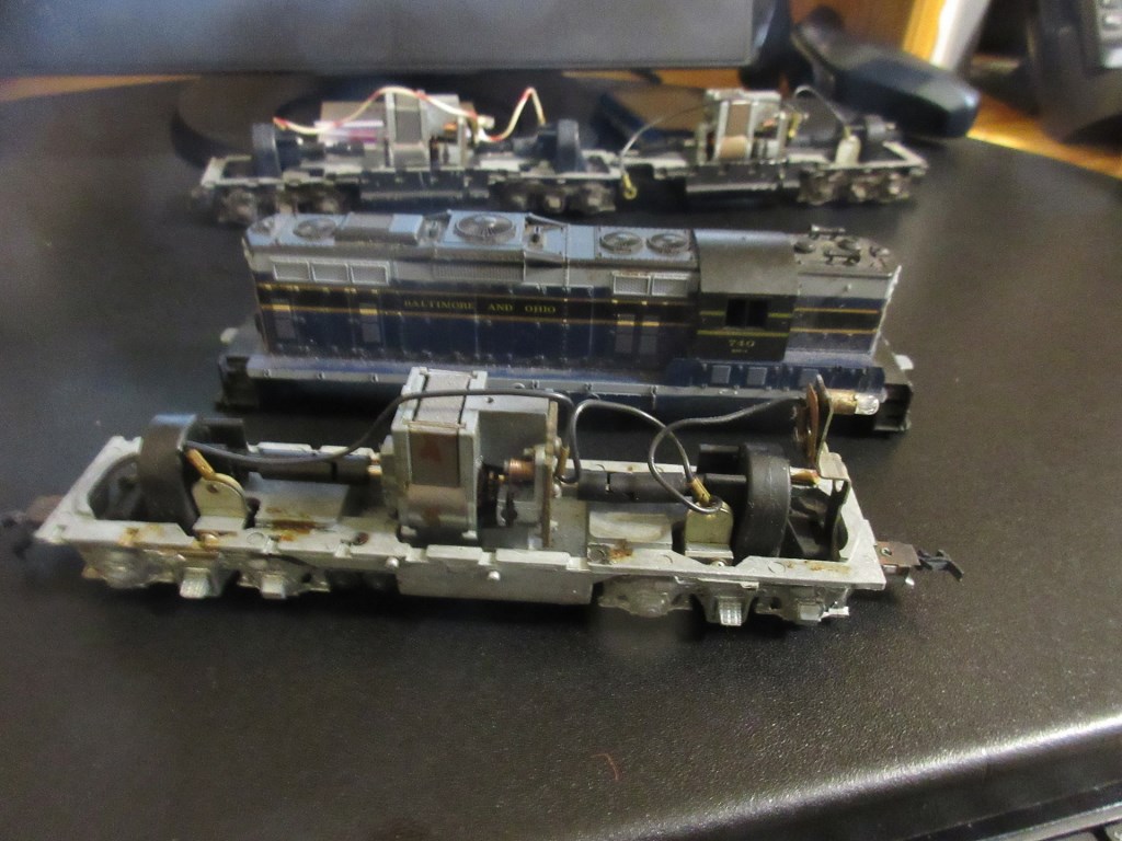

** Now this B&O GP7 looks to me to be a early Athearn geared drive, with a Athearn motor.
Frank
Edited by - toptrain on January 28 2017 07:42:10 AM

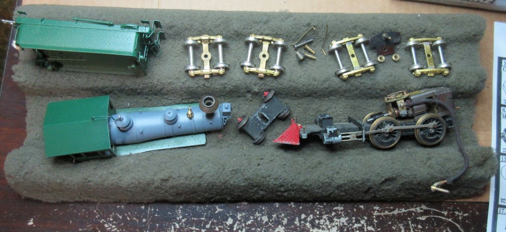

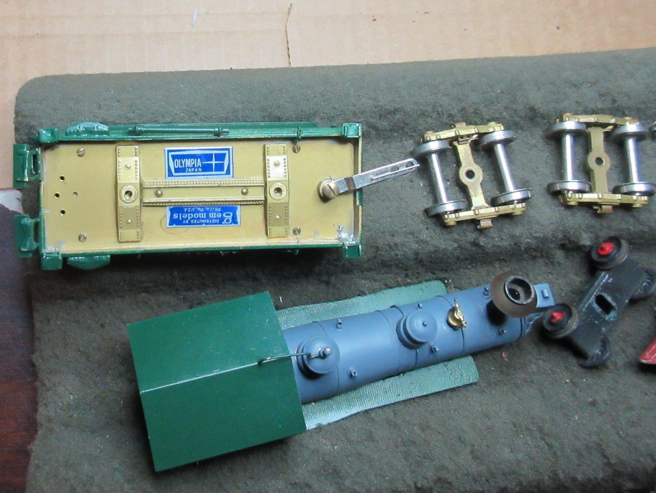

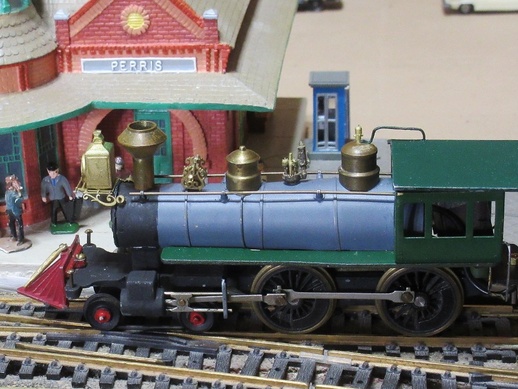

*** Mantua Bell of the Eighties
At the November twelfth 2016 Allentown First Frost train show I acquired a Mantua "Bell of the Eighties" 4-4-0 Old timer. It looks like a old beat up locomotive. The drive is intact. No important pieces are missing. The tender has been damaged and almost 3 inches of the upper edge of tender is missing. A little oil and the drive turns very well.
* It was not till the last week of December that the model found its way to the work bench. The tender body is a write off. I have a Gem Olympic brass tender to replace it with. Only working on the loco body I took the boiler apart, and stripped the body of paint. Looked through my parts and found some stuff. A fancy Kemtron bell and headlight. A different steam dome. A Kemtron pilot draw bar for old time locomotive pilots. It is to long but maybe I can shorten it. I know somewhere in a box or tray someplace is a well detailed, entire cab in plastic, a kit, for a old time loco. I haven't found it yet. I am painting the boiler Russian Iron gray. The cab and walkways different greens. The smoke box black. The tender 2 of the greens.
* This is where I am now.
Edited by - toptrain on January 28 2017 08:00:29 AM
 Posted - January 28 2017 :  08:50:07 AM Link directly to this reply  Show Profile  Add scsshaggy to Buddylist
That Belle is shaping up to be a pretty nice engine. Enjoying the updates.

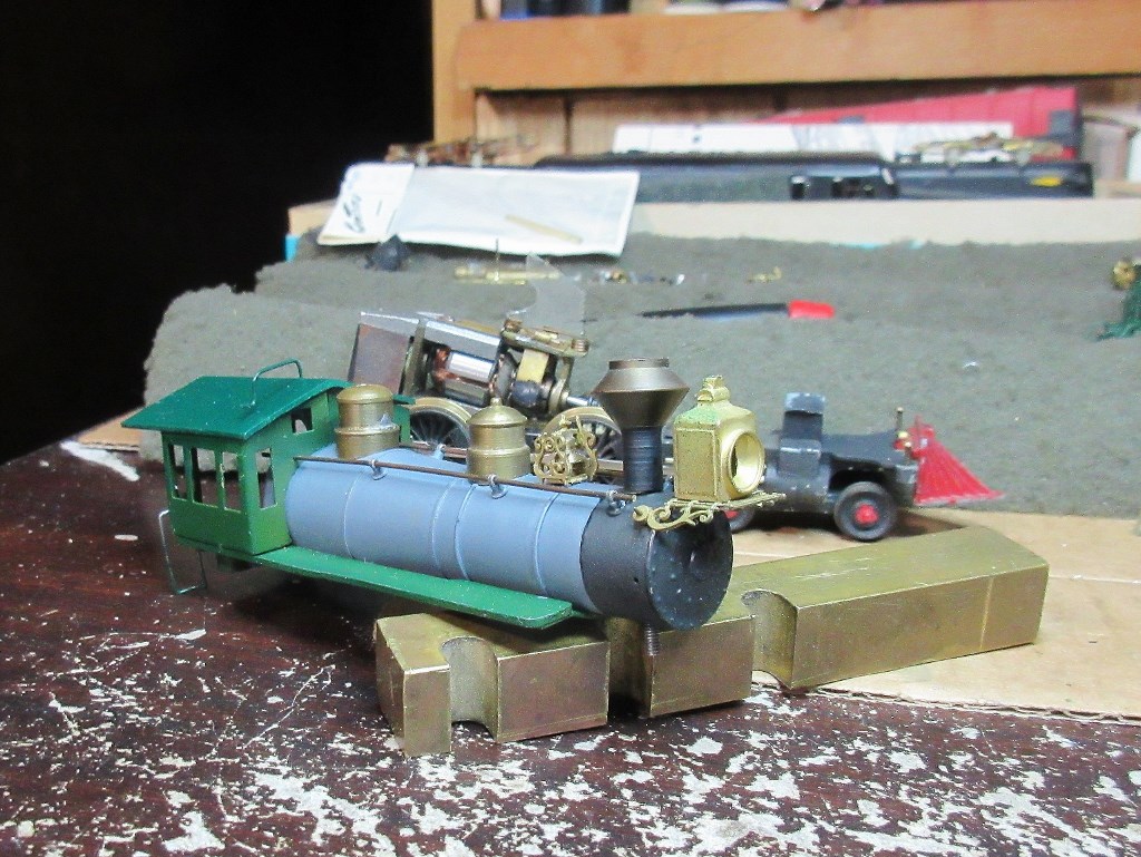

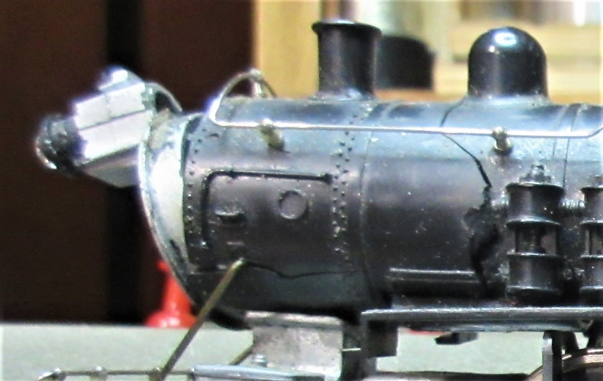

 Posted - January 29 2017 :  4:10:46 PM Link directly to this reply  Show Profile  Add toptrain to Buddylist
** Here is a good look at the boiler detail on my bell.

 Posted - January 29 2017 :  4:46:32 PM Link directly to this reply  Show Profile  Add ZeldaTheSwordsman to Buddylist
That looks very lovely!
I really need to get a hold of an old-timer one of these days

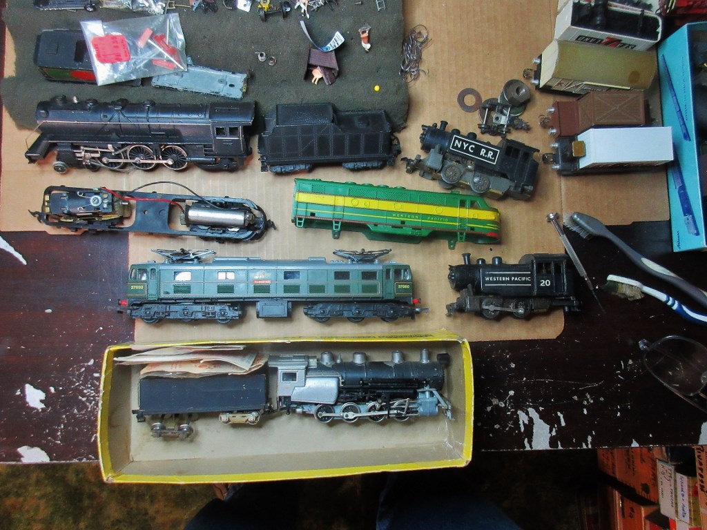

My work bench is still cluttered up with broken stuff for repair. The IMP 4-6-0 camelback went back to the Saylorsburg branch, but other work has arrived.
 Posted - February 16 2017 :  09:05:16 AM Link directly to this reply  Show Profile  Add toptrain to Buddylist
Originally posted by toptrain - February 13 2017 :  11:34:30 AM
* The electric loco by Hornby has a new coupler and is serviced and done.
* The Fleishmann pacific needs A new center driver and the hardware to fasten the rods and valve gear, so it remains undone .
* The Marx WP F3A is all fixed and ready for work.
* The other Marx UP F3A, not seen for my Grandson has been busy, has a new rear coupler and is lubed.
* The 2 Marx 0-4-0t still await service.
* The Lee town, Mantua conversion will be looked at soon.
* My Fleishmann 2-8-2 was worked on yesterday. I stripped a 2-6-0 of it drivers to replace the corrode ones, being the same parts. I'll do something separate with that engine here. It is ashame to take apart a good 2-6-0 for parts. I do see them at train shows so if I want one, they do show up.
* Work on the Mantua bell of the eighties has been stopped for now because of the need for a new cab. The original has no detail other than squared off holes for windows, and the unconnected pieces keep opening. Got to make or buy a better one.

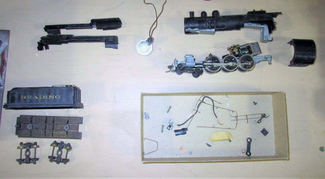

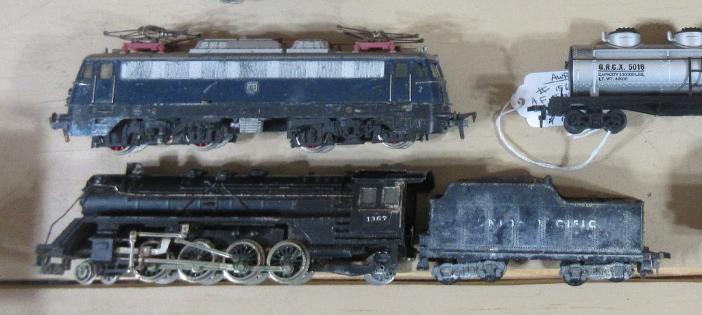

 Posted - February 16 2017 :  10:40:56 AM Link directly to this reply  Show Profile  Add toptrain to Buddylist

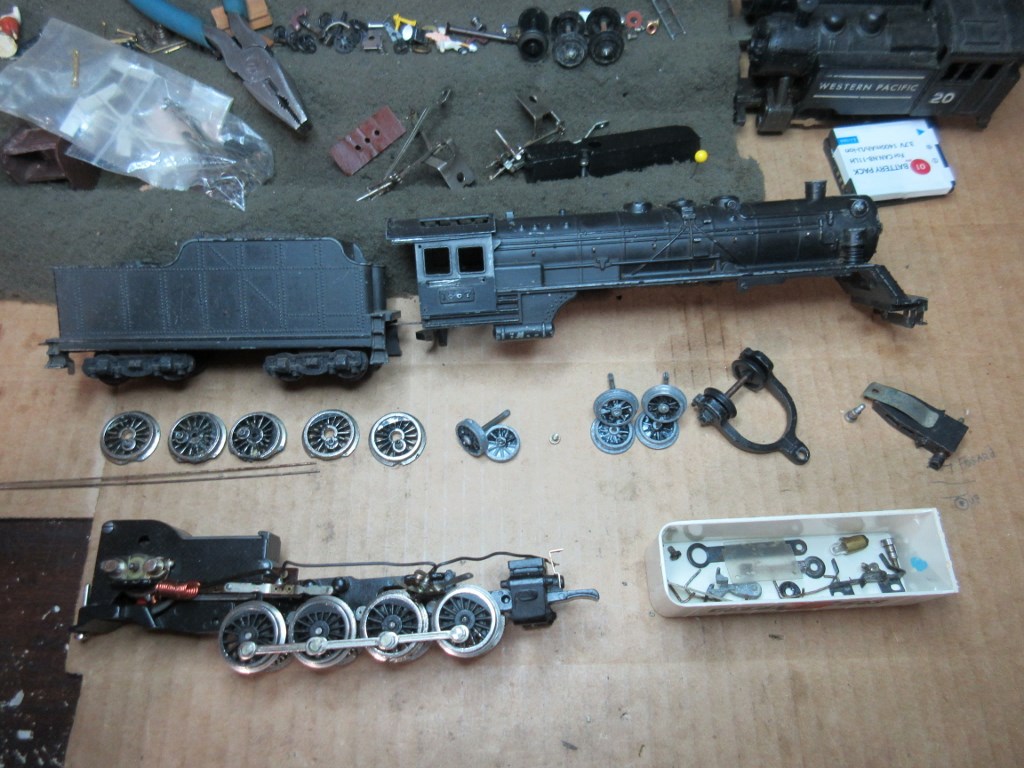

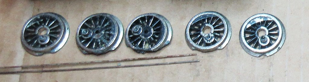

The loco I worked on yesterday was the Fleischmann 2-8-2 #1367 I got at the Allentown train show on 11-12-2016. I got 3 corroded locomotives that day for cheep. I looked for drive parts at all the shows I went to since that date and nothing could be found. I had gotten a 1350 2-6-0 months before and it was just sitting in its box doing nothing. Both 1367 and 1350 have the same drivers and mount to the same size axel. So I took part the 2-6-0 for parts for the 2-8-2. The Mikado will be of much more use to me.
* Here is 1367 when I got it ;
* Here are the 5 bad drivers !
* This what I did to it so far; Right now the drive is binding !
* Here is 2-6-0 1350 now ; I got it a Allentown First frost on Nov 14, 2015.
Edited by - toptrain on February 16 2017 4:17:15 PM

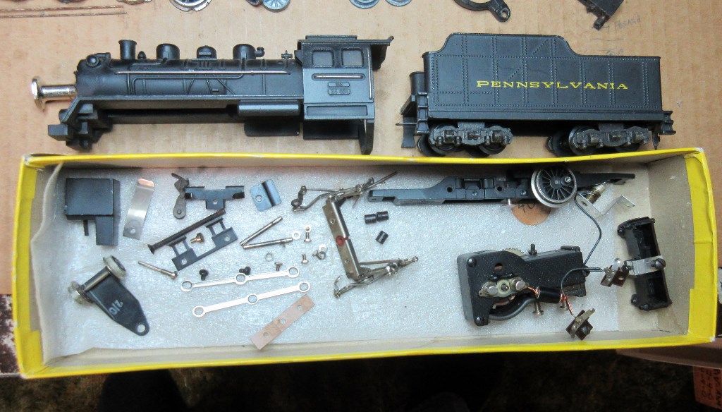

 Posted - February 16 2017 :  3:48:14 PM Link directly to this reply  Show Profile  Add toptrain to Buddylist

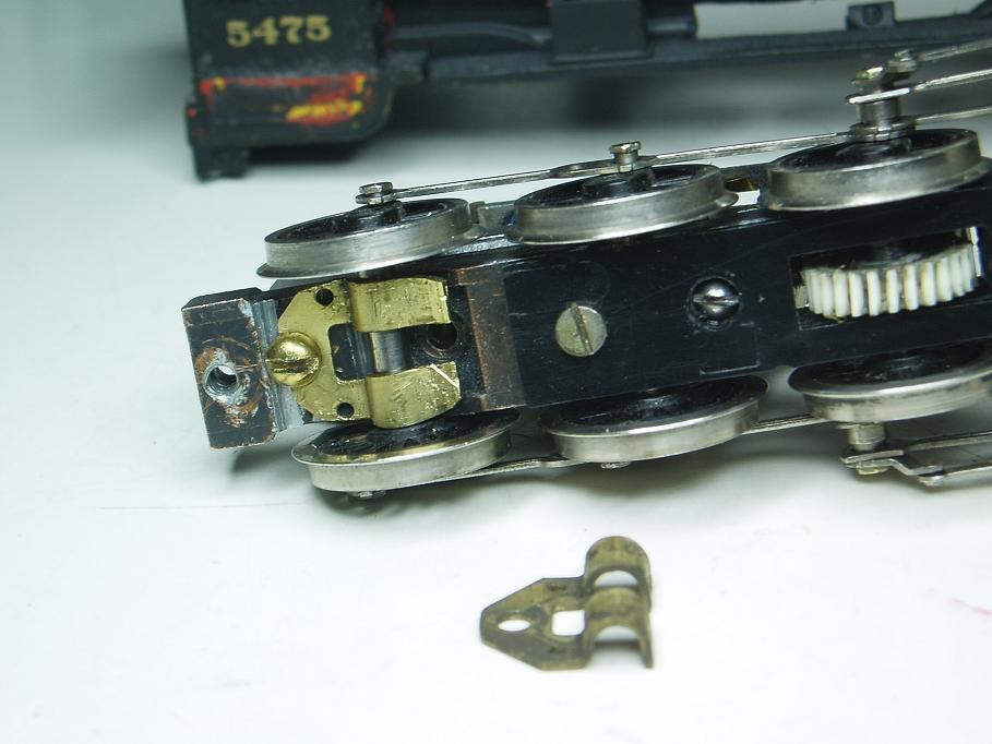

* To clear the binding I removed the motor and electrical pickups. I removed the side rods leaving only the wheels , axels. and frame. Placeing it on the test track and giving it a little push it rolled easily the 3, length os the test track. These wheels had to e quartered by hand and eye. Not the best way, but my puller and quarter would work with the wheels in the frame. I replaced the right side of the side rods. They will be making the right rail common with the frame. The roll test showed some binding going on. The first and last axels were OK ! I kept them connected tightly. I loosened the 2nd axel slightly and the binding cleared. I had a couple special washers for this problem and used one. I was able to tighten all 4 side screws and there was no binding. I installed the left side rods and the binding was back. I looked again to the second driver and loosened it and again the binding cleared. Same problem on both sides. I used my second washer. I have no binding in the frame with axels and rods installed.
* This is where I am right now. I do know this loco has a short to frame on the electrical pick-ups. I'll have to insulate them from the frame. Do this tomorrow. Have to get ready to meet some friends for some beers.
Frank
Edited by - toptrain on February 16 2017 3:50:20 PM
 Posted - November 16 2017 :  1:51:04 PM Link directly to this reply  Show Profile  Add toptrain to Buddylist

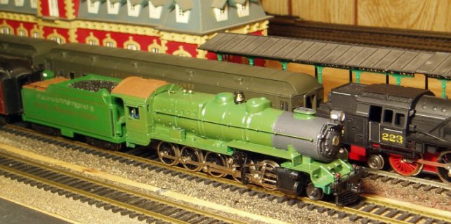

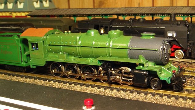

Actually, I forgot about this Fleischmann mikado 2-8-2 repair. What I finally did, I was able to use 3 driver sets from a 2-6-0. They were the same size and fit perfectly. I took the best of the remaining driver knowing that mast 4 axel drives use blind drivers an on the inside pair of axels. It is very common in Mantua and Penn-line. So now it is together and running. I still don't like doing it this way. I will be looking for another Fleischmann Mikado for parts.
 Posted - November 16 2017 :  1:56:21 PM Link directly to this reply  Show Profile  Add toptrain to Buddylist

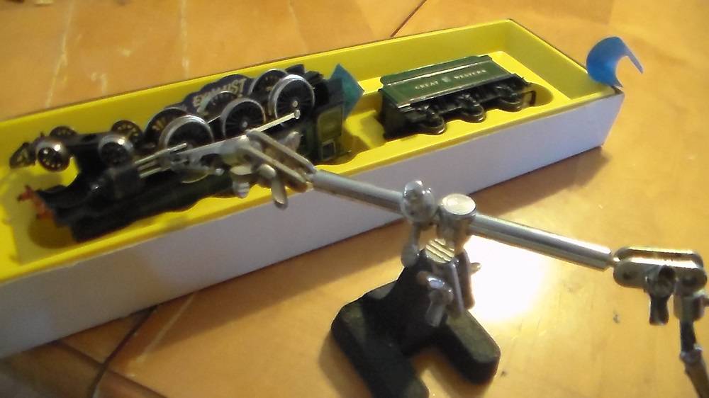

Ok, now I got at Allentown a Fleischmann mikado with no tender. What do I do now? Well if i can find the remaining parts to the 2-6-0 I took apart, I put it back together. At least then I won't be using corroded parts on my locos. Maybe somehow I can double head 2-6-0's. I won't know until I get started. I got to finish my Streamlined pacific first. The BLZ I am repowering.
Edited by - toptrain on November 16 2017 1:58:11 PM

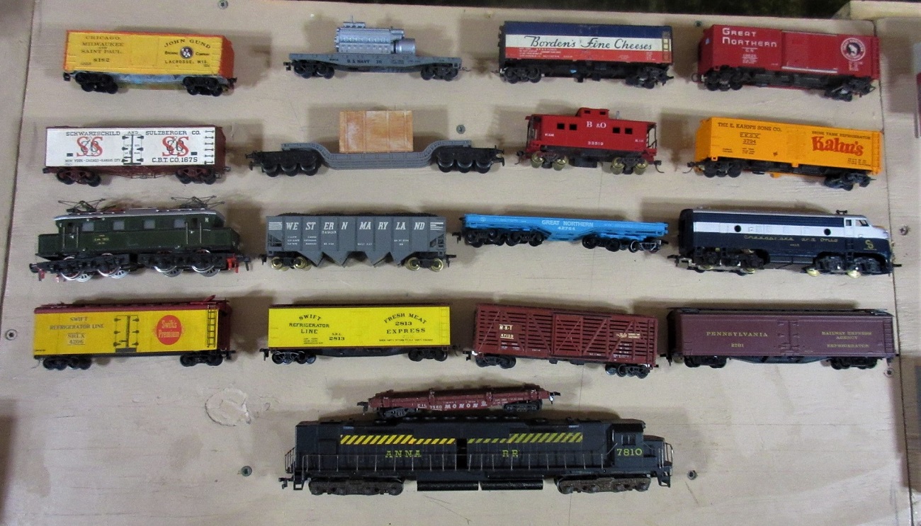

Well the last few days I've spent some time fixing trains. These are the done ones.

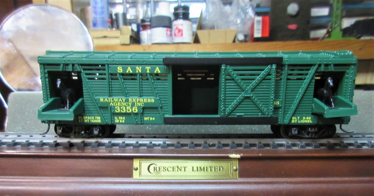

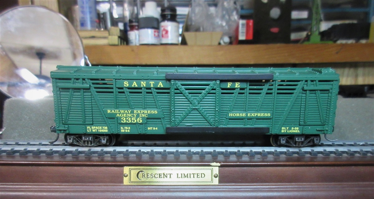

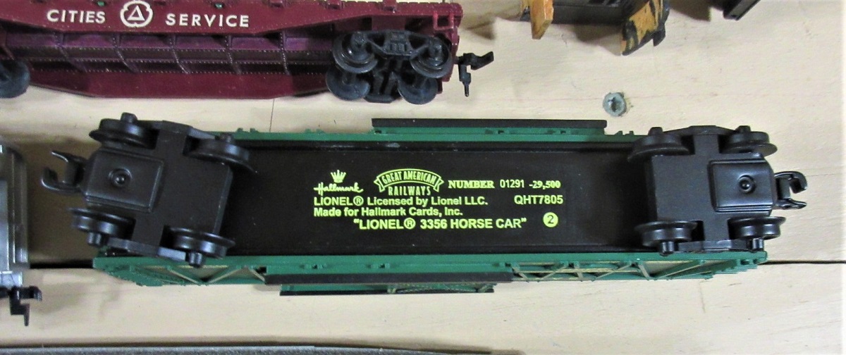

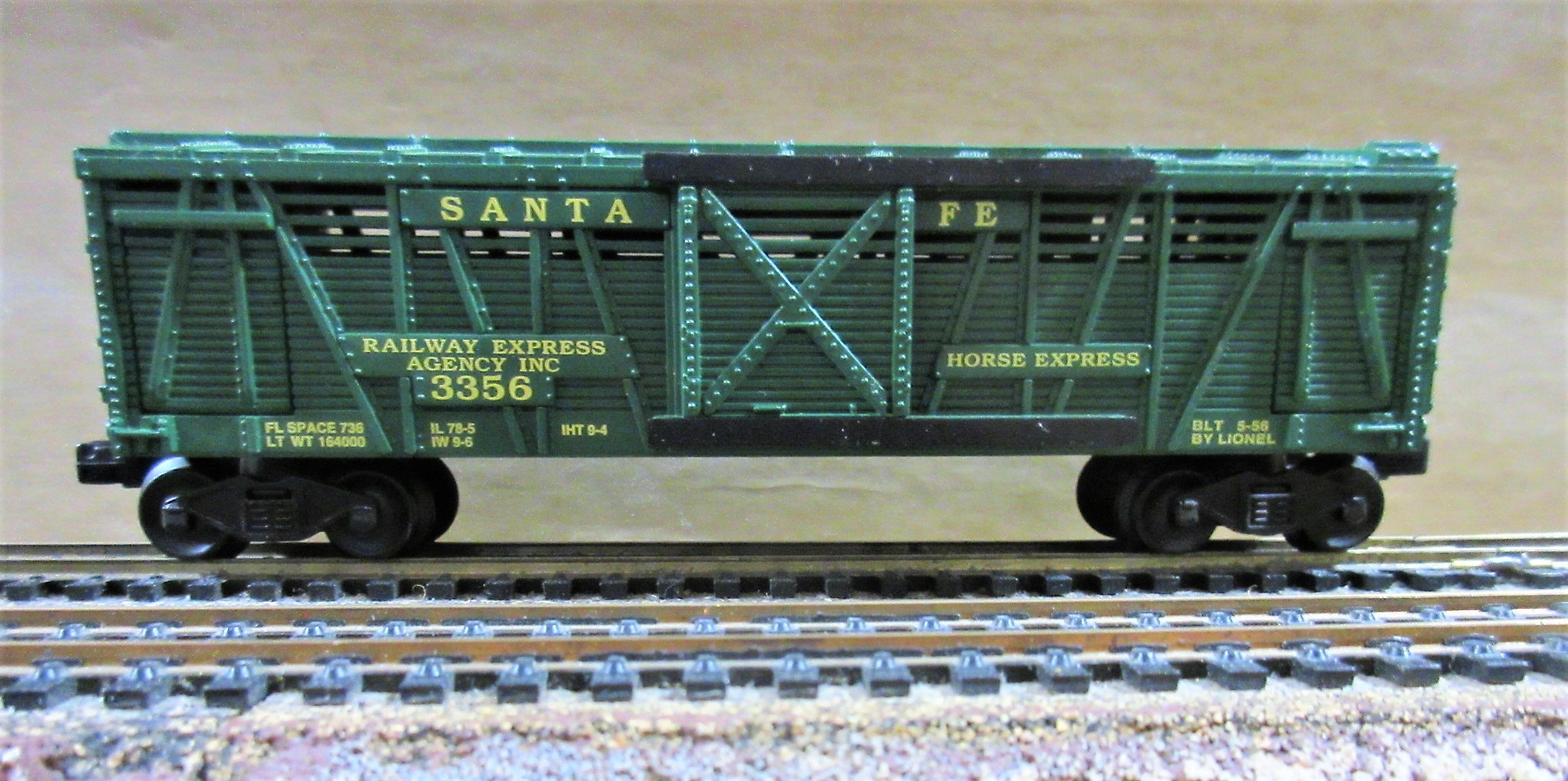

The Santa Fe Horse Car made by Lionel for Hallmark.
View 1, original car as I received it. It is a HO scale size car on tin plate trucks and couplers.

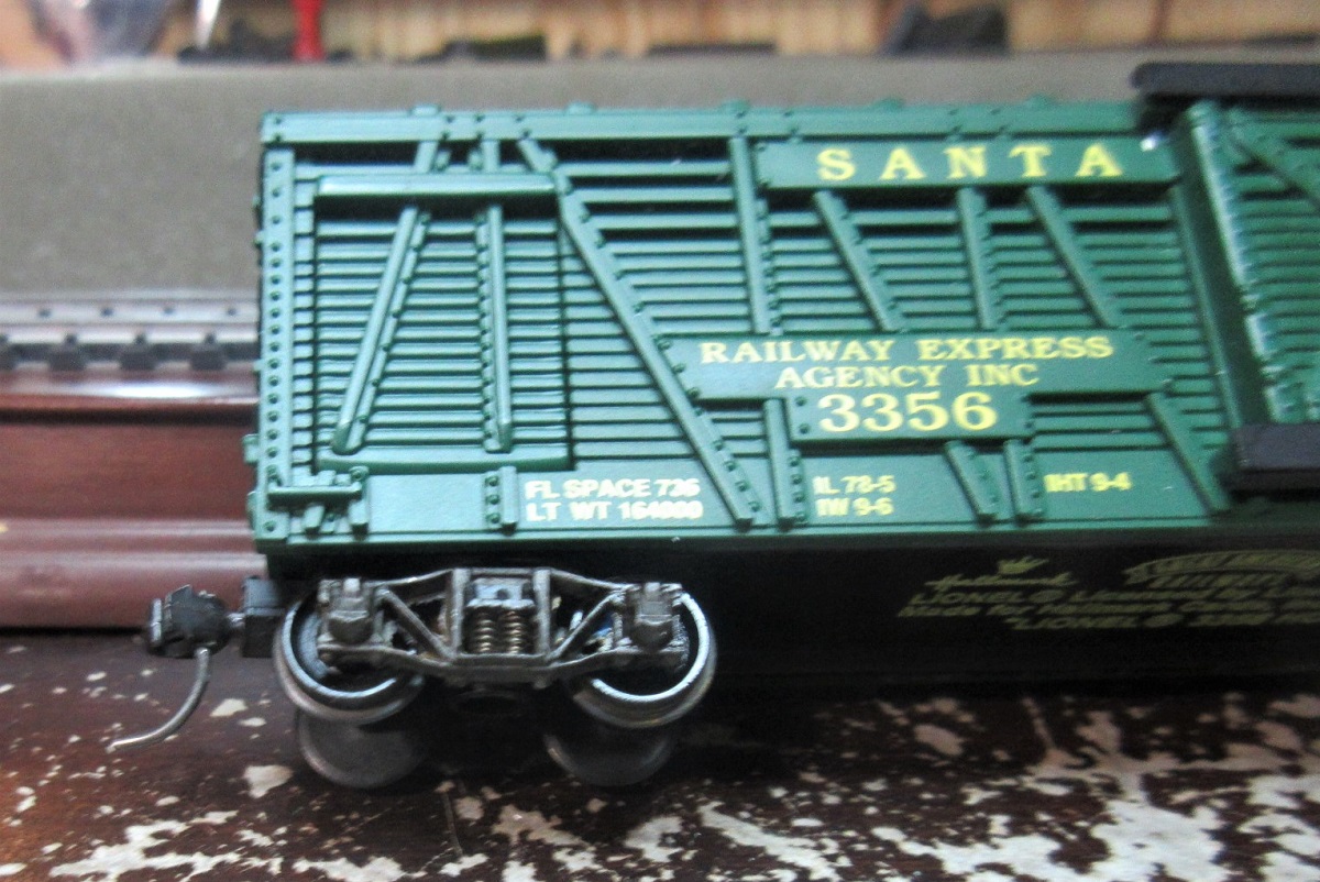

View 2, Bottom view of original trucks and couplers.
View 3 replaced trucks and couplers. Trucks are now die-cast and spring Arch bar. Couplers are now KD's.
View 4 shows complete car with doors open.

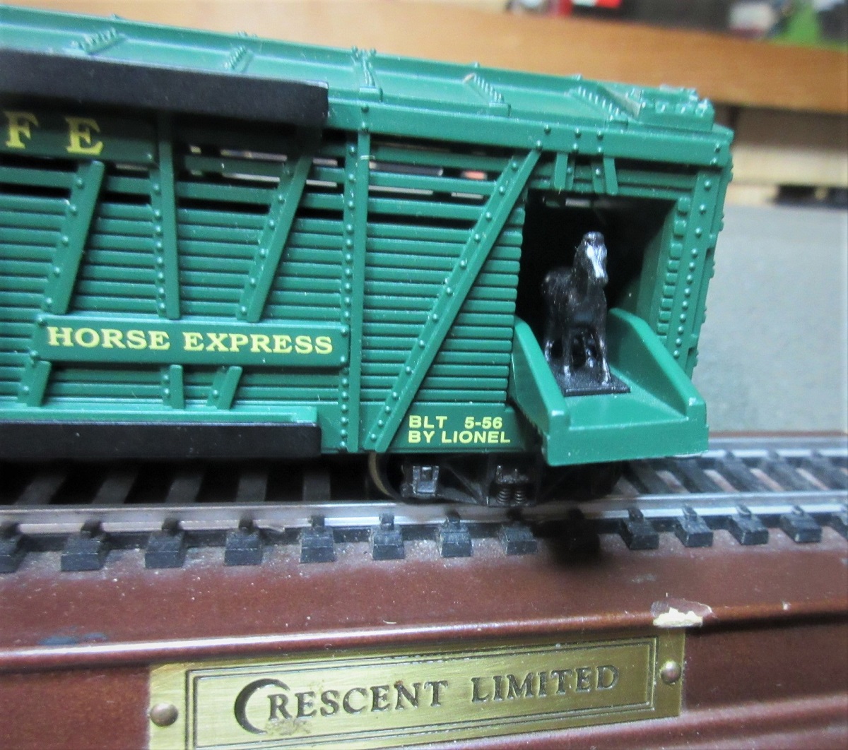

View 5 close up of open horse door.
View 6 final view of the completed car.
Edited by - toptrain on February 15 2018 7:30:10 PM

 Posted - February 15 2018 :  7:52:33 PM Link directly to this reply  Show Profile  Add Barry to Buddylist
I like that car Frank. Unique, with the different doors. Those original trucks are interesting. ?Are they replicas of what Lionel put on their early O and standard gauges? Did the car come with horses?
 Posted - February 15 2018 :  8:18:18 PM Link directly to this reply  Show Profile  Add Barry to Buddylist

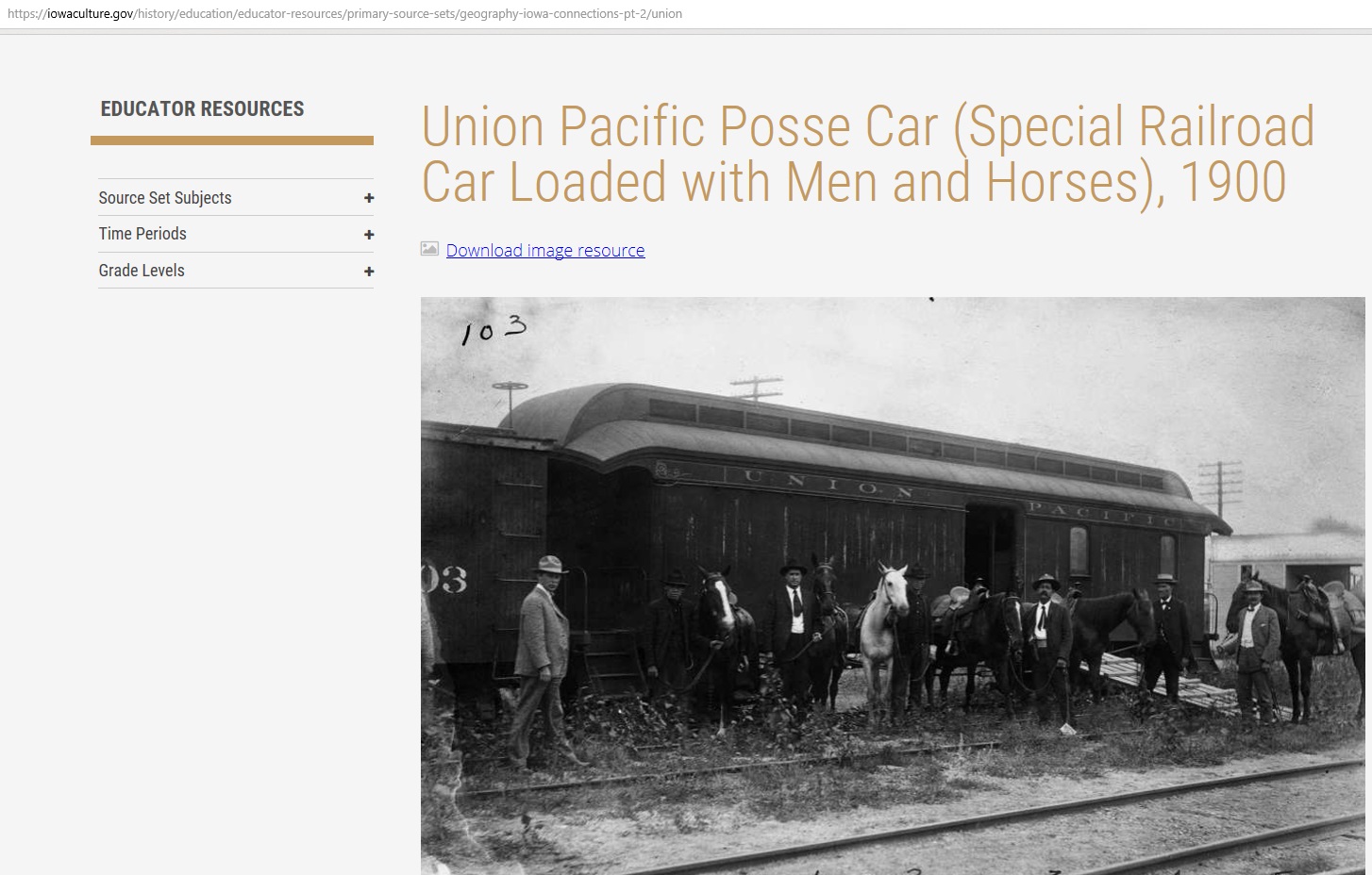

This car inspired me to look for images of horse cars and I found this one . . .
 Posted - February 15 2018 :  9:51:13 PM Link directly to this reply  Show Profile  Add RP model railroads to Buddylist
Very unique car, toptrain! Nice job replacing the couplers and bottom-trucks.
 Posted - February 16 2018 :  05:50:17 AM Link directly to this reply  Show Profile  Add toptrain to Buddylist
Originally posted by Barry - February 15 2018 :  7:52:33 PM
*Barry. The trucks aren't very useful for any gauge train I know of. The couplers are large dummy types. The car looks Ok now when it is run with other HO cars. The horses came with the car. It reminds me of a Lionel O gauge operating car that used a two-door system like this one has. Cows would go from a fenced in pen up one ramp into the car. Pass through the car, and go out and down the other ramp back into the pen.
* I do wonder if Hallmark made other cars of this type. A set meant to be displayed together.
Edited by - toptrain on February 16 2018 05:55:45 AM

* Well, another wrecked loco has joined my roster of junk loco's awaiting restoration.
* it will most definitely spend days on the workbench. The real damage to this model is here
in the smoke box and foiler front section. The cab damage is obvious and a slight
problem. I need some time for this repair. Tender trucks and a drawbar will be replaced.
Edited by - toptrain on March 12 2018 09:32:13 AM
 Posted - March 23 2018 :  7:42:51 PM Link directly to this reply  Show Profile  Add toptrain to Buddylist
** The 4-6-0 Reading camelback below posted on 3-12-18 has now been turned into this. And is awaiting a kitbashing rebuild. it is in need of a boiler repair and possible shortening.
Frank
Edited by - toptrain on March 23 2018 7:47:41 PM

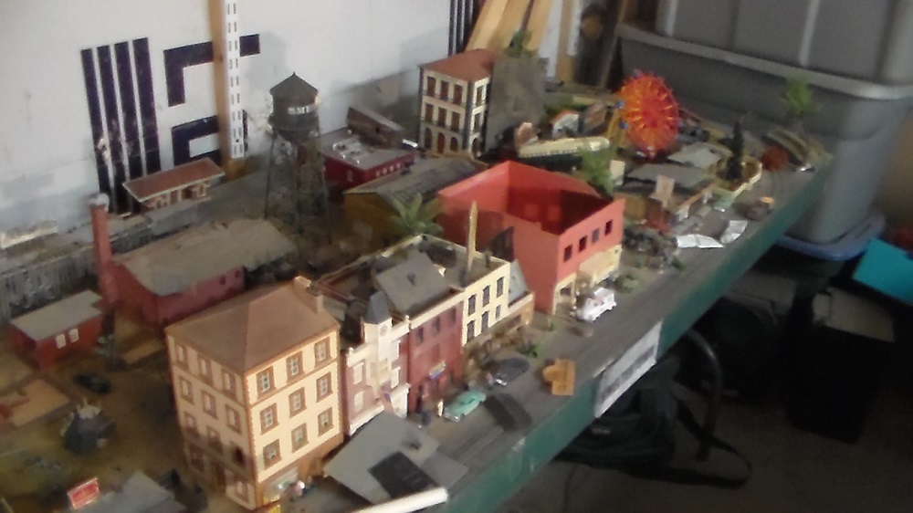

 Posted - March 28 2018 :  3:47:30 PM Link directly to this reply  Show Profile  Add Chops124 to Buddylist
This is a new way of "kit bashing." It is called "layout bashing," in this case courtesy of
Chopsticks the cat. What a mess. However, I don't think it will require more than a half
a dozen hours to piece it back together, and a pot of glue. I'd like to have it ready for
El Paso's "Street Car Days" coming up in May. El Paso is re-installing a short segment
of street car lines.

Rec'd this NIB vintage Hornby 4-6-0 via USPS with the left cylinder busted off. The package
was well packed and had plenty of dunnage to protect it, so someone at USPS really must
have pounded this antique.
I could get a refund, but hate the thought of this beautiful piece end up in the trash. Seems like a
simple repair, but I could not get the cylinder to mate with the frame- until I thought maybe it would
fit right if I globbed it up with Liquid Nails and put the assembly back into the original plastic
cradle, and that mostly worked- it is slightly out of line, here being reset, will test it tomorrow
and see if it works.
I love this old British stuff, it is built like old Lionel and has great color.
 Posted - April 04 2018 :  5:48:51 PM Link directly to this reply  Show Profile  Add Chops124 to Buddylist
Progress on the trolley rebuild, but some structures or so bashed that re-assembly
is not really an option, given what I can do.
Had to send the 4-6-0 back, after finally getting the broken cylinder to set up
for an overnight dry with JB Weld, come to find out it seems to be missing at
least a commutator brush.
Edited by - Chops124 on April 04 2018 5:50:29 PM
