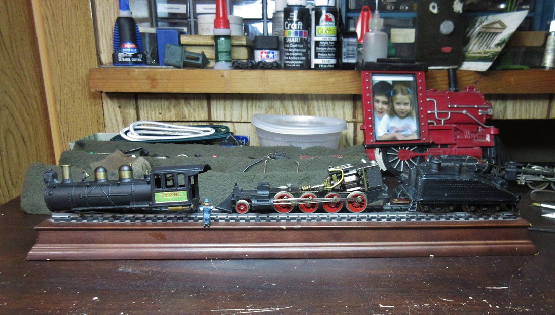

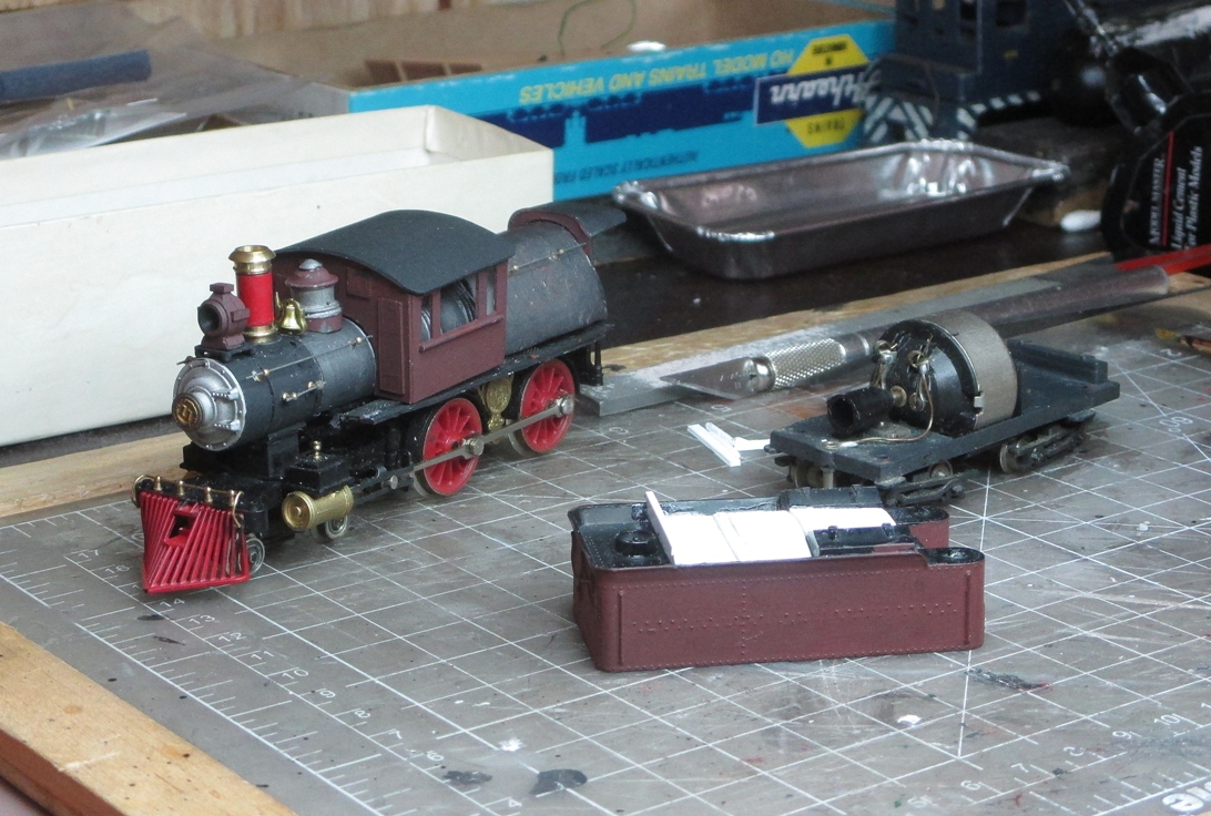

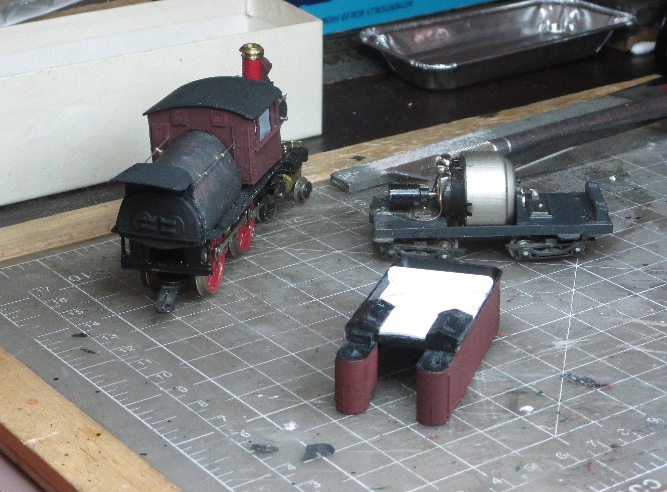

* Work bench has been taken over with the CRRofNJ 4-4-0 camelback project. You can see a up to date photo here. For a short while some Bachmann old time passenger cars were lettered and numbered for the Lehigh Valley.
Frank
 Posted - November 04 2014 :  3:17:02 PM Link directly to this reply  Show Profile  Add toptrain to Buddylist
A second view of the work bench today. I reversed the loco to show the backhead firedoors.

That camel back is really coming along nice. Can't wait to see it finished.
George
 Posted - November 05 2014 :  01:22:04 AM Link directly to this reply  Show Profile  Add Barry to Buddylist
That's looking quite nice Frank. Have you tried firing it up yet? I'm pretty ignorant of all the types of motors, but that one you have installed seems pretty hefty.
 Posted - November 05 2014 :  07:01:32 AM Link directly to this reply  Show Profile  Add toptrain to Buddylist
Barry Rivarossi used a tender location for the motor in this model. The motor in size is the same as a 4-6-2 had so it had plenty of torque and easily runs this small light loco.
If I haven't messed up the pickup it should work just fine.

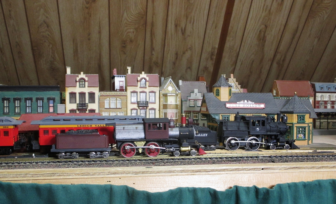

* Still more to do. Here is a comparison photo of the two small camelbacks. The CRRofNJ D4 is slightly longer.
* I need to start detailing the roof to give this locomotive it unique look.

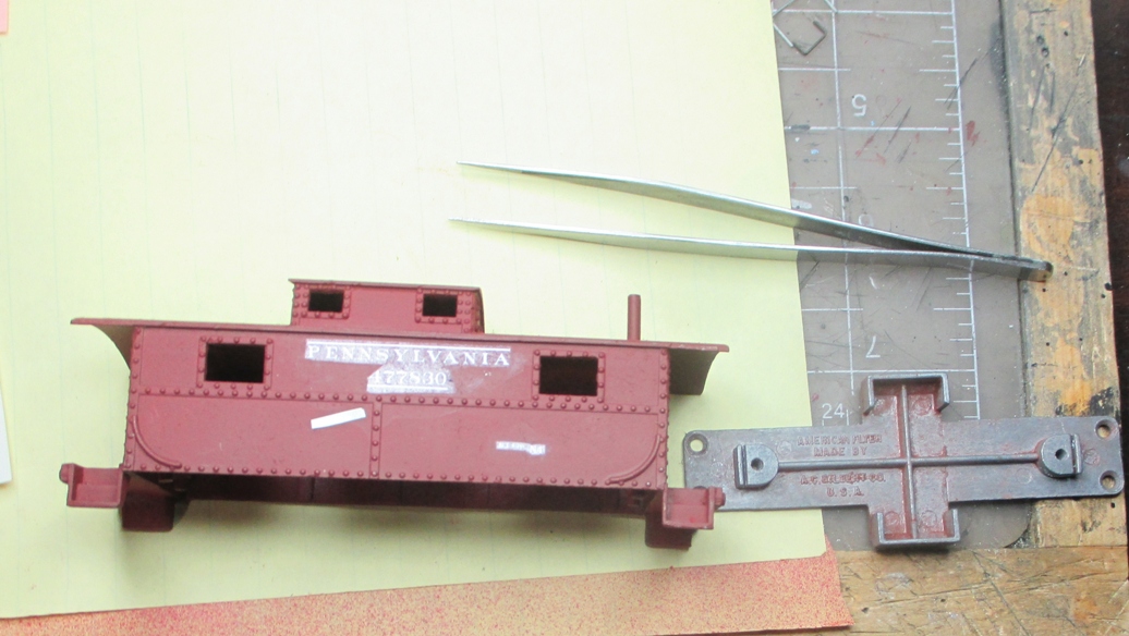

 Posted - March 29 2015 :  1:51:43 PM Link directly to this reply  Show Profile  Add toptrain to Buddylist
Here is what became of this old late 1940 Gilbert caboose. First it is older than any American Flyer S gauge anything. For Gilbert HO predates any gilbert S gauge made.
I don't know where I put the brass handrails for the end platforms.

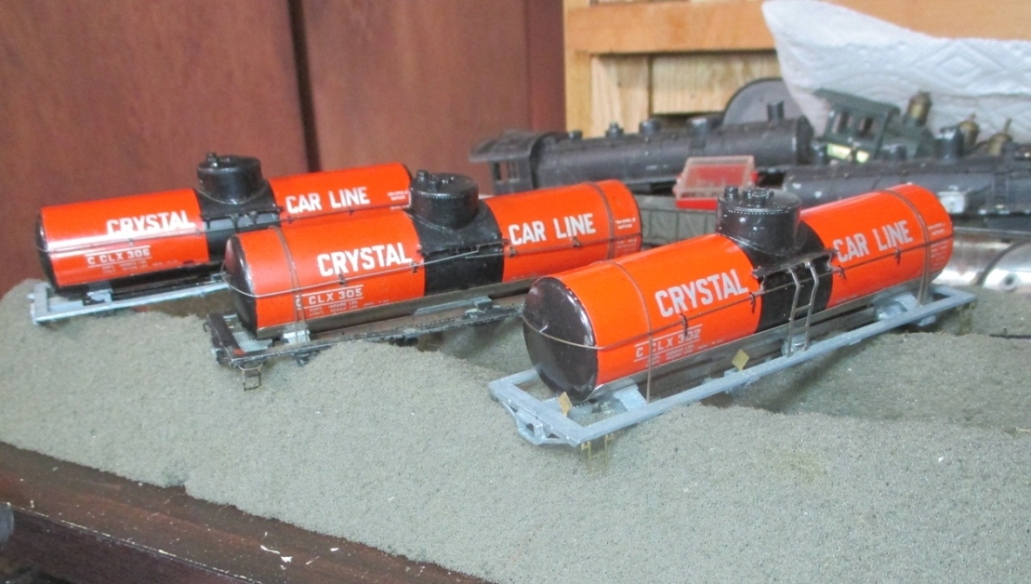

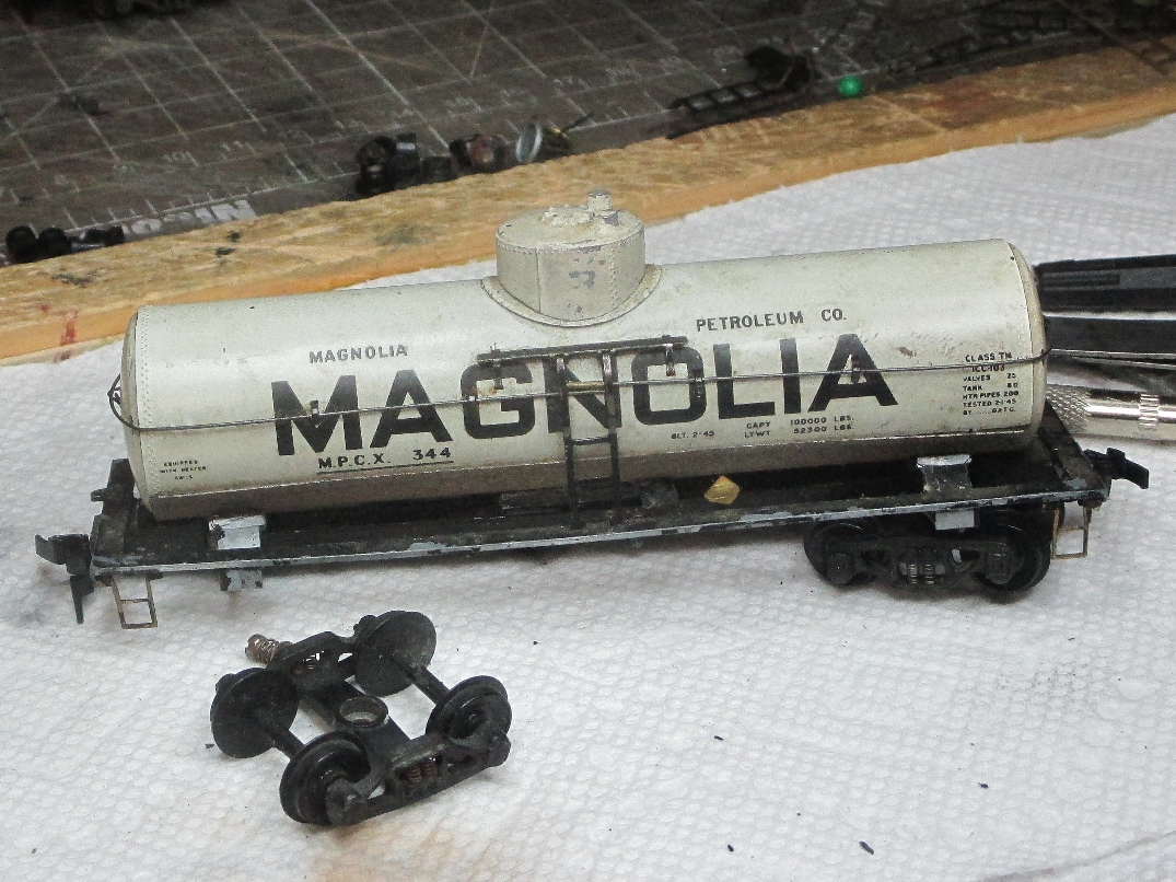

** When these Crystal are done this trio of Magnolia cars are next. MPCX 344, 345, and 349.

I am still struggling with Magnolia No. MPCX 244 and its bad frame. Last try had the frame come apart again and one end was raised high off of the track. Still going try to get this one back and running.
Edited by - toptrain on May 24 2015 11:18:06 AM
 Posted - May 24 2015 :  08:14:23 AM Link directly to this reply  Show Profile  Add JNXT 7707 to Buddylist
Frank - I know it needs work as you describe but the overall look of it is very realistic. Maybe it's the metal construction, they always seem to look better with age.

Connor, At Allentown great Lehigh Valley show I got these 8 tank cars. A plastic Varney Sinclair 38000. A Athearn 3 dome metal Deep Rock missing the frame. A Athearn metal Magnolia with a bad frame and no trucks. A Athearn 3 dome Union Tank car just needing couplers. A Gilbert Mobilgas 517 red tank car in good condition. A plastic Varney Koppers tank car in good condition. A Globe black Sinclair tank car in good condition only needed couplers. And a Globe Shell tank car in need of trucks and couplers. All were $2. each . This was at the merchants square mall great Lehigh valley train show. Don't you live around there.
* These cars show up not often, and not many, and most in need of work. Actually the other two Magnolia and three Crystal car line I picked up through the years and just never got around to building or fixing them until recently. The Athearn ones, the single dome, most I get missing parts, these have a lot of parts and are hard to assemble. The old globe ones have better frames and seem to last longer. The Silver Streak tank cars have been made for a long time so can be found as new kits in the box. These aren't all metal but have wood centers for their tank part. Only 5 different ones are made. The mantua ones are all metal except for the tank overlay which is printed heavy paper. I keep looking for old Red ball tank cars but have never found one. What is real hard to find is two dome tank cars. I only have 2. A brass international, and I think the other is a globe shippers express in black.

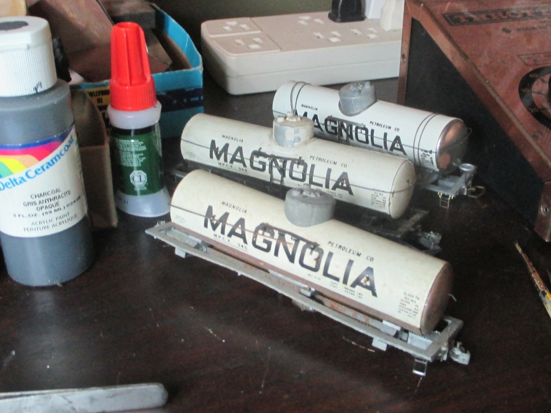

 Posted - May 27 2015 :  08:49:15 AM Link directly to this reply  Show Profile  Add toptrain to Buddylist

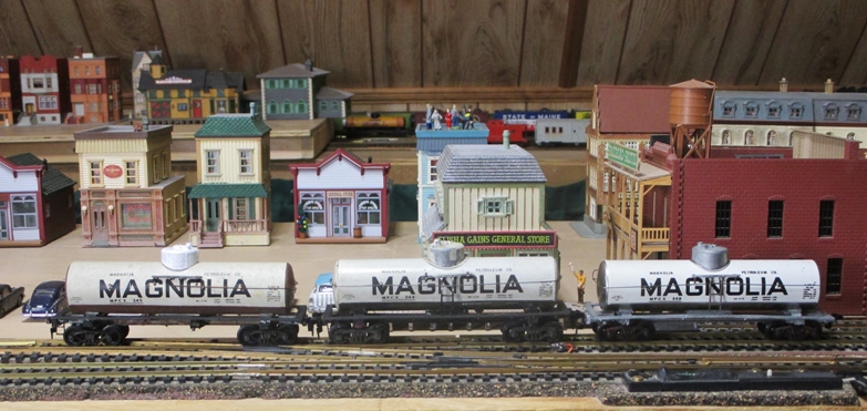

*** Here finally are the three Magnolia Petroleum Co. No. 244 is still a little higher on end then it should be but it is the best I can do. They are Athearn metal line cars from the 50's and early 1960's. They are factory painted but didn't come assembled. You did that. The diecast frames are a problem and many need replacement. Shelly use to make a metal frame that would fit. Bowser who made Shelly products no longer does it. I will be tring to use life like or Athearn plastic parts to fix these cars.
Edited by - toptrain on October 10 2016 08:06:54 AM
oldtimer52
0ldtime
 Posted - May 27 2015 :  09:13:02 AM Link directly to this reply  Show Profile  Add oldtimer52 to Buddylist
Nice set Frank. Didn't even notice the one end being higher until you mentioned it.

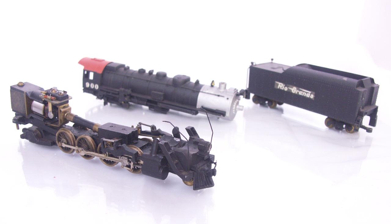

* A HO train Company 4-6-0 CNJ camelback is on the work bench and in need of some repairs. Once done it can go right to the layout and be run for awhile. Get the 4-6-0c fixed and the remaining 2 tank cars fixed are necessary to making space on the workbench to get back to the my Ashley shop building.

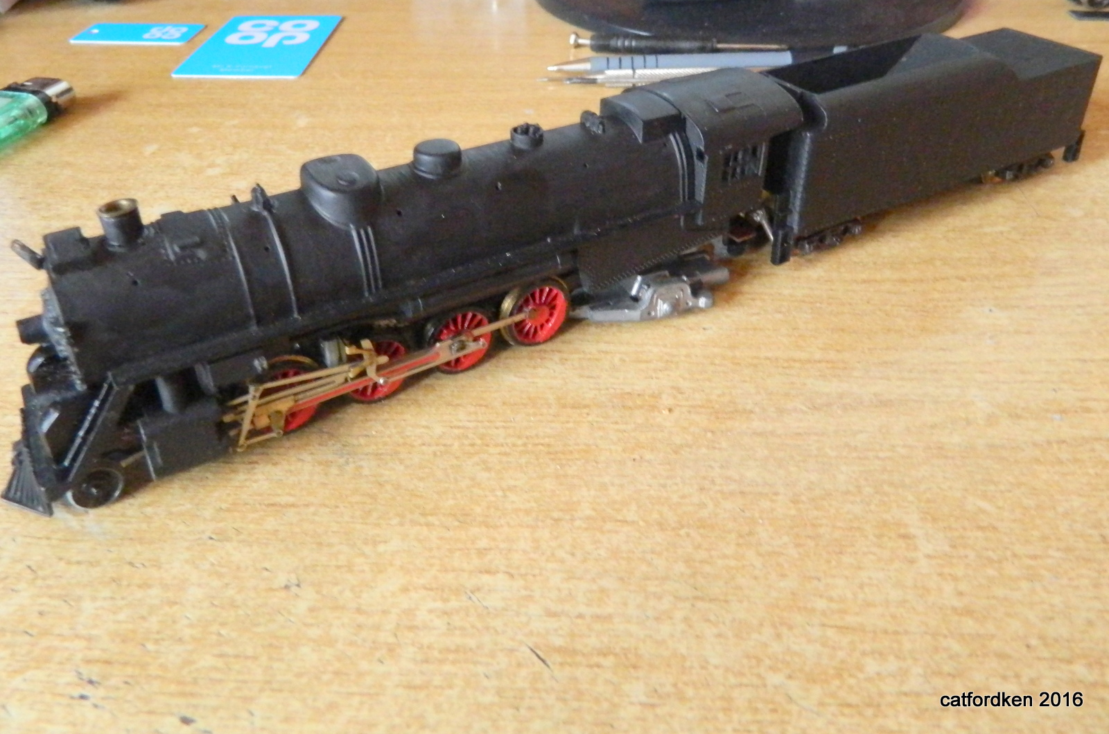

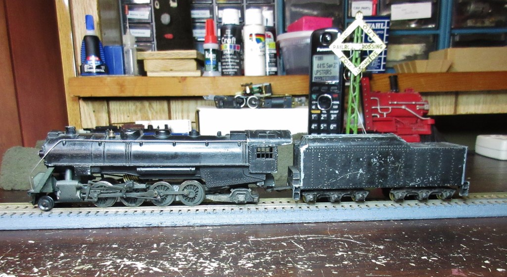

Well today on my workbench, watz goin on is a Rehabbing of a old Aristo Craft 2-8-0. The loco is getting a new tender and a good tune-up.
 Posted - July 24 2016 :  7:23:14 PM Link directly to this reply  Show Profile  Add Barry to Buddylist
Cool rig Frank. I'm looking forward to your restoration.
 Posted - July 24 2016 :  7:29:25 PM Link directly to this reply  Show Profile  Add Chops124 to Buddylist
This will be a topper!
 Posted - July 24 2016 :  7:32:26 PM Link directly to this reply  Show Profile  Add scsshaggy to Buddylist
That's a sweet looking engine. Admittedly, I have a soft spot in my head for 2-8-0's, but even without that bias, that would still be a real looker.
 Posted - July 25 2016 :  08:34:01 AM Link directly to this reply  Show Profile  Add toptrain to Buddylist
Hi guys ! well the 2-8-0 I got a few train shows ago at Maryland. No tender and no front axel. I had a new one spooked axel so that fixed one thing. I mated a old cast metal roundhouse tender to it. the 2-8-0 loco pick's up power from both tracks, and doesn't need tender pick-up. I oiled the motor shafts and turned it by hand to loosen it up . It felt like it was glued together. I kept turning it by hand it loosened to where when I put power to the brushes it would turn by the wheel track surfaces with coated to golden goop. Like it sat on a shelf and collected the goop over a bunch of years. Out came the emery paper and slowly it sanded off. Now it picks up power from the tracks and runs good.
I had some old rub on lettering for a Baltimore and Ohio tender so I rubbed it on and some went on, and some didn't. Maybe I should throw my old rub on decals because they really messed up the tender.
Well I'll have to be happy with a old 2-8-0 that runs good, and look bad for now.

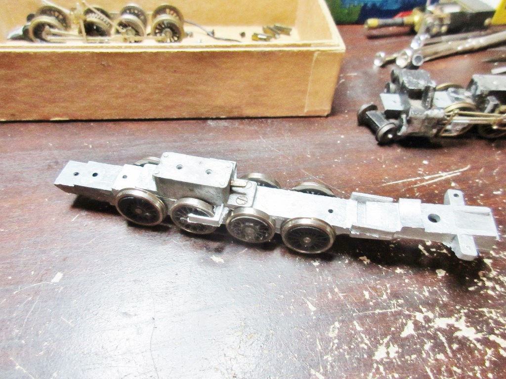

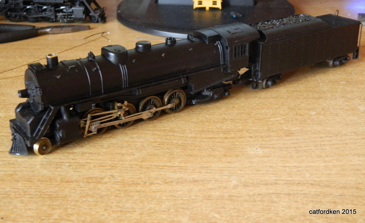

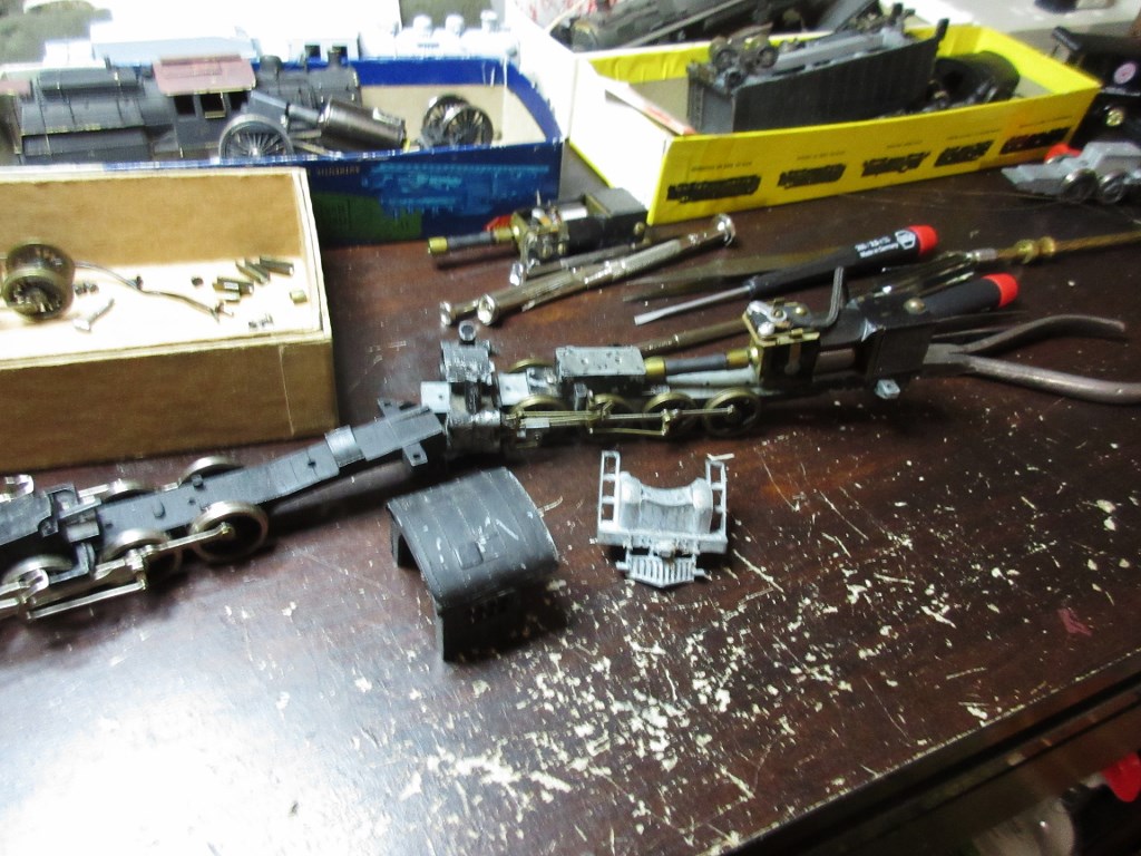

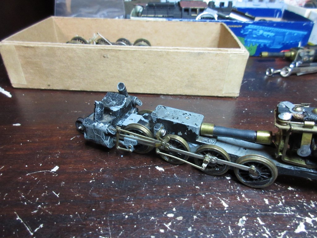

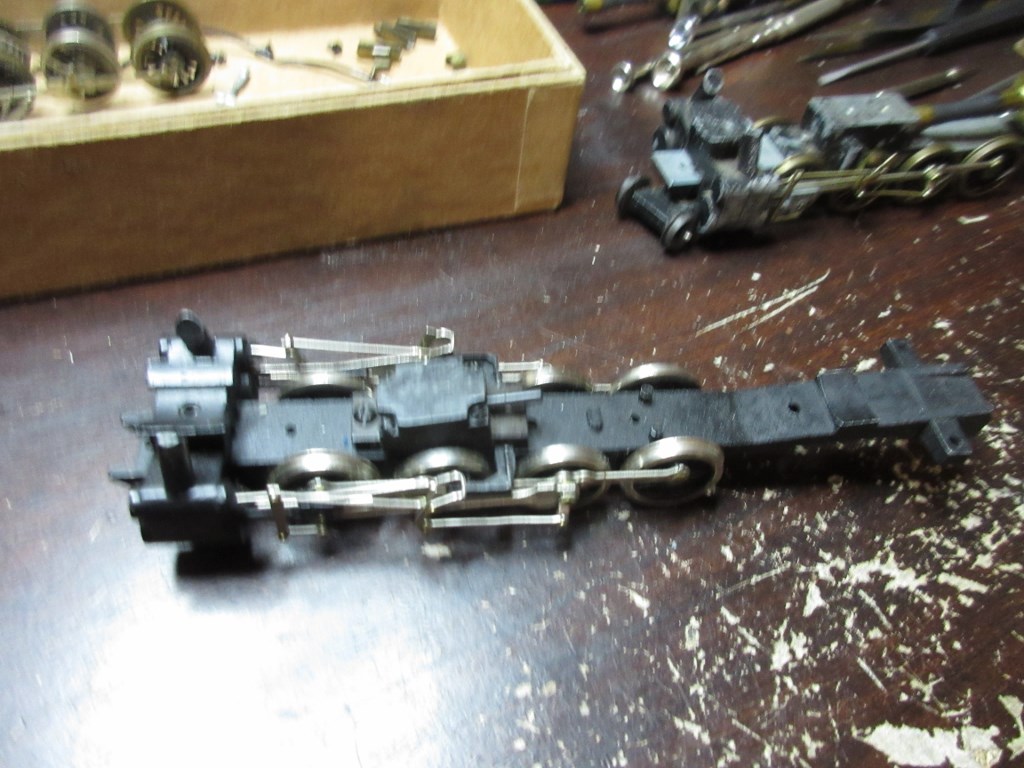

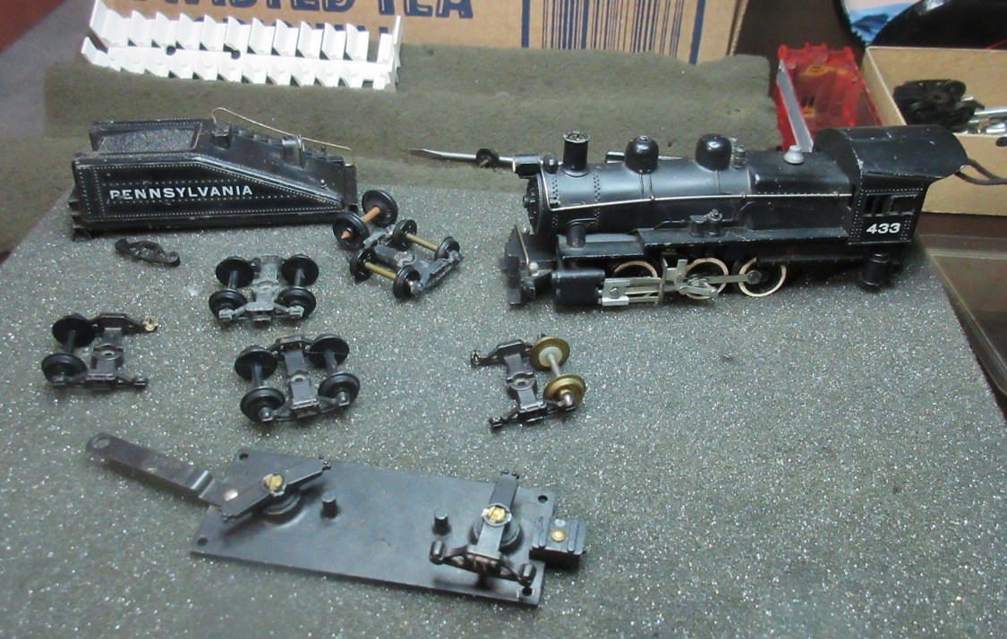

Yesterday I started on repairing a first rum Mantua Mikado. In what is considered as first run type Mikado drive most people don't realize there are 2 types. The first and oldest type drive. And then the second. Both use the same worm gear mounted in a cover. What is different about these first types is how the valve gears mounts to the drive. My friend Charlie gave me this project to do for him. Earlier he had given me some older Mikado drive parts that included parts to this first type Mantua Mikado.

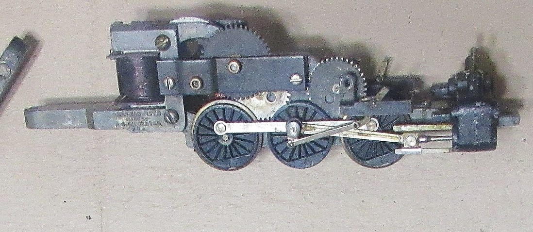

* I'll post some photos of 4 of the 5 different Mikado drives made.
* The first photo is the earliest version Mikado. The object of this repair is seen here.
Sorry about any poor photos.
* This version uses a valve hanger that must be screw mounted to a extension on the cover plate. Only this version uses this method of holding the valve gear in place.
This side shows a missing main rod wich still need to be raplaced. added 9-21-16
Edited by - toptrain on September 21 2016 08:32:27 AM
 Posted - September 20 2016 :  09:25:56 AM Link directly to this reply  Show Profile  Add toptrain to Buddylist

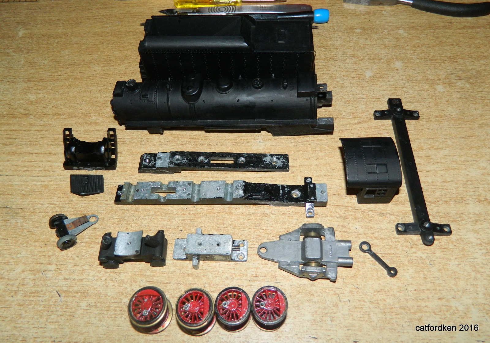

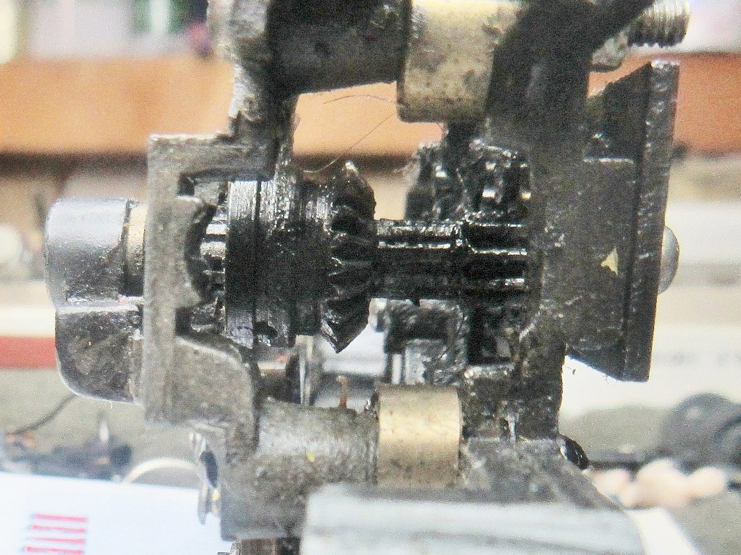

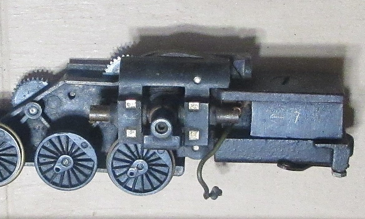

Here is the second and another old style Mikado drive for the all metal version. It is just a new frame with new style valve gear hangers showing cast on to frame. This style valve gear hanger will remain the same right up to the newest mikado's made.
 Posted - September 20 2016 :  09:35:03 AM Link directly to this reply  Show Profile  Add toptrain to Buddylist
* The third is the most common and used with mainly the plastic bodied tender, loco cab and pilot. This type had a motor mounted worm gear on the motor which directly drove the geared main driver. This is the most and longest produced version of the Mikado.
* The difference between this one and the forth version is in the forth Tyco stopped using brass bearings on the frame for the drive axels. A cost cutting measure. I have none of this forth type which didn't last long in production and Mantua returned to the third type with bearings.
Edited by - toptrain on September 20 2016 09:38:43 AM
 Posted - September 20 2016 :  09:47:47 AM Link directly to this reply  Show Profile  Add toptrain to Buddylist
Next comes the fifth and final drive for the Mikado to date. This was an improved drive made by Mantua just before Mantua went out of business and was replaced by Mantua Classics, made by Model Power. This drive went back to the covered worm gear mounted into the frame like the original but different. Mantua classics also used this new drive. Now MRC is now making the Mantua line. I have none of their Mikado's to show. I don't even know if the new Mikado has been released yet.
Edited by - toptrain on September 20 2016 10:00:37 AM
 Posted - September 20 2016 :  09:54:54 AM Link directly to this reply  Show Profile  Add toptrain to Buddylist

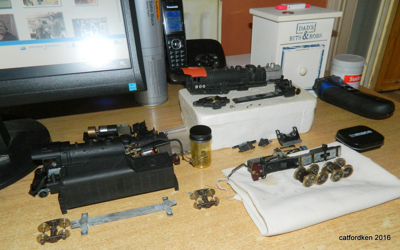

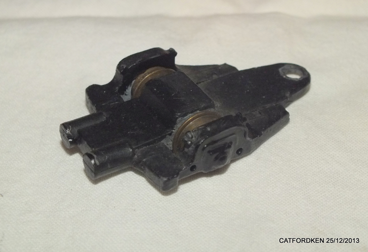

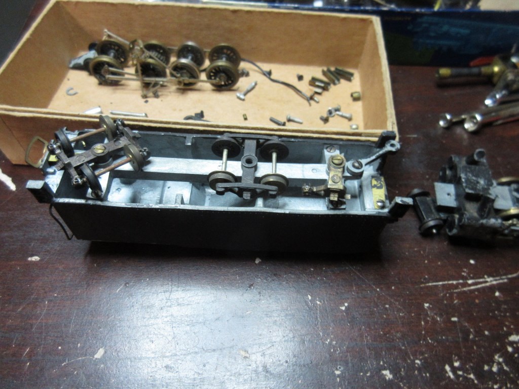

Now a part of this repair is the replacement of a broken original tender truck with one from my Mantua parts box.
* In this photo can be seen the broken truck with the replacement truck siting on the center of the tender frame.
* Here is another photo of the first type drive and the last drive together.

 Posted - September 20 2016 :  10:44:49 PM Link directly to this reply  Show Profile  Add scsshaggy to Buddylist
I remember (and have installed) the 810 retrofit kit, which was an open-frame motor much like the one in the first drive and a gear box like the one in the last drive. Those are sweet runners.
This restoration looks like it'll be interesting. Please keep us posted.
 Posted - September 21 2016 :  07:53:19 AM Link directly to this reply  Show Profile  Add toptrain to Buddylist

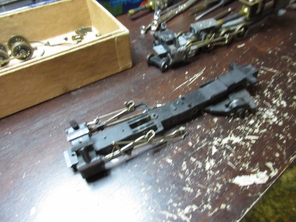

I Saggy! I am trying to get this loco back to as close to original as possible. I had 2 frames and both were no good. I had to use a second type frame and cut off the L shaped valve gear hangers. Now my frame with the good worm gear cover will mount correctly. I have to replace 5 rivets on the valve gear. Still one to go. I have a big problem with the #6375 main rod shoulder bearings. Both of them have been distorted, collapsed, and basically worn out. Need to make new ones. I hope I got some proper size brass tubing. I hope to salvage the hex head 0-80 X 1/4' main rod screws, for the brass sleeve of the shoulder bearings wont allow the screw to come out of it.
* Did anyone know that mantua made 2 different all metal tenders for the Mikado. One is shorter that the other. I think the shorter one is the original. The longer one use later on.

 Posted - September 28 2016 :  6:07:16 PM Link directly to this reply  Show Profile  Send catfordken a Yahoo! Message  Add catfordken to Buddylist

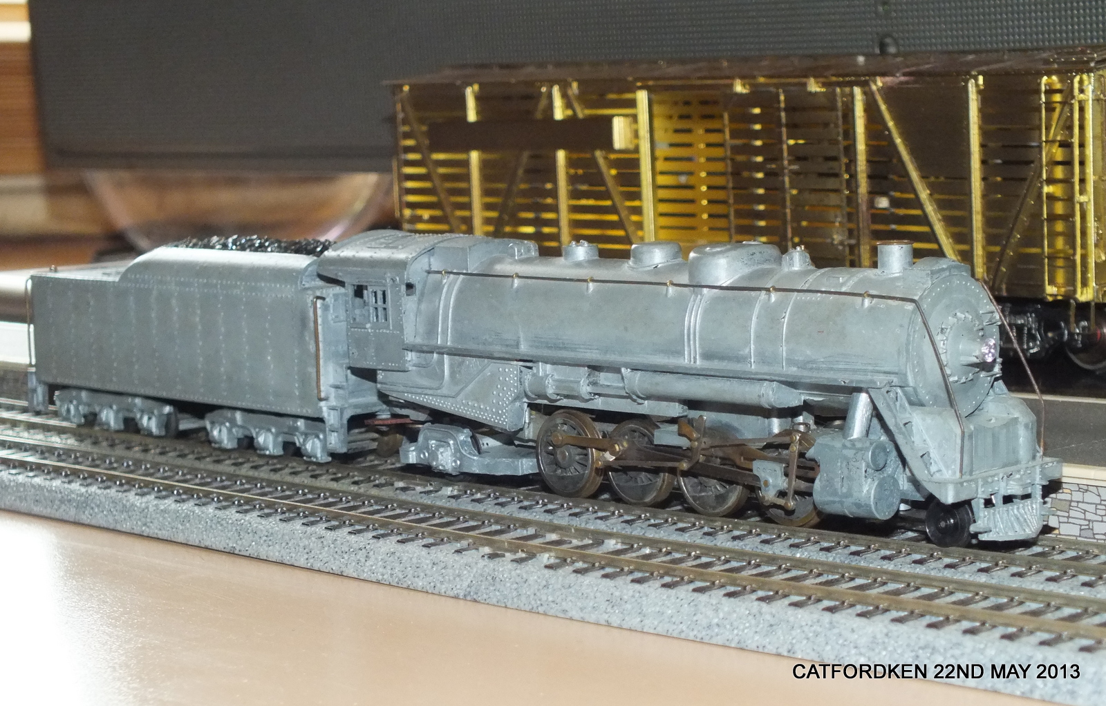

my 3 early mikados,ken
1949,all metal,4 wheel trucks on tender,powered trailing truck on loco,awaiting handrails to be made,real coal,front truck is diecast with built in spring
1952 no coal load other than what i added myself,6 wheel trucks on tender,no frame to tender,and front truck is pressed steel with separate spring and modified chassis to take modified valve gear
1949 this first issue one awaiting repair,again with powered trailing truck,no coal load
the 49 issues also had a 2 peice pilot
Edited by - catfordken on October 10 2016 09:58:21 AM

Hi ken, nice mikes. The panted one is the original. The unpainted one is the second one made. It is still all metal but has the newer way and parts for supporting the valve gear, as well as the newer style pilot. The second way is what I am trying to do. The first type is just to hard to find. I like the second because it shares valve gear and hangers with almost all the others made.
* thanks for the photos.

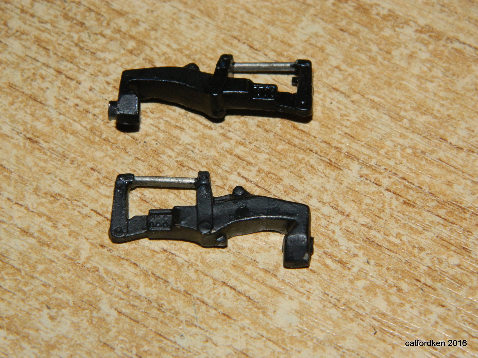

 Posted - October 01 2016 :  11:12:29 AM Link directly to this reply  Show Profile  Send catfordken a Yahoo! Message  Add catfordken to Buddylist
apart from the open frame tender,4 wheel trucks,no coal load,the 1st version had a powered truck,as seen in photo,ken
these were on the one for repair,looked odd so removed them
Edited by - catfordken on October 01 2016 12:38:08 PM
 Posted - October 10 2016 :  08:28:03 AM Link directly to this reply  Show Profile  Add toptrain to Buddylist
Very good info Ken, just you missed the Die cast framed front pilot truck that was used on the early all metal mikado's. They would soon be replaced with the steel framed, longer front pilot truck, that is still in use today. I wound up as well as putting together one Mikado for a friend, and one for my self. This is the one I did for me. Charlie's one I never took a photo of only a movie of it running. He has it now.

You said the frames commonly went bad. I feel like this is something you could remake in CAD or some kind of modelling program, and then 3d print a replacement.

 Posted - October 15 2016 :  06:34:38 AM Link directly to this reply  Show Profile  Send catfordken a Yahoo! Message  Add catfordken to Buddylist
my latest 1949 version,as was and in stage for stripping back to all metal body,ken
now have 2 49ers on the go,plus athearn hustler conversion
 Posted - October 17 2016 :  09:03:46 AM Link directly to this reply  Show Profile  Add toptrain to Buddylist
Kenny ; Very nice work as always. Those Mantua Mikes have always been a favorite with me. Lots of wheels. Lots of weight. Lots of power. A great combination that makes a great locomotive.

"Watz Goin on". Gilbert #200 AC Hudson's, and converting them to DC operation.
* * Concerning the Gilbert #200 Hudson. The first one's were made in the second half of the 1930. It was like a lot of electric toy trains of the period, made with a low voltage AC drive. The 110 volt AC drives were a little shocking to those who didn't really know what they had. Shortly after and during the time Gilbert had released #200, European manufactures were turning to DC drives. Gilbert following the trend, and did away with the AC drive and went to DC. Now many of these Gilbert Hudson AC owners, and there were a lot, wanted to run them with their newer trains. This need grew and small machine shops who owners may have been influenced by family members, or just had a few of the #200 Hudson's themselves, sat down and started work on ways to convert these locomotives to DC. From what I have seen and know now, two ways of thinking evolved to answerer this problem.
* * The first, just replace the field winding with a magnet. Problem is was you are keeping a armature winding designed to operate on AC with its style of brushes. As it turned out it worked OK. Being a overbuilt design it was able to handle the change.
* * The second a complete DC motor with the necessary gearing to allow power to be transferred 90 degrees to the original drive gearing. This is a little harder to do but the problem was just a mechanical one, and others in the past had answered this question, in a few different ways. I have one of each type of these drives. So now once I get them going again, I'll have 3 different # 200 Hudson's.
 Posted - October 17 2016 :  09:18:12 AM Link directly to this reply  Show Profile  Add toptrain to Buddylist
* * Got to start somewhere so here is a #200 AC drive.
 Posted - October 17 2016 :  09:20:23 AM Link directly to this reply  Show Profile  Add toptrain to Buddylist
This is the first way of thinking. "Just replace the Field winding with a Magnet.". Power from the tracks goes to the two original brushes.
Edited by - toptrain on October 17 2016 09:21:32 AM
 Posted - October 17 2016 :  09:31:33 AM Link directly to this reply  Show Profile  Add toptrain to Buddylist
* * Here is the second way.
* *First the motor package with angler gear. With matching one on shaft to original drive power transfers easily to drive.
* * Next a poor look into drive to see the other gear. The original rotating armature with its shaft were removed and replaced with this new shaft with gear.
Once completed another post will be made for each of the three #200 Hudson's.
