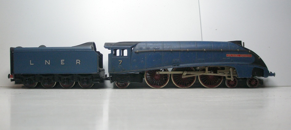

I haven't run anything yet. Plenty of time for that. I have replaced the body on the complete drive with the proper body. I will post of photo here of both the A4 #7 and the 0-6-0t.
frank opps ! about the Souther pacific. I am talking to Ken about that engine and a few others. Awaiting a offer, I think.
The locos name is Sir Nigle Gresley. He is the designer for the A4 locomotive.
The Peregrine body was gotten for its drive to go in the body. That completes this A4. The green body is spare awaiting a tender and maybe a drive. Someday a " Silver King " A4 will run again. ( tho most likely with a Mantua 4-6-2 drive.) The blue Peregrine body will be striped and repainted black with any A4 tender I can get. During WW2 the engines lost there colorful paint for very practical reasons. To hid their activities from Germans. It will be a war time A4.
* Also I may make this, the X-Peregrine, a 2-8-2 streamliner as one or a few were made and run. They used the same streamlining body style. All these good possibilities'

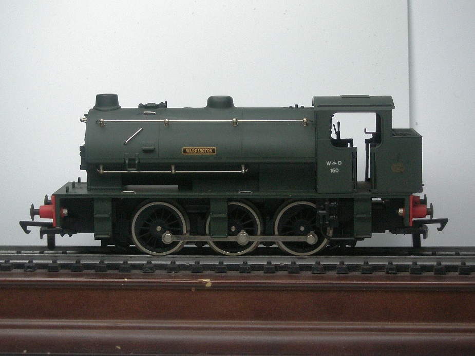

This is the Dapol 0-6-0t

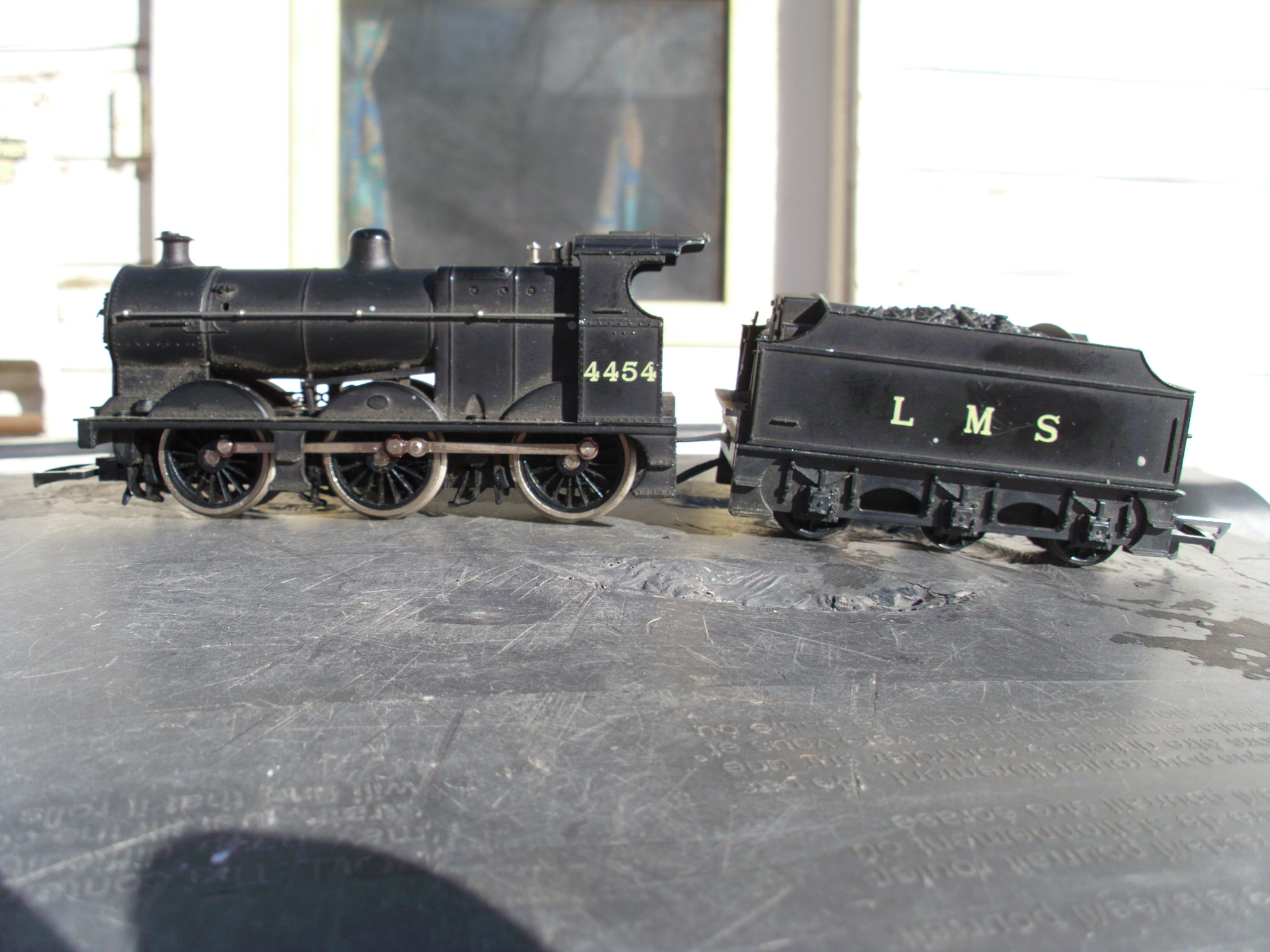

Neat locos Always did like British steam
I just picked up a Airflix L.M.S. 0-6-0 4F Foweler loco today

 Posted - October 20 2012 :  4:56:09 PM Link directly to this reply  Show Profile  Add microbusss to Buddylist
oh sorry, toptrain
Worst it needs is buffers & a hook for the front coupler
Edited by - microbusss on October 20 2012 4:56:52 PM

Looks nice Buss. show pictures of underneath to show how couplers attach. Alsothe front to show where and how buffers attach. it may help.
 Posted - October 20 2012 :  9:43:41 PM Link directly to this reply  Show Profile  Add toptrain to Buddylist
Hey buss if you keep it just add the couplers you use and run it with your old time locos.

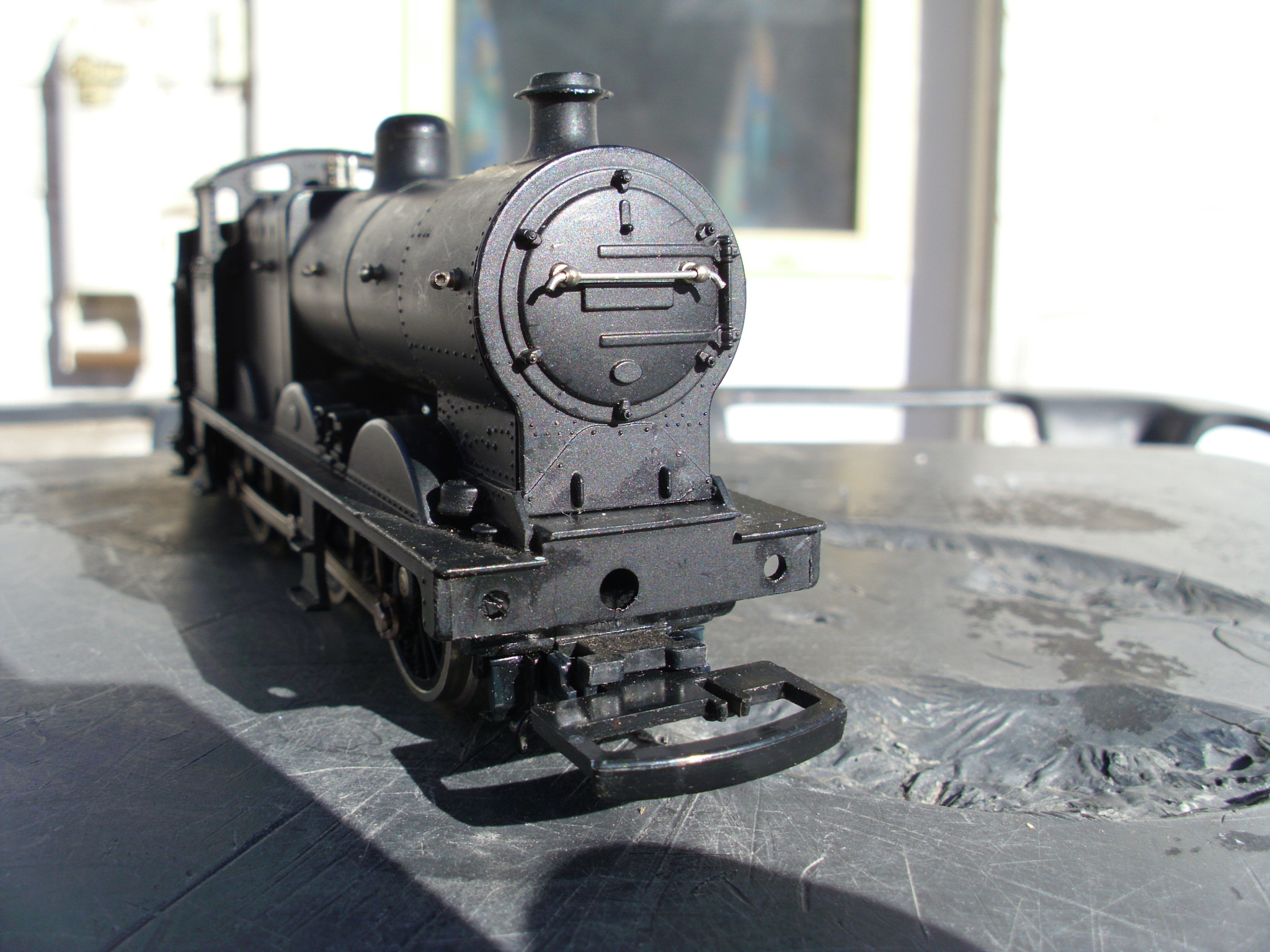

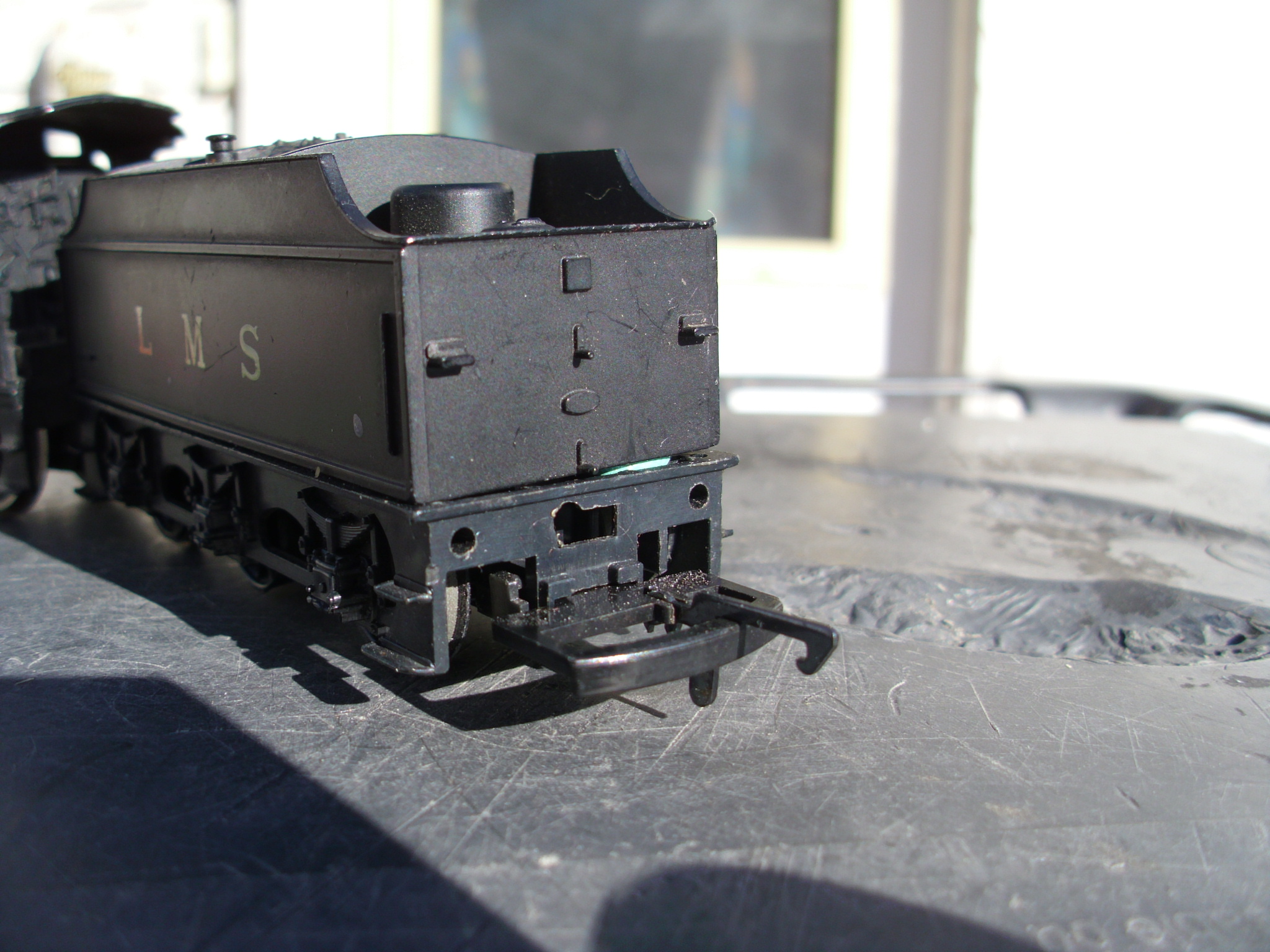

oh sure Good thing I took the pics earlier hehe (3rd time trying this!)
Front
Rear
On a side note whoever had this loco before has shaved the flanges on the middle power tender's wheels!
Edited by - microbusss on October 21 2012 01:18:47 AM
 Posted - October 21 2012 :  01:51:54 AM Link directly to this reply  Show Profile  Click to see EM-1's MSN Messenger address  Send EM-1 a Yahoo! Message  Add EM-1 to Buddylist
NICE Ben! Prolly did the shaving to go around really sharp curves!
 Posted - October 21 2012 :  12:16:32 PM Link directly to this reply  Show Profile  Send catfordken a Yahoo! Message  Add catfordken to Buddylist

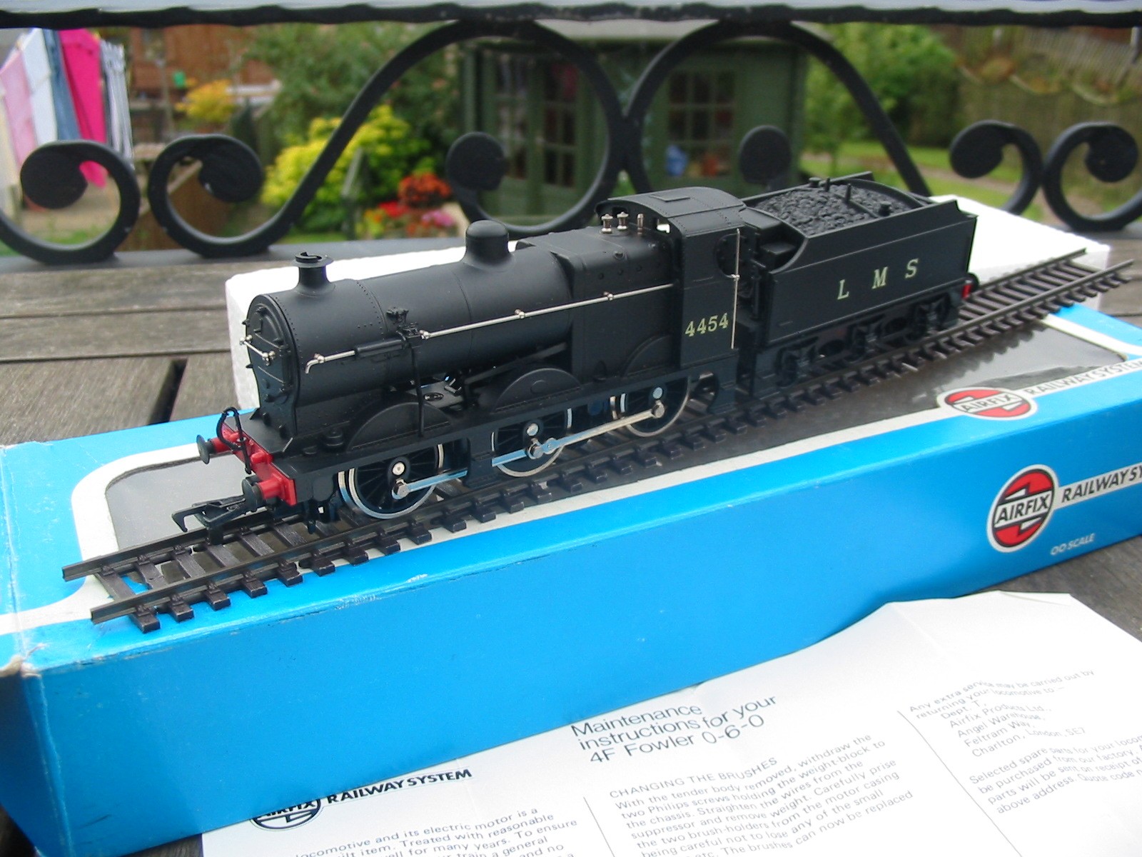

ben frank if i remember rightly,the buffer beams,the red bits,which are seperate castings,are missing ken
Edited by - catfordken on October 21 2012 12:19:32 PM
 Posted - October 21 2012 :  12:53:10 PM Link directly to this reply  Show Profile  Add toptrain to Buddylist
* Well in Kens photo Ben you are missing the Red buffer beam that you see on the front and rear of this engine with everything on it. Looks like you need to get some plastic and start replaceing the missing stuff.
 Posted - October 21 2012 :  1:17:11 PM Link directly to this reply  Show Profile  Add microbusss to Buddylist
SEE?? I knew the buffers were missing!!
Darn shame I can't get replacements
Looking at yours, ken it looks as if I have a older version of yours

Micro (Ben??) never say never, it just may be more difficult to aquire but NEVER impossible....whats the name of the engine in question, I bet I could find a source of parts if I tried hard enough, let me know and Ill give it a go in my free time :D

Airfix Railway System
4F Fowler
L.M.S. Livery
54122-6
OO scale
Thats what is on the end of box
 Posted - November 15 2012 :  09:58:01 AM Link directly to this reply  Show Profile  Add microbusss to Buddylist
catfordken - Well it looks like I'm also missing the Grab Irons too
Oh well Still worth the $35

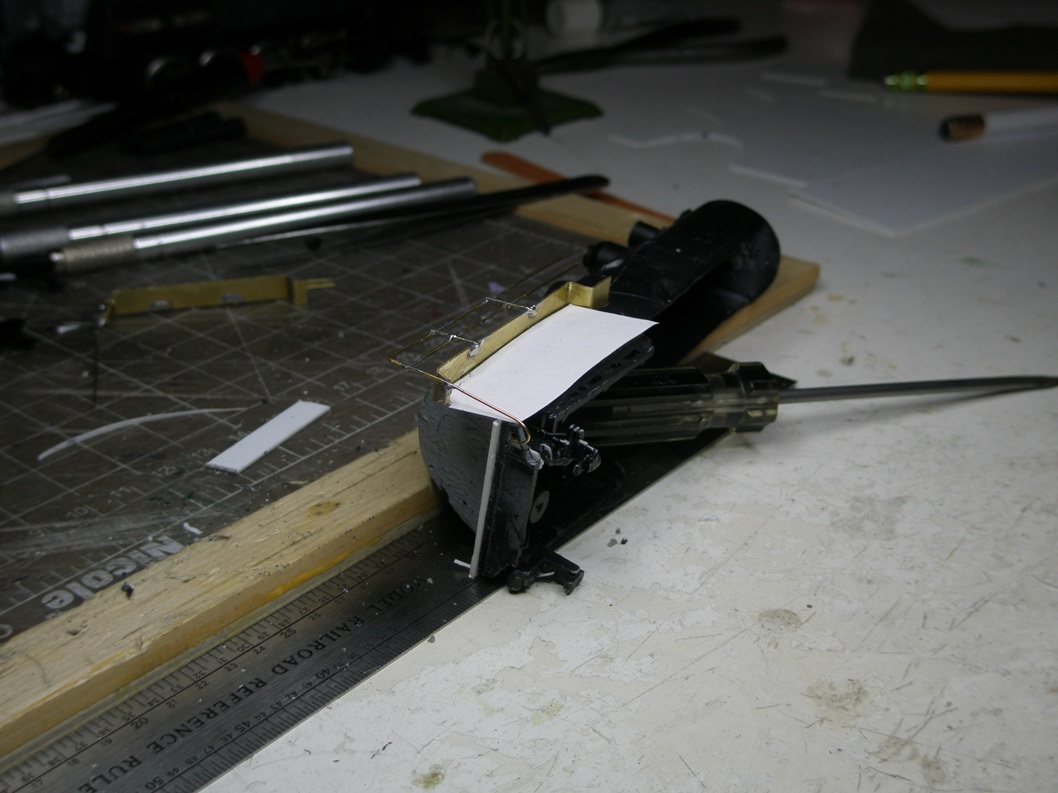

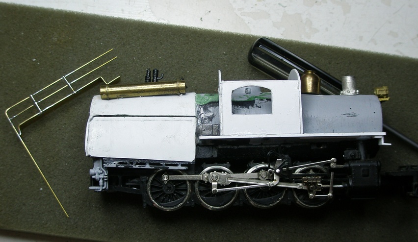

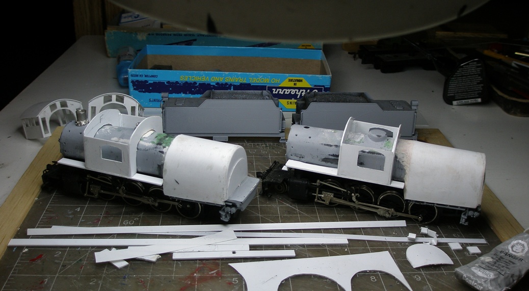

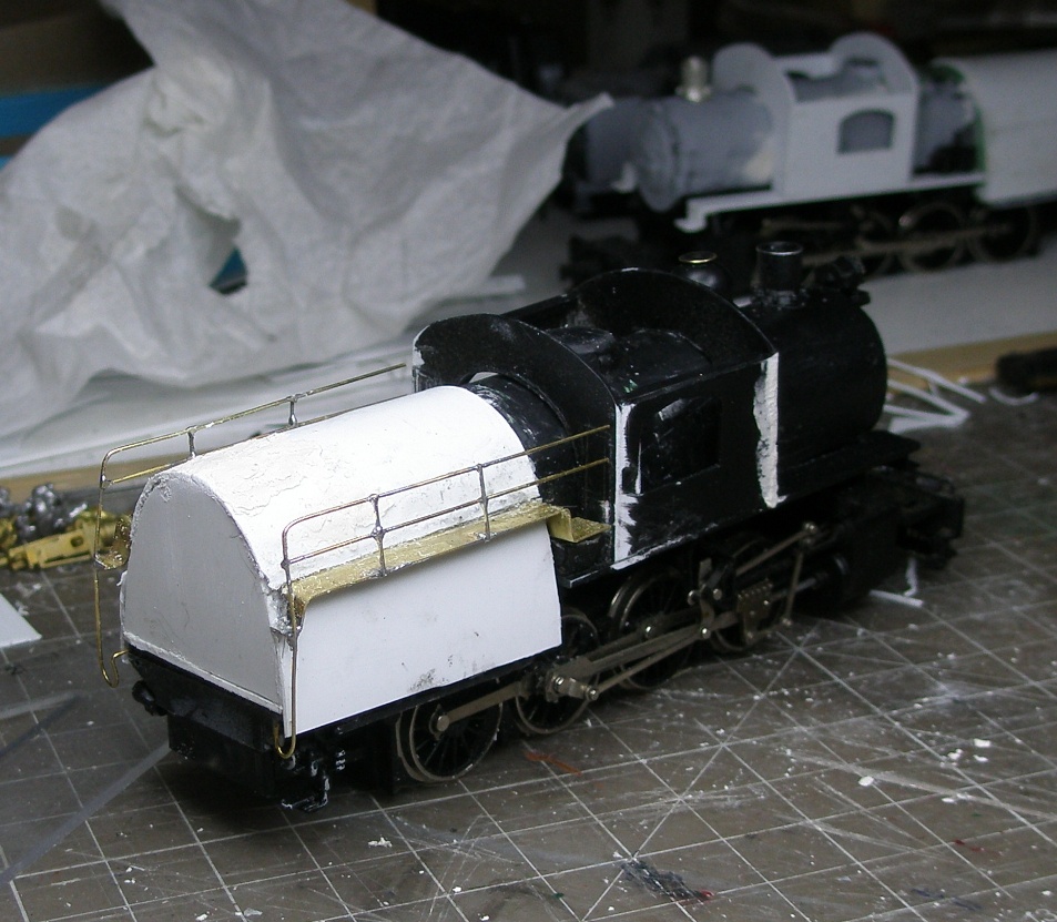

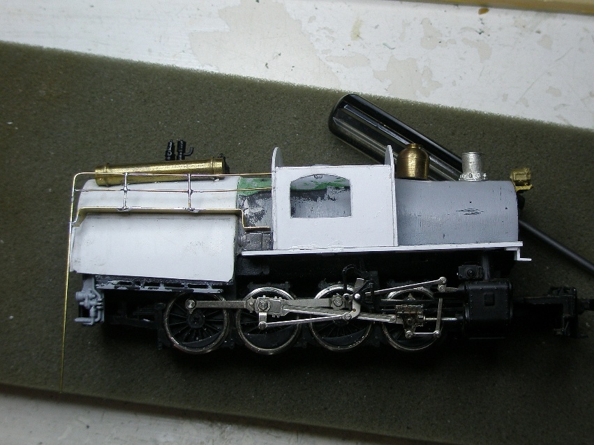

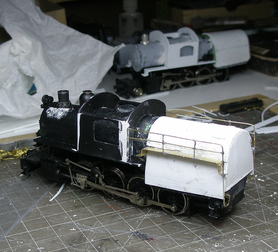

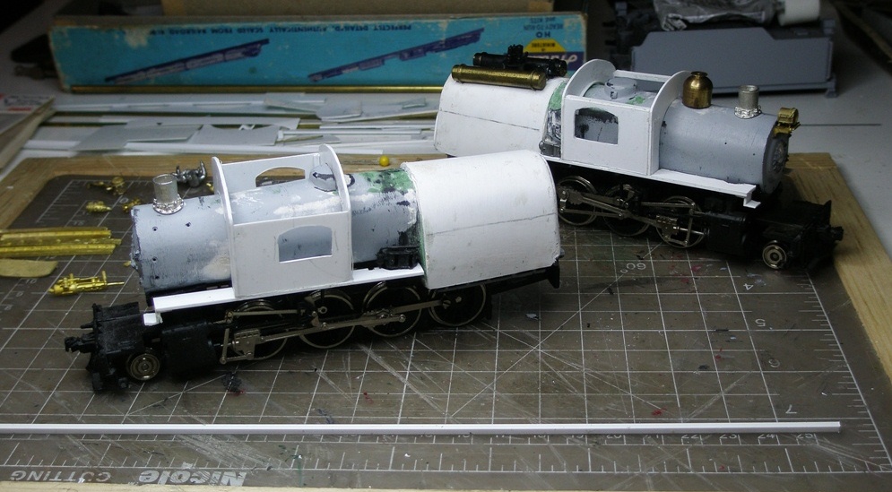

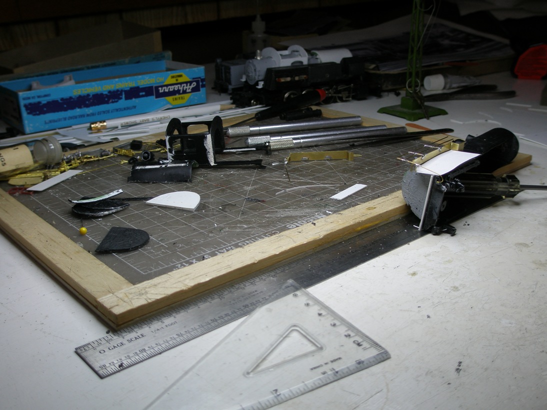

** A project I have been doing for the last 6 months, I have revitalized and gotten going again. It started as kitbashing 2 Bachmann 2-8-0s into 2 Reading camelback 2-8-0s. well I changed the road name and restyled the locomotive bodies and now it is progressing nicely.
* Project has become the building of 2 CNJ Camelbacks. Both 2-8-0 I class. One is a I-5 and the other a I-4 class. I have gotten past the cab and firebox part and I am finishing up the basic firebox for the I-5. Lots and Lots to do yet.
what they look like now on the workbench.
 Posted - January 25 2013 :  6:52:37 PM Link directly to this reply  Show Profile  Add Redwoods to Buddylist
You are a master of styrene construction! Nice work. Are the Bachmann drives stock or did you do any remotoring (just curious). - Thomas
 Posted - January 25 2013 :  8:10:53 PM Link directly to this reply  Show Profile  Add toptrain to Buddylist
Bachmann drives are just stock

* I just took this photo. I am a little further on in the project. The I-5 I worked on the most today and it shows.

Some work done today.
 Posted - January 29 2013 :  4:36:33 PM Link directly to this reply  Show Profile  Add Alco Fan to Buddylist
Frank,
Great progress. I admire your custom walkway with hand rails and the sheet plastic work.

well here I go again. I've pulled the firebox off. redoing the backhead.
 Posted - February 04 2013 :  7:15:04 PM Link directly to this reply  Show Profile  Send catfordken a Yahoo! Message  Add catfordken to Buddylist
frank as alco fan said love your walkway construction,cannot wait,but will have to,to see it finished ken
 Posted - February 04 2013 :  9:23:48 PM Link directly to this reply  Show Profile  Click to see DaCheez's MSN Messenger address  Add DaCheez to Buddylist
That's amazing what you're able to do with styrene. It's all looking great . What do you use for adhesive to glue the styrene together?
 Posted - February 05 2013 :  09:53:28 AM Link directly to this reply  Show Profile  Add toptrain to Buddylist
Originally posted by DaCheez - February 04 2013 :  9:23:48 PM
With plastic to plastic , just model glue.

* There I have stepped back again to do it right I hope. I pulled off the sheeting on the firebox. It became damaged when I screwed down the air tanks to tight. Also the walkways were not going in even. I will reshape a new lower piece from the walkway down. By coping the new piece before I glue it into place I will have the lower piece for the opposite side. This will assure that the walkways will be at the same height. All I got to do is do it. This is, as it has shown to be, easier said than done. My original trial and error way of stumbling through a project didn't work at all as you can tell. Let's see what happens this time.

** Now here is the workbench now !
** A close up of the I5 body with a paper template made for the 2 sides. That is right where and how I want the walkways to mount to the body. The new backhead lies on the cuting table. I got a little more done.
 Posted - February 05 2013 :  2:53:26 PM Link directly to this reply  Show Profile  Add microbusss to Buddylist
looking good I likes it
What's it gonna look like when done?
 Posted - February 06 2013 :  5:49:42 PM Link directly to this reply  Show Profile  Add toptrain to Buddylist
** Got to let it sit and harden. I'll sand it tomorrow, then fill and sand again.
