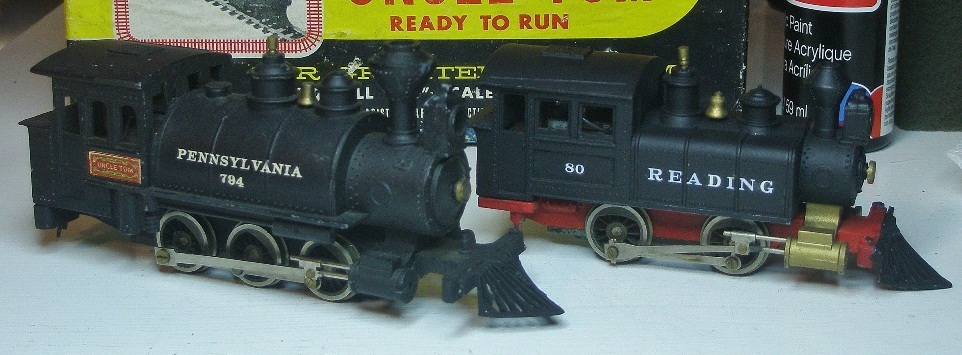

 Posted - February 27 2012 :  6:30:13 PM Link directly to this reply  Show Profile  Add toptrain to Buddylist
Another look at my 2 new switchers. I will most likely Remove the front cow catchers because as switchers they are useless without couplings on both ends. This second view shows the opposite side of the locos.

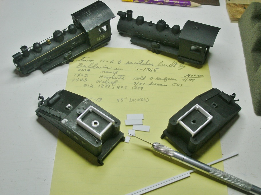

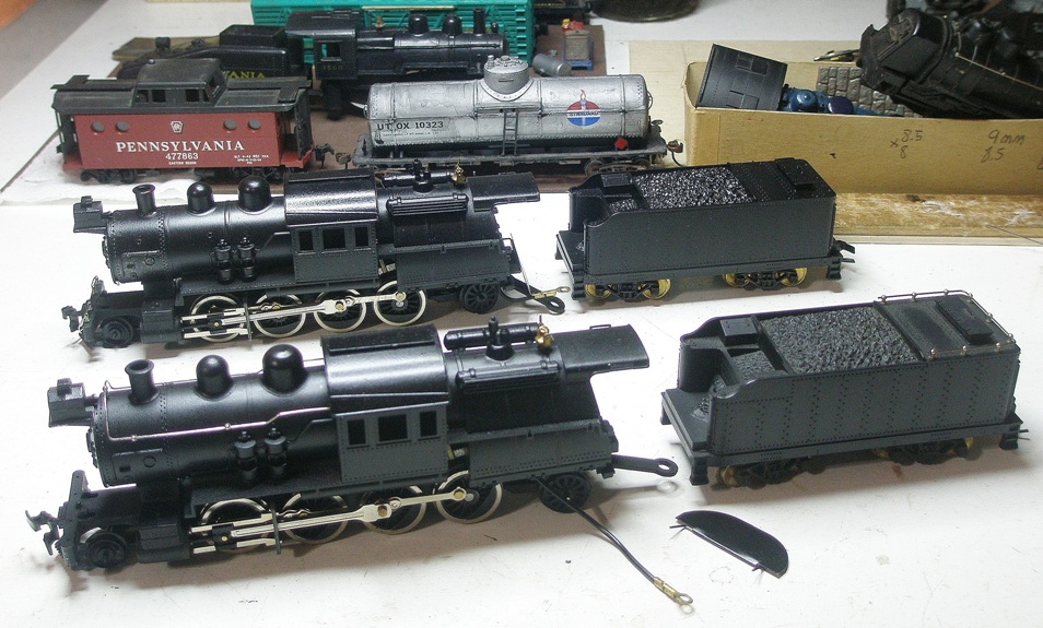

 Posted - March 09 2012 :  9:41:03 PM Link directly to this reply  Show Profile  Add toptrain to Buddylist

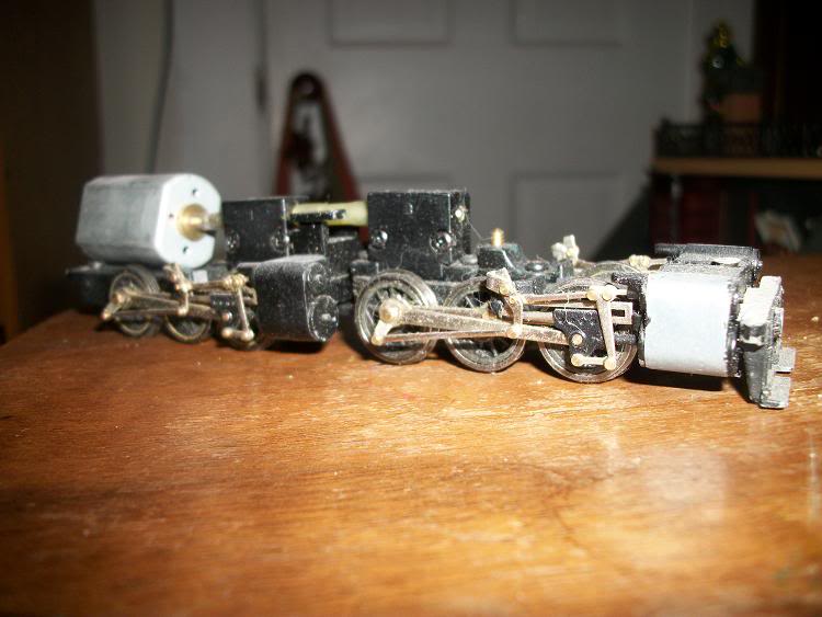

My 2 Roundhouse 0-6-0 switchers are on the work bench loco and tender bodys geting some work done. Anyone familiar with the models kmow them to be fueled by oil. I am changing them to coal. They will be CNJ 0-6-0s numbers 211 and 212. They were built by Baldwin and deleivered in July of 1865. They were disposed of before 1900. In my world they remained and were rebuilt and given steel cabs, dual sand boxes, and newer type slope back switching tenders. They remain 2 of the hard coal burners on the CRR 0f NJ. They have there original numbers.
* They were made and joined the roster back when locomotives were named. 211 was named Resolute. and 212 Relief.

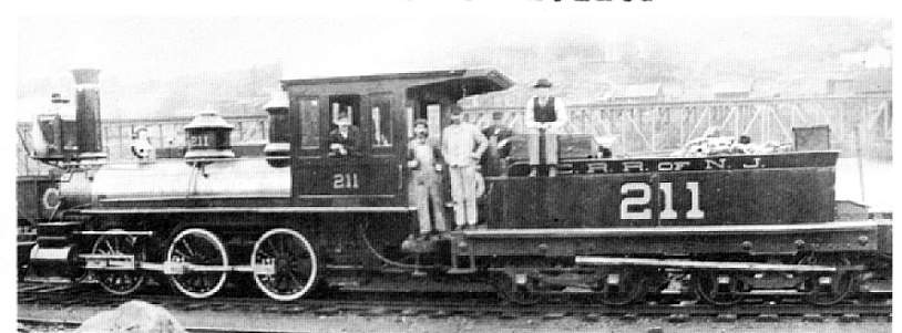

Here is a photo of #211, the locomotive resolute. from North East Rail. It is listed as not a part of any collection.

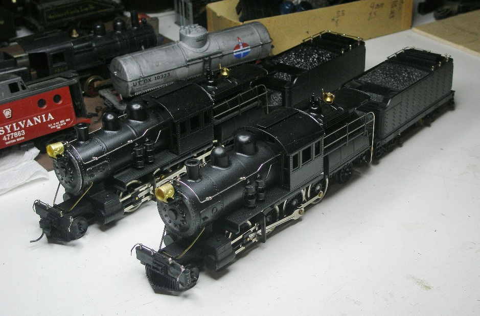

 Posted - March 15 2012 :  12:36:52 PM Link directly to this reply  Show Profile  Add toptrain to Buddylist

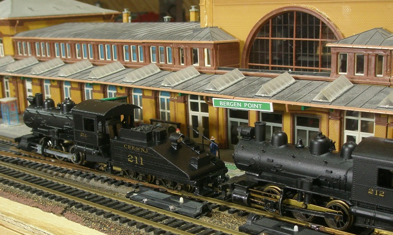

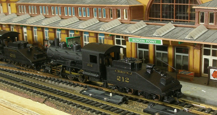

Here they are conpleted. CNJ # 211 and 212. Model Die Casting 0-6-0 switchers.
Edited by - toptrain on May 11 2012 7:26:41 PM
 Posted - March 15 2012 :  12:45:03 PM Link directly to this reply  Show Profile  Send catfordken a Yahoo! Message  Add catfordken to Buddylist
nice work yet again frank,will fit in very well with the rest ken

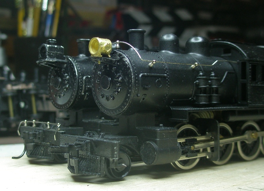

 Posted - March 23 2012 :  6:21:34 PM Link directly to this reply  Show Profile  Add toptrain to Buddylist
New headlights for the Mikes. Here is a comparison of the old next to the New.
Edited by - toptrain on May 11 2012 7:25:13 PM
 Posted - March 23 2012 :  8:02:51 PM Link directly to this reply  Show Profile  Add toptrain to Buddylist
The 2 camelback Mikados are built. I had to change the headlights.
Edited by - toptrain on May 11 2012 7:24:16 PM

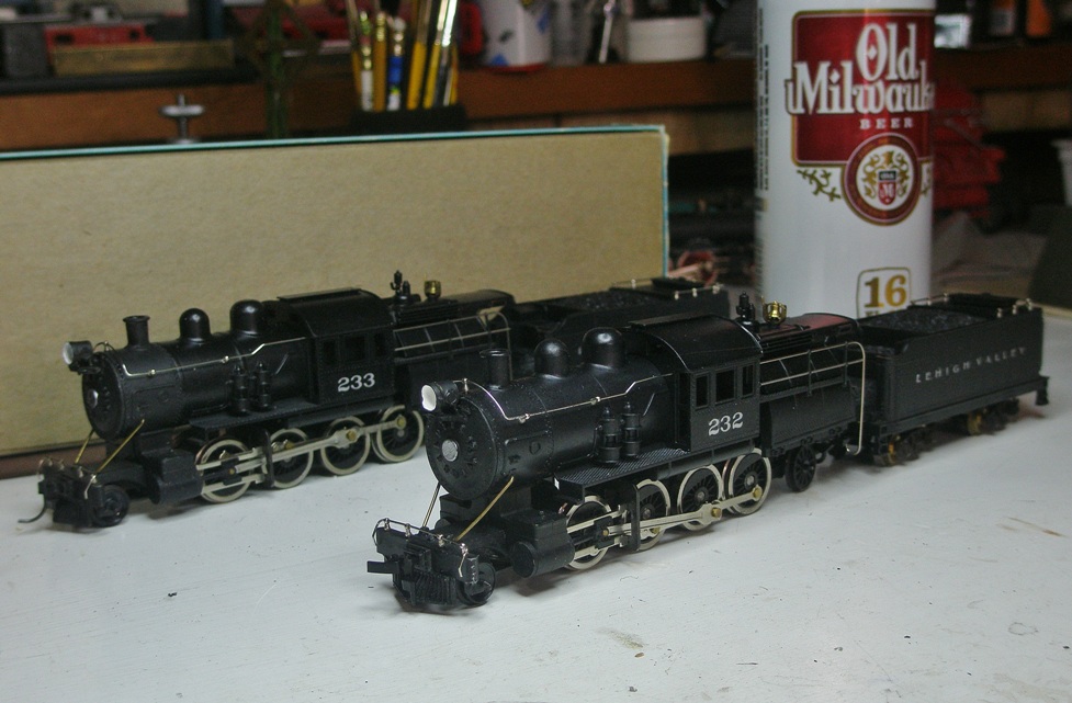

Well they Valley N1 class are done. I found I had a set Of valley steam decals. Just they are silver lettering. I think meant for a streamliner or newer steam. It was all I had so on they went. I think they show well. I didn't have to paint the handrails. There silver to and match.

Very handsome.
 Posted - March 25 2012 :  6:59:10 PM Link directly to this reply  Show Profile  Add toptrain to Buddylist
* You can view photos of these 2 Lehigh Valley class N1 locomotives, numbers 232 and 233 at North East Rail.
these are the real locomotives.
* Just click link below and look at N1 class. You will see the 2 numbers listed there.
http://www.northeast.railfan.net/lv_steam1.html

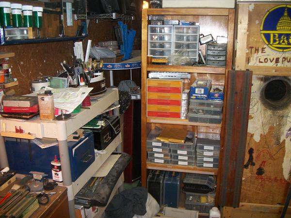

 Posted - April 01 2012 :  01:32:01 AM Link directly to this reply  Show Profile  Click to see EM-1's MSN Messenger address  Send EM-1 a Yahoo! Message  Add EM-1 to Buddylist

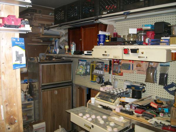

OMG you all DON'T want ot see my work bench!

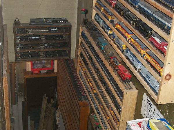

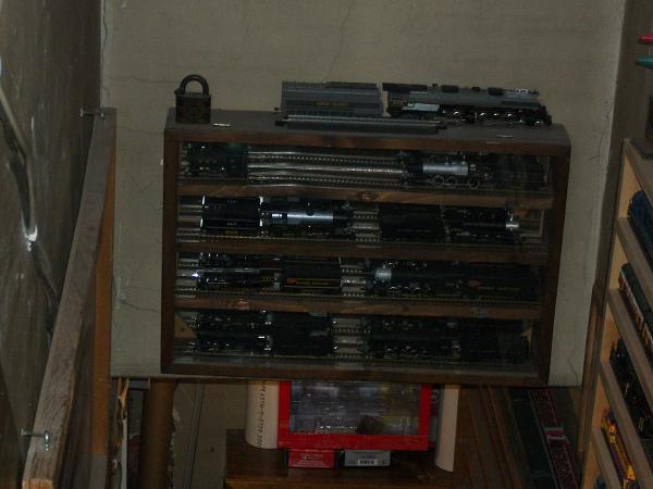

^------^-----^-----Whats seen heading up to the shop, its on the 3rd floor of my house (Attic)
Then....whats at the top of the steps......
So.....I'll show ya the whole shop!

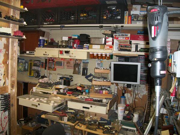

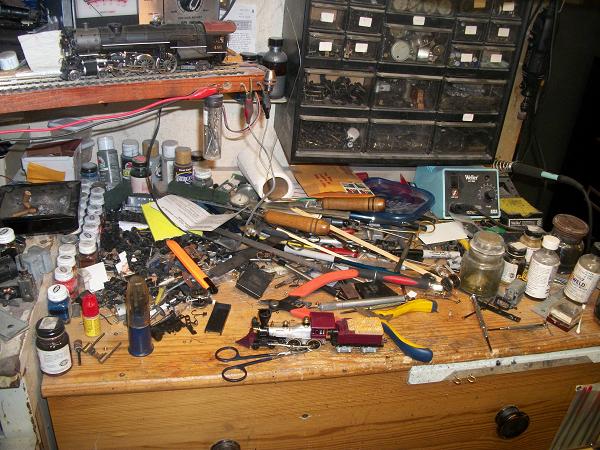

^---------WORK BENCH!
^-------Work bench "extensions" LOL

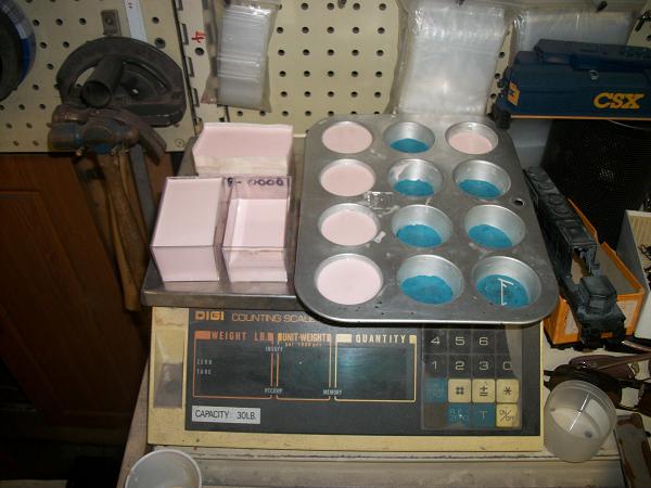

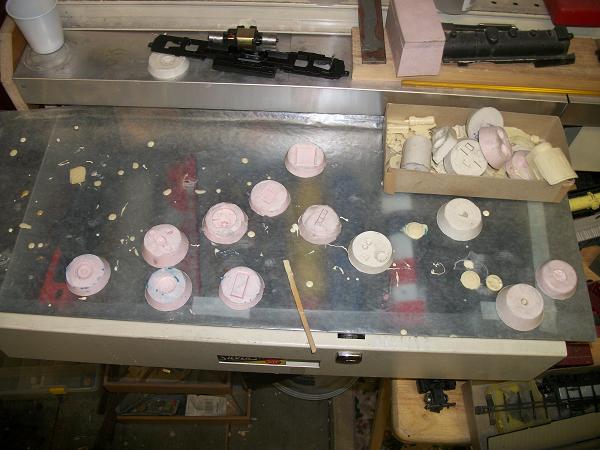

^--------Where YTR pours molds.

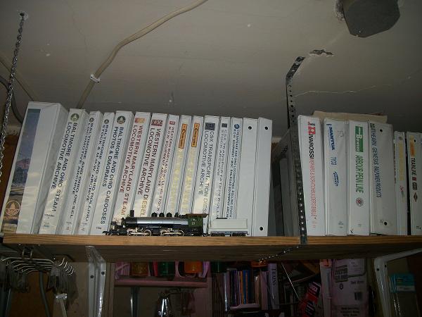

^--------Whats overhead as you walk throug hthe Attic door! These are all of my parts sheets and diagrams, PLUS custom painting images for color placement and decal placement.

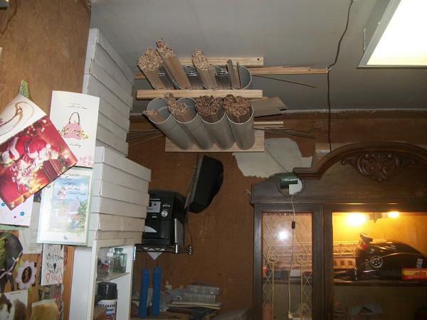

^--------Wood scratchbuilding supplies!
^--------Wall stoarge.....With the molding area.
^---------Detail cabinet! (YES, all those storage containers are FULL of detail parts), the white boxes on top of the cabinet, is "trading card" boxes, with complete train sets in them for my personal collection of freight cars. in the small number of white boxes, there is aproximately 300 cars in them!

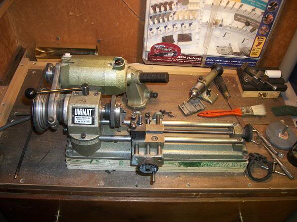

^---------One of two, machine centers. (I have bigger machinist tools in my basement....)
^---------Shop overview!
WHAT A MESS!

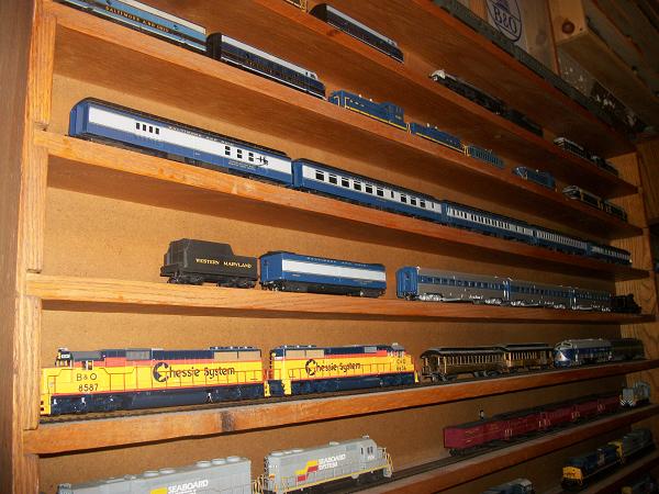

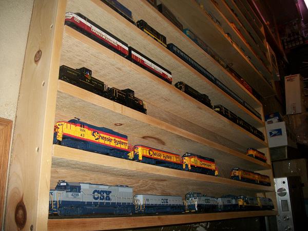

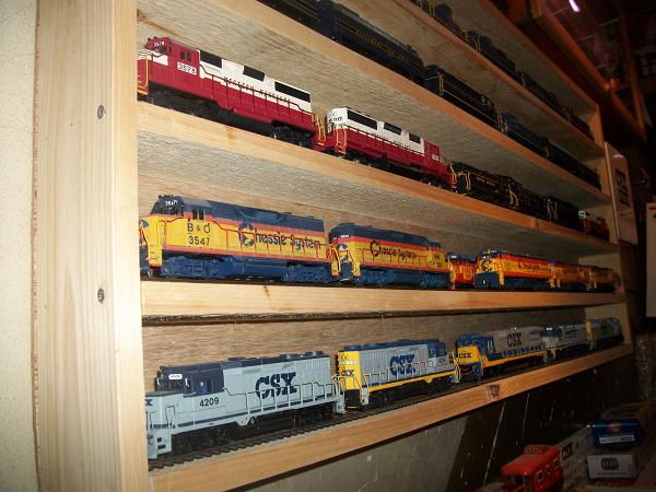

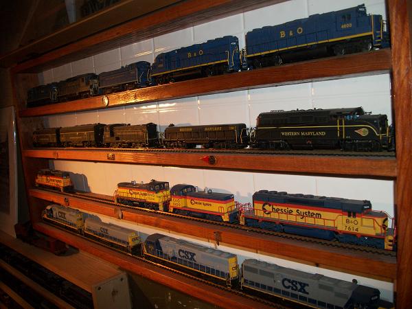

 Posted - April 01 2012 :  10:39:47 AM Link directly to this reply  Show Profile  Add microbusss to Buddylist
neat I likes it! Did you make the shelves for your locos & cars yourself?
 Posted - April 01 2012 :  2:05:55 PM Link directly to this reply  Show Profile  Click to see EM-1's MSN Messenger address  Send EM-1 a Yahoo! Message  Add EM-1 to Buddylist
Busss,
Yep, all those display cases are hand made right in my basement! (I might add, a NICE way to recycle all brass straight track!)
I have 2 pine cases I never done any finish on them as they are "S-3" which has only 3 finshed planed sides, and the bottom or underside of the boards are rough cut.
Also those 2 cases were made, in a hurry too! I needed them in such a way that I had no choice to open up space elsewhere to store things so....... but I'll say, it looks good otherwise!

 Posted - April 01 2012 :  4:58:19 PM Link directly to this reply  Show Profile  Add microbusss to Buddylist
real neat cases To be honest I'd rather build my own cases than buy them The want such redonkulous prices for one

Nelson, if you look at the one picture showing "wall storage" you'll see a "cabinet" door built int othe wall.......thats a crawl throught! LOL on the other side is my "Stock Room" which looks like a storm from hell went throught it....... I got some SERIOUS spring cleaning to do the next few weeks! LOL
As for all the stuff, you guys have not seen anything yet! I'll have to get more pictures! As there's a few missing..... Area's that is!
BUT, I'm one of those shops that has all this as I never know what people are looking for! PLUS, I'm a custom shop so........
Also, the "shelves" the wooden display cases, the largest one, I forgot to mention was made by me back when I was in High School EDIT: (Aparently I need to go back to school to learn how top spell again!) in shop class, its solid Oak, 3/4 thick, by 4 inches wide, by 8 feet long! Costed me $24 to buy the wood from the school! and that was by the board foot back then! SO, I been building those cases for a long time and will continue as time passes and the collection grows!
Edited by - EM-1 on April 07 2012 01:09:03 AM
 Posted - April 02 2012 :  02:41:52 AM Link directly to this reply  Show Profile  Click to see EM-1's MSN Messenger address  Send EM-1 a Yahoo! Message  Add EM-1 to Buddylist
Originally posted by microbusss - April 01 2012 :  4:58:19 PM
Yeah, your absolutely right.....I paid $24 for the Oak, thats in the biggest case seen here.....The rest was "cut offs" from my regular job for the State Liquor Commission, where I build Liquor stores "State Stores" Then in my basement, I have a full wood shop too!
Forgot to mention at any one given time.......The locomotives in the cases, (along with the few rolling stock seen) are merely my personal collection! (I got other cases through out the house but that amount, that size, the wife would divource me! LOL But these personal collection serve another purpose.....they're my advertisement!

Now for the real truth......If I were to "clean" my main work bench, it take me 2 days, and then when I began to work on something else after that it take me 2 hours to be right back to square one........Sadly enough its true! Thing is, I do clean it, and have all the items seen on the main bech put away till the time the follows I'm sitting there again! But it never seems to take long before all that work from cleaning it up, is right out the window!

LOL you know overlooking my pictures, anyone notice that my "Mini Machine Center" is the cleanest!?????? Safe that way!
 Posted - April 07 2012 :  12:19:08 PM Link directly to this reply  Show Profile  Add toptrain to Buddylist
* Yes John it is the cleanest. because of that the least interesting.

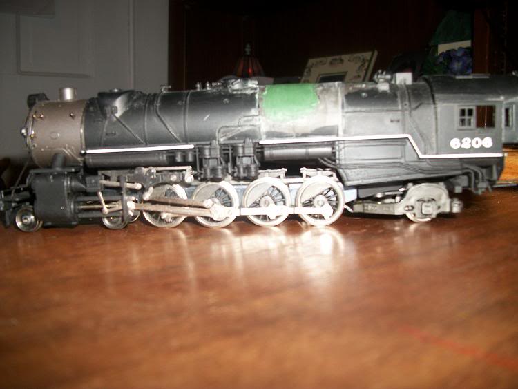

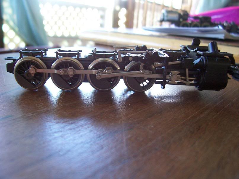

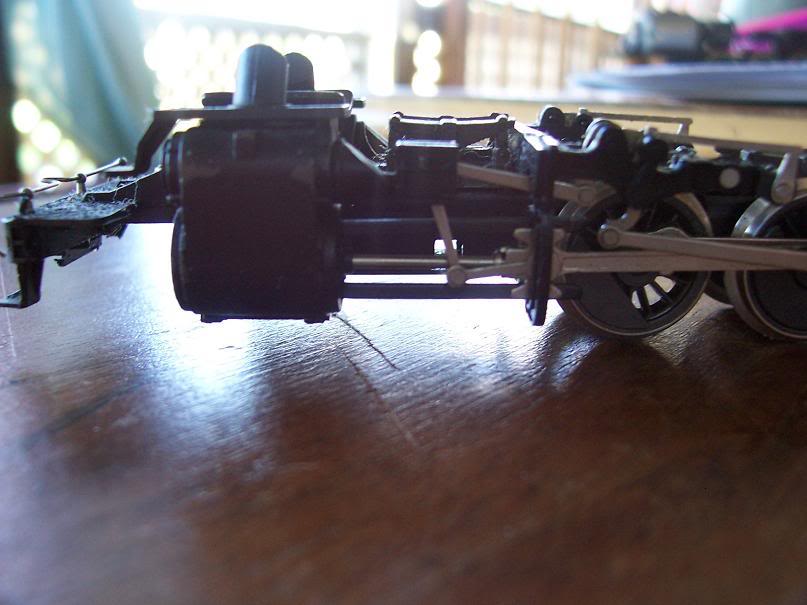

 Posted - April 21 2012 :  7:37:15 PM Link directly to this reply  Show Profile  Click to see EM-1's MSN Messenger address  Send EM-1 a Yahoo! Message  Add EM-1 to Buddylist

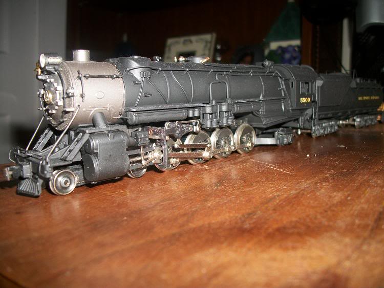

Me likes the Mantua 2-10-0! I just can't help myself.....
I've been looking for the Mantua 2-10-0 for quite some time. Somewhat hard to find locomotives!
I want to make one int oa B&O Class "Y" 2-10-0........

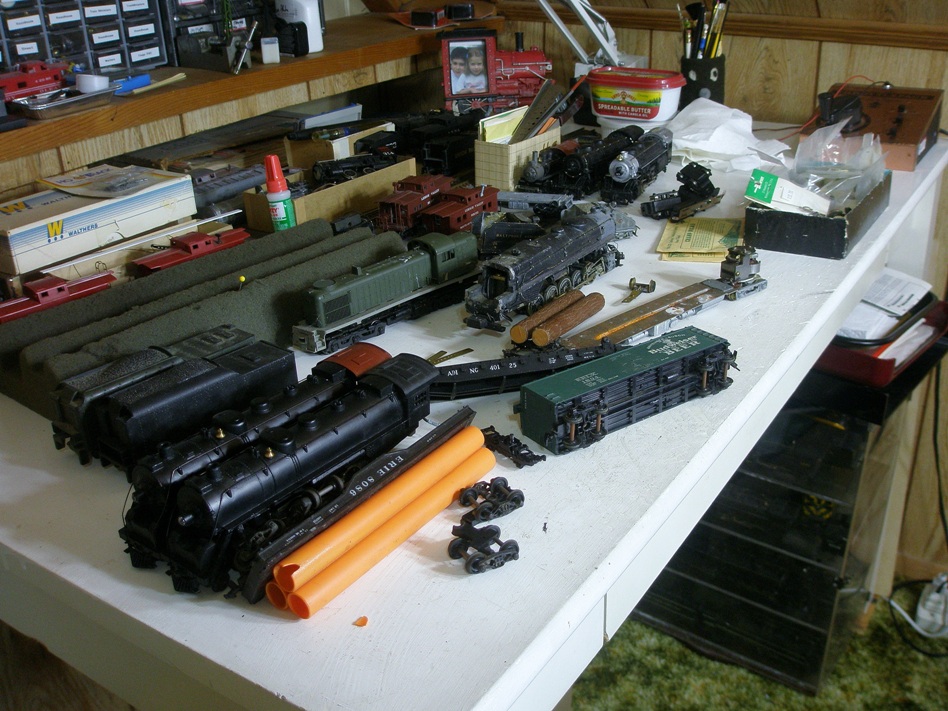

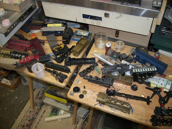

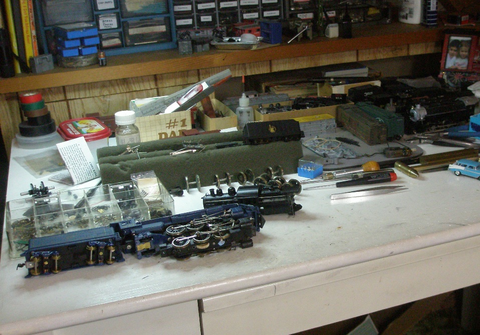

A look at the work bench yesterday.
Edited by - toptrain on May 11 2012 7:20:30 PM
 Posted - April 22 2012 :  11:05:32 PM Link directly to this reply  Show Profile  Click to see EM-1's MSN Messenger address  Send EM-1 a Yahoo! Message  Add EM-1 to Buddylist
Frank,
Very NICE! (Mine is somewhat cleaner!) As I've been working on alot and getting things done but, also "sorting" of loose parts that hasn't been done up to the point of the last pictures I posted.......
With that said, I'm also making the whole "area" more user friendly with placement of paints, and tools, PLUS parts and such.....

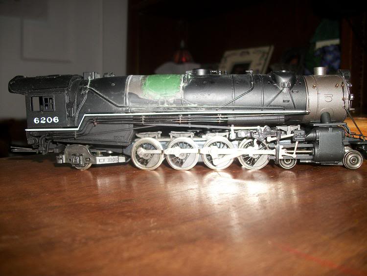

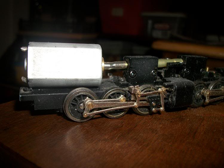

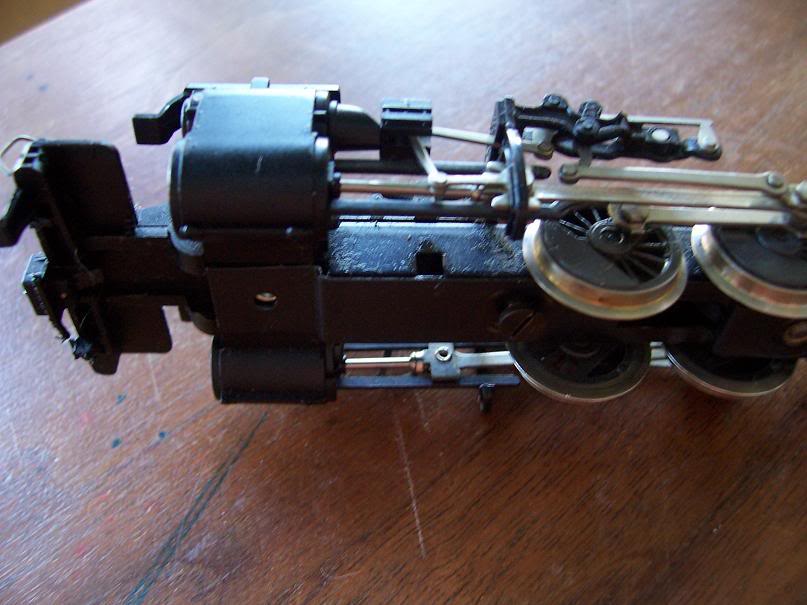

** Current Project on the work bench for the last 2 days.
* "Improving of Mantua kitbashed 4-6-0 that was factory painted for the CNJ."
* Overall appearance of the model was poor. Initially all that I had done was shortened the frame of a Mantua pacific. Then shorten a spare body I had to match the frame. Original paint with silver smokebox, mineral red roofs, and giant front headlight stayed the same. Even the 1608 number on the cab stayed. The large box poke drivers from the pacific gave it a more racy look, tho the driver type to modern.
* The CNJ purchased 5, L5 camelbacks from the Reading when they became excess there, repaced by C1s pacifics's. They had the 3 window Reading cabs like the Mantua model has. Reading numbers for their L5 sold were #'s 592 to 596. These numbers could not be kept for the CNJ already used this number series for their Atlantics. In fact number 592 is the number of the preserved Atlantic camelback donated to the B&O Railroad Museum in Baltimore. The CNJ renumbered the 5 locos, #'s 631 to 635. I chose for mine # 634. The CNJ would reclassify these locomotives as L3s.
* The frame for the CNJ would stay. The drivers would be changed. The side rods and main rods would stay. For now the valve gear and cylinders would stay. Maybe a future upgrade could be made later on. The original drivers for this L3 class were 69" spoked drivers. The Mantua were 84" box poke drivers. On a old used frame with drivers, in my spare box was a Aristo-Craft CNJ 4-6-0 camelback drive. The pilot was broken off so this frame could not be used. The drivers were correct and in good shape. just the last axel had the drive gear on it. The main rods connected to the center driver. All drivers are flanged. For any 6 wheel drive this is OK. I had to take apart both wheel sets, pulling off both wheels and the gear, of the center and rear axles to switch axles and replace the drive gear, with a Mantua one to match the worm gear on the PM1 motor. Then put the wheel sets back together properly quartered. Because I kept the original Mantua frame, cylinders, side rods and valve gear, they all still fit except for widening the holes hole on some side rods, the main rod, and the eccentric fitting the Aristo-Craft center driver rod mounting post. Also this fitting needs to be soldered to the post mentioned. I am thinking of replacing the tender with a Reading tender off the type used on the loco by the Reading. It is the one that comes with old Mantua Pacific's and Atlantic's. Off which I still have just one. I have to see about this. The tender may be going to Catford branch.
So much for today.

Reading I-6 2-8-0 camelback project.
** I received a few days ago a Link to a Reading railroad list of drawings on side elevations of all their steam locomotives. Great info, not complete but still great. My I-6 project has benefited from it. My model is a kitbash and not a scratch build so all measurements will not be exact. If you start with a certain drive, a Bachmann 2-8-0 in my case. Way to much work is needed to be done to change driver size and frame length. To be exact you must scratch build.
** I am kitbashing. The entire Bachmann drive will remain unchanged and all will be made to conform to the, striped down, basic Bachmann I-10 body. In other words the engine will be a little bigger than the prototype. Around 3 feet in length. Easier to see for us old guys.

The two RDG !-6 bodies still be done. Good work takes awile,
Some new trains.
Mantua 2-8-0 1950s version
Tyco small BN Diesel
Binkley old Pullman observation kit.
Ambroid wood combine
Varney Pullman
Binkley 40' wood reefer kit. Supreme Bisket.

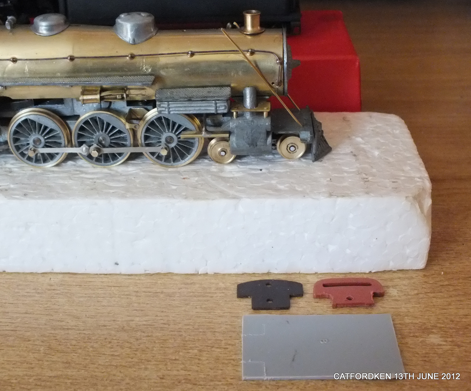

 Posted - June 13 2012 :  09:56:42 AM Link directly to this reply  Show Profile  Send catfordken a Yahoo! Message  Add catfordken to Buddylist
a real busy little bee,i on other hand am just doing a little to pacific,ken
 Posted - June 13 2012 :  12:21:33 PM Link directly to this reply  Show Profile  Add toptrain to Buddylist
Boiler stay bars and insulated tender connection all look'in good.
 Posted - June 13 2012 :  12:55:00 PM Link directly to this reply  Show Profile  Send catfordken a Yahoo! Message  Add catfordken to Buddylist
dead right there frank,all i need then is drive gear,2 short walkways,headlamp,bell then with what i can make finished ken

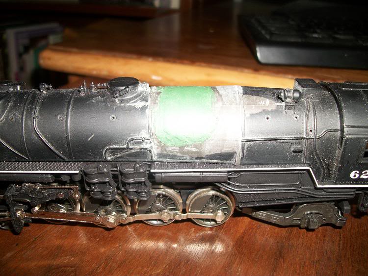

Frank,
Nice work up to this point!
Got a question, the green is that Squadrans putty?
Looks GREAT otherwise......I would NOT sand that at all! Use a fine cut mill file or Bastard file......Leaves a much smoother surface for finishing, with alot less work!
 Posted - June 16 2012 :  9:34:06 PM Link directly to this reply  Show Profile  Add toptrain to Buddylist
Hi Eric : yep it is squadron putty, green, on top of testors putty, tan. I am not good at filling and sanding. I will give it a good try and accept the results. I need to make two new cabs and firemen shelters. Also new boiler backheads. I haven't even started them yet, or decieded what year they will be modeled as. I have no as built photos or drawings. That may make them be later on like the 30s or 40s.
frank or toptrain.
Edited by - toptrain on June 16 2012 9:45:18 PM
 Posted - June 17 2012 :  2:11:32 PM Link directly to this reply  Show Profile  Click to see EM-1's MSN Messenger address  Send EM-1 a Yahoo! Message  Add EM-1 to Buddylist
frank or toptrain.
Originally posted by toptrain - June 16 2012 :  9:34:06 PM
LOL Frank, its John!
Anyway file VERY slowly, with VERY little presure and they will turn out GREAT. Remember, speed is not the key here, its the slow even movement of the file that will reasult in a fine completed model!
Mind if I post pictures of a Rivarossi 2-10-2 that I transformed into a 4-8-2?
 Posted - June 18 2012 :  05:17:05 AM Link directly to this reply  Show Profile  Click to see EM-1's MSN Messenger address  Send EM-1 a Yahoo! Message  Add EM-1 to Buddylist
Frank,
Nope I can post it here then as I have no pictures of it on the layout, running, yet.... (My layout is on the hold list) so,....
The finished model......
 Posted - June 18 2012 :  06:50:24 AM Link directly to this reply  Show Profile  Add toptrain to Buddylist
John :
* The Santa Fe type that became a Mountain type. The 4-8-2 kept it's B&O look. That is a good heavy mountain. The work on the boiler came out very well. Keep up the good work.
 Posted - June 18 2012 :  4:17:16 PM Link directly to this reply  Show Profile  Click to see EM-1's MSN Messenger address  Send EM-1 a Yahoo! Message  Add EM-1 to Buddylist
Thanks Frank!
Yes, they did keep the B&O looks....Most of the B&O rebuilds did in most cases, but not all of them!
The B&O took 2 wrecked S-1's, 2-10-2 type, and rebuilt them into class "T" 4-8-2's, the first of the "Mountain" type used on the B&O, and thats when the Motive Power Superintendant seen the potenial of the wheel arrangement and then began working on building a whole fleet of 4-8-2's from old 2-8-2's.....Needless to say, they were not as "balanced" looking at the originals, but were/kept the B&O looks!
As for good work, you bet! I take alot of pride in what I do on the models I build, not only for myself, but my customers as well!
 Posted - June 20 2012 :  06:39:51 AM Link directly to this reply  Show Profile  Click to see EM-1's MSN Messenger address  Send EM-1 a Yahoo! Message  Add EM-1 to Buddylist

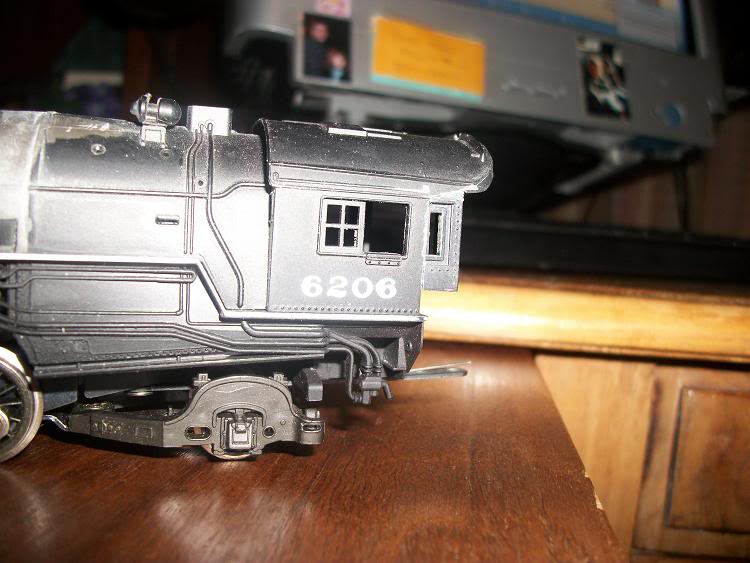

With the B&O modeling I got another neat conversion.....a Rivarossi 2-10-2 boiler thats gonna be on a Rivarossi Y6b 2-8-8-2 frames!
Overall view.....
A view of a YTR casted cab.....on the 2-10-2 boiler, sitting on a Y6b set of frames:
A close up of the boiler sitting there on the frames....
I will be fitting the inside of the 2-10-2 boiler with the internals of the Y6b boiler for the engine set placement, and distance.....
Once I have this conversion that it will mount, I plan to mold all of it as well! Then those B&O guys out there can take a Y6b, and remove the rear trailing truck to go from a 2-8-8-2, to a 2-8-8-0, B&O EL class locomotive!

And then on top of that, I'm building the USA's first Articulted locomotive as well, the B&O's 1904, "Old Maude" 0-6-6-0, from a chassis from Mantua.....That will have a 100% scratchbuilt boiler!
And I changed the motor as well to have a flat can motor:
I want it to pull like the real thing did so.... the open frame motor had to go! Sadly, with the motor size, and the firebox size, I won't be able to add a flywheel as I would have liked too!

John those are interesting projects. Great cab you made. fits good. Cant waite to see how you will support the boiler on the 2-8-8-0 and how you will get the steam from the boiler to the cylinders.
Edited by - toptrain on June 20 2012 09:14:34 AM
 Posted - June 20 2012 :  10:09:57 AM Link directly to this reply  Show Profile  Click to see EM-1's MSN Messenger address  Send EM-1 a Yahoo! Message  Add EM-1 to Buddylist
Frank,
The cab is an exact replica of the original! I made them, as the cab overhang alot of times gets broken off, and theres no good way to repair them, besides replace the cab!
PLUS, that same cab is the actual cab for the B&O's 2-8-8-0's, as it was also used on the Rivarossi 2-10-2 so.....And is a B&O design/spotting feature for the railroad.
The steam pipes will be those as used for a real locomotive, and will be Rivarossi Cab Forwards steam pipes more or less, shortened or lengthened when I get that far As I'm not sure what I'll need for length at this time!
They, are details so.....I want to get the running of it done before I do any details!
I'll do my best to keep posting pictures on progress!
