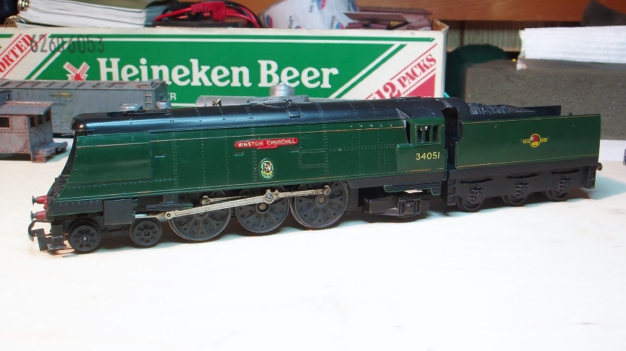

Next off of the Work Bench is a Triang Menchant Class. Winston Churchill. frank

Frank:
That should be Corona beer, since you have so many "limes" hanging about!

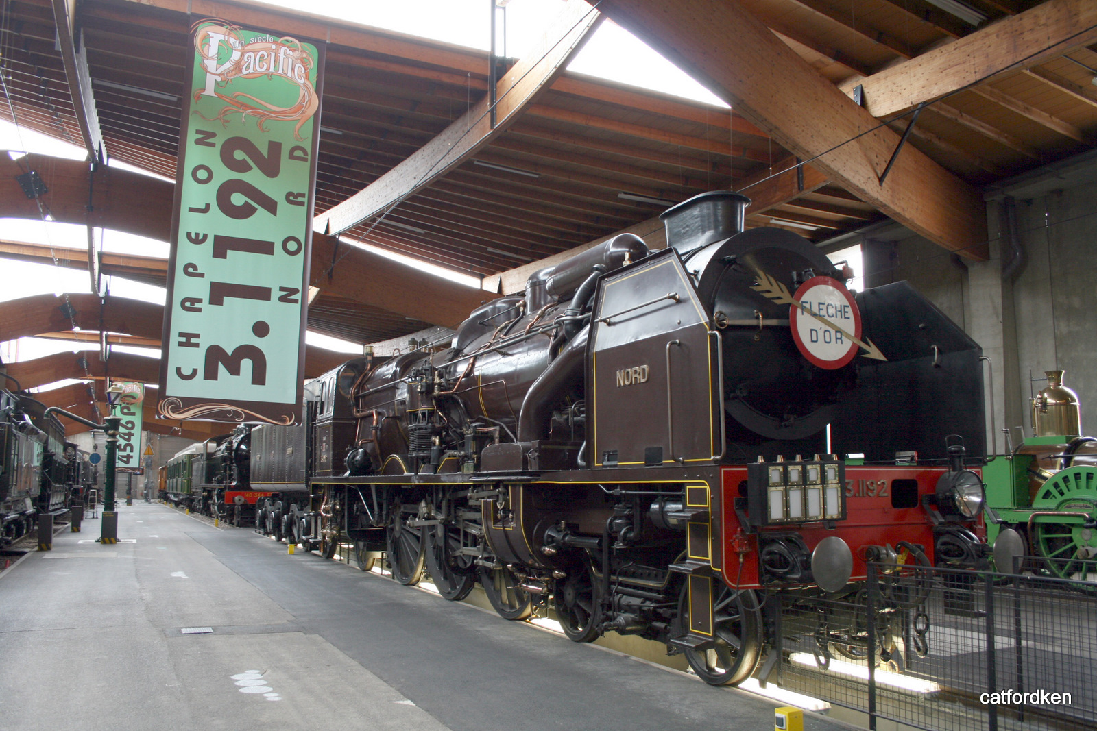

| hi frank the nord pacific is it a rivarossi or jouef ken

nice locos,love that brown livery,great for pulling the orient express ken

Yes Ken that is it. Just mine wount have the front bumpers. it will most likley get a front pilot to allow it to run on the Pennsy branch of the PGW.M1 and M1a with photos.

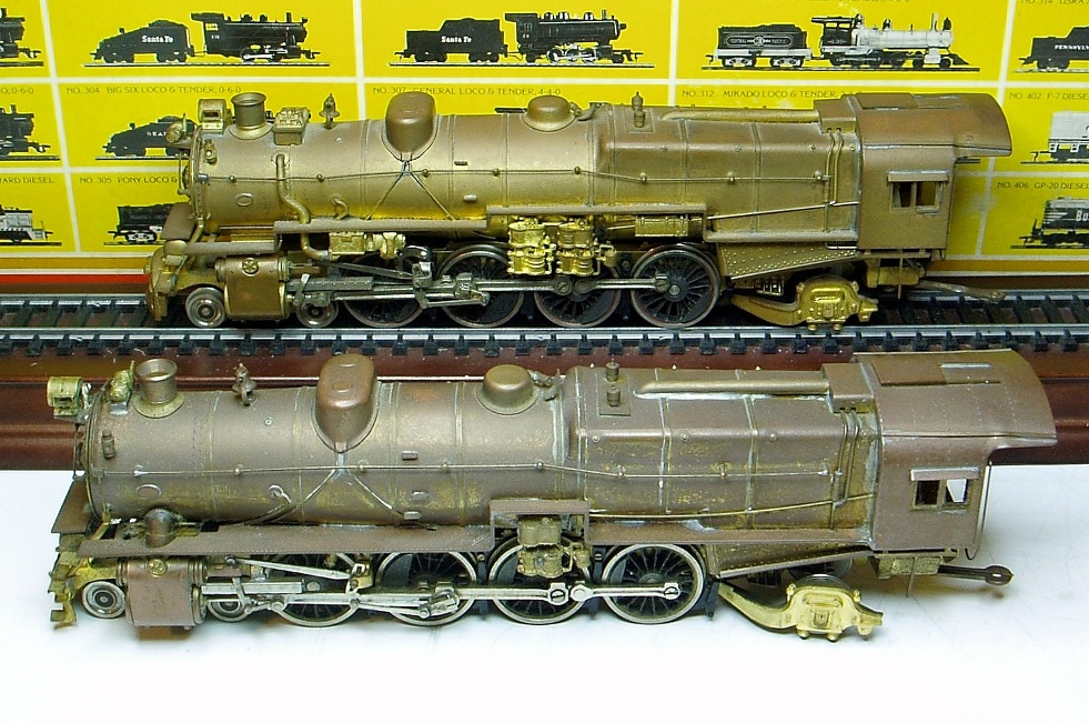

**** My M1a that I got at the NYS of ME train show yesterday 10-23-2011. **** * The dealer said it was a Westside model. He also said that he replaced the motor because the because wires were off one of the commutator segments. He was right. I repaired this and put the original motor back. I did this because the new installed motor didn't fit right . it was to big . Hard to remove and replace the boiler. So it is together and running. * I took these photos to show it and its differences from the first group built, the M1 mountains. I am lucky enough to have one. My M1 is made by Guild for Gem. * The M1 as built is a simple but large locomotive. It is of the last built without a train control system, and a feed water system. Also it had only one two stage compressor. When Pennsy designed and built them, they thought it would be enough. We all know that didn't work for all modern Locomotives have multiple compressors. * I am sure you will pick out these things I have noted on the M1a, and missing from the older M1 frank
All photos of the firemans side. All changes can be seen there.
*** M1 ***
*** M1a ***

| a great pair frank,they look the business,ken

Here is a side by side.

| frank saw difference in 1st photo,and can only repeat a great pair,and am jealous ken

Ken, Also something very different about the two. There is no large steam exhaust leaving top of cylinders going into smoke box on the M1a. If you have a M1b it is the same here, no exhaust pipe. It is cast internally in cylinders.

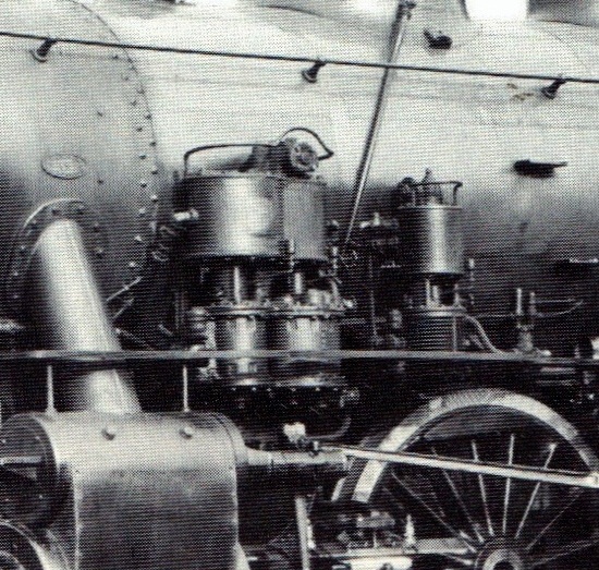

Going back the C1 4-4-4 * About the 2 compressors. What I need to know is how these two compressors were piped together. In the drawing I can see what looks like 2 air tanks laterally mounted behind the cylinders and on top of the frame. How do these pipe in to the brakeing system. * I read that they were used together increasing the air capacity to handle high speed braking. frank

I have the parts sheet for the Rivarossi French Pacific, and it looks like it has a proper steel motor mount that's part of the frame, instead of the magic melting plastic one in the AHM Heavy 4-6-2's.

What are those 4 lights on the left side of loco used for?

Posted - February 22 2012 : 09:46:49 AM
Hey Frank:
Thats certainly very different than the LL chassis.
Would one of those vertical AHM engines be a good replacement? You know the oes that went in the I think GP18/ RS2 units.

Posted - February 22 2012 : 09:53:20 AM
Gareth ; The last Teakettle sent to the catford branch was one, some one tried that idea one. I just shipped what i had to ken. i dont know how or if he had time to get into making it work. Maybe he will respond to this post with some info. * here is what went to Kenny. The changes made were the Rivarossi Motor ( never mounted). Rivarossi wheels and axels. and that is it. * in the photo you can see Rivarossi wheels.

Posted - February 22 2012 : 11:07:55 AM
Hey Frank:
Mine doesn't have the rounded gear pocket on the bottom plate as on yours but again yours is the metal cast one right? Mine says Made in Hong Kong on the bottom plate. The coal bunker is also deeper front to back than the one you have pictured...

Posted - February 22 2012 : 11:48:25 AM
Hi gareth your one is a lifelike teakettle,which were made in hong kong(now china),the pictures you posted showed that the windows door and the underfloor were removed ken

Posted - February 22 2012 : 1:01:58 PM
Hey Frank:
He cut away as well that "floor" section that supports the coal bunker.
Likely this will end up being some kind of Forney.
Thanks for your efforts, you to CFK.
