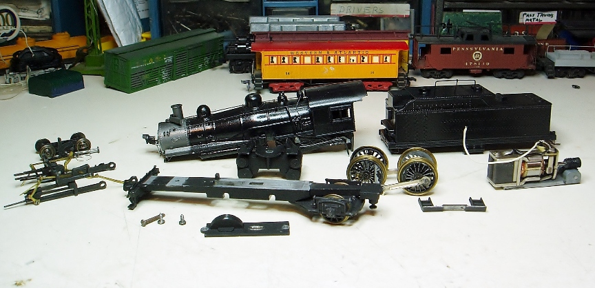

 Posted - February 04 2009 :  12:26:29 PM Link directly to this reply  Show Profile  Add toptrain to Buddylist

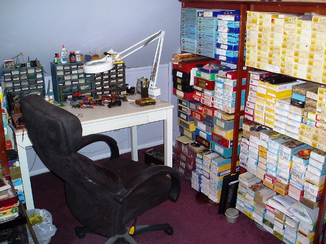

The work bench ! today

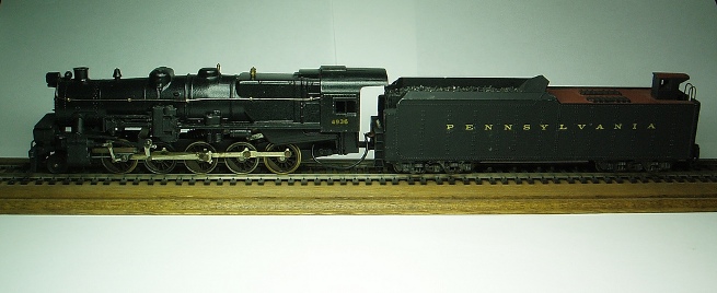

 Posted - February 18 2009 :  07:51:58 AM Link directly to this reply  Show Profile  Add toptrain to Buddylist
First decapod off of service track and returned to service.

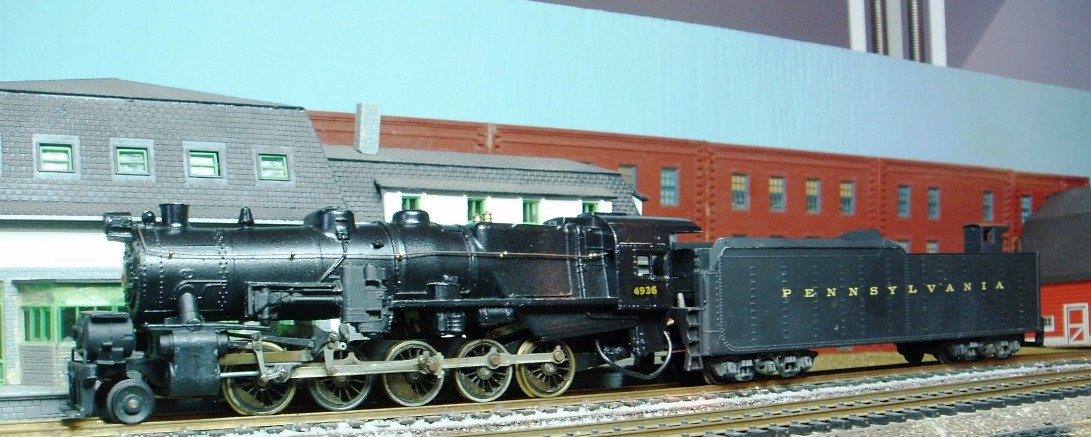

 Posted - February 19 2009 :  6:37:15 PM Link directly to this reply  Show Profile  Add toptrain to Buddylist
Another decapod is ready to run now.

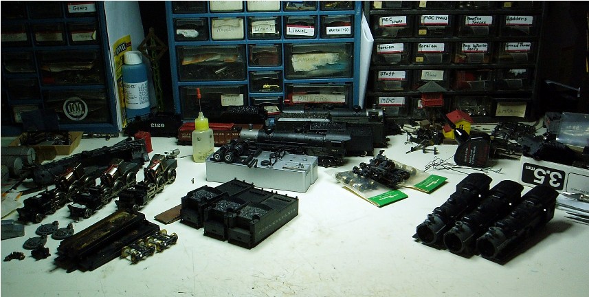

 Posted - February 25 2009 :  3:39:21 PM Link directly to this reply  Show Profile  Add toptrain to Buddylist
My latest work on four Penn Line decapods has been completed. All four are running now. all cleaned, oiled and tested.

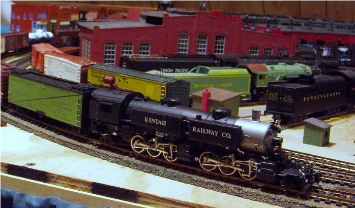

 Posted - December 09 2009 :  8:50:48 PM Link directly to this reply  Show Profile  Add toptrain to Buddylist
A different 2-6-6-2 tanker is seen rounding turn by the locomotive storage tracks.

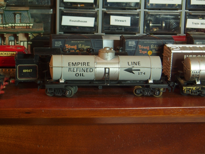

 Posted - January 22 2010 :  09:01:58 AM Link directly to this reply  Show Profile  Add toptrain to Buddylist

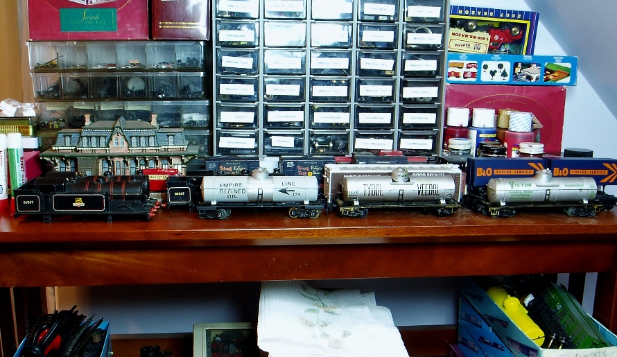

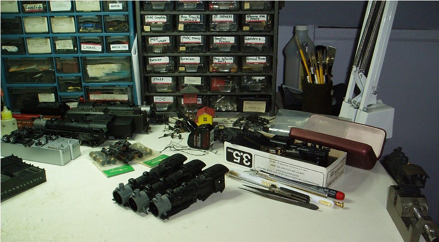

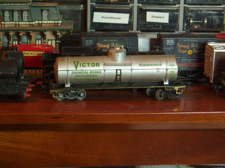

Yesterday the workbench

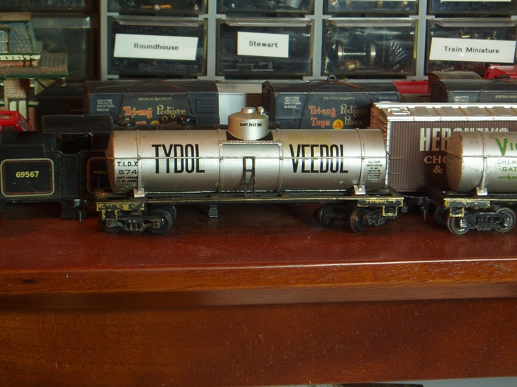

** Here is some things I Purchased at the Greenberg train show a week ago, being worked on. Some metal tank cars, a Athearn mikado, 3 Life Like, Liliput PRR G5s locos, and a HObbyline PRR A5 without a tender.
* First photo: Left side, 3 tank cars. The front one is a all metal Mantua from the 1950 factory detailed for the Republic tank lines. The 2 behind are undecorated. They are of all brass construction made also in the 1950s by Silvine. A Cary PRR decapod loco body lays on its side benind three steam loco drives. These are Liliput drives made for Life Like. The tender shells, floors and details all go to these locos. They are PRR G5s. A pair of MDC truck trailers await decals. A Athearn Mikado is behind them, with the tender for the PRR I1, then my re-bodied Mantua 2-6-6-2 behind that. It is waiting for the tender that is behind it to be added with some more detail.
* Second photo: This is more centered on the workbench. Views of some of the same stuff metioned in the first photo with the addition of the 3 lifelike PRR G5s bodies.More detail parts for the G5s and repair parts for the PRR I1 are laying around.
* Third photo: Same stuff with the addition of a tichey train box with a hobbyline PRR A5 0-4-0 that is getting a new loco body. The old one is in the vise being held in place while the glue used to repair it cure

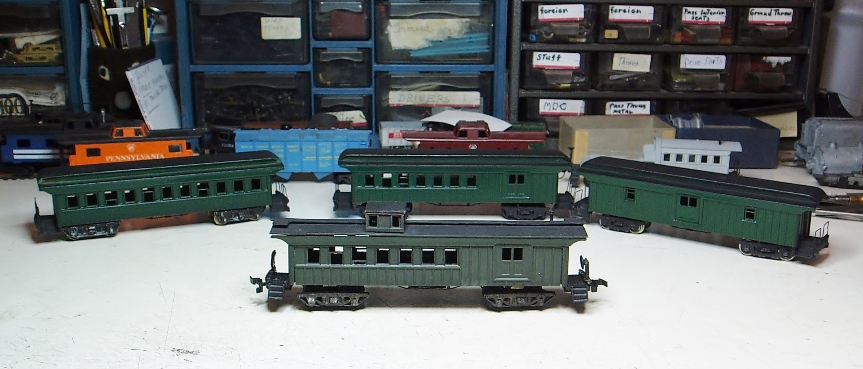

 Posted - December 01 2010 :  09:12:55 AM Link directly to this reply  Show Profile  Add toptrain to Buddylist
Hi everybody !
* Latest work done is detailing 4 Hi Baller old time passenger cars. Three are of the cresatory roof type. The forth is a flat roof drover caboose. Hi Ball calls it a caboose combine. They are 48 foot long without couplers, to the platform ends. They are made of cast metal except for the floors, which are wood. The floors are very thin and it seems to be a problum when you fasten the trucks or end platforms. These need to be screwed down. The thin floor doesn't give enough grip to the screw. I'll work this out. At this time interiors are not in the plaining stages, floor thickness is not a problum. I'll put in a photo now then keep rambling on, later on.

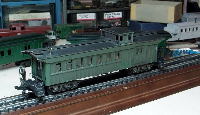

 Posted - December 22 2010 :  10:34:18 AM Link directly to this reply  Show Profile  Add toptrain to Buddylist
With the combine caboose the car is now put together right. Handrails, windows, and couplers are in place. I'll move on to the full baggage.

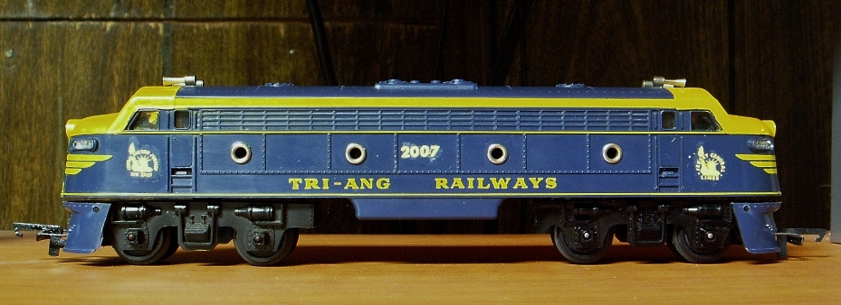

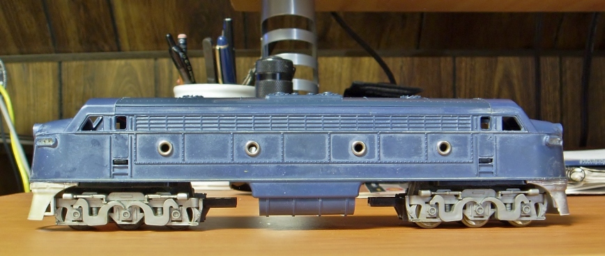

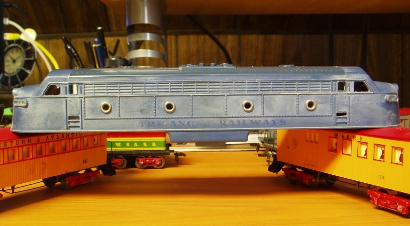

 Posted - February 08 2011 :  4:57:18 PM Link directly to this reply  Show Profile  Add toptrain to Buddylist
* Kitbashing a Triang doublender EMD diesel for conversion to a TYCO power torque drive. The prototype had Co Co trucks. the model B trucks.
* the starting point. Tri-ang Diesel R159/R230. I added a few rub on lettering just to see if it would look ok.
* First I tried a TYCO MU2 diesel drive. Then the torque drive I liked it's appearance better. I striped off the yellow paint. The blue was the plastic color.
Edited by - toptrain on February 08 2011 4:58:25 PM

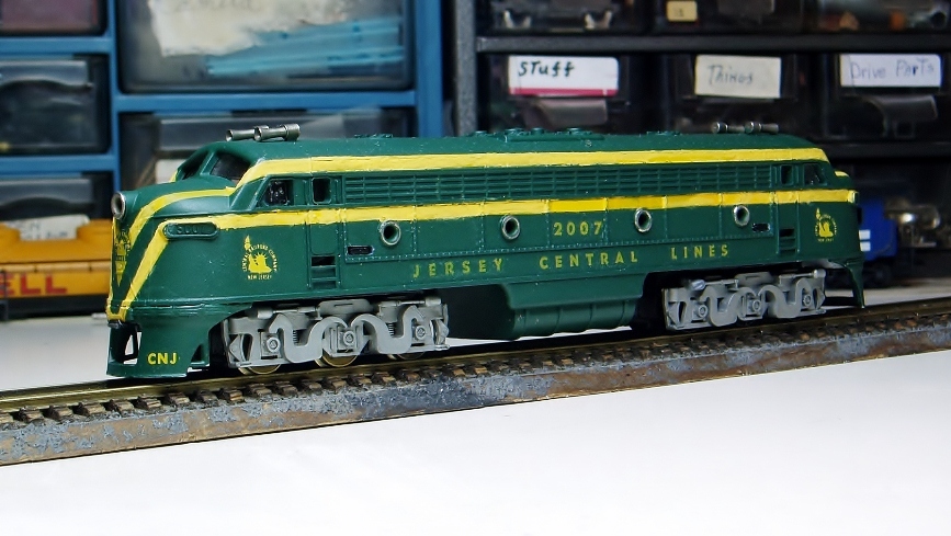

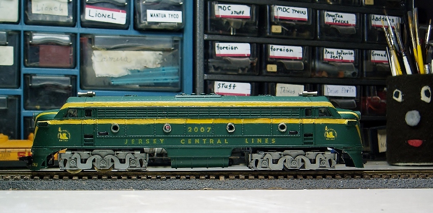

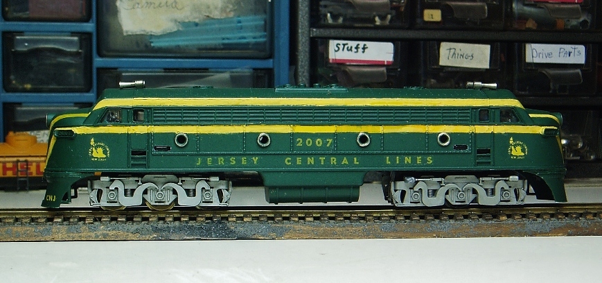

 Posted - February 08 2011 :  5:07:03 PM Link directly to this reply  Show Profile  Add toptrain to Buddylist
Back now to the doublender.
* I measured the loco being work on and compaired it to a Athearn SD45. The SD was longer. The couplers on the SD45 are body mounted so that is what I will do. I found a pair of Bachmann FTA diesels to donate there pilots to the project. I applied the pilots and cliped in the wired and cleaned drive and found out all clearances were OK.
* I gave the locomotive its green paint, then some decal stripes. The decals fell apart. The liberties went on good. So did the name and numbers. I will rework the striping later.
Edited by - toptrain on February 08 2011 5:09:51 PM
 Posted - February 08 2011 :  7:24:49 PM Link directly to this reply  Show Profile  Add Alco Fan to Buddylist
Awesome Frank. Very cool and creative!

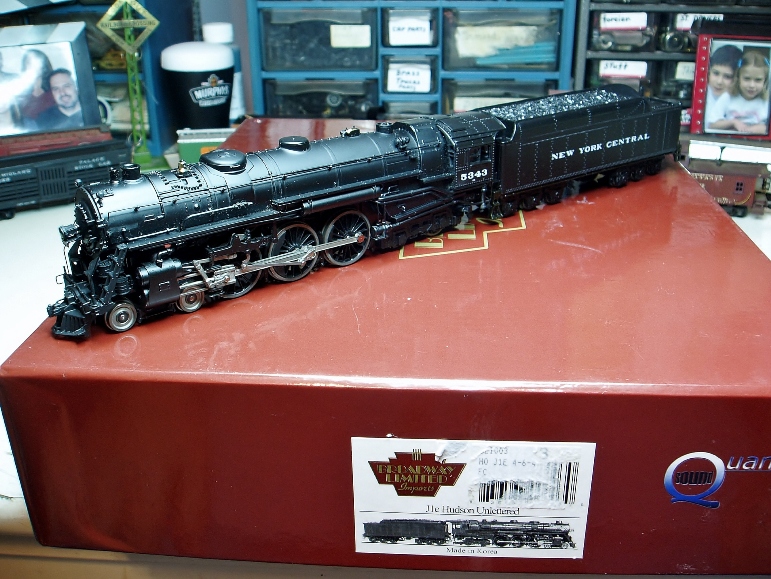

 Posted - February 10 2011 :  5:43:40 PM Link directly to this reply  Show Profile  Add toptrain to Buddylist
My doublender is still in progress. Now I will post a photo of my lastest project. I recieved this MDC Atlantic yesterday. I have been checking it out. Found the side rods no good the main drive geer missing a tooth. The reduction gear no good, but very worn. screw missing to hold motor down. Missmatched bodies. No thnder truck wheels and axels.
* Corrections so far. Replaced plactic tender with a die cast one of the same style with trucks and more detail. Replaced side rods with a spare pair of Bowser PRR E6 rods. Made a screw for mounting motor. Found a replacemsnt gear for nain drive axel.
Edited by - toptrain on February 12 2011 6:40:52 PM
 Posted - February 10 2011 :  5:52:14 PM Link directly to this reply  Show Profile  Send catfordken a Yahoo! Message  Add catfordken to Buddylist
apart from the problems you have encountered and solved,it looks from photo to be in very good condition bodily,ken
Edited by - catfordken on February 10 2011 5:53:13 PM
 Posted - February 10 2011 :  7:05:47 PM Link directly to this reply  Show Profile  Add toptrain to Buddylist
Ken ; It is coming along. Till I get another reduction gear It will be on hold. North west short line makes a replacement gear set. I will order one in a few days.
Edited by - toptrain on February 11 2011 3:58:57 PM

 Posted - February 11 2011 :  6:36:20 PM Link directly to this reply  Show Profile  Add Sundowner to Buddylist
very nice collection and workspace
Looks like my place... just replace the trains with computers- lol
Very impressive, frank!!

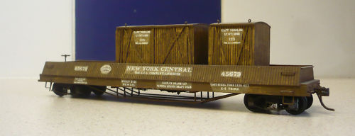

What is the brown flat car load in the 1st freight pic? 6th car from the left on bottom

Roadname is NYC. No the RDG isn't for sall. The brown one is a NYC LCL car. It is a early container freight Car. It has 2 larger and 2 Smaller containers. It needs work. A project for me later on.

hey frank i got an unmade kit of the nyc container car coming,by ambroid,he had one made up but like yours needs a bit of work and one of the large containers missing,ken

Ken with the one I have it is a bit beat up. It isn't play ware. On the car, all the queen posts and suport wires which are susposta be cables are trash. Need replacement. the body of the car is good. With the 4 containers, 2 need new roofs and all I bolts need to be replaced.

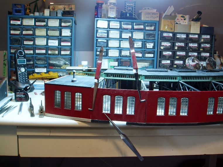

 Posted - February 17 2011 :  11:35:03 AM Link directly to this reply  Show Profile  Add toptrain to Buddylist
OK Next a roundhouse repair. It started as a replacement for 4 doors. It wound up so far. 6 doors. 2 front sections with brick damage. One wall section falling out.
How a project can grow.

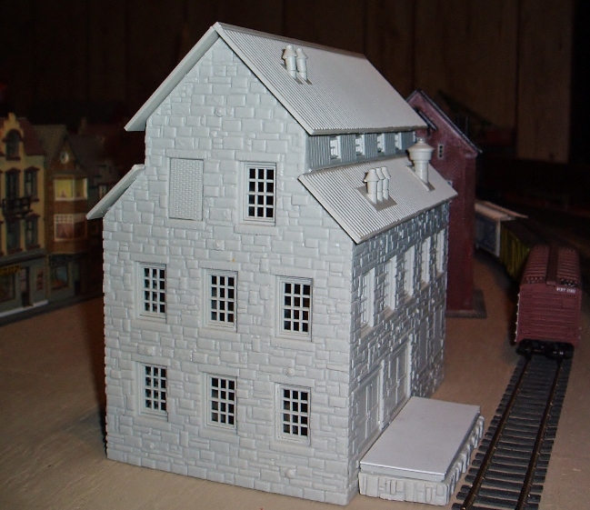

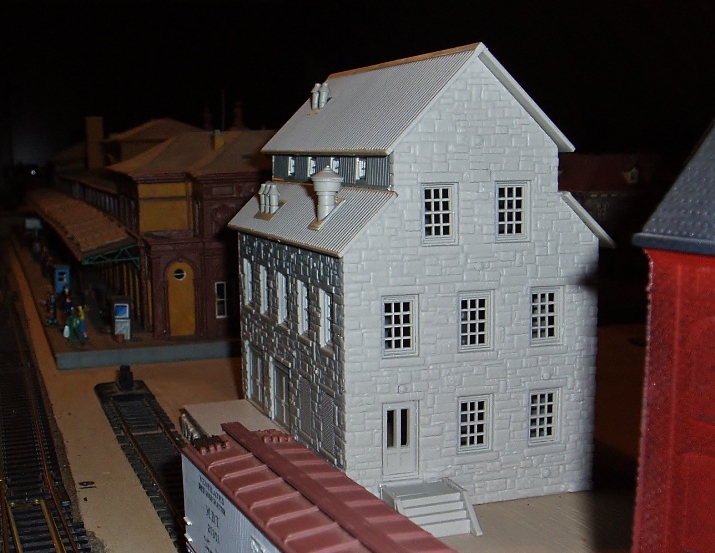

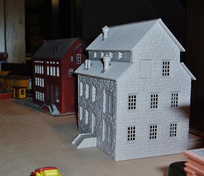

 Posted - February 22 2011 :  9:04:09 PM Link directly to this reply  Show Profile  Add toptrain to Buddylist
I got a little done today. I pulled out The Railway design Associates kit of the J&J Tool Co. It is a incomplete kit and I wanted to see what I could build from it. Of the 3 structers the make up the model only the main structer was in the bag. The leanto and small addition are no to be found. But the main building is complete.
Here it is not painted.
 Posted - February 23 2011 :  8:08:55 PM Link directly to this reply  Show Profile  Add toptrain to Buddylist

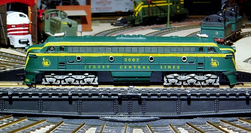

Return to a older project.
Going back to Feb 8 the doublender was awaiting additional work. I relocated the trucks to where they were more centered in their opening. I also lowered the body slightly. The new look.
 Posted - February 24 2011 :  3:29:43 PM Link directly to this reply  Show Profile  Add toptrain to Buddylist
Here it is with it couplers.

 Posted - February 25 2011 :  06:48:58 AM Link directly to this reply  Show Profile  Add Helm to Buddylist
I love your ersatz Baldwin double ender!!!
Originally posted by Helm - February 25 2011 :  06:48:58 AM
Rich , look closser. You will see it has a look General Motors diesels. The high grill is the same as a F9. Th nose is like the EMD F3,F7,or F9. It doesnt have the Baby face front ends. The CNJ doublenders were Baldwin. Number 2000 to 2006. My 2007 is a imaginary next loco in class. It is not a imaginary locomotive. EMD doublenders like this but with 3 axel trucks were made and sold throughout the British empire.

My BWI NYC Hudson is now running. My Hudson Has no DCC, or sound. It is now a stright running DC locomotive.

I have done some work on the silvine brass tank cars I got reciently. touchups and lettering.
Frank
 Posted - April 11 2011 :  09:11:59 AM Link directly to this reply  Show Profile  Add toptrain to Buddylist
One of them , the Silvine tank cars came out Ok.
Another Victor Chenical Works kept its beat up look.
My PRR Empire lines is done but not well done.

The current mess today. Trains awaiting repair, and paint striping,
