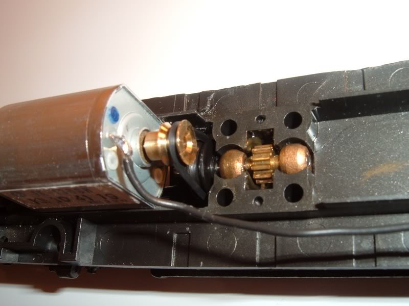

I was thinking of trying a primary belt drive to replace the pinion and large gear of the reduction gear to eliminate the screeching gear noise.
I want to get things worked out with the geared version first.
Originally posted by Ray Marinaccio
Why are you not turning down the armature shaft for the pinion? Is the motor case a bear to open?

 Posted - April 01 2008 :  2:08:25 PM Link directly to this reply  Show Profile  Add Roy to Buddylist
Since the overall dimensions of the truck are critical to fitting in narrow-hooded diesels, and still allowing minimum turn radii, I think I'd try to integrate the motor casing into the truck frame itself. That way you could mount gear studs, the truck suspension spring pivot, and whatever, right to the motor casing.
Alternately, the casing could be removed, and the motor parts fitted directly into your frame. The advantage here is the ability to redesign the brush holder for easier brush maintenance, for instance.
 Posted - April 02 2008 :  02:34:31 AM Link directly to this reply  Show Profile  Add NickelPlate759 to Buddylist
Instead of manufacturing a whole new truck block, wouldn't it be simpler to take a bunch of scrapped PT's, and machine them to accept the new can motor and gearing? Then you could sell it as a kit, or preassembled for those with less DIY know-how. You could also give a discount to those who donate their old truck block for recycling. You'd need a good supply of old trucks, but PowerTorques show up in parts auctions all the time. Ray probably has more than a few in his junk box.
Why don't we just make them rubber band powered? [:D]
Originally posted by Ray Marinaccio - March 30 2008 : 07:24:17 AM
Well, I was joking about the rubber bands, of course, but belt drives do have their merits, like this setup I put in one of my Rivarossi U25C's.
I used pulleys and a belt salvaged from various tape and disc drives. It pulls like heck with no slippage.
The fly in the ointment for a belt in the PT truck would be lubricants slinging off of the gearing, or hair and lint. Either would likely be a deal breaker.

Hey NP:
Here's my thinking. Now you've done some building obviously from the belt drive on your U-Boat. When I think of the work of disassembly of a PT then setting it up on a Mill's vise, or perhaps using a lathe to machine that block to make another motor fit I'd be wondering, wouldn't it be simpler to produce a set ot PT like TERP blocks. There are changes that could be made in the redesigned block like changing the material. GIC suggested for example using plastic as a block material, Isolating the motor to allow for all wheel pick-up. All thats easier if designed in from the outset, but especially if the manufacturing process is designed at the same time.
Finally, while Ray may have several PT trucks in his junk box as do most of us, I think you need a larger block of "cores" to commit to a production process.
PS: I'd really appreciate some more pictures of that belt drive system!?
Edited by - romcat on April 02 2008 02:57:24 AM
Originally posted by NickelPlate759 - April 02 2008 :  01:34:31 AM
Nice job remotoring the U boat
Ray
