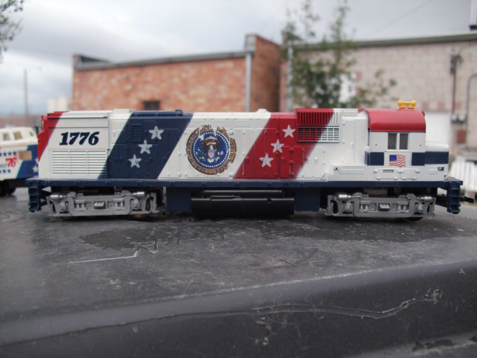

Spirit of '76 C630. Needs parts.
Have to replace a broken drive wheel, needs new brush springs, also have to replace the rear side trucks, and could use new decals as well. Anyone make them? Also came with metal handrails

 Posted - September 05 2010 :  3:08:55 PM Link directly to this reply  Show Profile  Add Brianstyco to Buddylist
Hi - The Super 630 spirit of 76 with no stars is a RARE one you have. I have only seen one listed on ebay recently that was sold with 3 others.

I didn't realize that some 630s came without stars. Never occured to me to look.
The 1776 on the rear needs to be replaced. That decal is worn on both sides. the Presidetial logo is cracked and chipping

 Posted - September 06 2010 :  3:21:49 PM Link directly to this reply  Show Profile  Add microbusss to Buddylist
cracked & chipping you say? Well can't be any worse than mine
course mine is the rare Prez Seal before the change

It seems that the Presidential logo decal was not made to last.
