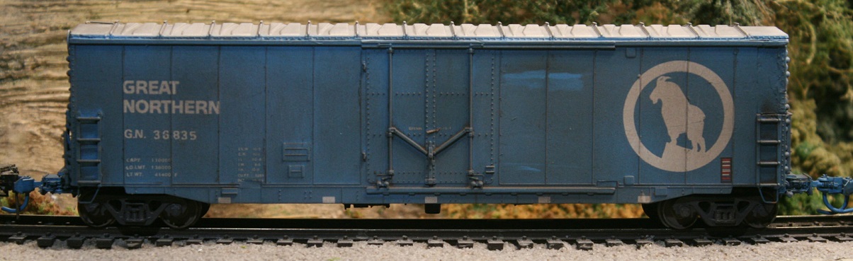

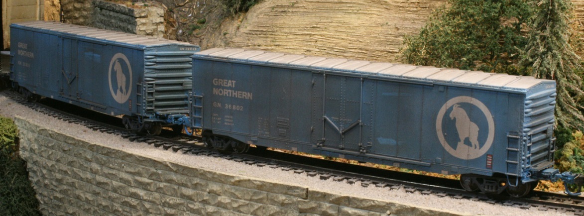

 Posted - December 24 2017 :  6:53:26 PM Link directly to this reply  Show Profile  Add Srenchin to Buddylist
Those of you who have been following my Tyco Plugger Rebuild Program are no doubt aware of my thoughts on removing the roof walk on these shells, in a nut shell it's not worth the effort.
However I have since been forced to re-evaluate that opinion after the success of these latest rebuilds. For your consideration I submit my Great Northern Big Sky Blue plug door boxcars sans roof walks.....

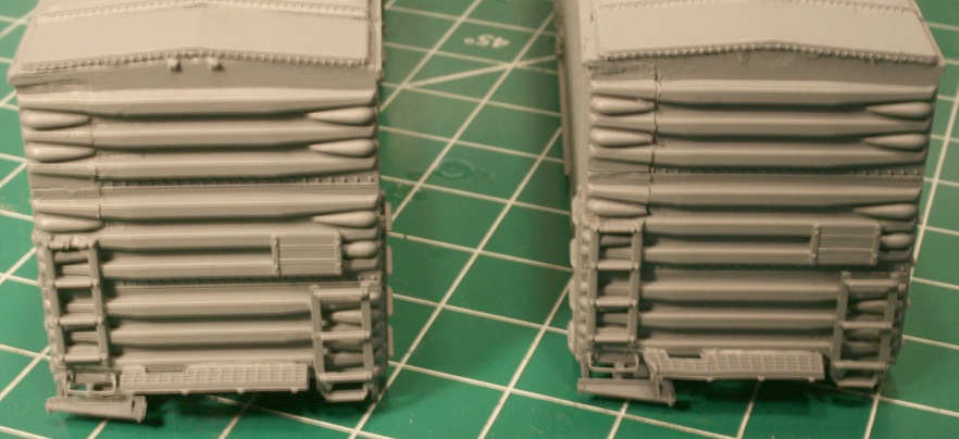

How did I remove the roof walks and lower the end ladders on the "B" end of these cars? Well stay tuned and I will share the process.
Until then Happy Holidays!!!

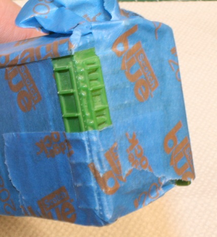

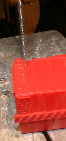

How did I remove the roof walks and lower the end ladders on the "A" end of these cars? This is how I did it....
You will need two plugger shells, the second shell will be a parts donor to rebuild the modified "A" end of the rebuilt car and an Accurail 50 foot boxcar roof...
If it is possible, the donor shell should be a reject unsuitable for rebuilding, the one I sacrificed had the plug door crudely removed by a previous owner...

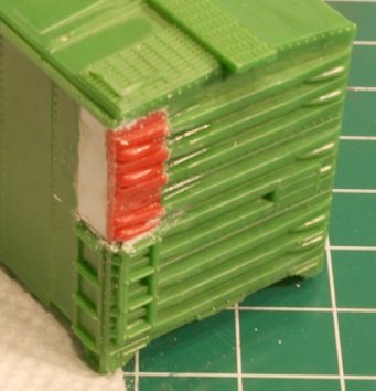

First step in the rebuild process is to remove the unwanted cast on ladder detail on the "A" end of the rebuild shell....
Mask of the area to be removed...
Then using a Dremel tool and files, remove the original corner from the shell...

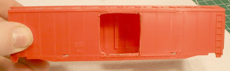

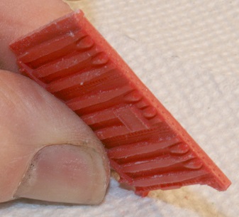

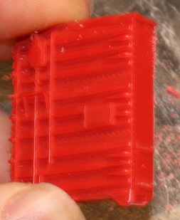

Next, remove the ends from the donor shell....
Make sure you preserve the rivet detail on the sides of the end pieces....

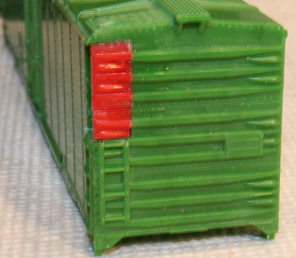

Now the tricky part, cut out the appropriate matching parts from the RIGHT side of the donor shell ends to plug the hole on the LEFT side of the rebuild shell. Remember you will have to turn the donor shell parts upside down to rebuild the A end on the rebuild's shell...
Use strip styrene to fill in the gap on the side of the car and to re-enforce the rebuilt A end...

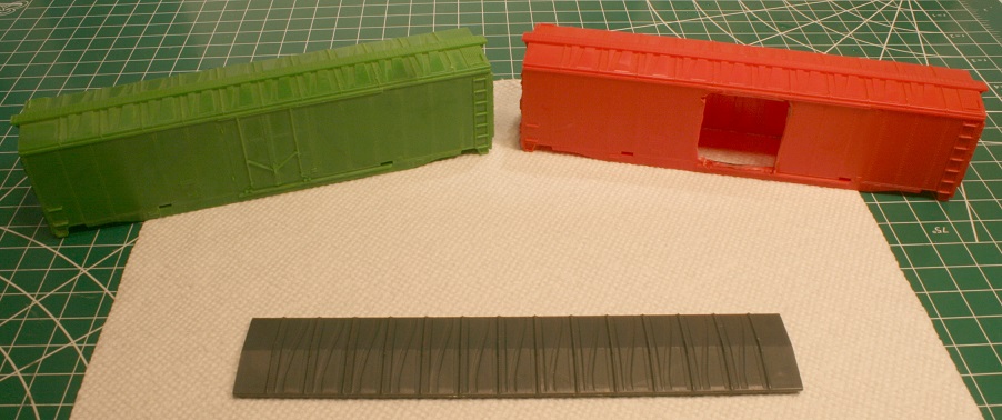

Once the plastic cement is dry on the rebuilt "A" end of the car, the roof can be rebuilt....
First Mask off the original roof for a rough cut....
Then use a Dremel tool to cut out the original roof...
The next step is a fine roof removal, again using tape and Dremel tool remove all roof material from the sides and ends of the donor shell....
Then using hobby knives and files, smooth down the sides and ends of the rebuild's shell to prepare it to receive the Accurail roof...

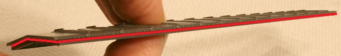

At this point it is a good time to modify the Accurail roof. The first step is to remove the "rim" on the underside of the shell which in these pictures are highlighted in red....
After the Accurail roof is modified, test fit the new roof on the shell...
You will note that the Accurail roof overhangs the ends of the shell by about a 16th of an inch, to fix this cut the ends of the Accurail roof and then cement the parts back together again...
Once you are satisfied that the roof properly fits on the shell, cement the new roof to the shell...
The final step is to prime the shell in order to see any blemishes that may need to be filled with plastic putty....
That's it, yes it is a lot of work but if your careful it's worth the effort!

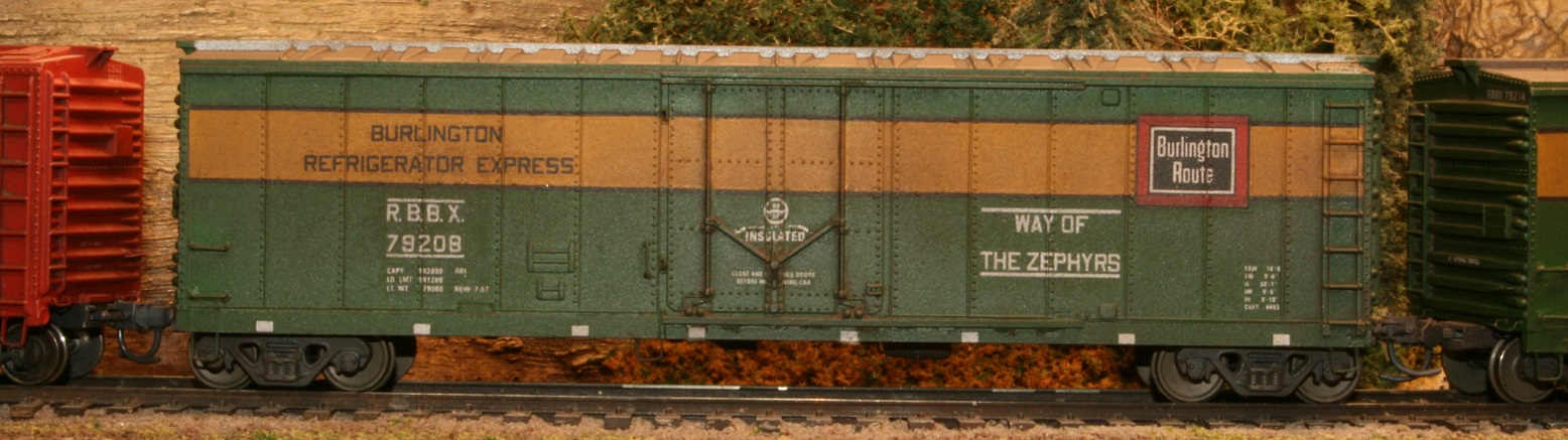

Srenchin
CNRedAvatar
 Posted - September 01 2019 :  11:01:19 PM Link directly to this reply  Show Profile  Add Srenchin to Buddylist
Here is a picture of a car that I am interested in modeling....
As you can see, the biggest difference between the RBBX car
and a Tyco Plugger is the shape of the side sills. Pluggers have
"fish belly" side sills whereas the RBBX cars have low straight sills.
So the first thing I did was to remove the original sills, I did this by first
cutting off the fish bellies with a Dremel tool and then finishing the
process with sand paper. In the process I ended up removing the
bottom rail for the plug door, I will replace the removed molded
detail with strip styrene....
Next step, adding the new straight side sills and reconstructing
the bottom door railings. Stay tuned...
Edited by - Srenchin on September 01 2019 11:26:46 PM

Srenchin
CNRedAvatar
 Posted - September 02 2019 :  4:54:02 PM Link directly to this reply  Show Profile  Add Srenchin to Buddylist
Here is a photo of one of my cars with new side sills and lower
door railing installed...
 Country: USA  ~  Posts: 822  ~  Member Since: December 26 2009  ~  Last Visit: November 20 2026 Alert Moderator  Go To Top Of Page

Srenchin
CNRedAvatar
 Posted - September 03 2019 :  10:57:47 PM Link directly to this reply  Show Profile  Add Srenchin to Buddylist
Here is the latest photo from my CB&Q plugger project...
Grab irons, stirrups, and brake wheel are installed.
Under frames are also assembled.
Next step will be primmer painting!
Stay tunned!

Srenchin
CNRedAvatar
 Posted - September 05 2019 :  12:10:28 AM Link directly to this reply  Show Profile  Add Srenchin to Buddylist
Here is the latest update, the cars have been primed
and given a coat of yellow paint. Next step will be
to paint the roof silver and then mask the yellow
stripe and paint the sides green...

Srenchin
CNRedAvatar
 Posted - September 06 2019 :  12:29:58 AM Link directly to this reply  Show Profile  Add Srenchin to Buddylist
Well I have finished painting the shells, a little touch up work
is needed but on the whole they came out OK...
In not worried about the edges of the yellow band, they will
be hidden by black decal pin stripes. Tomorrow I will
touch up the paint and and start decaling.
Edited by - Srenchin on September 06 2019 12:30:51 AM

Srenchin
CNRedAvatar
 Posted - September 08 2019 :  1:24:35 PM Link directly to this reply  Show Profile  Add Srenchin to Buddylist
Well the decal work is done....
Next steps...
1.) Paint Touch Up
2.) Dull Coat
3.) Weathering
4.) Checking and adjusting weight
5.) Final Assembly
6.) Maiden test run on the layout
Stay Tuned....

Srenchin
CNRedAvatar
 Posted - September 08 2019 :  5:27:34 PM Link directly to this reply  Show Profile  Add Srenchin to Buddylist

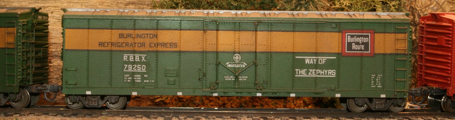

My three CB&Q pluggers are complete, check them out....
This was a fun project, not overly complicated but not
to simple either. I especially like the yellow stripe in
this paint scheme, these cars will really stand out in a
train.

 Posted - September 09 2019 :  08:17:46 AM Link directly to this reply  Show Profile  Add RP model railroads to Buddylist
WOW - complete transformation! Great work.
 Posted - September 09 2019 :  09:57:46 AM Link directly to this reply  Show Profile  Add Chops124 to Buddylist
Rags to riches, amazing stuff.
Originally posted by RP model railroads - September 09 2019 :  08:17:46 AM
Isn't it amazing how a new paint job, a hand full of details, and
some decals can make such a huge difference! The whole
point of the Tyco Plug door Rebuild Program is to prove that
you don't need to spend a ton of money to make a nice
freight car fleet.
Edited by - Srenchin on September 09 2019 9:49:25 PM
