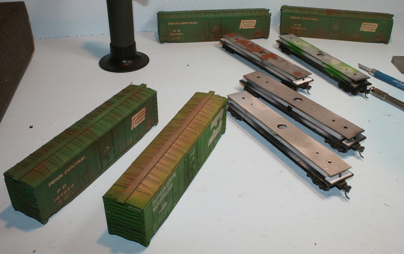

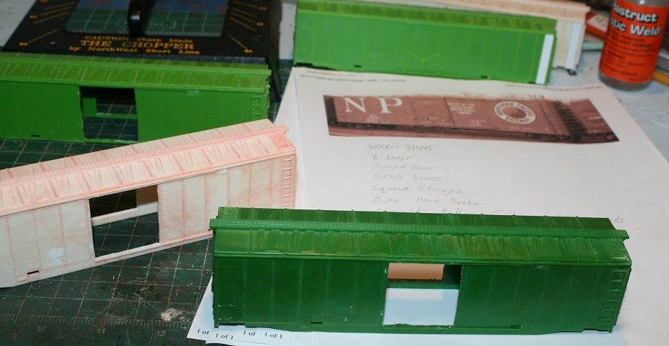

 Posted - September 30 2017 :  8:08:12 PM Link directly to this reply  Show Profile  Add Srenchin to Buddylist

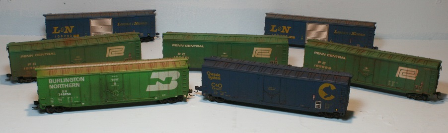

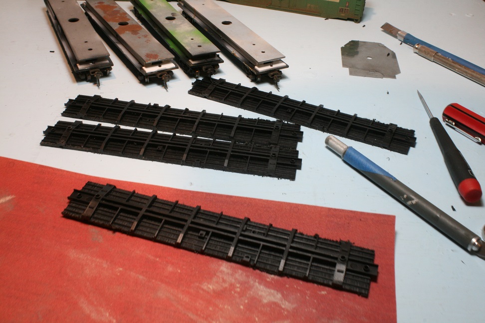

Here is my latest batch of rebuilds, almost ready to start painting....
Stay tuned for more developments!

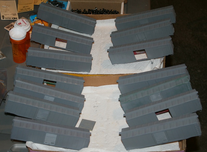

 Posted - October 10 2017 :  11:09:05 PM Link directly to this reply  Show Profile  Add Srenchin to Buddylist

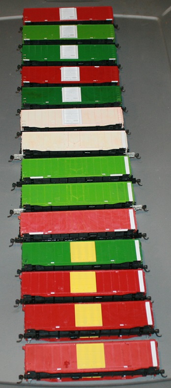

Time to prime...
Fourteen cars at once in true Rebuilding Program style!

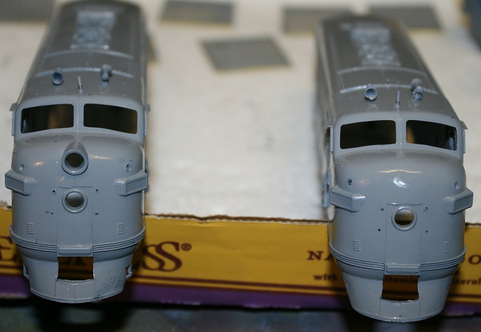

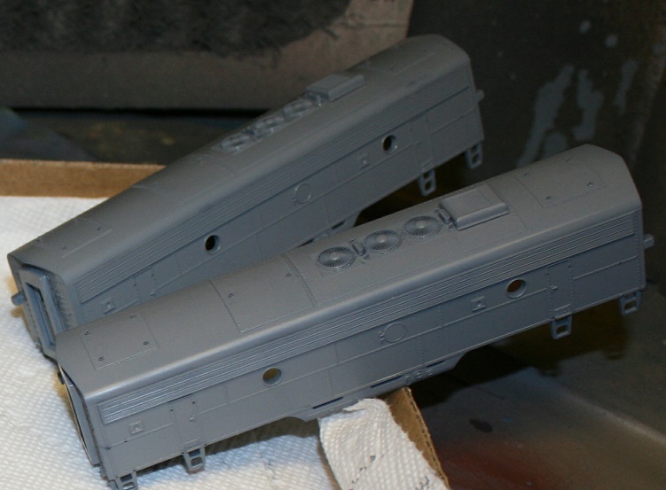

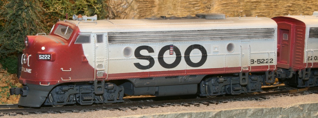

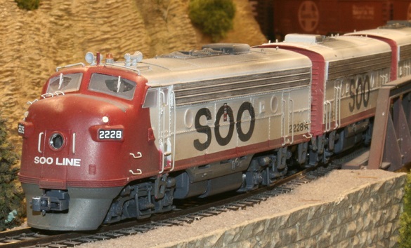

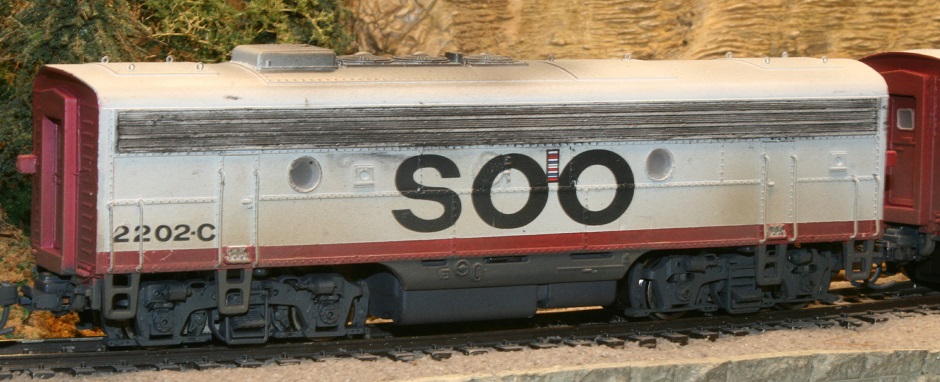

 Posted - October 10 2017 :  11:16:00 PM Link directly to this reply  Show Profile  Add Srenchin to Buddylist

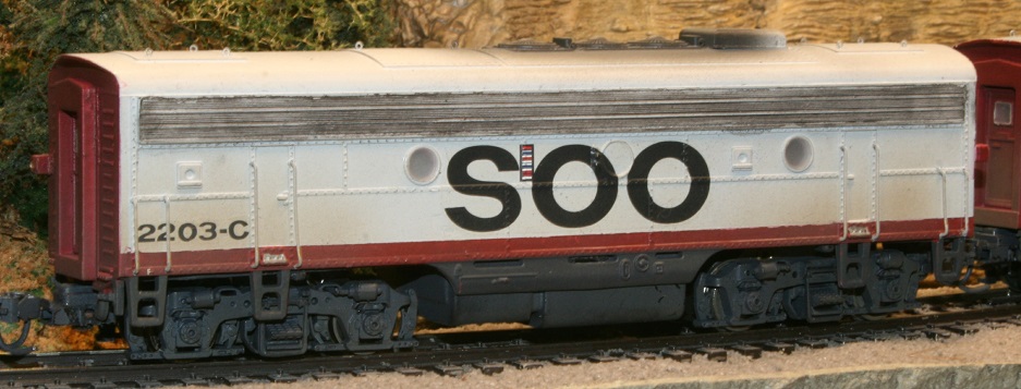

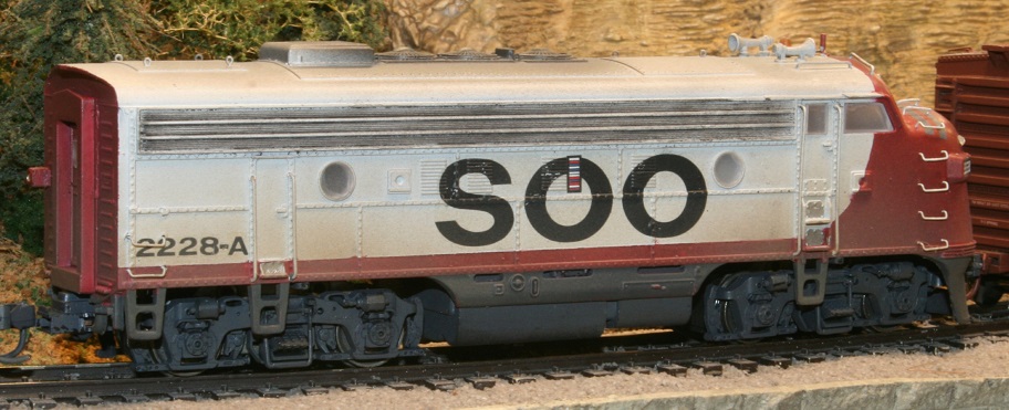

In addition to my new boxcars, part of my current rebuilding project includes building Soo Line locomotives and matching caboose for my 2017 Trainfest train. (Soo Line is the theme railroad for Trainfest 2017)
Here are a few photos of my Soo Line equipment...
Note the missing upper headlight housing on the A unit on the right, this will be a model of Soo Line locomotive 2228A which was wreck damaged and lost her nose headlight in the rebuilding process.

 Posted - October 10 2017 :  11:16:12 PM Link directly to this reply  Show Profile  Add RP model railroads to Buddylist
Looking good Srenchin! Can't wait to see the final product!

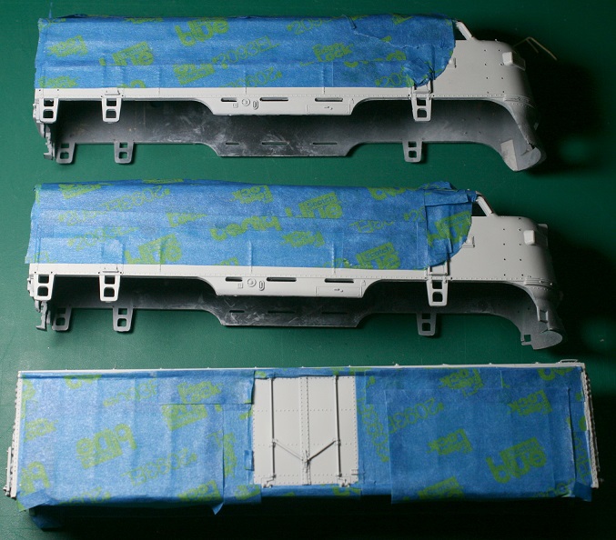

 Posted - October 14 2017 :  8:33:50 PM Link directly to this reply  Show Profile  Add Srenchin to Buddylist
Next step, Masking...
It's a tedious process that takes a lot of work, but if you do it right the models will emerge from the paint booth with near flawless paint jobs!

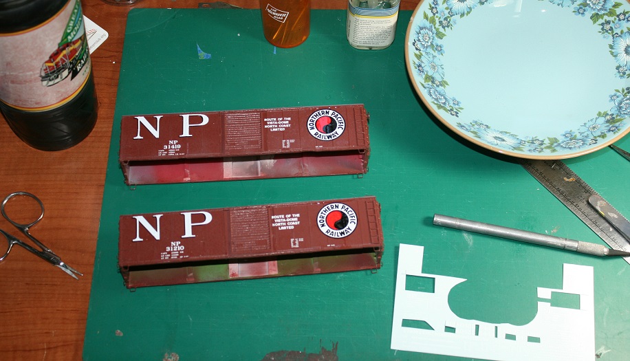

 Posted - October 18 2017 :  2:43:00 PM Link directly to this reply  Show Profile  Add Srenchin to Buddylist
Starting the decaling on my latest rebuilds, check out my latest project....
I love the super sized NP on these Northern Pacific Boxcars, they really jump out at you!
Stay tuned for more updates!

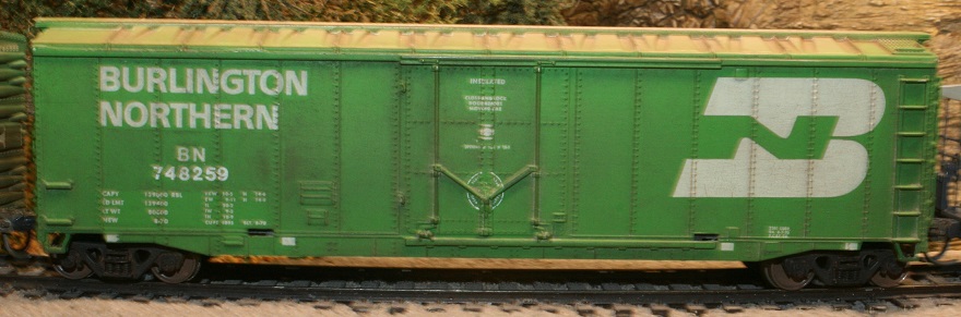

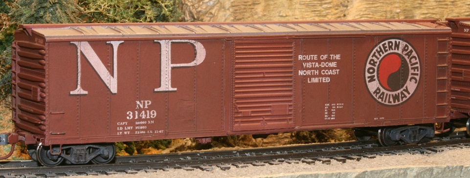

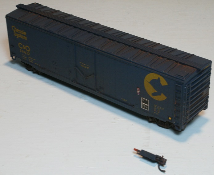

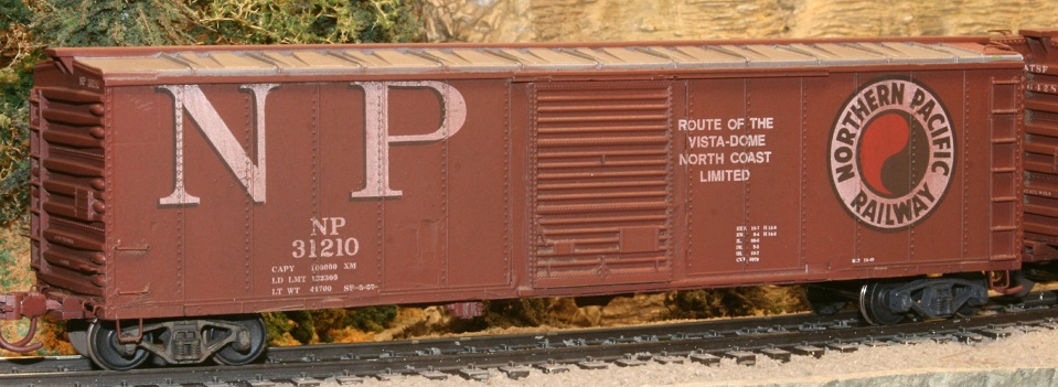

 Posted - October 26 2017 :  6:50:03 PM Link directly to this reply  Show Profile  Add Srenchin to Buddylist
I have finished my latest batch or rebuilds, check them out....
Changes I made on these cars include replacing the plug door with a sliding door and converting the side sill from a fish belly contour to straight. The straight side sill allows more underbody detail to be visible when viewed from the side.
I love the huge "NP" letters and the big emblem on these cars, they will certainly stick out in any train!!!
Stay tuned for more cars!!!

Brian4321
Gilbert HO
 Posted - October 26 2017 :  6:56:57 PM Link directly to this reply  Show Profile  Add Brian4321 to Buddylist
Srenchin,
Very nice. You really put time and effort into this and it shows well.
Can we place custom orders? I've always wanted to see one of the Tyco billboard covered hoppers customized for the two-tone Mountain Dew.
 Posted - October 26 2017 :  6:57:23 PM Link directly to this reply  Show Profile  Add RP model railroads to Buddylist
WOAH!!! That is amazing work! Excellent NP box cars.
 Posted - October 26 2017 :  7:40:12 PM Link directly to this reply  Show Profile  Add Barry to Buddylist
Always a pleasure to view your work Scott. Those box cars are fine.

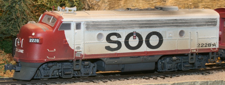

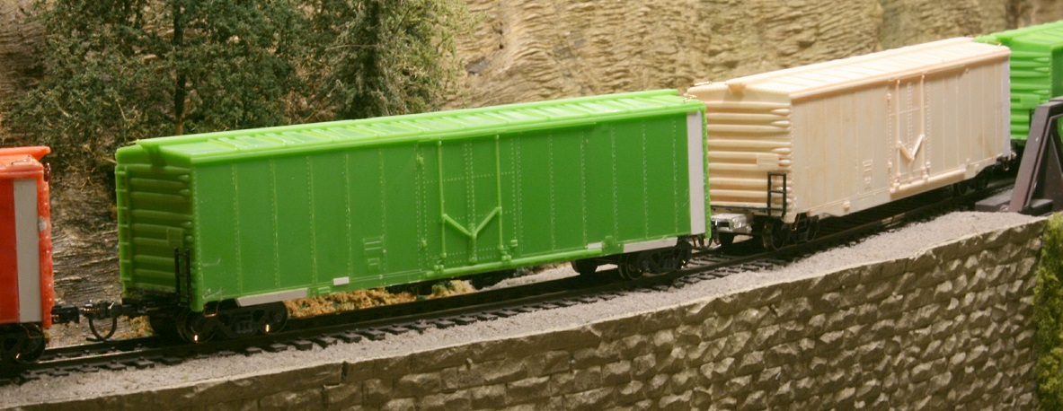

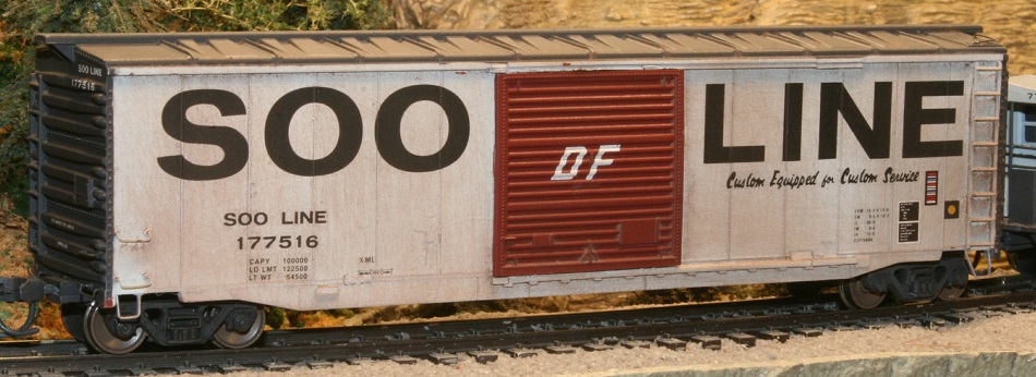

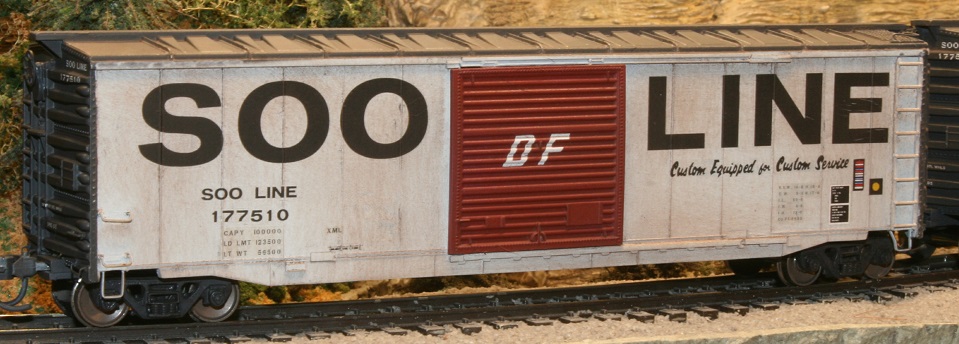

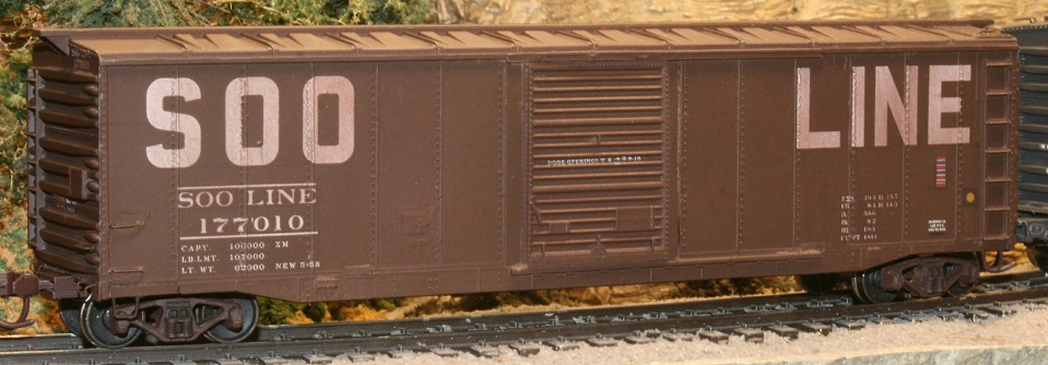

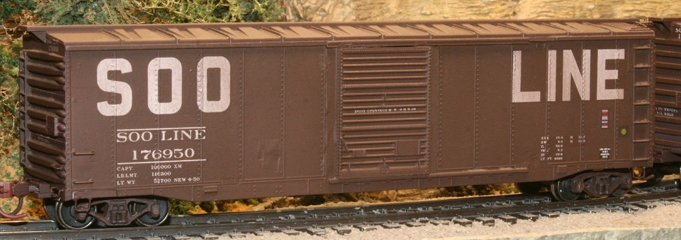

 Posted - October 27 2017 :  11:41:53 AM Link directly to this reply  Show Profile  Add Srenchin to Buddylist

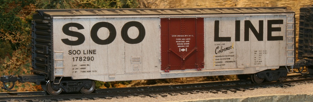

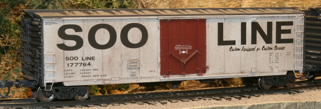

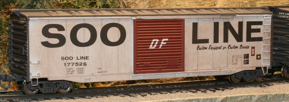

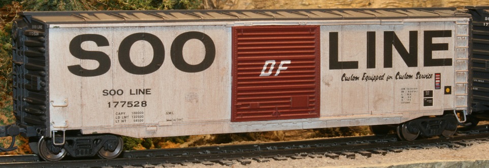

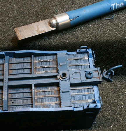

As I mentioned before, the featured railroad at Trainfest this year is the Soo Line, so among my latest rebuilds are some Soo Line cars....
The prototypes of these models were welded PS 1 style cars so I had to shave off all the rivet detailing on the shells. Also note that the plug door was replaced by a 9 foot sliding door. If you are interested in how I made these models feel free to review some of my earlier how to posts in this thread since I used the same techniques on these cars as on past rebuilds.

 Posted - October 27 2017 :  2:26:13 PM Link directly to this reply  Show Profile  Add Redwoods to Buddylist
Originally posted by Srenchin - October 27 2017 :  11:41:53 AM
Just beautiful, great job!

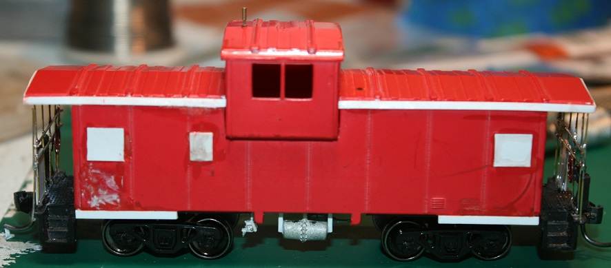

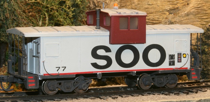

 Posted - October 27 2017 :  10:59:20 PM Link directly to this reply  Show Profile  Add Srenchin to Buddylist

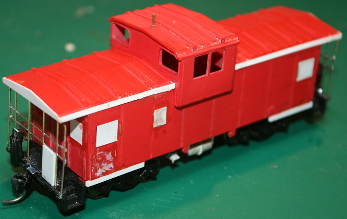

While not made from a Tyco Plugger, this caboose deserves to be counted in this thread. This car started life as a generic Bachmann Norfolk Southern crummy but after stripping, detailing, repainting, decaling, and weathering I was able to transform it into a Soo Line caboose...
Note the rotary beacon, axle generator, and radio antenna details!
Stay tuned for more rebuilds!

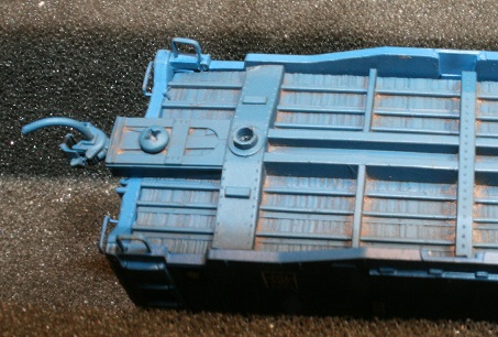

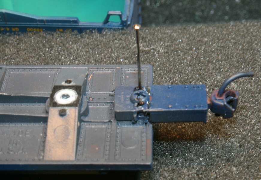

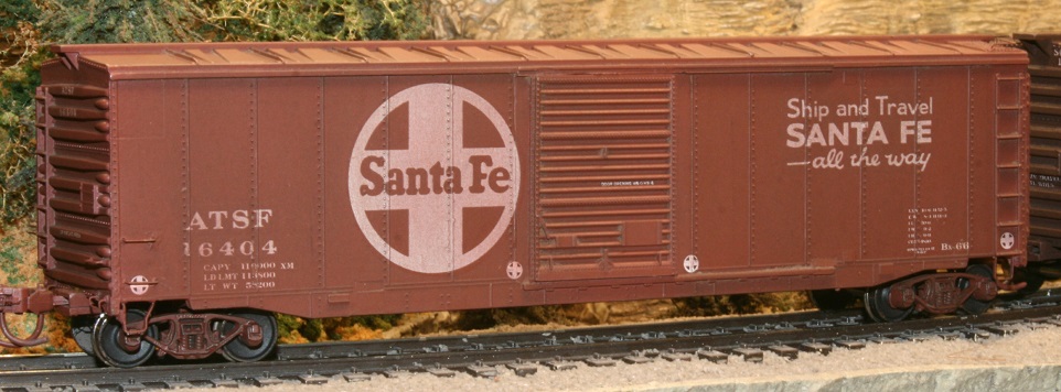

 Posted - October 28 2017 :  7:57:40 PM Link directly to this reply  Show Profile  Add Srenchin to Buddylist

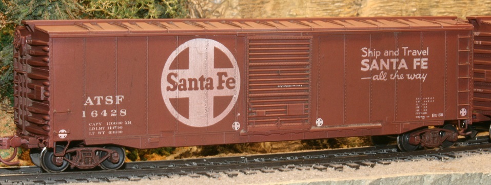

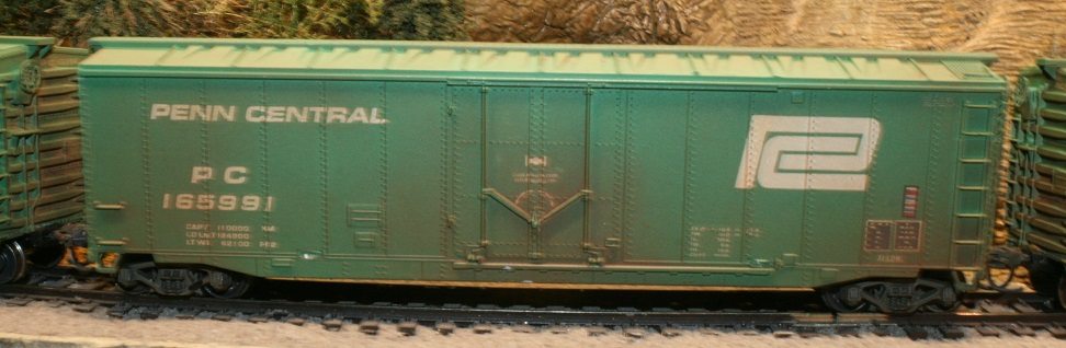

Here is another pair of rebuilds from my latest batch
These cars were pretty straight forward, the addition of sliding doors was the only significant modification. Safety appliance details, paint, decaling, and weathering rounded out these cars.
Stay tuned for more!!!!

 Posted - October 29 2017 :  12:20:56 AM Link directly to this reply  Show Profile  Add microbusss to Buddylist
Originally posted by Srenchin - October 27 2017 :  10:59:20 PM
I think I would of made the rotary beacon actually work

This pair of rebuilds features Soo Line's Colormark campaign, no true Soo Line train is complete without one of these!
One interesting thing about this paint scheme, I found it easier to paint the red doors before applying the light grey. One my first attempt at painting these cars I applied the light grey first and then masked the doors to paint them red, however even with careful masking I still had a lot of bleed trough. So I stripped the cars and painted the red first, just goes to show that sometimes the usual procedure isn't always the best!
Also not the extended draft gear boxes and other add-on details.

This pair of rebuilds are more basic, ubiquitous brown boxcars with sliding doors.
I have to admit that I like the block lettering!

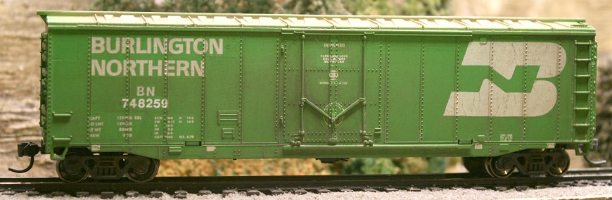

This is the last pair of cars from this batch of rebuilds...
These are my favorite cars of the bunch, note the Hydra Cushion draft gear details under the car. The other usual details round out these rebuilds.
Stay tuned for one more post on this batch!

And Last but certainly not least, this is the power I am going to use to pull my rebuild train at Trainfest this year...
This spiffy quartet will look nice at the point of 70 car rebuild train, I will try to get a video again!

 Posted - November 01 2017 :  3:08:26 PM Link directly to this reply  Show Profile  Add RP model railroads to Buddylist
WOAH! Those F-Units are REALLY nicely detailed and look so realistic! Awesome work again Srenchin.

Those of you who have seen my Trainfest 2016 Tyco Plugger Rebuild video may have noticed that some of my cars didn't make the train. Fact of the matter was that some of my rebuilds had to be side lined as "Bad Orders" due to tracking or other mechanical defects.
In preparation for Trainfest 2017 I have repaired and or rebuilt my Bad Order cars so they can make this years train. Pictured below are last years no shows....
The Chessie System car was the most interesting repair. I equipped this car with Walthers extended cushioned draft gear coupler pockets and apparently the weight of the 50 plus car train was just too much...
Yup, the stress was so great I ripped the guts right out of her.
The Walthers draft gear kit is designed to just be glued into place and I suspect for an average sized HO scale train the strength of a cemented connection would be sufficient. However with the train weights I am dealing with I clearly needed to fasten these components mechanically. I did this by pre-drilling holes through the draft gear pocket and underframe and then pressing heated metal pins through them....
As the pins cool, they become cemented in place forming a nice mechanical connection between the draft gear and the car body.
Another couple of bad orders were my L&N box cars. Upon further inspection I found that I neglected to trim the underframe rib detail that could prevent the trucks from swiveling properly....
This problem was easily fixed with a chisel blade...
The other cars had no visible problems that I could find upon visual inspection, further tests on my home layout also failed to pin point any problem. Fact of the matter is, the layout that my club uses at the train show is over 35 years old and it spends most of its time stored inside an uninsulated building. After that amount of time in such conditions, a certain amount of bench-work and track warpage is inevitable.
Now I am not saying that the track on the club layout is bad, it is not. However due to the age of the layout and its portable nature, the trackage on the layout has enough quirks that any cars that may be sensitive to uneven track will derail.
It just so happens that the one thing all the derailing cars had in common were their rebuilt Tyco frames....
My only hypothesis is that the slightly top heavy nature of my rebuilt Tyco frames was causing balancing problems for these cars. I therefor decided the best way to solve this problem was to change out the old Tyco frames for new Accurail replacements....
Once the new frames were installed on the shells, I tested out the cars on my layout and they all behaved normally....
Next stop, Trainfest 2017!!!

Here is another reason why I like the Accurail frames, look at the photographs below and see if you can spot any differences. The top photo shows a Tyco frame and the bottom shows an Accurail frame, note the distance between the end stirrups and the outer most wheel sets....
Did you notice the truck spacing? The Tyco frame's body bolsters are about a scale foot closer to the center of the car, a concession made to accommodate the talgo style truck mounted couplers. The Accurail frame on the other hand has a more prototypical truck spacing.
The difference between the two photos may seem minor at first, but once you get used to seeing models with prototypical truck spacing suddenly Tyco pluggers with original frames seem strangely pigeon toed.

Yes, the Penn Central had 50 foot plug door cars, here is one example....
http://www.rr-fallenflags.org/pc/pc165993akg.jpg
According to the October 1974 issue of "The Official Railway Equipment Register", Penn Central had 12 fifty foot plug door cars in their X39K class. These cars were numbered 165975 to 165999.
