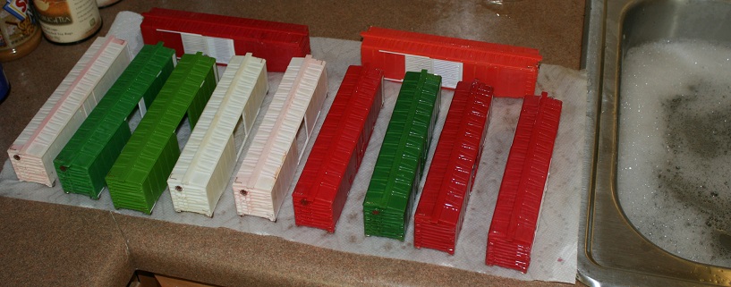

My wife is from Tuscon Btw. Hopefully will be putting a primer coat on my two cars today, still not sure which railroad they will end up being painted for.

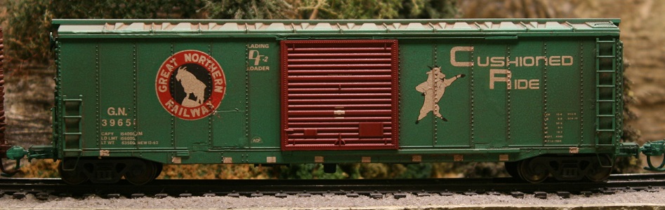

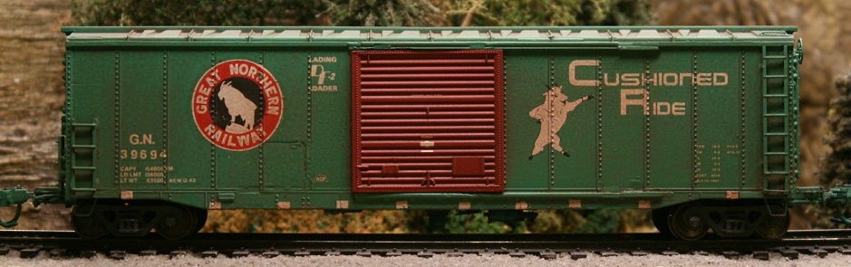

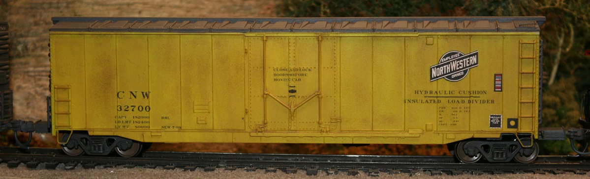

Another car completed....

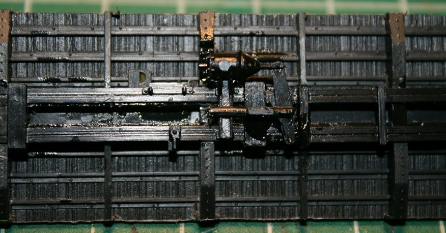

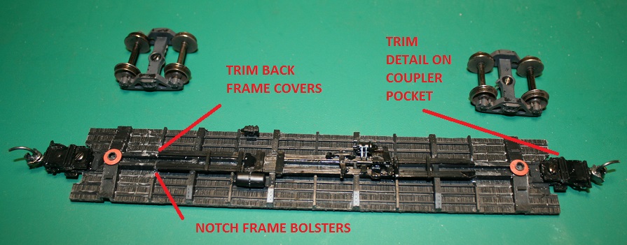

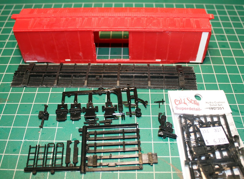

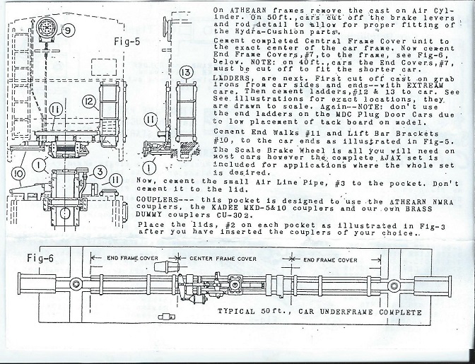

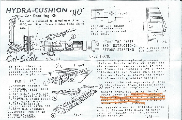

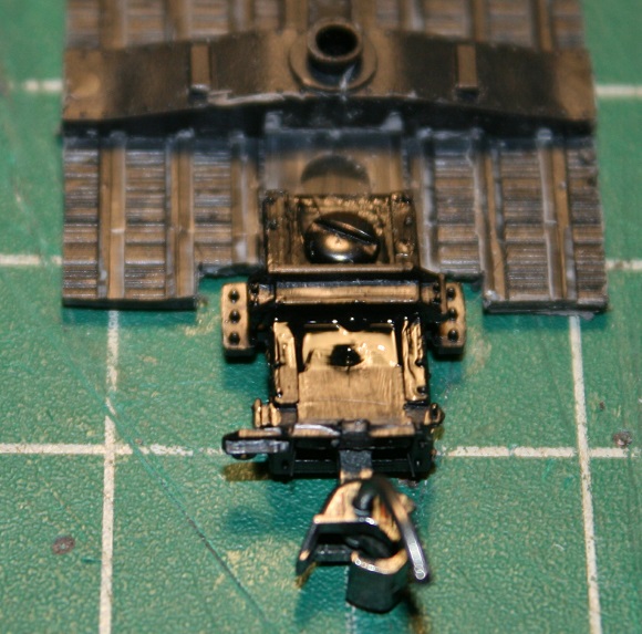

This car utilizes the Walthers cushion draft gear kits I described in earlier messages, they are not as detailed as the Details West products but they look great all the same.
The decals are from Microscale, they compare favorably to the Herald King Decals I used on my last CNW yellow plugger.
Also note the lack of rivet detail, I think this model now passes as a welded car. What do you think?

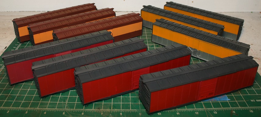

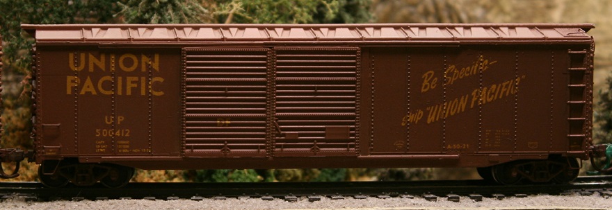

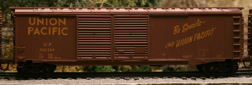

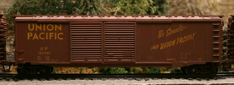

My next batch of ten rebuilds will include the following cars...
Two Santa Fe Shock Control cars with square heralds (click on link below)...
http://www.rr-fallenflags.org/atsf/atsf12965akg.jpg
Three Santa Fe Shock Control cars with round heralds (click on link below)...
http://www.rr-fallenflags.org/atsf/atsf14669akg.jpg
Three Denver and Rio Grande Western plug door box cars (click on link below) ....
http://www.rr-fallenflags.org/drgw/drgw60915ajs.jpg
Two Union Pacific Double Door boxcar brown cars similar to this (click on link below)...
http://www.rr-fallenflags.org/up/up164241akg.jpg
(This is a combo plug/sliding door car, mine will have two sliding doors)
Stay tuned for rebuilding posts...

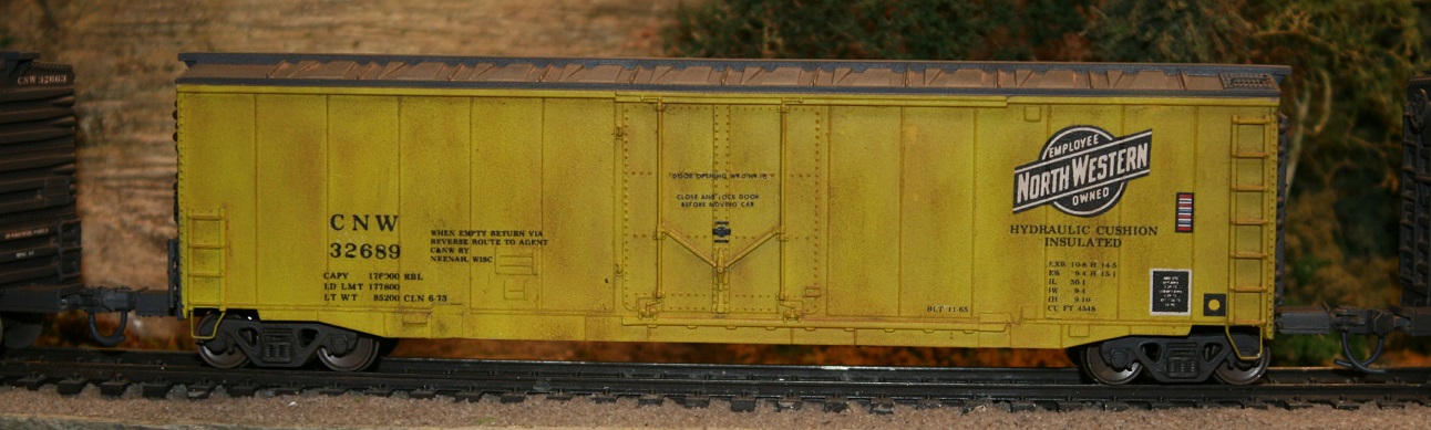

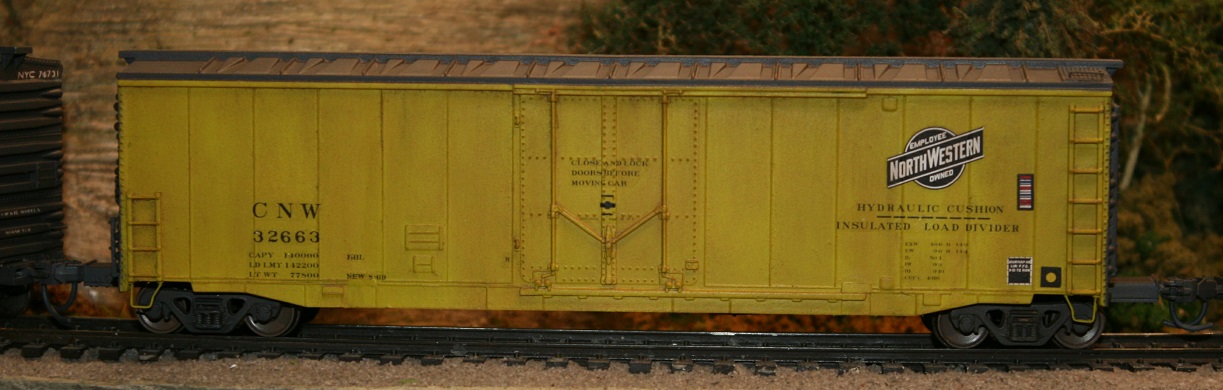

Finally got around to figuring out what railroad I am going to paint my two pluggers, Northern pacific and CNW, that being said what brand/color of arylic should I use, one in NP dark green and the other in CNW yellow. Thanks.
maybe these two?
model flex CNW old yellow, and NP dark green?
Don't want to use enamel paint unless I have to.

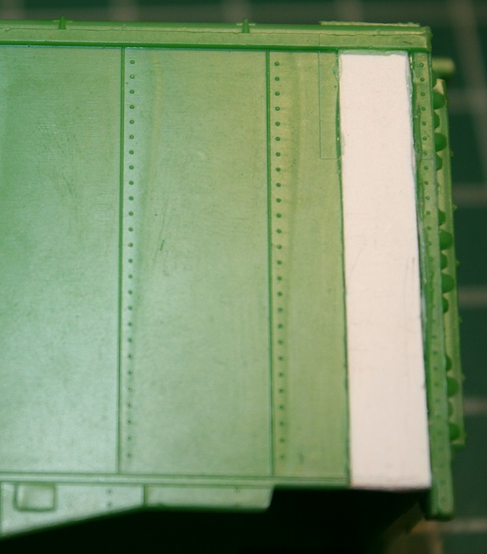

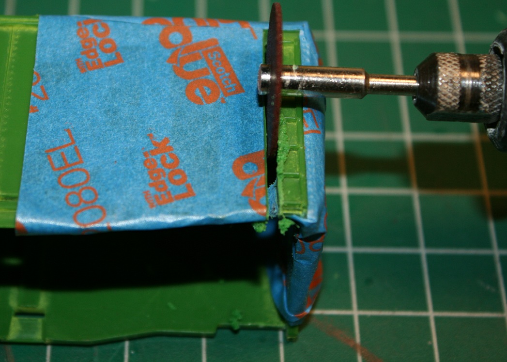

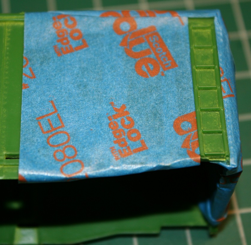

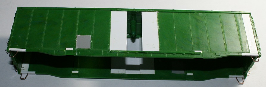

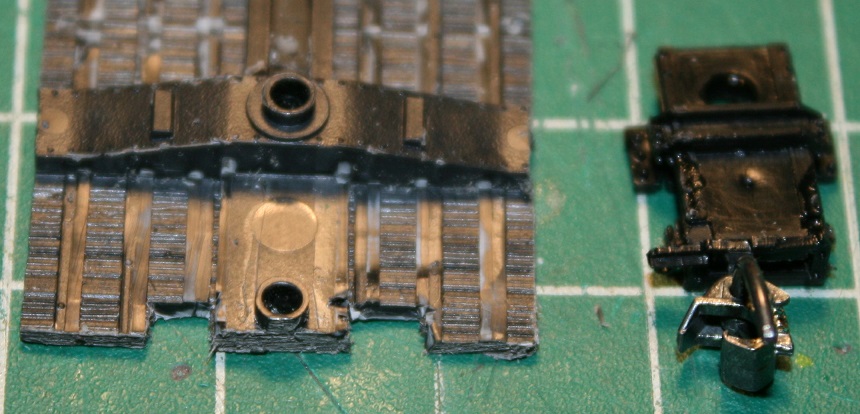

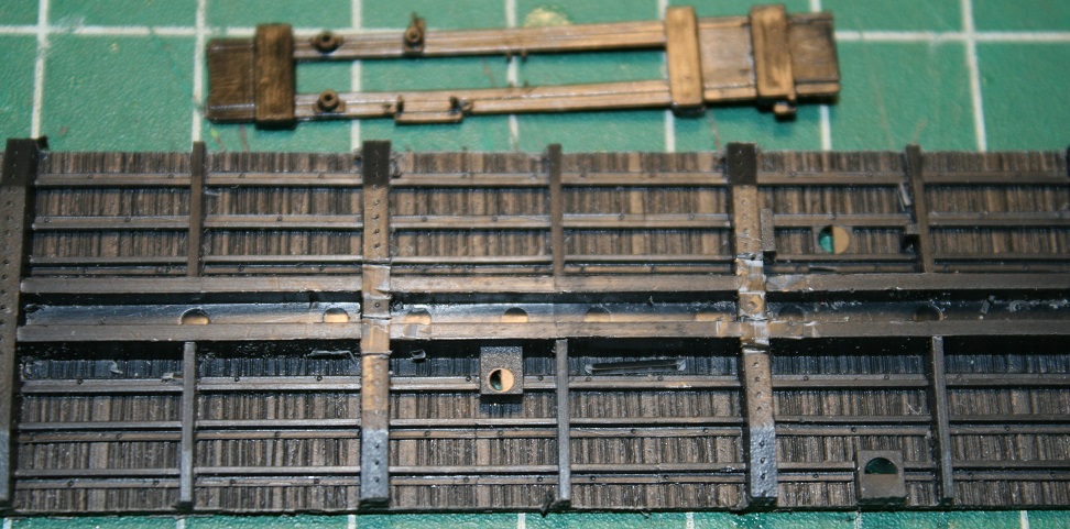

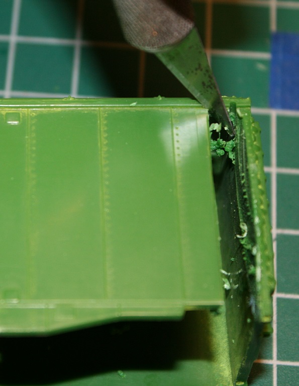

Those of you who have been following this project may have noticed that most of the cars I have rebuilt are decorated in what I refer to as "Dip Job" paint schemes, one solid color on the entire shell. Sure some of my earlier cars may have had black ends or silver roofs, but non of them have been painted in two or more separate colors on the same "plane".
Part of the reason for this is that most freight cars are "dip job" projects" most railroads weren't interested in spending extra money to make their ordinary freight cars look fancy. This simple fact certainly helps modelers for it saves us a lot of extra work and time masking and painting.
However, during 1960's the railroads began to get more image conscience and started painting their new and improved equipment in splashy, bright, multi-colored paint schemes that stood out in a train of otherwise single color cars. I would be remiss if I didn't take on some of these bolder paint schemes in my plugger rebuilding project!
As I mentioned in an earlier message, I am going to take on Santa Fe's Shock Control and Rio Grande's silver and orange schemes. A cursory glance at the prototypes will reveal that an accurate model will need straight lines on the color borders and detail highlights on the safety appliances (i.e. The Santa Fe Shock Control cars have black grab irons and ladders over the red sides and the Rio Grand cars have orange grab irons and ladders over silver sides).
In other words, a good final result depends on perfect masking!!!
The trouble is that masking can be difficult to do accurately when you have to contend with "molded on" details, especially the end ladders! This problem is compounded when the end ladders need to be painted separately!!!
There is an easy way around this however, simply remove the molded on ladders and replaces them with separate detail parts after painting!
This is how I do it....
First, mask off the detail you want to remove. This is an important step because it helps you see the cut lines and the tape protects the shell surfaces that may get marred by melted plastic....
Second, using a motor tool with a cutting disk, make your cuts along the cut lines, do not linger to long with the cutting tool because the plastic will warm quickly and unwanted distortions may occur on shell, especially when you cut so close to the car's end!!! SAFETY FIRST!!! USE EYE PROTECTION!!!
Third, once you have the main chunk of unwanted material removed, use a sharp knife to clean up the edges (HELPFUL HINT: re-insert the original Tyco frame to help reduce stress on the shell for this step)...
Finally after making the cavity on the shell all clean and square, use a strip of styrene to replace the removed portion of the shell, use plastic putty to seal any cracks and fix nicks...
The shell is now modified to make paint masking much easier, when painting is complete, replace the removed detail with separate detail parts!!!

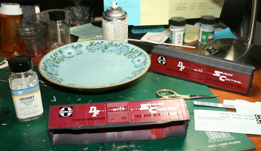

 Posted - March 26 2016 :  8:42:14 PM Link directly to this reply  Show Profile  Add Srenchin to Buddylist

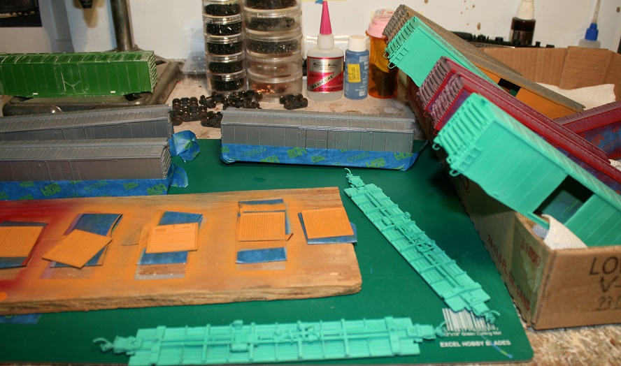

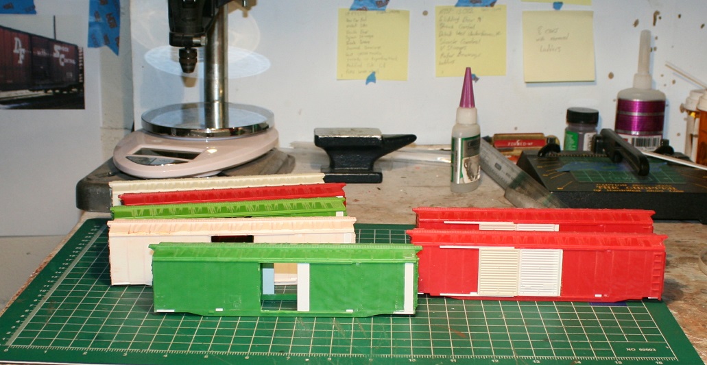

If there was one skill I wish I had but seem to have no aptitude for it would be " multitasking " , the ability to handle multiple project at the same time without screwing any of them up. I am a terrible multitasker, if I have too many irons in the fire at the same time I end up burning the proverbial curtains with one of them.
This deficit in my personal skill set came into play today as I was working on my Plugger Program. I currently have three types of cars that I am working on all at the same time and they all require unique detail modifications compared to each other.
Usually I just use "post-its" to keep my notes straight, but for this batch I need pictures. More importantly I needed my pictures organized in such a way so that I could reference them quickly as I moved from one car to another.
The solution is an old TV and movie cliche, the "wall of pictures and notes", a classic prop for any detective or conspiracy drama...
Well, whatever works to keep things on the right track!

 Posted - March 27 2016 :  2:05:13 PM Link directly to this reply  Show Profile  Add Barry to Buddylist
Fine work Scott. I like your photo story on removing the ladders and filling in with styrene.

Well I am still "plugging away" on this latest batch of rebuilds, here is a picture of my work bench with some of the new shells....
The double door cars will be Union Pacific Automobile Boxcars and the others will be Santa Fe Shock Control cars, not pictured are my Rio Grande Cars.
Stay tuned as things progress!

One of my all time favorite freight car prototypes is the classic Santa Fe "Shock Control" boxcars that were introduced in the 1960's. With their bold graphics, bright red paint, and billboard style advertisements for "A Smoother Ride For Freight", these cars certainly stood out in any train! I would clearly be remiss if I didn't include some Shock Control cars among my rebuilds!
The Shock Control cars were so named for the Hydra Cushion "floating center sill" technology they were built with. Unlike the after-market add-on cushion devices that were being installed on older boxcars, the Hydra Cushion system was built right into the boxcar's center sill. In order to represent this cushioning system on my models, it is necessary to modify the accurail frames with Cal-Scale's "Hydra-Cushion" detail kit.
The Cal Scale Hydra Cushion kit part # SC-301 is shown below, the main components include the draft gear pockets, air cylinder and slack adjuster, central and end frame covers, and the distinctive hydra cylinder. Other goodies in this kit include a brake wheel set, end ladders, end walks, and even uncoupling lever brackets!
The instructions are straight forward, interestingly there is a special note (high lighted in orange) about modeling Santa Fe Shock Control cars...
Start by modifying the coupler pockets as shown in the instructions....
The new coupler pockets simply snap together and then are secured to the frame by using the Accurail draft gear screw...
Installation on the Accurail frames is a bit tricky, some of the frame detail needs to be trimmed to get the frame covers to lay flat on the center sill.
This is what the kit looks like for a Santa Fe car, note the lack of the Hydra Cylinder...
In my next post I will install the rest of the under frame parts and then mate the Tyco shell to the modified frame, stay tuned.....

 Posted - April 07 2016 :  09:56:28 AM Link directly to this reply  Show Profile  Add Srenchin to Buddylist
Well I ran into some snags with my Santa Fe Shock Control cars, turns out that the Cal Scale Hydra-Cushion detail parts interfere with the trucks when the car is negotiating 18 inch radius curves.
The solution is easy though, simply trim back the detail parts as shown in the photo below to allow free movement for the trucks...
I also notice that the wheel sets on my roller bearing side frame trucks will come into contact with the Accurail frame on tight curves. This is also easily fixed by adding a small notch in the frame bolsters as shown in the photo above.
And this folks is why you test your work on the layout while building your projects rather than waiting until everything is done!!
Edited by - Srenchin on April 07 2016 09:57:56 AM

On a better note I got some weathering done on the CNW car today, while doing that I noticed that I had lost the brake wheel. Have to order some more when I can and a few other things. I hope to post some pictures of some of the stuff I have been working on this weekend.

I have finally finished modifying the latest batch of shells, here is a picture of the shells after a soapy bath to remove finger prints and dust....
Next step, painting! Stay tuned.

Srenchin
CNRedAvatar
 Posted - April 24 2016 :  10:13:54 PM Link directly to this reply  Show Profile  Add Srenchin to Buddylist
Hello all,
I have been distracted by other model railroading projects so the work on my Plugger program has slowed down a bit, but it still continues!
My latest experiment involves removing the molded on tack boards...
I am using the same "cut and plug" technique that I am using to replace the side ladders.
On my next weekend I will start painting, stay tuned...
Edited by - Srenchin on April 24 2016 10:14:27 PM
 Country: USA  ~  Posts: 822  ~  Member Since: December 26 2009  ~  Last Visit: November 20 2026 Alert Moderator  Go To Top Of Page

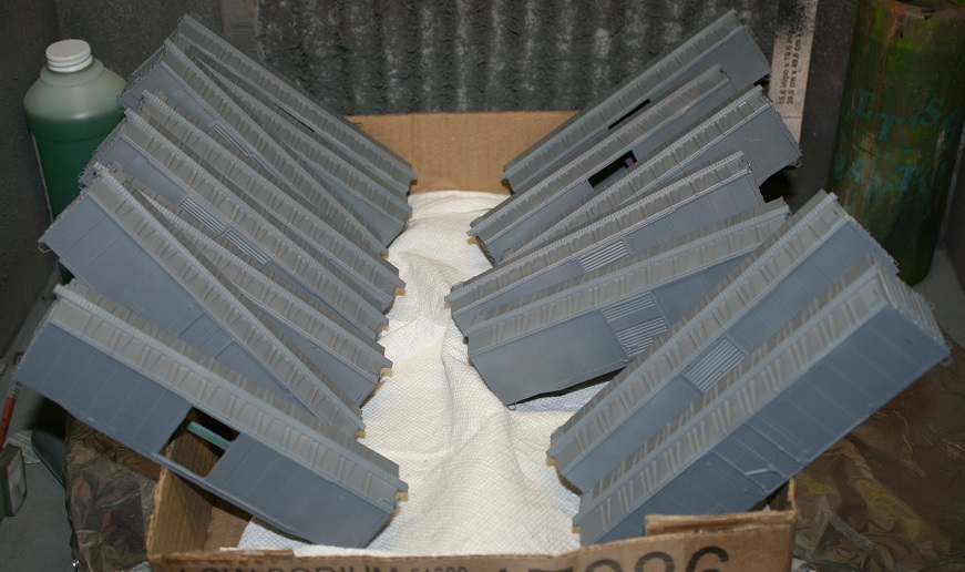

Srenchin
CNRedAvatar
 Posted - April 29 2016 :  5:24:40 PM Link directly to this reply  Show Profile  Add Srenchin to Buddylist
More progress, I just finished primer painting 15 cars! Take a look...
Stay tuned for more developments...

 Posted - May 26 2016 :  11:48:34 PM Link directly to this reply  Show Profile  Add Srenchin to Buddylist
Hello All,
Sorry I have been away for a while, I needed a break from my rebuild project so I took some time off to do some other model railroading projects. Any way, I am happy to report that my rebuild program is back in full swing, I am currently working on 15 cars at the same time!!!
Here is a photo with some of my current rebuild projects....
Stay tuned!

 Posted - July 28 2016 :  4:48:15 PM Link directly to this reply  Show Profile  Add Srenchin to Buddylist
Hi all,
It has been a while since I have posted any updates for my Plugger rebuild project but things are back on track.
Today I just finished five more cars that I had been keeping on the back burner for over two months, here they are....
Note the "Hydra Cushion" details under the GN cars.
Next up will be some Milwaukee Road, Denver and Rio Grande, and Santa Fe cars!
Stay tuned!!

Here is a preview of my Santa Fe Shock Control cars.....
This is one of my favorite railroad paint schemes, I can't wait to see them completed!!
Stay Tuned...
