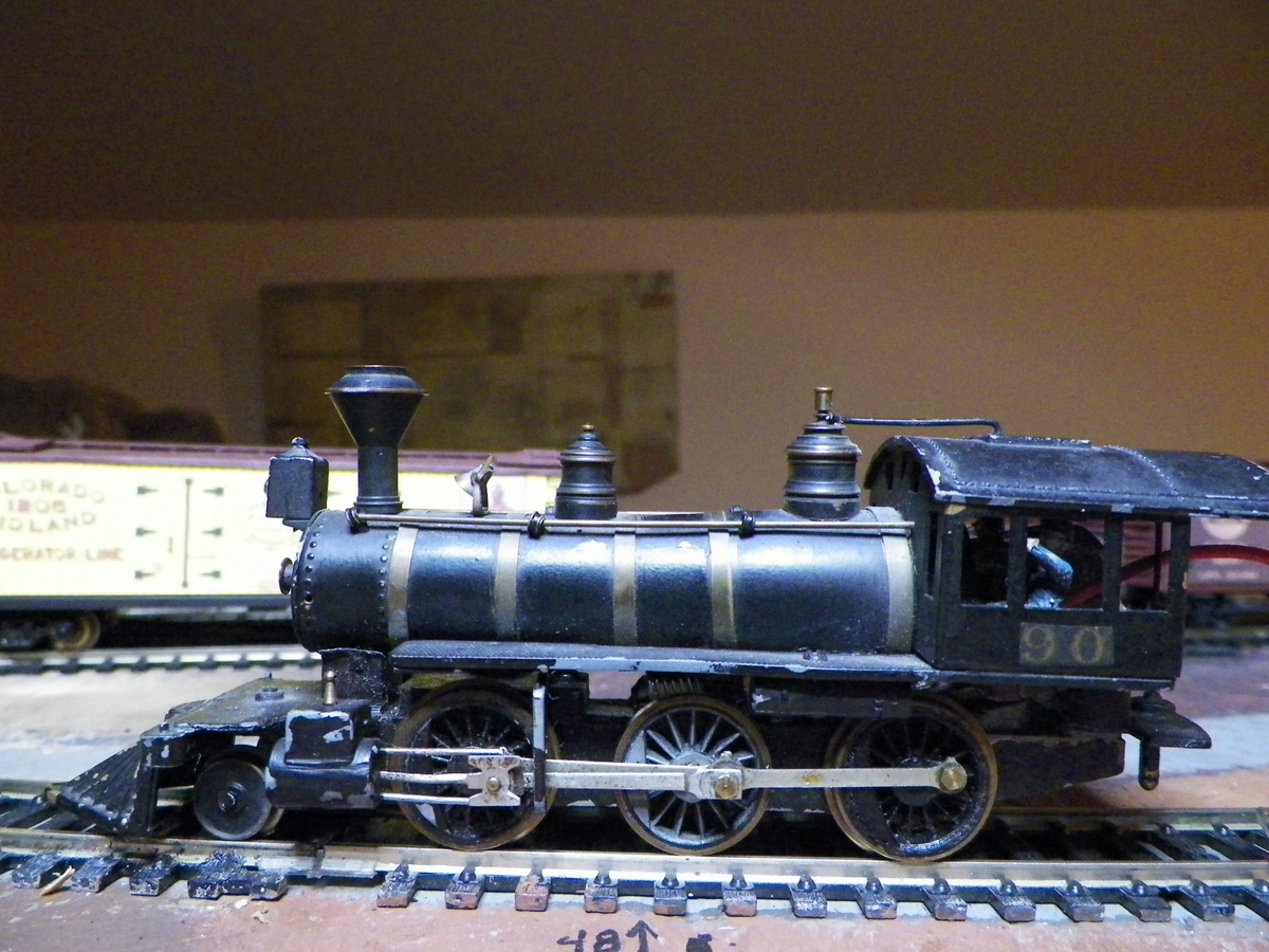

Couldn't control myself and jumped on this Mantua Metal Products 2-6-0 with the old style accoutrements; stack, light, domes. Even came with a couple old Weston crew members. I haven't done a thing to it yet; this is just the way it came. No tender, but I had one. Not sure whether Mantua made a 2-6-0 with these things or maybe the builder grabbed some parts from the Belle? One thing I want to decide is whether to render it as a wood burner or a coal burner. Plenty in store for this winter; see what gets done.
 Posted - August 27 2015 :  9:07:03 PM Link directly to this reply  Show Profile  Add Barry to Buddylist
After looking on hoseeker, it looks like the old time parts came from the Belle 4-4-0. Now I'm leaning to replacing the stack and making it a coal burner. And probably ditching the bands on the boiler, which seem a little wide to me.

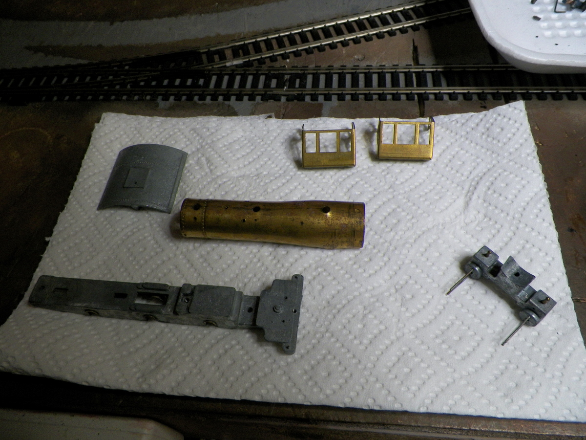

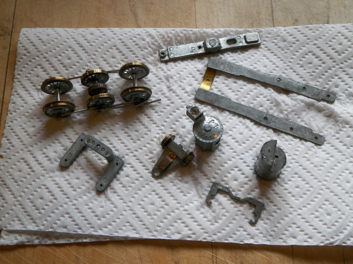

 Posted - September 07 2015 :  12:42:33 PM Link directly to this reply  Show Profile  Add Barry to Buddylist

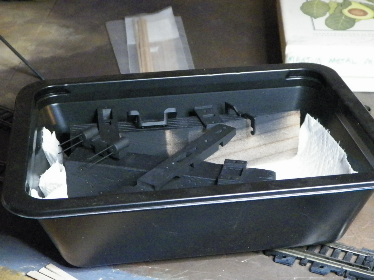

Wrapping up the paint removal . . .
Still need to get after the motor, but so many outdoor things to be done while this summer lingers.
A nice selection of Belle of the Eighties parts. Now I'm thinkin' maybe I want to chase down a frame and the few other parts that could complete a Belle model. That should only take a few months, hey? I could dig a Belle pullin' a consist of High Ballers old time coaches and combine. We'll see what happens with that.

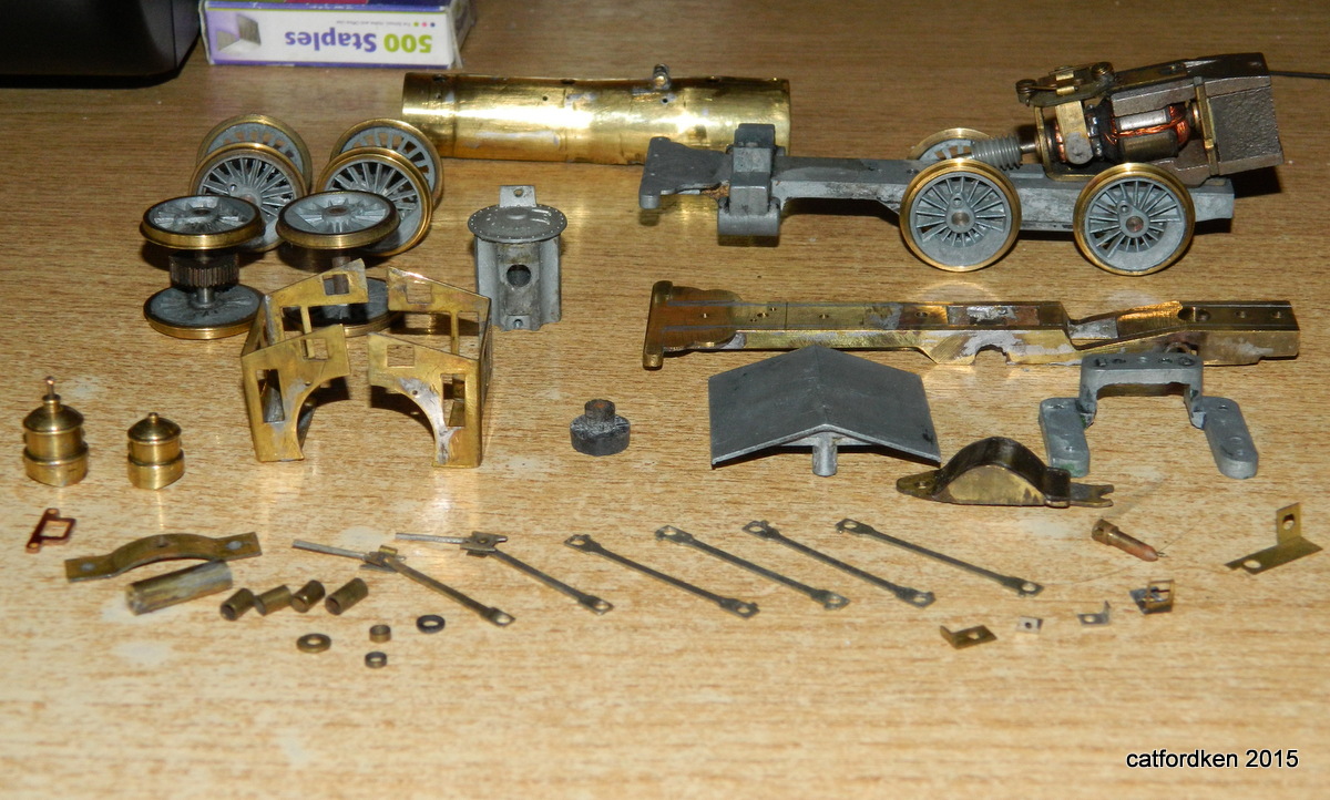

what bits do you need barry pm me got a few spares,picture shows a few

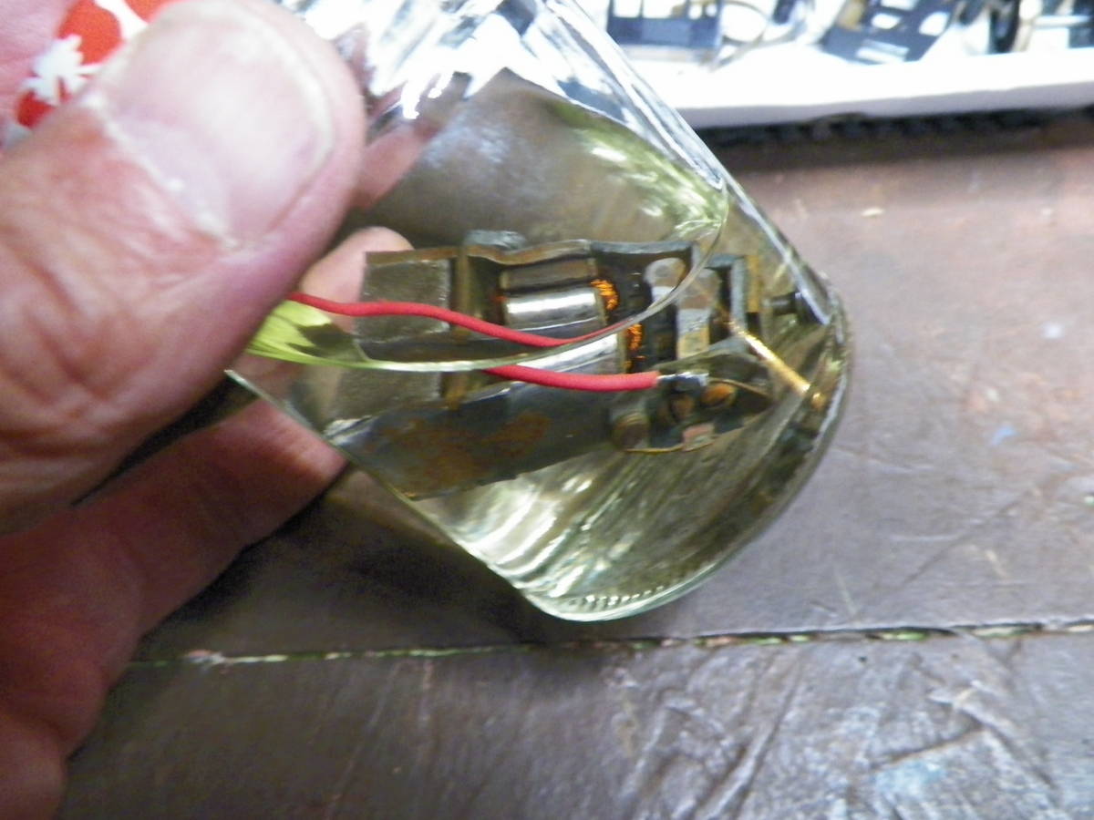

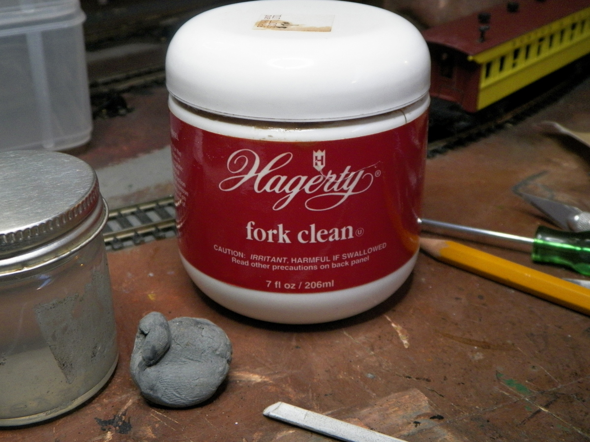

This jar of "Hagerty Fork Clean" is something that I got years ago at a jewelry store to clean the brass reeds on harmonicas. It works real nice for cleaning brass, but you don't want to leave things sit in it overnight or anything long. Supposedly it will "eat them up". I usually go up to a minute and then maybe re-dip. Rinse well after. Cleans brass up pretty nicely.

So it's been a few weeks. In the while, Ken and I did a swap and I now have the pieces to complete this model as a Belle of the Eighties . . . and now the title for this thread is going to be incorrect, but I'm going to continue here to do this photo story in one thread. I'm diggin' the idea of building a Belle. Also been busy with household chores, though, so this is going to be a slow build . . . unless I adopt a Devil-May-Care attitude, hey? I like that the drivers on the Belle are 72" (I haven't measured the Mogul drivers, but I'm guessing like 60"?). This locomotive has some potential to strut some muscle.
Here's a couple photos. Getting the steam chest mold marks cleaned up and thinking about getting the frame and running gear together and motoring this thing up.
 Posted - October 06 2015 :  07:45:05 AM Link directly to this reply  Show Profile  Send catfordken a Yahoo! Message  Add catfordken to Buddylist
good guess barry very close,61-1/2 inch drivers,ken

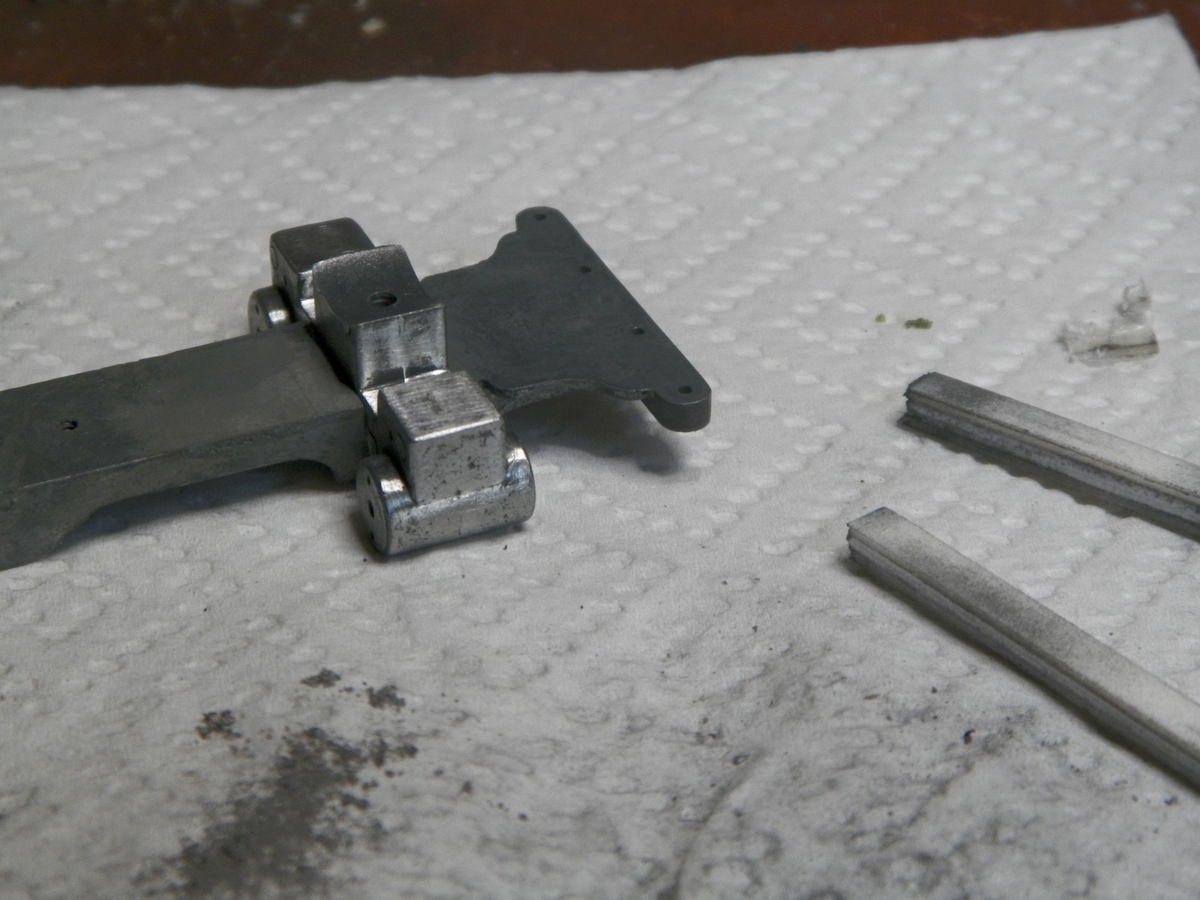

Need to do a little work to the guide bar yoke. (These little cast yokes are really fragile. I guess that's why many times, you get a Mogul or a Belle with a missing one. The one's I've cut from brass aren't as precision, but you have to put a little more thought into breaking one.) It's one I had from the Mogul. The alignment with the guide bars seems the same, but the method of mounting it is different. The Belle frame doesn't have a "slot" that the yoke fits in (whereas the Mogul does). So the photo of the little brass piece (from a Mantua couple set), that's what I'm going to trim up and then super glue to the yoke. That's my plan so far. If it looks real pretty, I'll post a photo of it. Then there's a few different colors of green I'm lookin' at for the cab and boiler ? ? ?

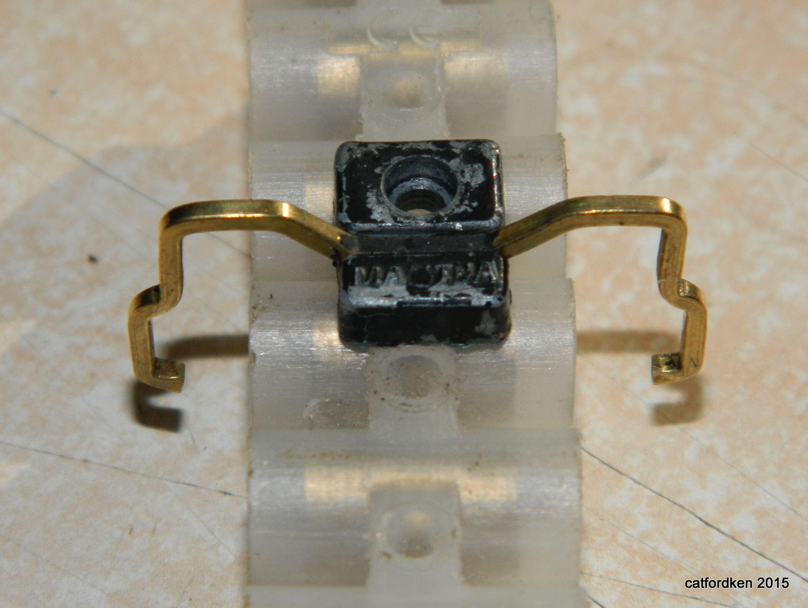

hi barry this one came with the belle parts box i received ken

 Posted - October 08 2015 :  11:33:28 AM Link directly to this reply  Show Profile  Add Barry to Buddylist
Wow. That's quite a mounting lug on that yoke Ken. This photo shows what I came up with for the mounting lug that I'll super glue to the yoke (if that glue doesn't hold, maybe I'll try a tiny brass pin with it?). Then, the other things in this photo are the running boards from the Mogul that have mounting holes for Mogul equipment filled in with JB Weld. I briefly considered leaving them and mounting the equipment on the Belle, but I decided to leave it "stock" as much as possible presently. The clamps are holding the yoke which is slightly warped. We'll see if this works. I figured about the time I applied enough pressure to bend it, I'd break it. Maybe apply some heat? The dark red is what I'm considering for the drivers presently.

Got the mounting lug fastened (though should cure more) and went to drill more cleanly through lower guide bar hole and the fine edge wall cracked, so aborted the drilling to reinforce the wall of the hole with some JB Weld. These things reminding me to be patient and that another reason for missing yokes is that they broke before the model got assembled? Pluggin' away at it . . .
Looks like maybe I should fill in those mold depressions on the yoke while I'm at it.
 Posted - October 08 2015 :  7:26:12 PM Link directly to this reply  Show Profile  Add Barry to Buddylist
By the way, I put that yoke in the oven while it was still clamped between the metal plates as in the earlier photo; preheated to about 300 and then turned the oven off as soon as I put the package in and left it maybe a half-hour. Maybe it was sheer luck, or a coincidence, or whatever, but the warp is out of the yoke. I'd like to think heat facilitated that?

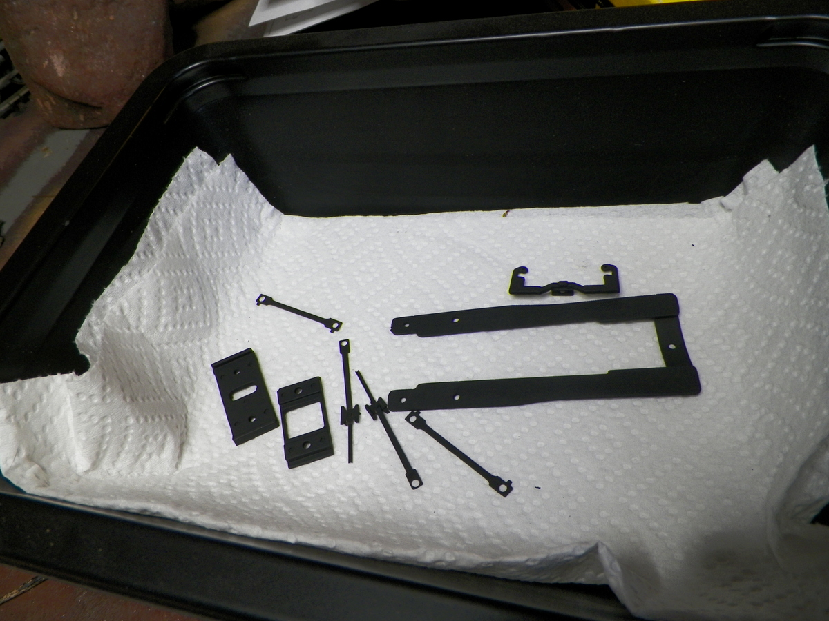

 Posted - October 14 2015 :  3:13:02 PM Link directly to this reply  Show Profile  Add Barry to Buddylist
I decided it was time to do something, being yet undecided about paint scheme. So I went for good old black for the frame and such. This needs another spray yet. Basic Testors flat black.

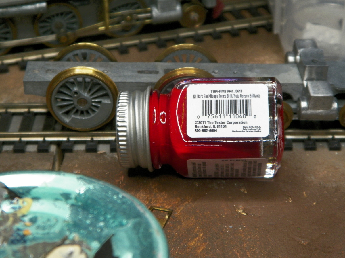

 Posted - October 15 2015 :  8:41:00 PM Link directly to this reply  Show Profile  Add Barry to Buddylist

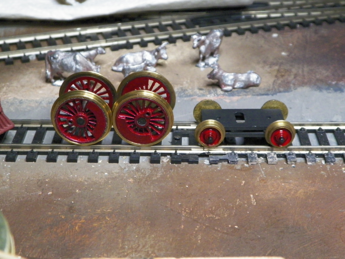

Temptation got the best of me today and I busted open the bottle of Testors dark red thinking worse case scenario, I could remove it. Now I'm kind of liking it.
 Posted - October 15 2015 :  10:08:00 PM Link directly to this reply  Show Profile  Add scsshaggy to Buddylist
That particular shade of red (bordering on maroon) is a color that some railroads used on crack passenger cars. It'll make the new engine look like the queen of the fleet. That's appropriate to the name "Belle of the 80's."
It looks like you're going to dress the old girl up in regal fashion.
 Posted - October 16 2015 :  12:48:44 PM Link directly to this reply  Show Profile  Add Barry to Buddylist
Yeah Don. I was thinkin' it could look pretty fine if the driver's had a little pin-striping; maybe even whitewalls, but I'm a bit skeptical of making a mess out of them. I am going to try to have it exude the flavor of an 1860's locomotive, just maybe not one that Baldwin really dressed up. Put some brass paint on the plastic pilot wheels (one side actual brass/one side plastic). Looks a bit funky to me presently, but I'm thinkin' when that paint has hardened good, I can sand it off a bit, and then with the accumulation of a little rail dirt . . .

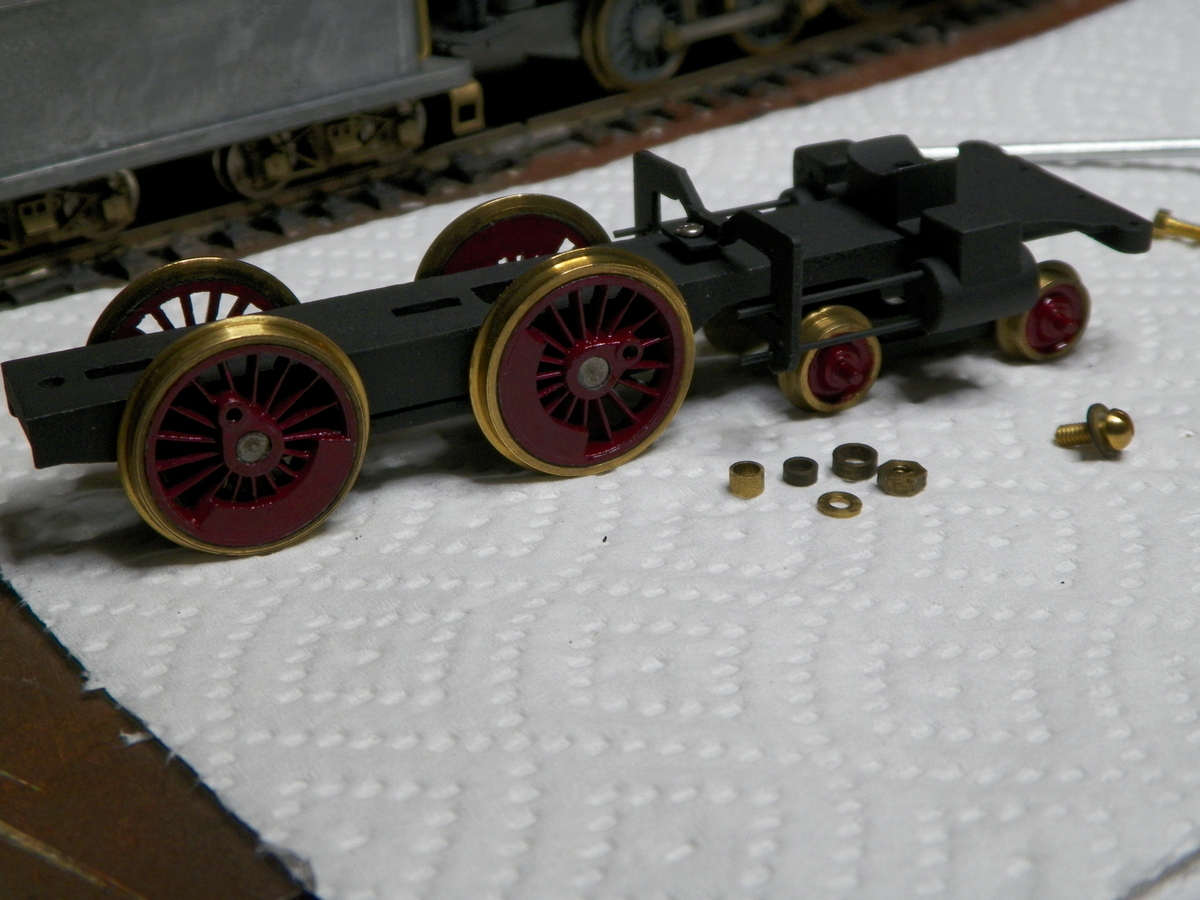

 Posted - October 22 2015 :  10:46:33 PM Link directly to this reply  Show Profile  Add Barry to Buddylist
A bit of assembly. It's going slow because of other projects, but I should enjoy this like a fine cigar or glass of whiskey.

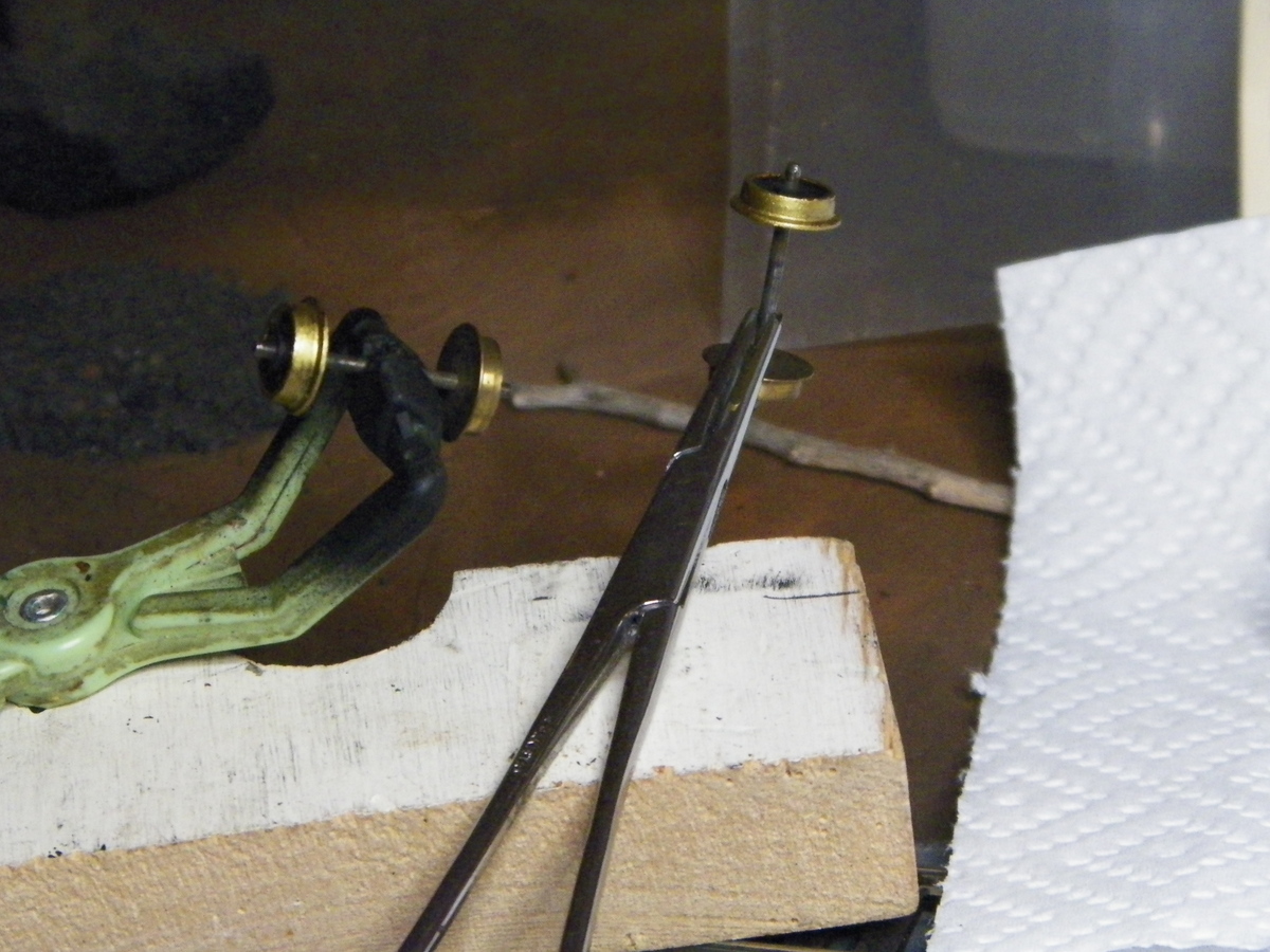

Also had been looking at (scrutinizing) the hubs and jumped ahead and painted them black. Considered brass, but I didn't think I could get it to match the brass in the drivers.

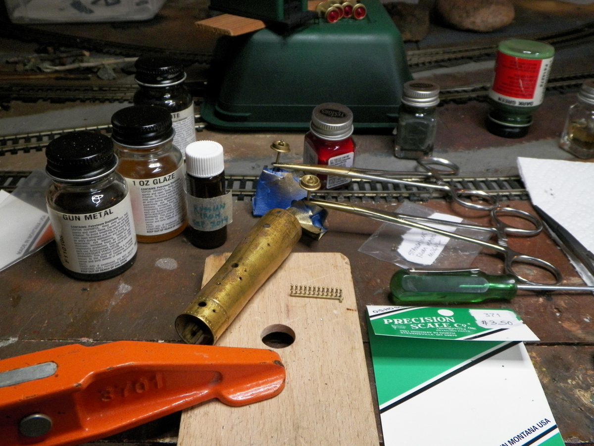

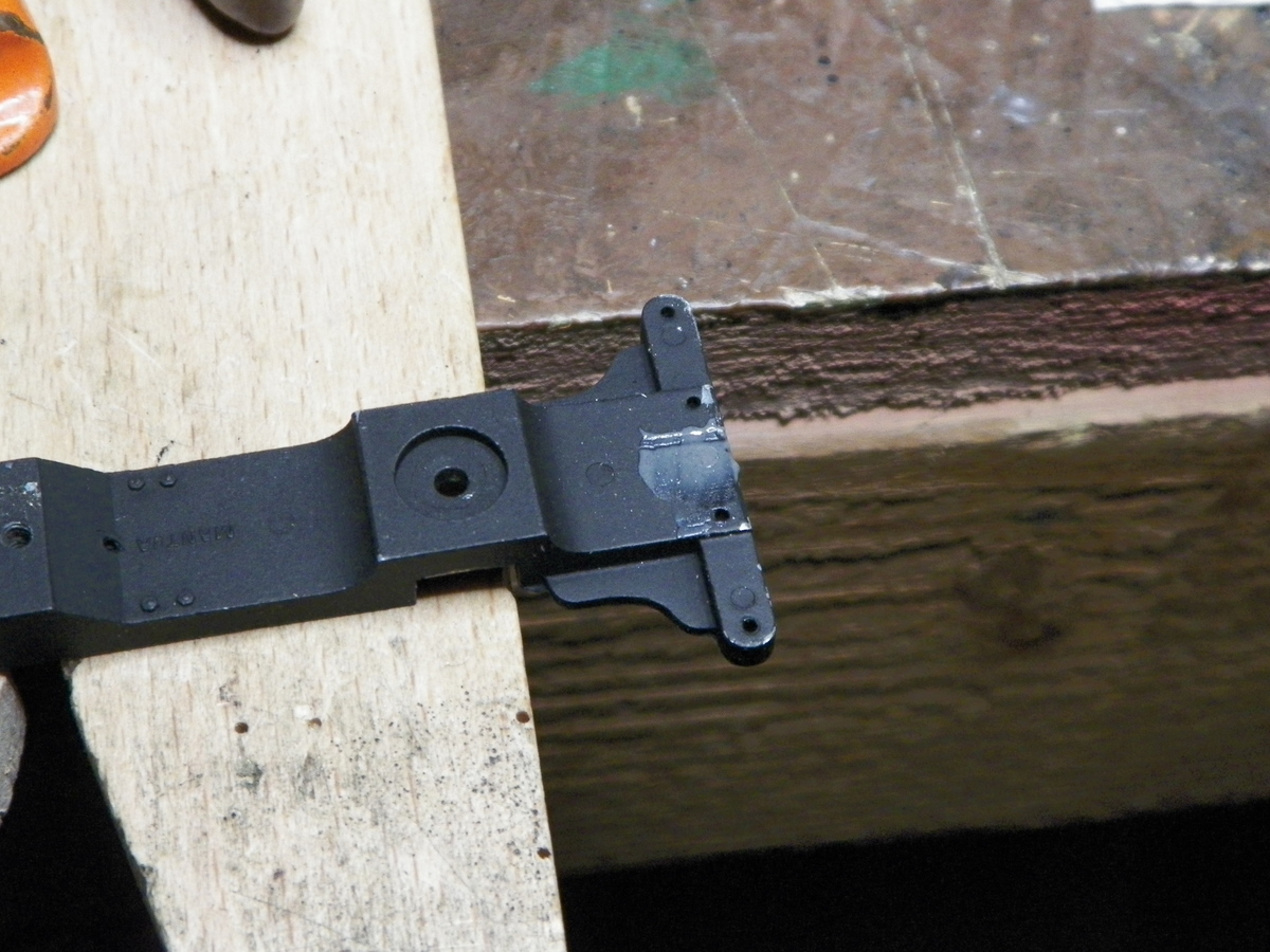

Some progress with the repair. Re-drilling the filled hole worked despite the fact that the drill migrated to the original hole. But it did take out a bit of metal along the way and the path is straighter and the pilot hangs straighter and the new threads work smoothly. Regluing the mounting lug to the guide bar yoke (after scoring the surfaces to be joined a bit more methodically) seems to have worked; strong enough to allow me to file the mounting hole out a bit since my alignment of this tiny part was less than perfect.
Looking through what trucks I have (that will conduct electricity well). I came across these that I may use to start ? ? ?

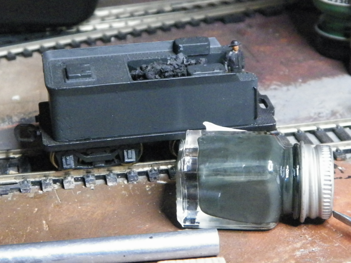

The tender frame needs a bit of work. The mounting hole on the right for the frame that hangs around the coupler (one I made earlier from some thin brass) is not quite in the right place and is stripped. Since this photo I've filled that with JB Weld for redrilling (we'll see how this one works out) . . . #90 hex head screws.

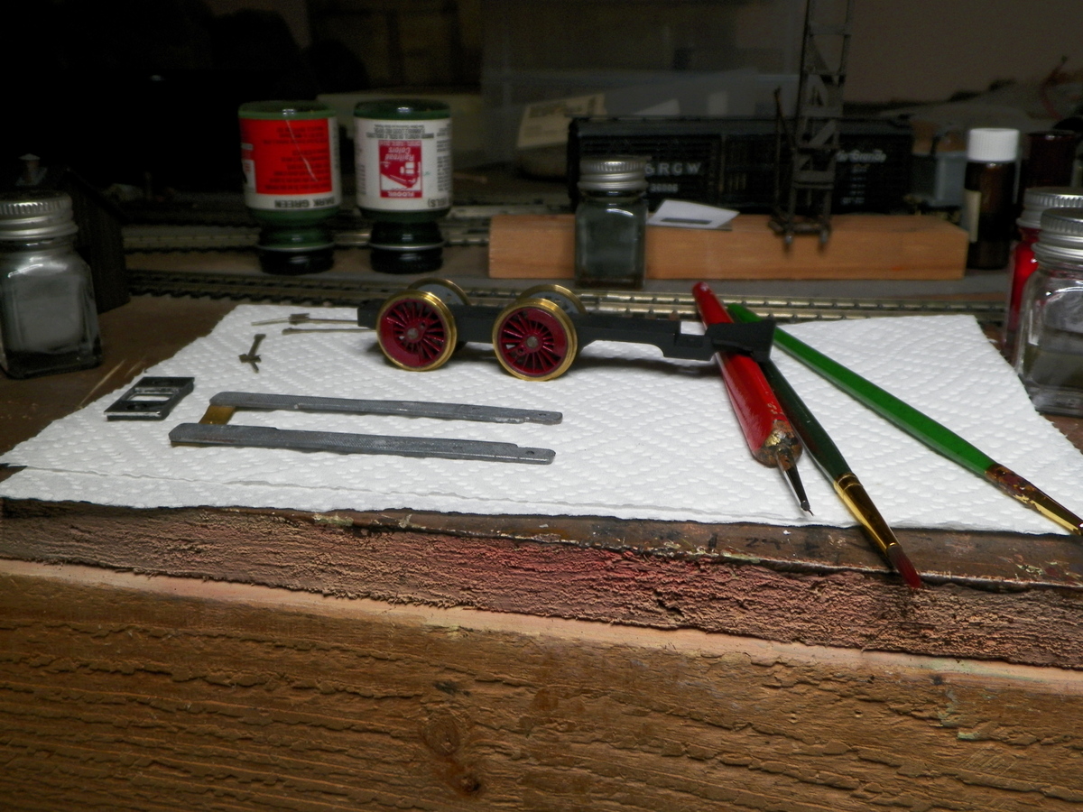

And here's a tray of parts ready for painting. We're in a bit of a cool spell today, I'd like it at least to be around 70 outside. These parts will all be flat black.
Here's the shop . . .
Happy Monday.

[The wheels in the parts to be painted tray wont be flat black. I'm going to see what "Rub n Buff" brass will do on the wheels and then go for the dark red in the center. I'm hoping the Rub n Buff will be a bit less 'granular' in appearance than brass paint ? ? ?]

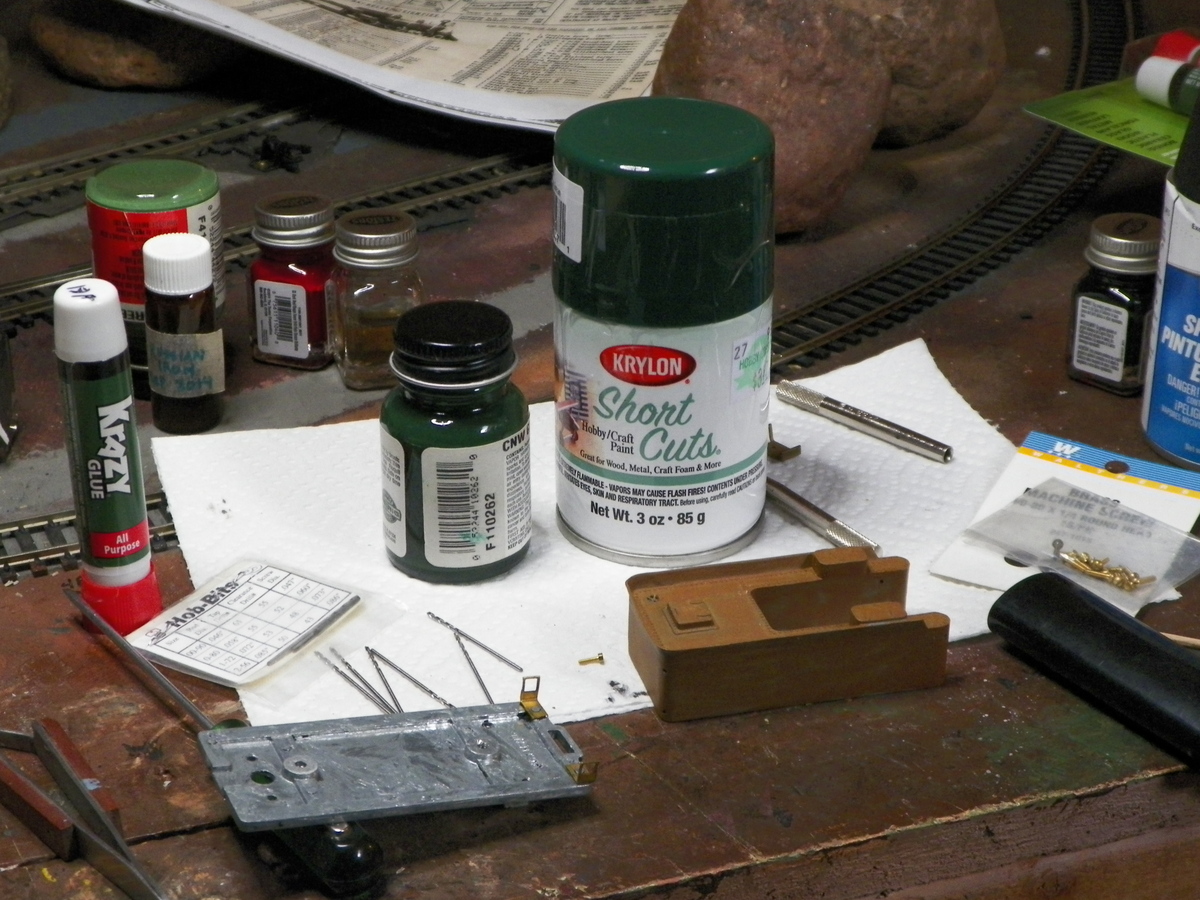

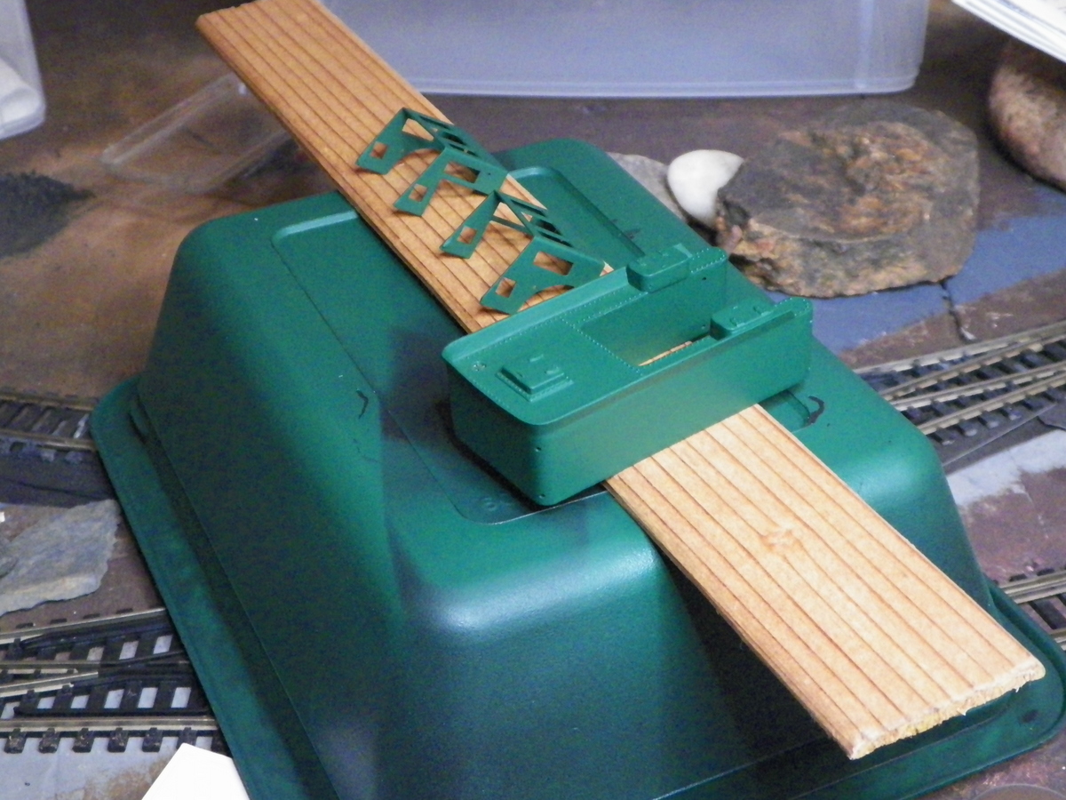

 Posted - October 26 2015 :  6:40:21 PM Link directly to this reply  Show Profile  Add Barry to Buddylist

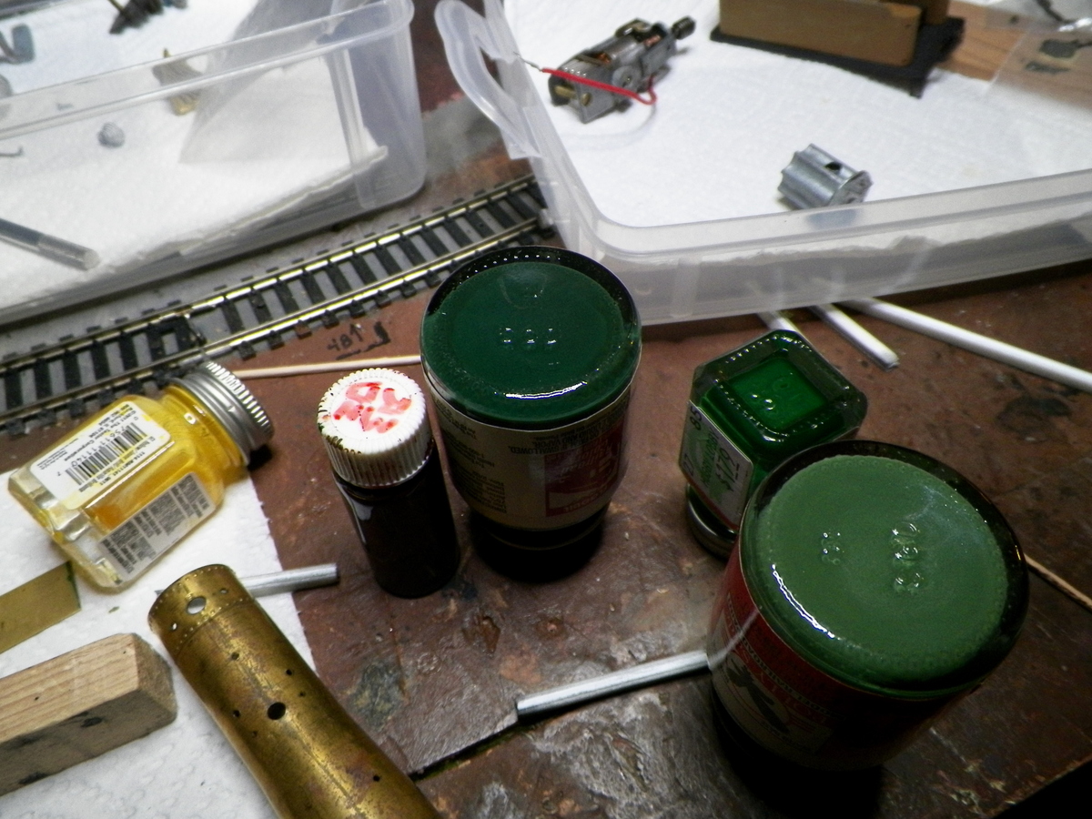

Didn't find Rub n Buff brass at the local supply, but did recall having some brass spray . . . took a chance and sprayed these wheels. We'll see how that works out; realizing I'm going to have to clean the needle tips and the rims.
I did find some paint to try; a spray the dark green near to the railroad paint I had. This will be the first locomotive I spray, but I'm thinking there is a remote possibility I will leave it glossy rather than dull coat like I've done everything in the past. There's always paint remover, hey?

Got the coupler housing bracket re-drilled, tapped and mounted. Once again, the drill wanted to migrate to the original hole [a mini drill press would be useful], but also again, the rethreading of a previously overstretched hole ended up improving the overall alignment of the thing and with a little filing . . .

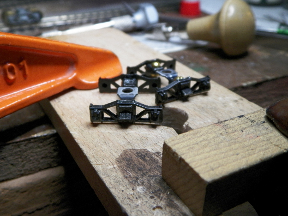

Also, looking further at my previous choice of tender trucks (?temporary?), I think I'm going to go with some Mantua/Tyco tender trucks from the 4-6-0, 4-8-0 era. There side frames pretty much match some of the side frames I think might have come with some of the Belles ? ? ?
In the photo above, the side frames on the unpainted trucks to the left are what I would use, but I don't have a second one presently. The center ones are what I'm going to use; replacing the original wheels with the steel wheels I painted brass color. ?Why did I paint the wheels brass? Guess I wanted them to match the locomotive wheels and I really didn't want to get into painting the drivers black or some form of iron color (though that could be fun to try sometime). The screws in the side frames I'm going to use are from a previous repair . . . before I realized you could gently bend the yoke to remove the wheelsets.
In the photo below, you see a couple of things. One is, that the tender (being used with a Mogul previously posted on this site) is painted "locomotive green". It's formula, from Daryl Ryder, is 1/2 Brunswick Green and 1/2 Pullman Green . . . tones it down a hair from almost black to a wee bit green . . . or something like that. That is the color in the small bottle lying on it's side.
The other thing on this tender are the earlier type trucks (which I could "borrow", but I would much prefer not to . . . or permanently switch between the two, but you know the dangers of handling models more than necessary . . . one mod leading to a couple of repairs ?).
Originally posted by Barry - October 27 2015 :  12:39:52 PM
I've been looking at pictures of 1860's locomotives as they are reproduced, today. Jupiter, Leviathan and U.P. 119 have all wheels painted red. Some foreign countries, such as China, Russia and Germany kept red wheels into the late steam era. I'm told that a red wheel is easier to inspect for cracks than a black one.
Not saying that there's anything wrong with a brassy color, just that red, like on your drivers and pilot wheels, would be pretty typical.
Edited by - scsshaggy on October 27 2015 7:18:03 PM
 Posted - October 28 2015 :  12:42:03 PM Link directly to this reply  Show Profile  Send catfordken a Yahoo! Message  Add catfordken to Buddylist
barry i know its a british 4-4-0 but it contains a green red like yours does,but also black and white,so you can use those last to colours with yours,or even gold

Barry, in your second post you show the motor immersed in a cleaning fluid. Just what do you use?
 Posted - October 28 2015 :  3:02:25 PM Link directly to this reply  Show Profile  Add Barry to Buddylist
Hi Alex, the cleaning fluid is rubbing alcohol (98%, I believe; it comes in a lower strength as well, but since the whole idea is less water, I go for the 98%) from the grocery store. You really have to add elbow grease applied with a toothpick or fragment of something or other, to get to the nooks and crannies. One thing nice about these older motors is that they are mostly screwed together instead of riveted, so you can get them apart to clean them. On this particular motor, which had some surface rust on it (you can still see a stain in the metal), I also used a sanding stick and knife to get things clean. And a soldering iron to remove old solder. I prefer not to solder the wire to the motor; I trap it under the brush spring.
So today so far (see how much more time I can steal from neglected duties; I'm obsessed nowJ) I'm examining the paint work to see what I think. Yeah, Ken, I dig the colors on those UK locomotives. Although I've only seen photographs, it looks to me like the British are a bit more adept at locomotive restoration . . . perhaps due to the monarchy?
I dig the pin-striping on the wheels. I was noting that yesterday on a stagecoach here in town. At this point, I'm not ready to attempt that, but maybe I should get a tiny brush and play on some scrap ? ? ?
Thinkin' about what color the cab interior might be?
Layin' out some things for boiler hand rail stanchions and some paint work. The Russian Iron is 50/50 Gun Metal/Glaze (per Daryl Ryder; he's a model builder and painter and decal maker who's done a bunch of Colorado Midland work). The Russian Iron works pretty fair if you get it applied in a good manner and don't have to mess with it after. I'm thinkin' the smoke box is going to be graphite. The wheels next to the boiler are the pilot wheels. I decided the sprayed brass looked better than my previous brush work (which I had also coated with glaze; thinking it would make the brass look more real . . . it didn't by me), so I removed the previous paint from the pilot wheels and sprayed them brass.
