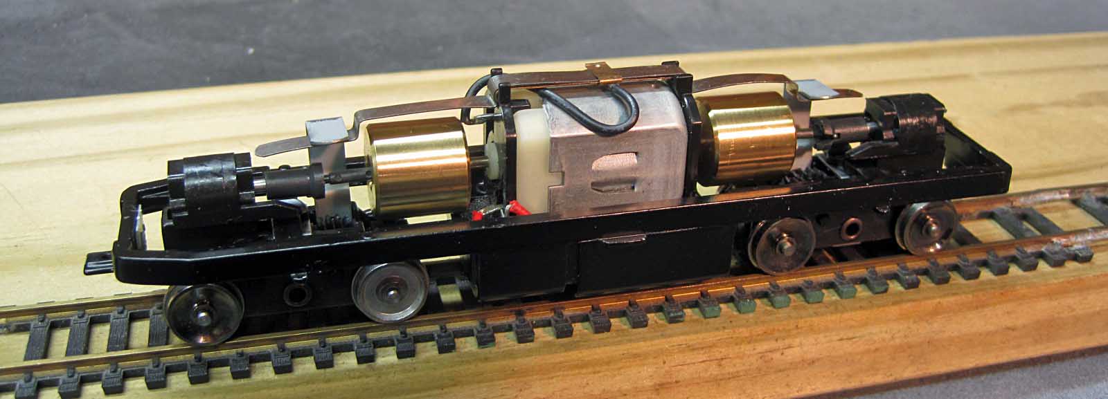

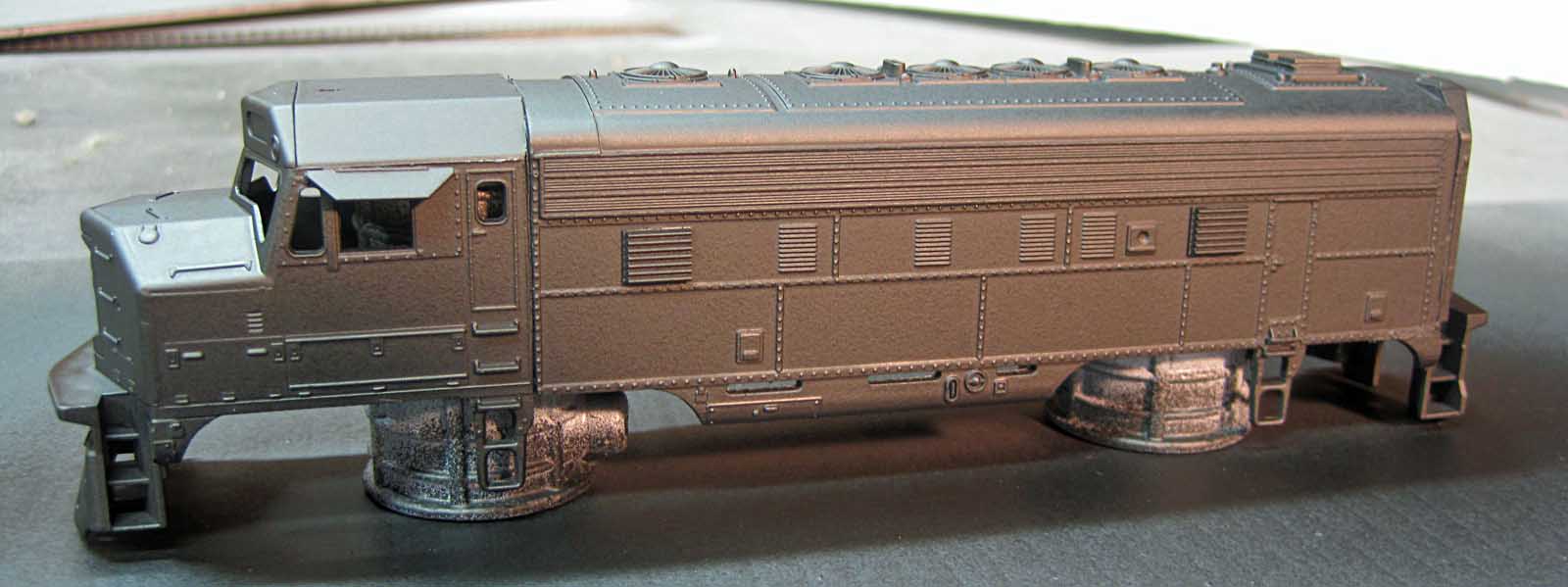

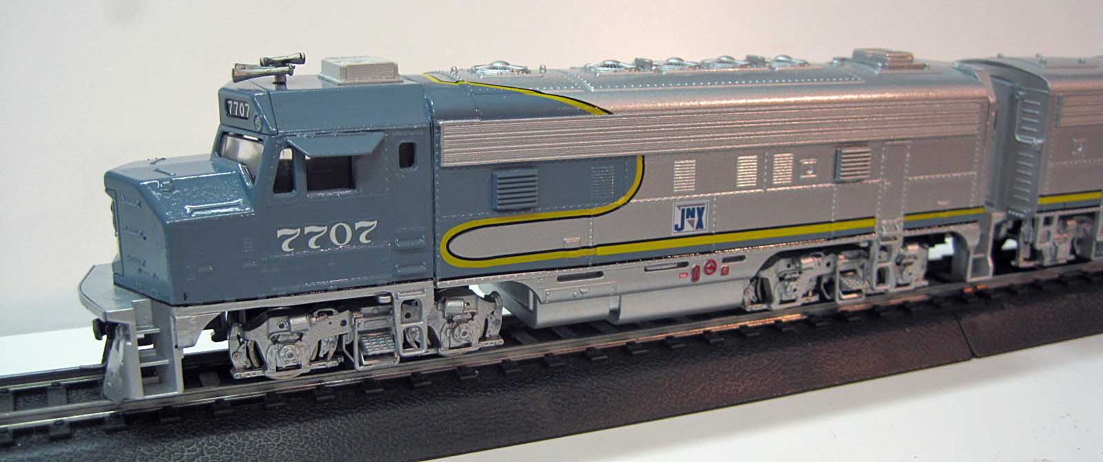

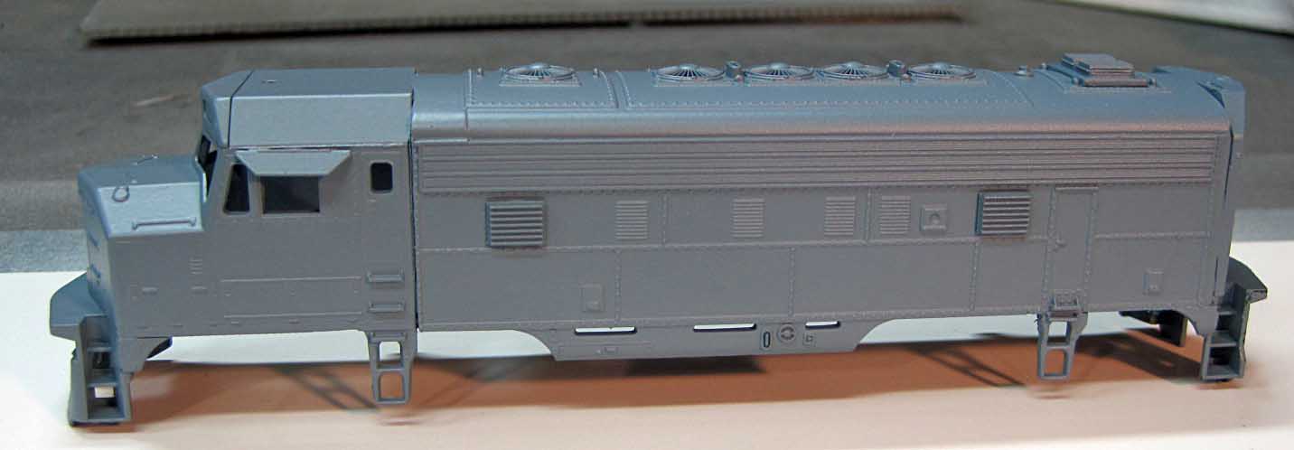

This is what happens when you have a F7A you're not sure what to do with and a spare F45 shell waiting for something to do.

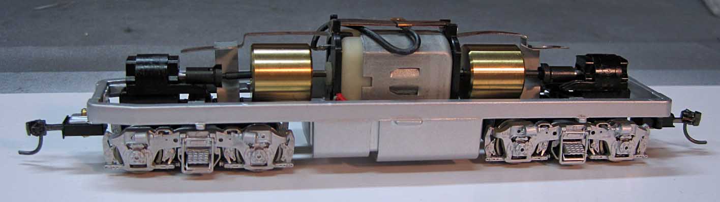

It started life as an Athearn John Deere F7A, that wasn't running - was missing one wheel. Taking it apart, the axle gear was broke in half as well. Was a simple fix replacing it with a spare axle gear/wheel pair, and it runs smooth and quiet.
I have never seen an Athearn like this one though, with the can motor. This is production, not a remotor.
I haven't decided what to paint it yet, will probably go with the home JNXT road since it is such a fantasy bash, although I can see the possibility of a shop doing something like this. as for that, I'm still wondering what to call it???

That motor looks like one found in an IHC GG1....

Sshaggy - yes the Crandall cabs did partly inspire my creation, plus I had always wondered if I could do it.
I love projects like this, creating something entirely different. And judging from photos I have seen of real railroad shops making 'oddballs', I figured why not? Entirely believable.
Have to admit I had a moment of hesitation before I made the first cut with the razor saw though.....

Looks a bit like an F40PH commuter loco. That's a Mabuchi motor, and I think they used them in their RTR line. They no doubt got the idea from IHC / Mehano, who used the same motors. They're quieter and draw less than Athearns blue box motors.

I've always liked the "oddballs". This is what I think the CF7 should have looked like!
But with that in mind, it is in fact NOT a CF7. So I am wondering what to call it. CF7 stands for "Converted F7", which it is...but to call it that would be misleading. Maybe add a suffix letter, as in CF7J....or go at it from the other end, and call it a CF45....
These little details drive me up the wall

A little progress report, not a lot to show but I know where I'm going with it now. With a spare Athearn F7B shell with a Globe dummy chassis available, I decided it needed a B unit. I finished it yesterday.
The lead unit shell has been painted in the base JNXT blue, waiting to be masked for the war bonnet color scheme.
The chassis has been painted silver, replacement sideframes added for the two that were missing, and long-shank Kadee couplers installed.

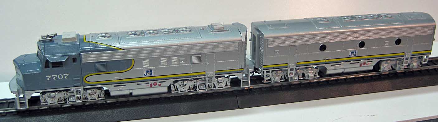

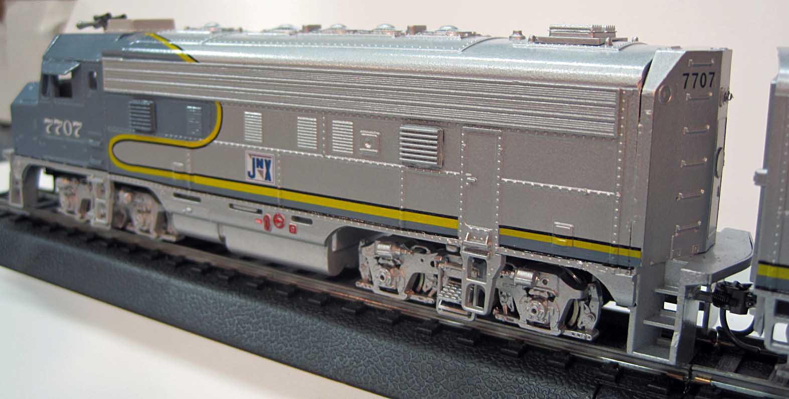

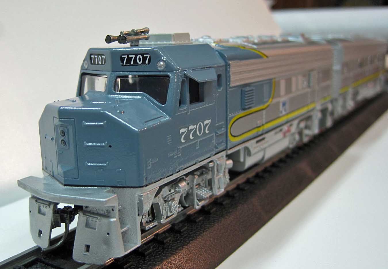

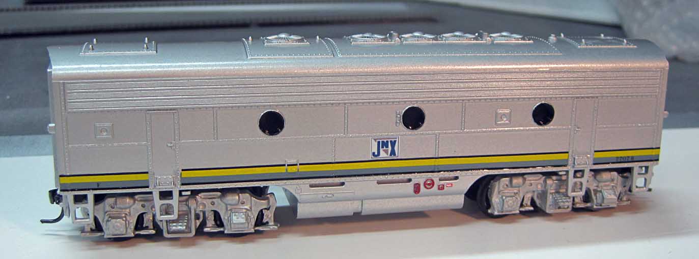

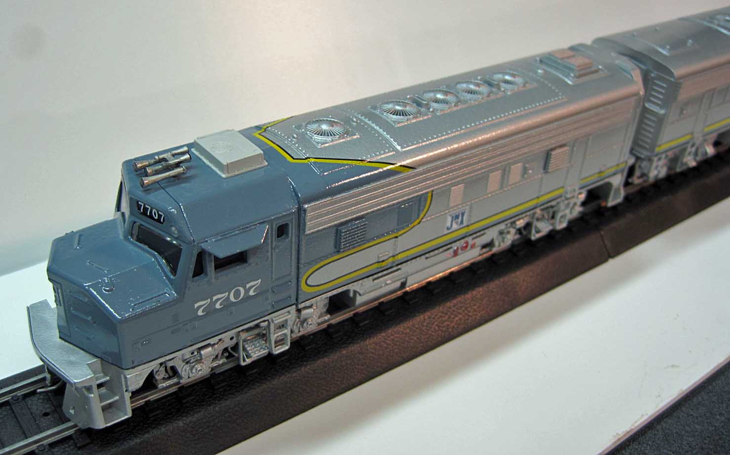

Fresh from the shop, JNXT MK P10, with its sister B unit. I still have to make a slight adjustment to the F45 pilots, as they are nearly scraping the rails - but a quick trim will cure that.
 Posted - November 06 2014 :  6:26:20 PM Link directly to this reply  Show Profile  Add microbusss to Buddylist
how about a big & fat JNX logo on the nose?
I provided the JD loco
 Posted - November 07 2014 :  12:46:13 AM Link directly to this reply  Show Profile  Add Barry to Buddylist
I'm digging your paintwork Jerry. And the clean number boards and cab. And the JNX "branding". What kind of work you got in mind for this fine looking (interior as well . . . looks like a powerful rig) locomotive to do?
 Posted - November 07 2014 :  06:42:21 AM Link directly to this reply  Show Profile  Add JNXT 7707 to Buddylist
Originally posted by Barry - November 07 2014 :  12:46:13 AM
Thank you Barry - this AB set will be used on the Office Car Special, the railroad's flagship as you see currently on the Norfolk Southern, UP, KCS, CSX, etc. My layout is very loosely placed, timewise, and so I can have a reason now to pull a train of streamliners either set in the 60s or present day.

Thanks - the lines are straight because they are decals taken from a Microscale Santa Fe Warbonnet set. But yes, it does still require masking when painting the base colors. I spray the silver last because Testors silver does not take to being masked - the tape dulls the sheen when it is removed.
For the masking process (and this is taken from Microscale instructions) you make a photocopy of the decal sheet and use it as a template for the masking tape. It sounds complex and does require patience, but it's not all that hard in practice. The lines are not so crisp at this stage but thankfully the decal stripes cover them and you end up with a nice sharp line.
