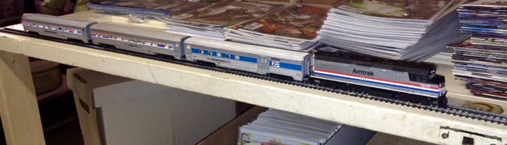

I also just installed a TCS T1 DCC decoder into this Walthers Amtrak Dash-8 locomotive! So now I have six DCC-esquipped locomotives for use on my layout.
/tyco/forum/uploaded/wiley209/20140921195024_modeltrainpics92114-06.jpg

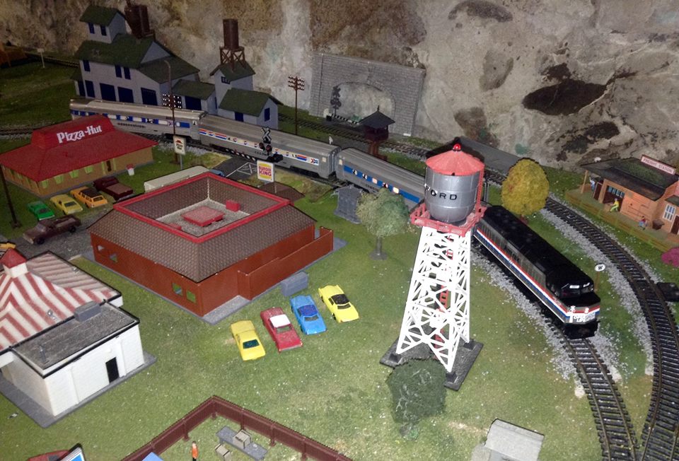

The full Amtrak train, now powered by DCC!
A word of note when installing a TCS T1 decoder into the Walthers Dash 8...
http://www.tcsdcc.com/Customer_Content/Installation_Pictures/HO_Scale/Walthers/GE_Dash_8-40BW/Walthers%20Trainline%20GE%20Dash%208-40BW.html
When it comes to the motor pick-up wires, you must solder the red wire to the gray one, and the blue one to the orange one, instead of the other way around as shown in the pic. When you do that, it will mess up the direction of the locomotive on a layout, at least when you're using a Bachmann E-Z Command system.

Love the Amtrak train wiley - especially the Trainline loco.
ChessieRR
BNSFAvatar
 Posted - September 22 2014 :  6:39:10 PM Link directly to this reply  Show Profile  Add ChessieRR to Buddylist
Very nice layout! That Amtrak train looks great with the Dash 8 up front. I like the main street scene as well!

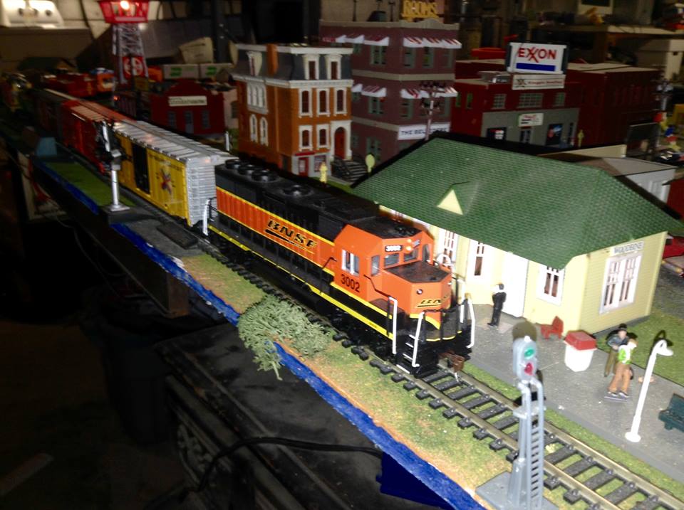

I now have a second locomotive for my main BNSF freight train! It's a DCC-equipped Bachmann Santa Fe GP38-2. I've set it to the same address as the BNSF GP40 to allow for double-header operation.

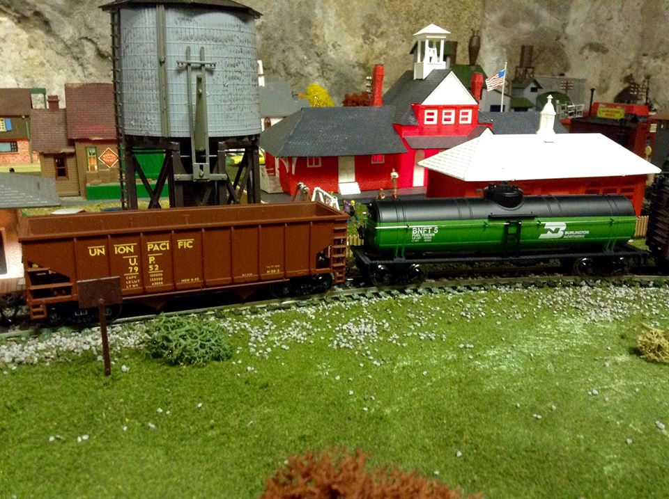

Just a couple pieces of Walthers TrainLine rolling stock I recently acquired. The BN tank care I got today (same Walthers order that included the school kids figures.)

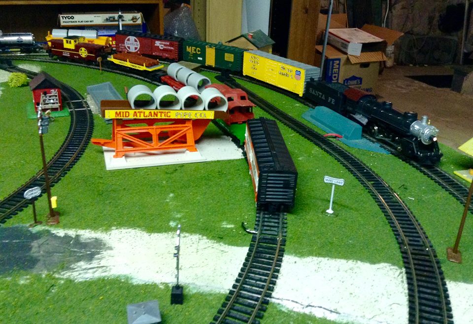

Here's some more updates. I have varied the motive power on my layout a bit. While my main freight is still pulled by my good old Bachmann BNSF GP40-2, I also have this...
IHC 2-8-2 Mikado Santa Fe steam locomotive and tender. This is the later model with a flywheel motor and a knuckle coupler on the tender by default. I wound up removing the lead truck as it was derailing on turnouts; it's sort of like some of those modified Mikados that became 0-8-2s now, making it a bit more unique. It's not DCC-ready, and though the installation is possible, I probably won't upgrade it for a while.

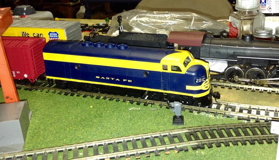

Life-Like Proto 1000 ATSF F3A, number 201C. This one IS DCC-equipped. I'll need to replace the headlight though...

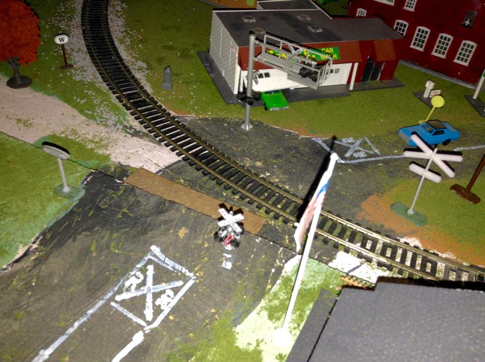

I also now have the TYCO lighted signal crossing set up on my layout, replacing the TYCO signal man.

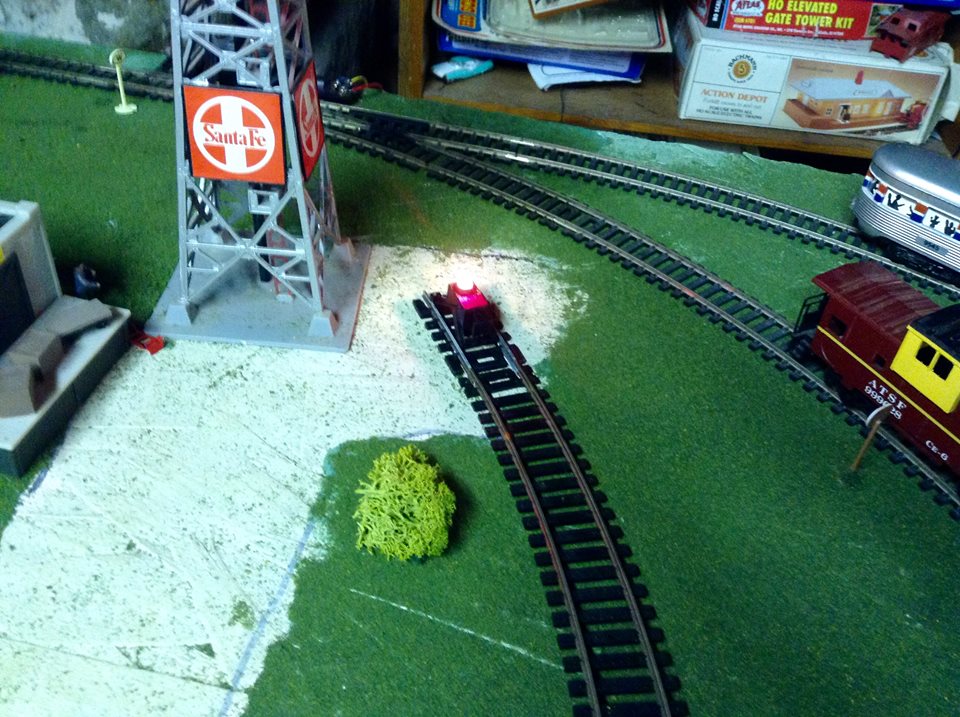

I installed a TYCO Tru-Steel lighted bumper track section onto this siding, as I will say they do look neat, especially on a DCC layout. This type of bumper section is much shorter than the older TYCO bumpers, which were about the length of an Atlas, Life-Like or Model Power bumper track section.

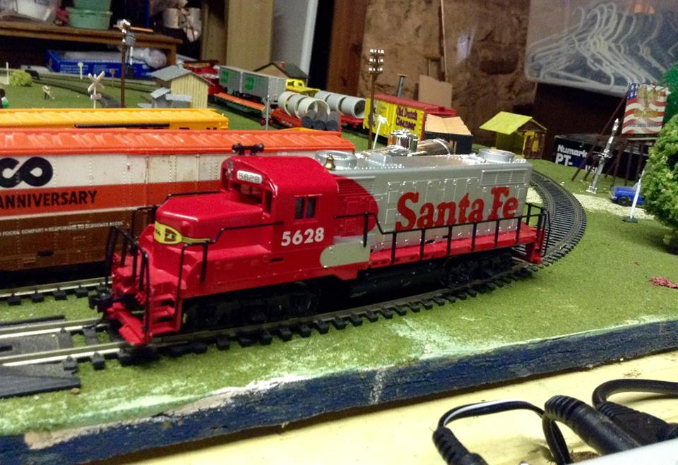

I also bought my first Proto 2000 locomotive at the train show: a Santa Fe GP9! It did take a bit of time to put the parts together, but so far it looks pretty good! I need to break it in a little more before I actually do any layout use, as well as get a decoder for it, as it's DCC-ready. I'm deciding whether to get a Bachmann or TCS decoder for this, as I've had good luck with both kinds on my E-Z Command system.

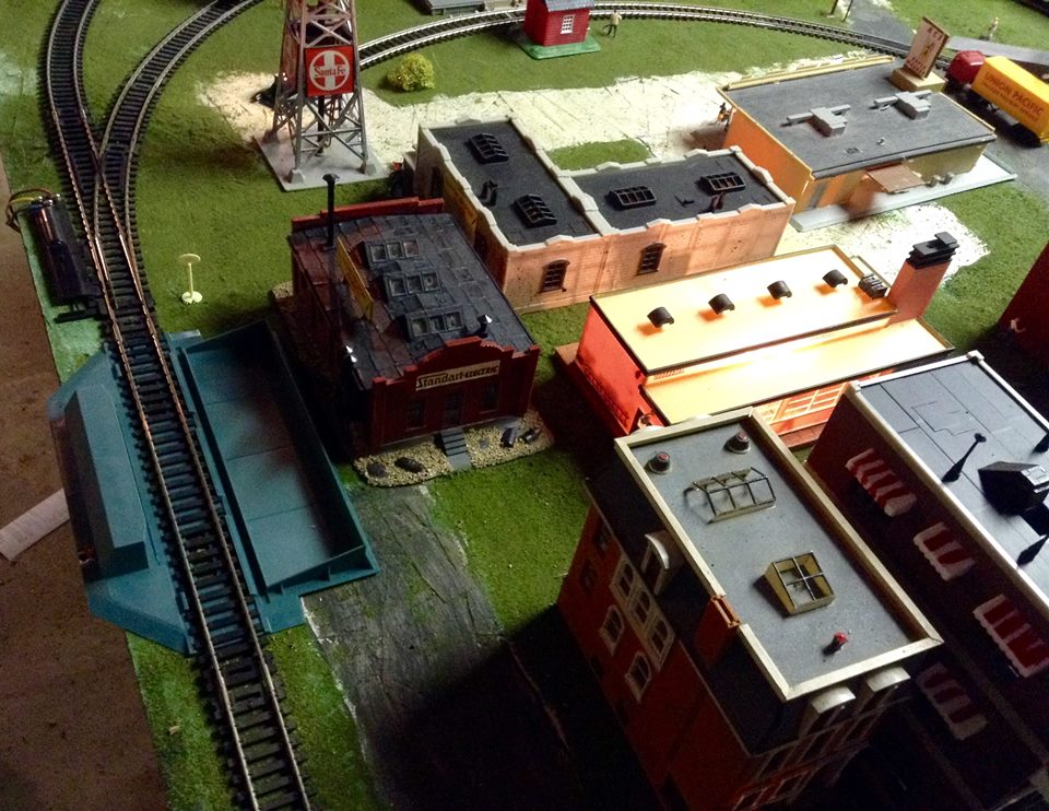

I tried re-arranging a few structures here...

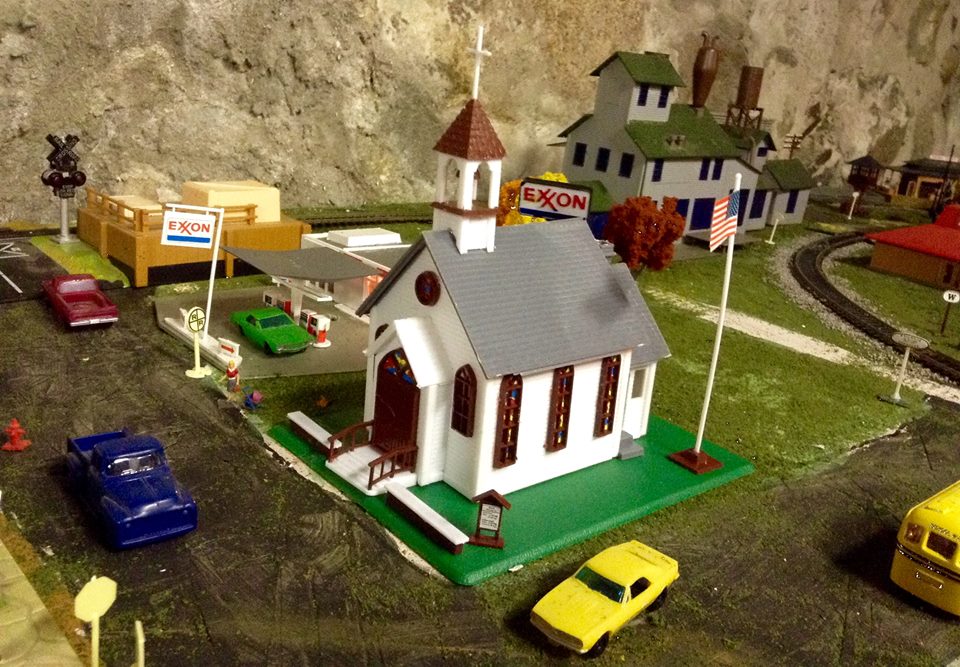

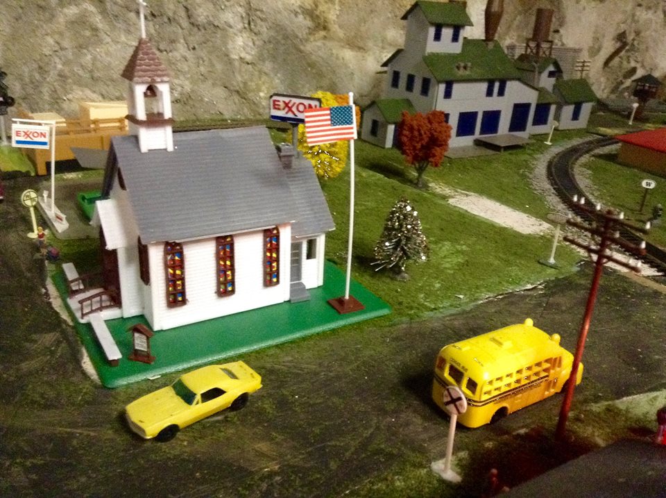

I got a new Life-Like Town Church building kit too! The old church was looking pretty crummy, like an old run-down building (it was one of the first building kits I attempted to assemble myself as a kid), so I figured it was due for a replacement.

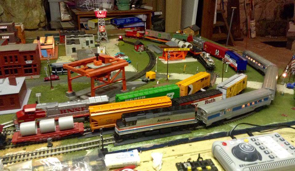

Just an overview.

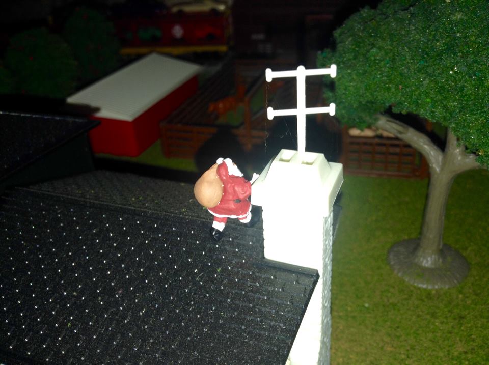

Santa Claus is spotted delivering presents! But since there's no snow, it means no sleigh. So how DID Santa get there? Or is it just an impostor?

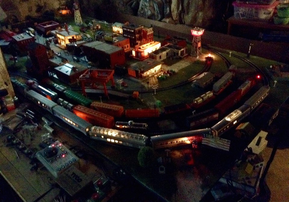

Merry Christmas from Roundpost Junction! Here are my Pola/Walthers Trackside Maintenance buildings I got...
And of course my Christmas train on its' last day of operation for the year.

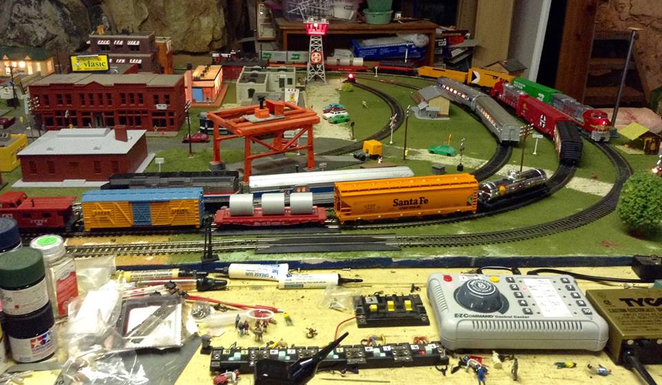

Recently bought some more stuff for the layout...
TYCO chrome Shell tank car. It may not be prototypical, but it sure looks cool! I've already swapped out the horn-hooks for knuckle couplers. I also like the separate details on it.
Again, not very prototypical but what can I say? It's Conrail! (I say this because Conrail used to own the tracks running through Brockton before the MBTA bought the line; freight services here are now done by CSX.)
Bachmann tri-level car transporter. I don't plan to run it on my layout because it is pretty long; I just think it looks cool and makes a great display piece.

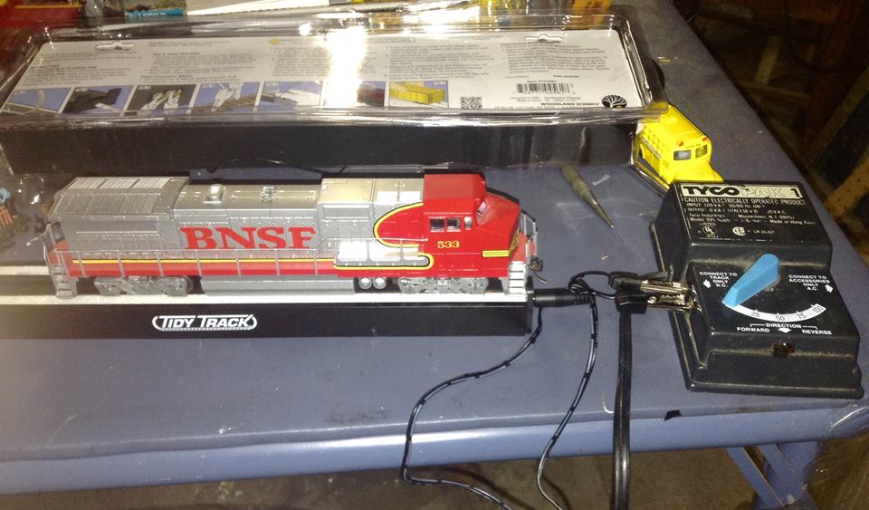

This I got for Christmas; a Woodland Scenics Tidy Track roto-wheel cleaner! Handy for cleaning my locomotive wheels!
Life-Like moped dealership!
A couple of my freight trains in action.

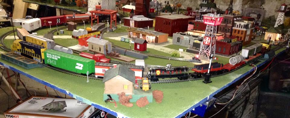

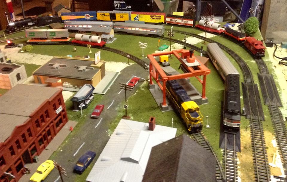

Overview as of today.

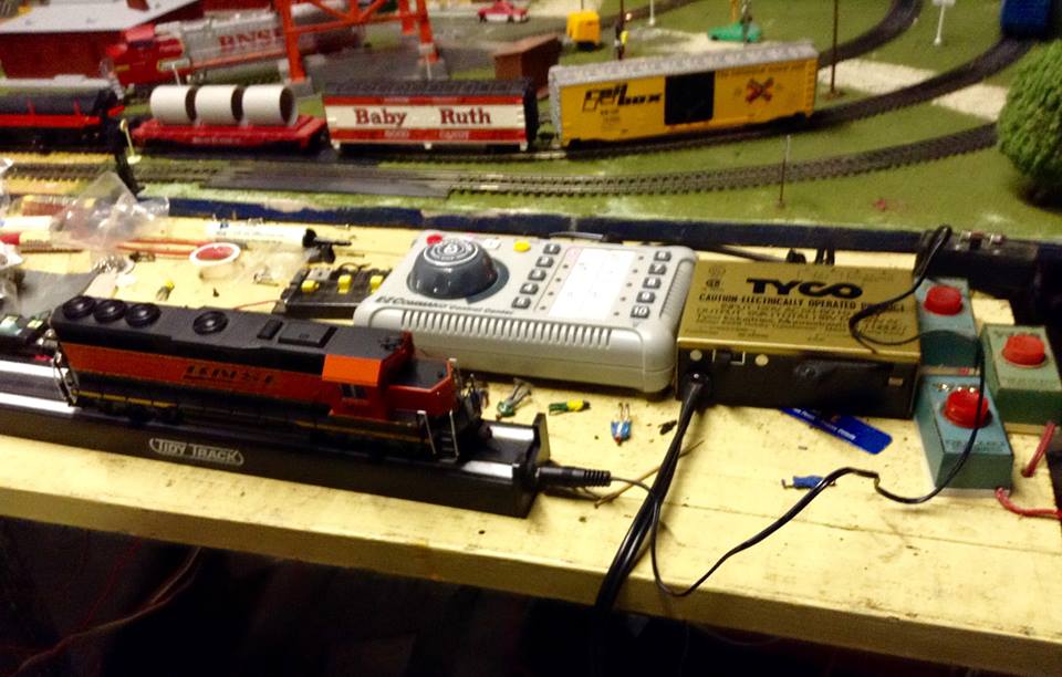

My Proto 2000 GP9 now has a DCC decoder in it! (I used a TCS LL8 decoder; it was a pretty easy plug-and-play install job.)

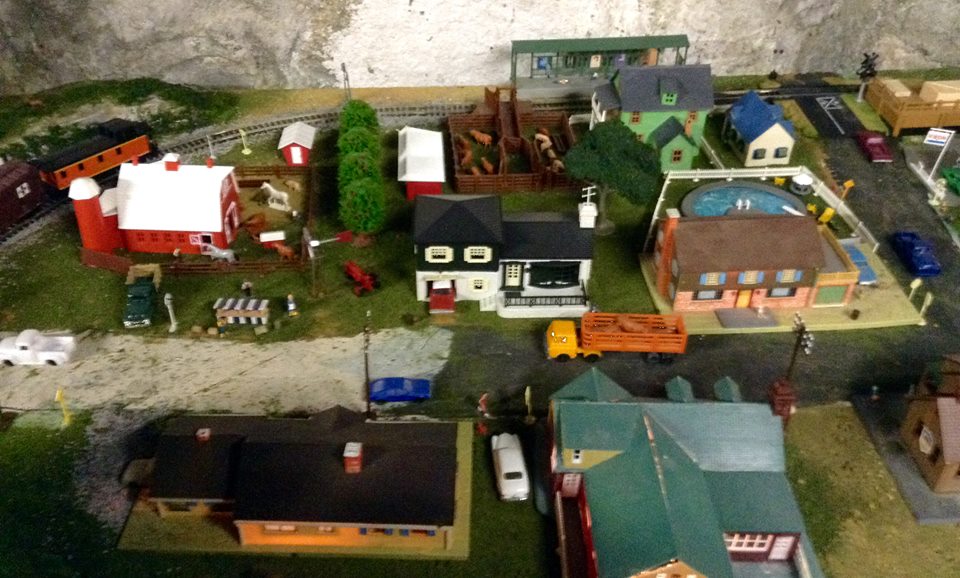

The residental area of my layout in its current state.

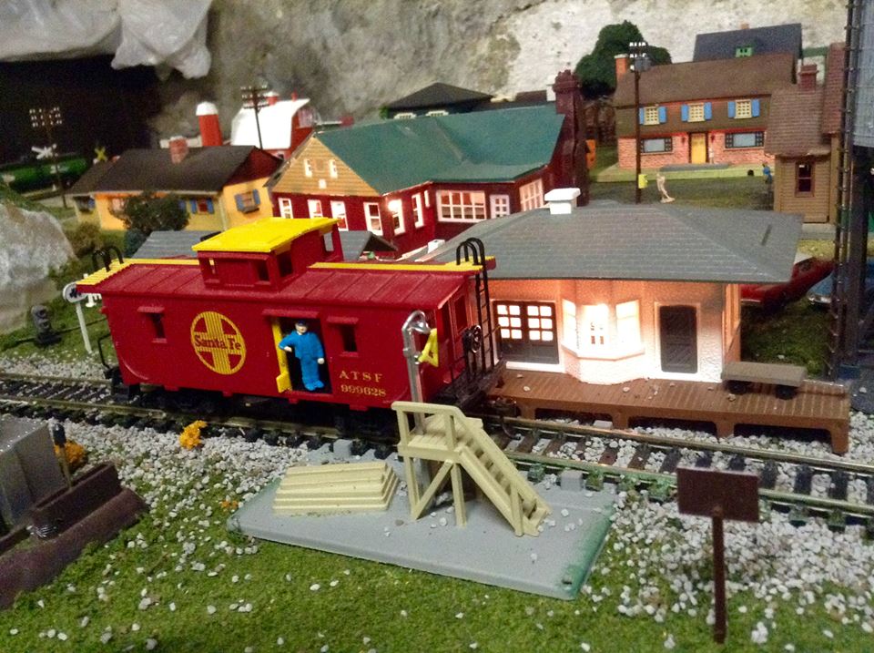

I've also now put the Bachmann "action caboose" loading platform here.

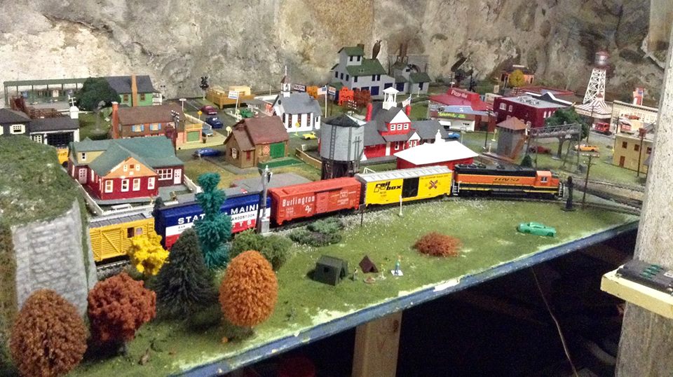

With the exception of the caboose, this Bachmann Santa Fe GP40 is pulling all TYCO rolling stock!

Looks great. A suggestion to try and get that pilot truck on your IHC 2-8-2 back on. If its picking the tip of the points, file the tip of the point rail to help it taper into the main rail. If its picking the frog, then the wheelset in the pilot truck is most likely out of gauge. Its usualy a simple fix to correct that issue. I have run into this before with Tyco and Atlas snap turnouts. The end of the point rail is squared off and fairly thick, so it sticks out a bit and a flange can pick it and derail. Mike

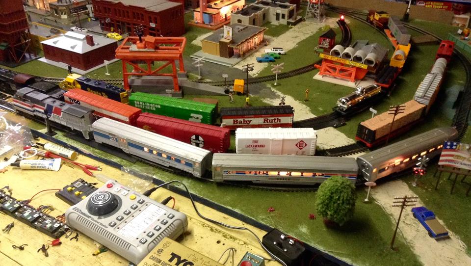

But now that I have more engines and a large layout, some of my trains seem to struggle a bit. I tried cleaning the track, and wheels on several locomotives, but it appears that the power for my E-Z Command unit may not be enough right now (just one amp.) SO, I ordered the E-Z Command 5-amp booster, since I figured I've had DCC for over a year now and am willing to upgrade it a bit more. (I might get a walk-around companion for it too, so I can have walk-around control and a second throttle.)

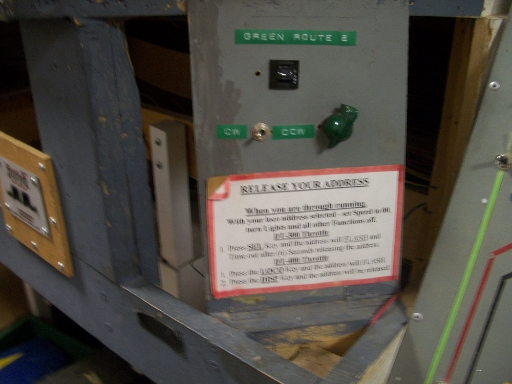

Hey, just got to see your video! You really put your heart and soul
in this creation. That pipe unloader was so neat, I've never seen one, much
less one in action. The photos above are my dear pals at the train club,
tonight, beating their collective brains out trying to fire up a very, very
expensive state of the art DCC system, and Broadway Limited GG1 (not shown).
I think I'd much, much prefer that Bachmann EZ Command Control unit
you have there- much more my speed. These poor folks spent two hours
trying to get the pantographs to go up and down, turn the bell off, make it
move at all. How does that Bachmann unit work for you?

Well, I finally installed a DCC decoder into my Walthers Amtrak F40PH! It runs pretty well, but I found out the reason for some of my trains often struggling is due to the track needing cleaning in some areas, so I'm working on that as well. I also got the Bachmann E-Z Command booster so I could at least still have a bit more power than one amp.

The booster should help. I think your lovos were struggling because the botchman system is designed to run one loco at a time. I am getting a booster for my NCE it puts out 3 amps and I want to run more trains do its a must.
wiley209
 Posted - June 05 2015 :  11:33:52 PM Link directly to this reply  Show Profile  Add wiley209 to Buddylist
Originally posted by raysouthernpac - May 21 2015 :  11:51:18 AM
It did seem to help quite a bit, but I found it was also apparently due to dirty track, so I'm working on cleaning that as well.

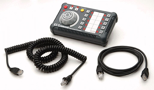

I'm also now getting the Walk-around Companion, so I can try out the walk-around control technique as described in Robert Schleicher's "The HO Model Railroading Handbook" (formerly "The TYCO Model Railroad Manual"), and so I can have a second throttle on hand!

A lot of Amtrak travel going on during the summer, with people going on long train trips and such.
A couple of BNSF freight trains in the rail yard.

Comparing my TYCO/Mantua Santa Fe GP20 and my Walthers Santa Fe GP9M, both in the red/silver "SuperFleet" colors.

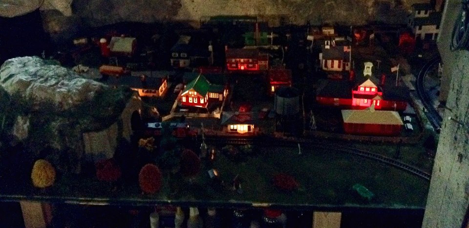

Some "dark" shots on my layout, showing the various lighted buildings and accessories, as well as the lighted Amtrak cars.

As of today, the kids on my layout go back to school.

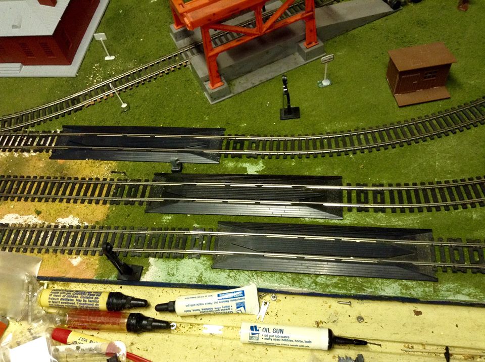

Sometimes you can't have too many rerailers...

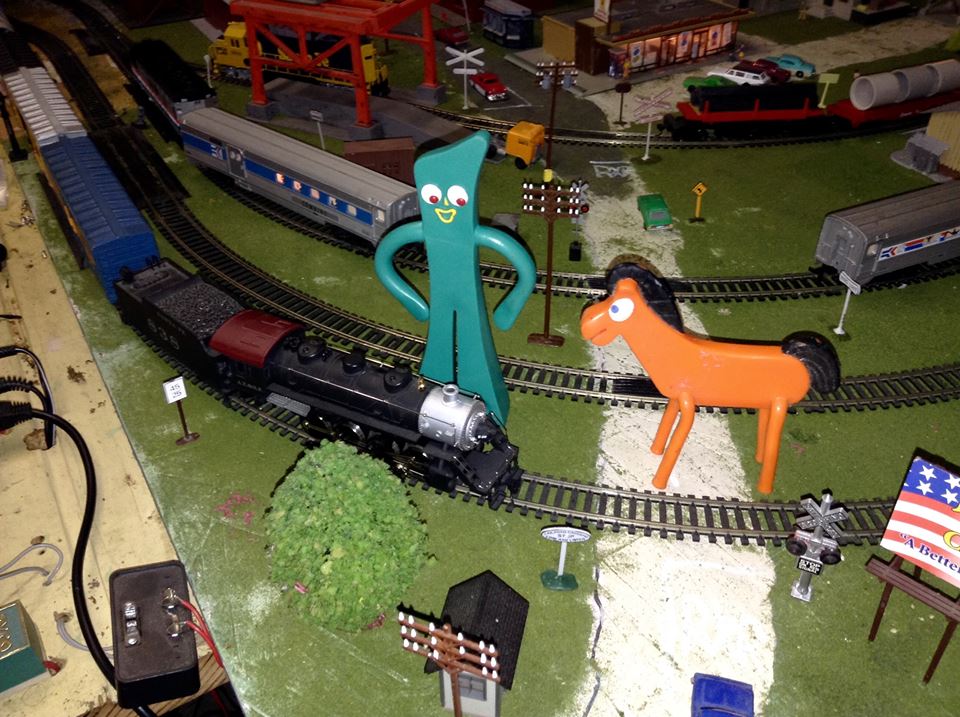

Even Gumby and Pokey want in on the action! (Yes, that Gumby figure is supposed to be based off the '50s version.)

I added the appropriate pavement markings to some of the railroad crossings (ones not protected by "crossing gate/signal" operating accessories. I plan to wire up these two crossing signals soon, most likely to a Grade Crossing Pro controller from Logic Rail Tech.

Disaster occurs! Now normally a handcar can't cause a train wreck, but I based this off the early 90s Winnie-the-Pooh episode "The Good, The Bad and the Tigger," where at one point a speeding handcar collides with a runaway steam train, causing it to blow up!
