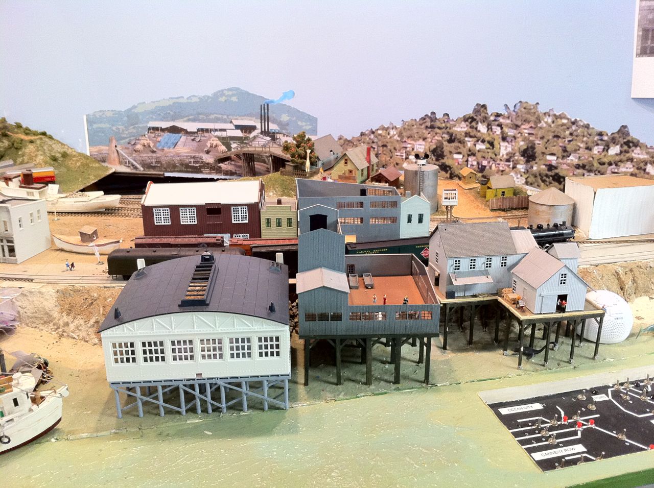

It's a new year so I'll start my own layout thread to show what I'm up to. I've been building on it since 1996 and it most of the trackwork and electrical is completed. There is also a fair bit of scenery. The railroad and the places that I'm modeling are fictional, but imagine a line in California that starts in at the Monterey canneries, goes over a mountain and then to a large city by the bay.
Here is the cannery section so far:

hi Thomas love the perspective of this scene ,ken

very nice Though I think you needs some roofs on the buildings & a mermaid under the docks
That one building on the left looks like a airplane hanger

I don't recall ever seeing a control panel surrounded by scenery. That's an interesting idea and could possibly lend itself to a number of situations.

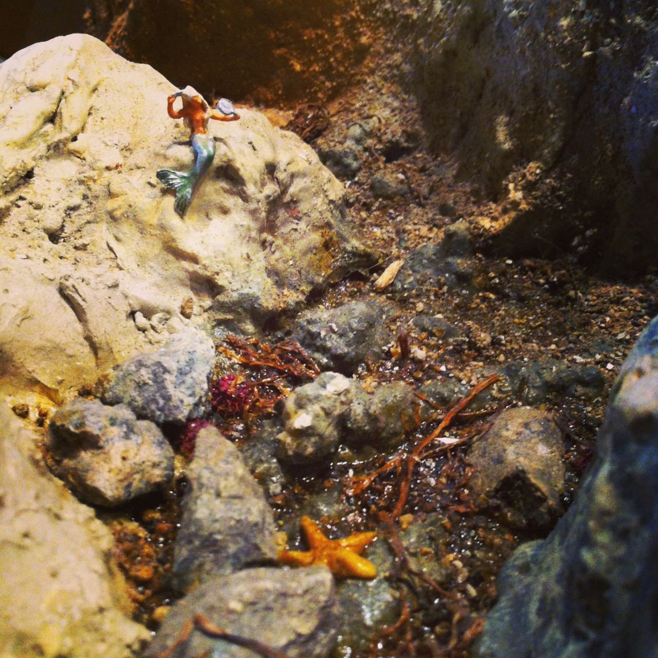

Originally posted by microbusss - January 03 2014 :  12:28:27 PM
Yup, roofs are coming soon. You are right about the O-scale airplane hangar. It will get new windows and details to make it HO scale.
The mermaid doesn't like the docks. She prefers to hang out by the lighthouse.

The detail and realism is amazing. It took me a while to figure out where in the first picture the model buildings ended and the backdrop started.

Yes it's incredible how a good backdrop can really transform a scene. It's like the brain needs it to believe it.

hi thomas,love that layout as said previously,and the great perspective,you have taken time to do it,and my brain for one was fooled ken

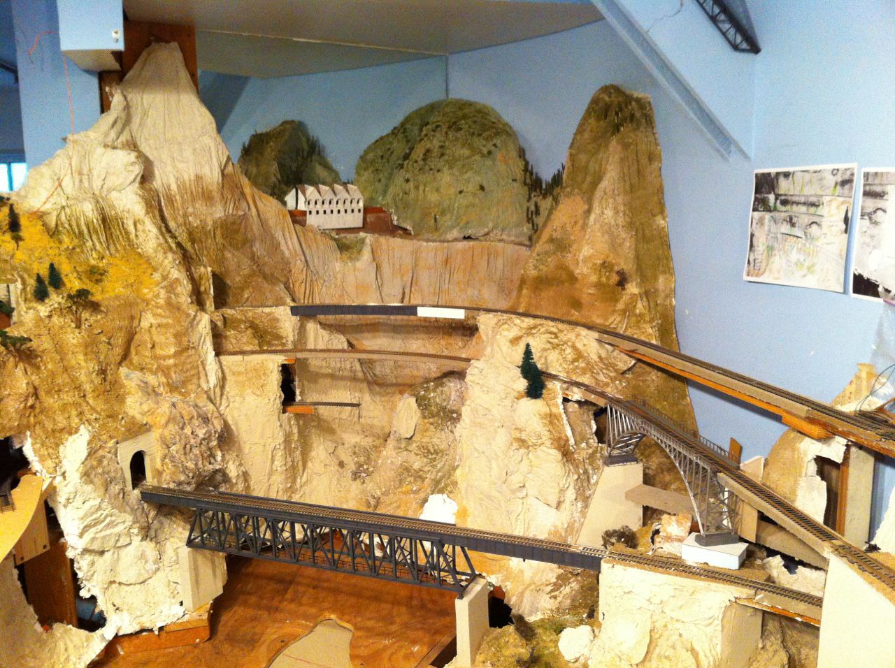

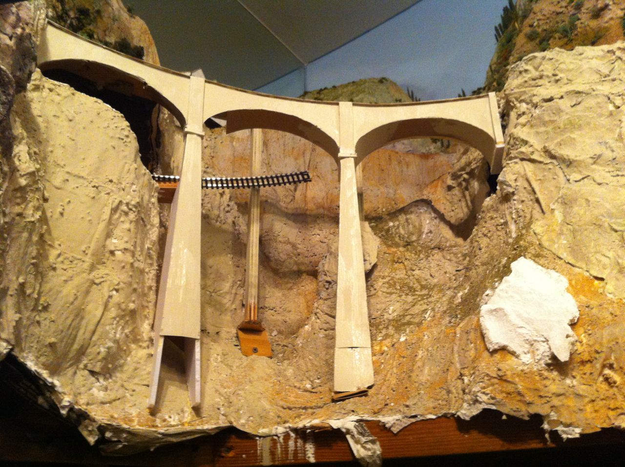

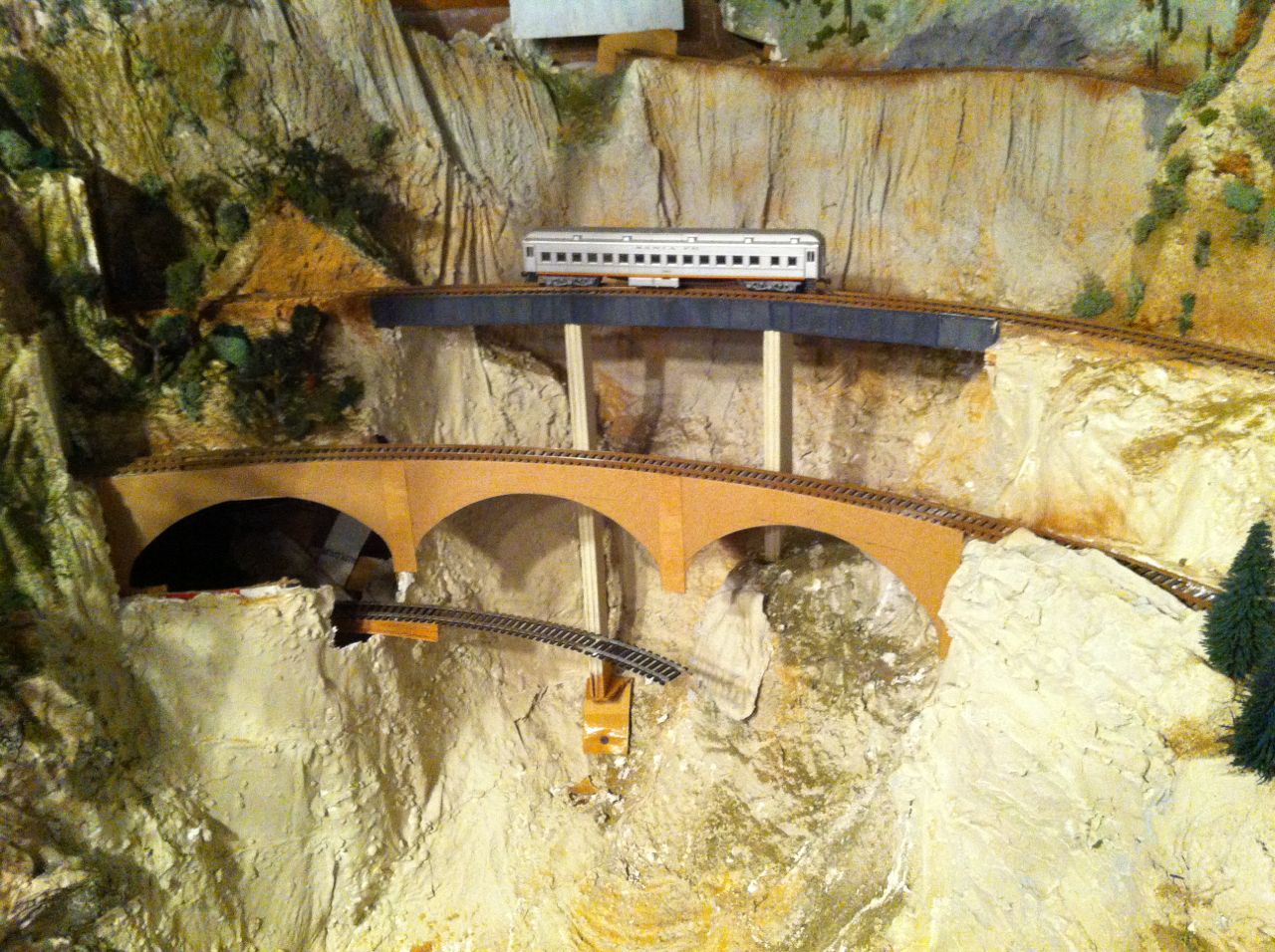

 Posted - October 06 2014 :  12:37:14 PM Link directly to this reply  Show Profile  Add Redwoods to Buddylist

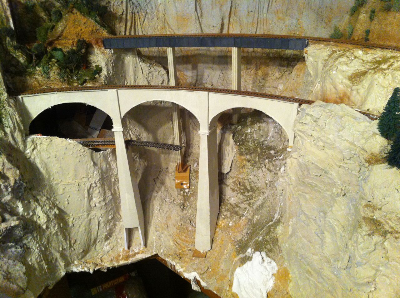

This past weekend I worked on a couple of curved bridges at the end of the canyon. I used girders on the top track with plain wooden piers. On the next track down I made a concrete arch bridge from cardboard with foam core piers. As with many bridges on my layout, these bridges are just facades glued onto the roadbed. My inspiration for the concrete arch bridge is the "No Hands Bridge" near Auburn, CA.
 Posted - October 06 2014 :  2:25:23 PM Link directly to this reply  Show Profile  Add Barry to Buddylist
Very nice Thomas. Noting that you said you'd been working on this layout since 1996. It is amazing how much time it takes to settle in to what you want to do. Makes you want to tell new modelers not to get too excited about deciding what to do until you've got a couple years under your belt.

Love those bridges Thomas, along with the breathtaking scenery. In my opinion, nothing adds more interest to a layout than a bridge soaring over some steep drop-off. Great work!
Barry, I agree with your thoughts on how interests evolve. I started out modeling the UP, then settled on L&N...which I am largely sticking with .... but I have noticed how I am slowly gravitating more and more to local WV railroads - specifically ones my dad worked for (NYC/PC/Conrail).

Thanks, yes I agree there is something about a bridge soaring over a deep chasm. The roadbed and track have been there for a long time but it sure is more dramatic now.
In my case it wasn't so much my evolving interests as it was just having started something in '96 that was WAY too big. The layout is still pretty close to the original plans I drew up way back when. For the last several years I've been focusing on trackwork and electrical and making good progress on that. But I was showing the layout to some friends recently and that sparked my interest to return to the canyon and dress up those hanging roadbeds.

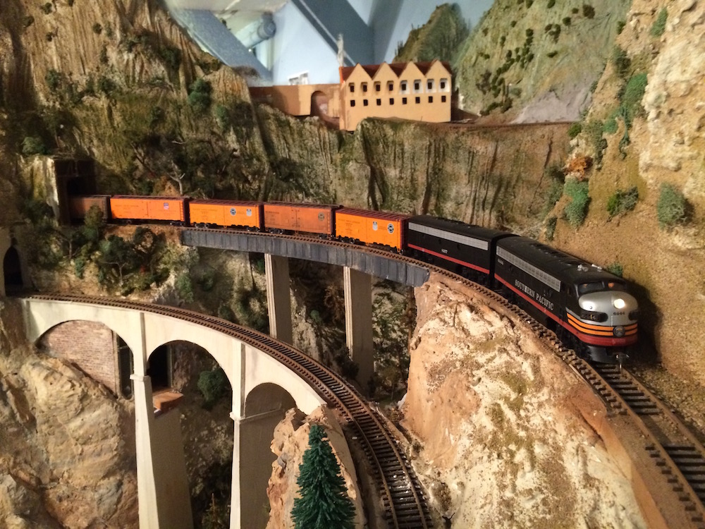

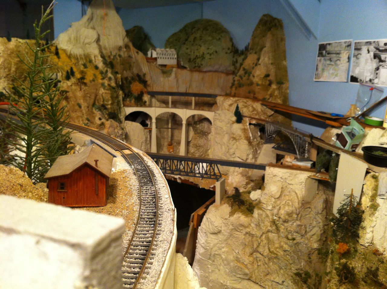

 Posted - November 08 2015 :  1:24:46 PM Link directly to this reply  Show Profile  Add Redwoods to Buddylist

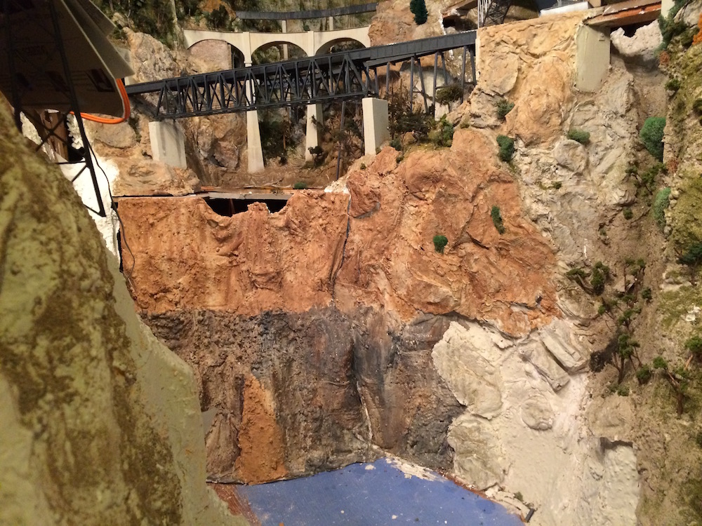

Here is a recent shot of the end of the canyon, showing some of the progress I made this year.
-- Thomas
 Posted - November 08 2015 :  9:21:44 PM Link directly to this reply  Show Profile  Add Chops124 to Buddylist
Holy Shamoly, Batman! This is pretty darn cool.
Shades of John Allen, with its own unique vision.
The mermaid is a great touch, and that PFE
express is just great. Hope to see more!

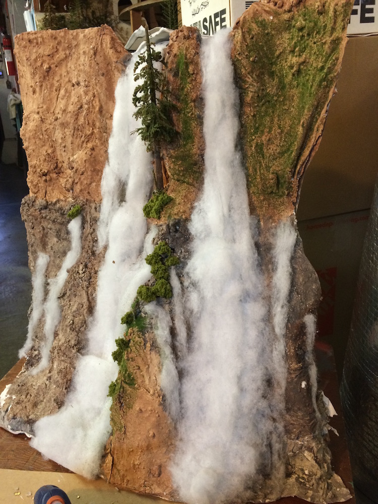

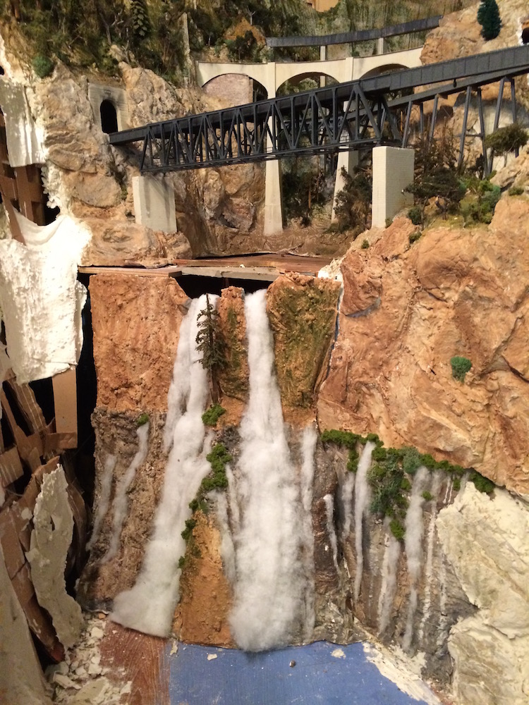

 Posted - November 10 2015 :  11:44:33 PM Link directly to this reply  Show Profile  Add Redwoods to Buddylist
Thanks for the compliments. You are indeed right that John Allen is a big influence for me, especially when it comes to floor-to-ceiling scenery and bridges.

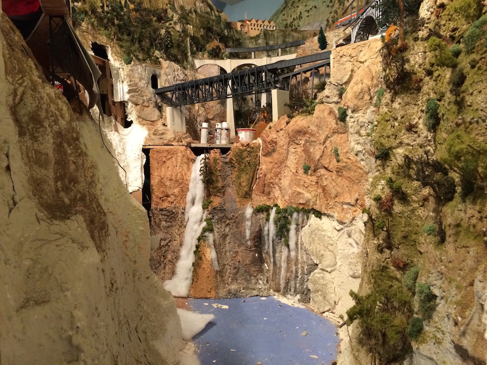

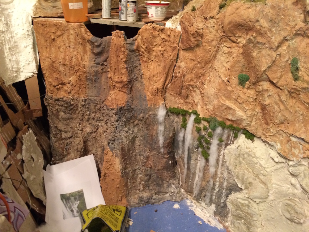

Here is a project that I worked on over the summer. It's my version of McArthur-Burney falls with water seeping out of the rocks. It's taller and narrower than the real falls, but I like how it's turning out. The water is modeled with polyester batting.

 Posted - November 11 2015 :  10:22:18 AM Link directly to this reply  Show Profile  Add scsshaggy to Buddylist
That waterfall with water seeping from halfway down the cliff is an unusual touch.
You see "weeping walls" in the real world, but not so often modeled.

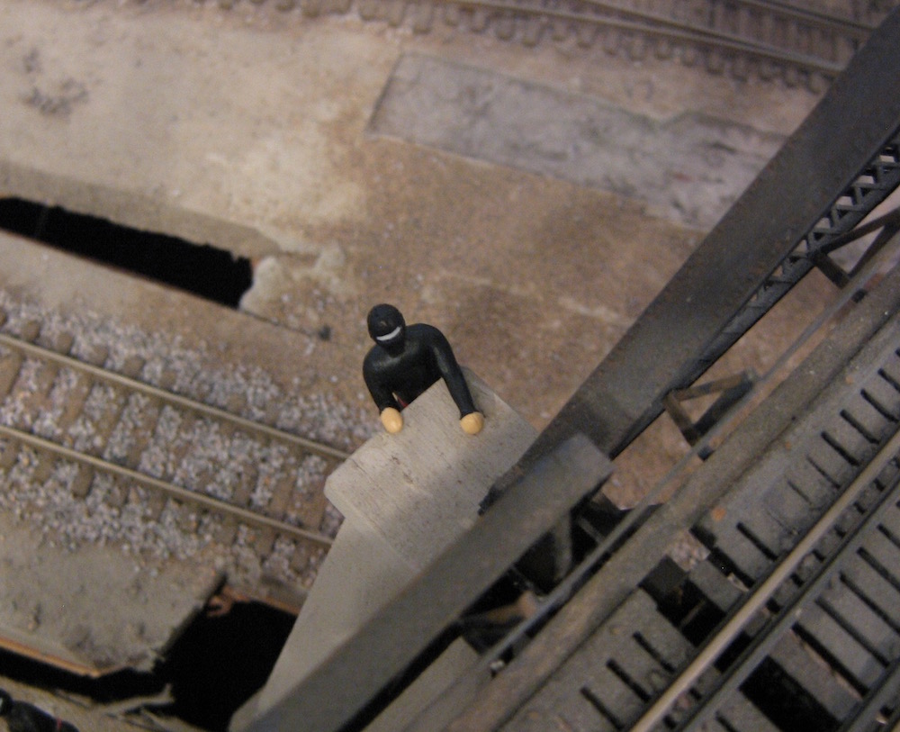

Microbuss, my favorite silly thing on the layout is a group of ninjas scaling one of the bridges. I'm not sure what they're up to but it doesn't look good.
Here's an earlier thread about silliness on the Redwoods and Pacific: http://www.tycoforums.com/tyco/forum/topic.asp?TOPIC_ID=10695
 Posted - November 11 2015 :  8:22:29 PM Link directly to this reply  Show Profile  Add Barry to Buddylist
That scene is pretty convincing Thomas. And at least in the photo, that cotton batting looks like spray. I'm not seein' the mermaid though.

Astonishing work. the GD on steroids. Waterfall is
astonishing. A guy standing over my shoulder as I
was flipping through your thread had this to say:
"Holy carp." (Flip the vowel and consonant).

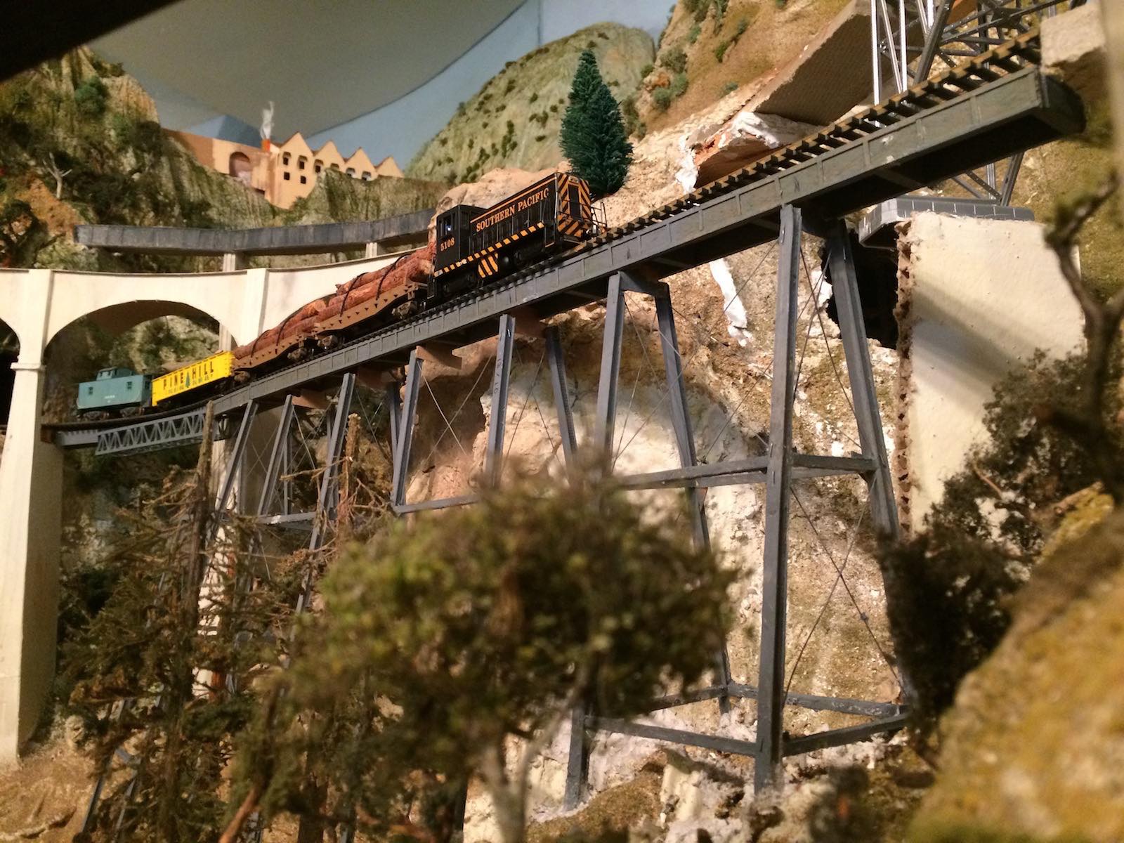

 Posted - December 27 2016 :  1:01:55 PM Link directly to this reply  Show Profile  Add Redwoods to Buddylist
A short log train on a high spindly bridge.

Cool view Thomas.

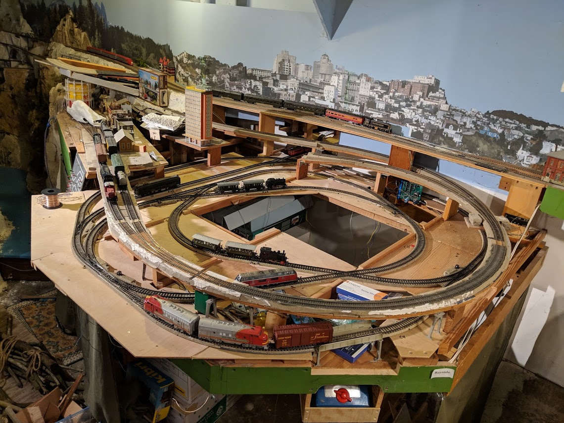

 Posted - March 01 2019 :  8:58:11 PM Link directly to this reply  Show Profile  Add Redwoods to Buddylist
This year I'm working on a section of the layout that will be a city scene, with many tall art deco buildings. This section has been an empty hole since I started the layout two decades ago, so I'm excited to be working on this. I've always wanted a trolley loop, and by coincidence I recently inherited all of my dad's extensive Märklin collection as he is getting older and is downsizing his home. So I decided to create the several loops using Märklin 3-rail track. The loops will be fully automated and controlled by an arduino. This will have special meaning for me since I grew up with Märklin and my tinkering with my dad's trains when I was a kid played a large part in me getting a degree in engineering.
It's taken me about a month of evenings to design and mount the tracks with all of the wiring associated with it. The next step will be to program the arduino and hook it all up. Eventually I plan to kitbash some trolleys using Märklin mechanisms.

Nifty layout. Keep up the good work.
 Posted - March 01 2019 :  10:00:20 PM Link directly to this reply  Show Profile  Add RP model railroads to Buddylist
Looking good! Great work.

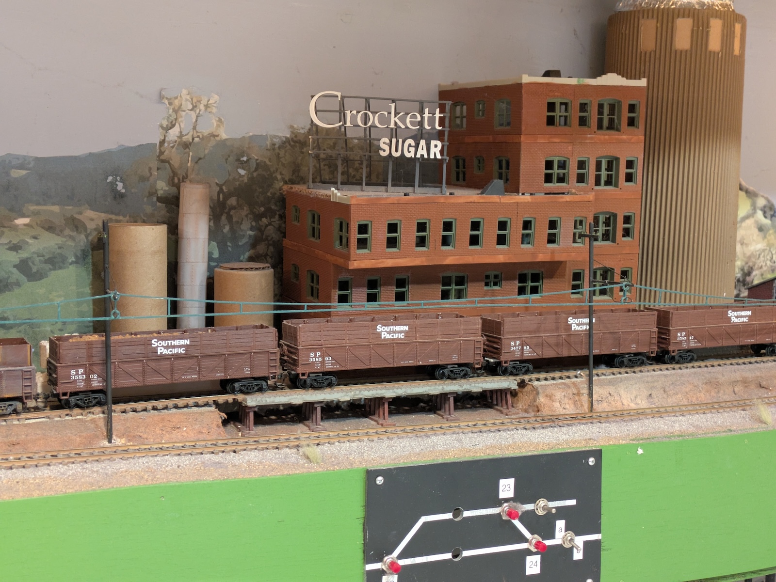

 Posted - September 15 2026 :  12:37:03 PM Link directly to this reply  Show Profile  Add Redwoods to Buddylist
Here's a view of a sugar refinery on my Redwoods and Pacific RR. I kitbashed it from a couple Life Like Belvedere hotel kits. I had the sign custom laser cut from lettering that I created. I mounted the letters on a scaffold made from coffee stirrers. The sugar beet cars are kitbashed from Bachmann gondolas and I also used coffee stirrers for the wooden extensions.
