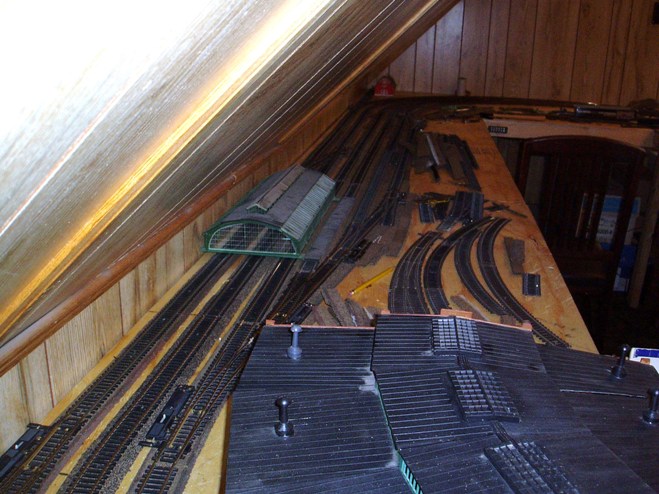

**My large basement layout has been history for almost two years. I moved up to the attic with my layout. first with a 16' X 2' switching layout. I cut a 4X8X3/8" down the middle long ways. I have 3 small shelf units and a small 3 draw something or other that I used to support it. I layed the 2 2x8s atop some 1x6" boards to hold it together. It was kind of a test to see how it would be. It wasn't! It operated Ok but I missed the contineous running. That was the history of the attic till now.
**I have completely done away with the old except for the 1X6s. Building all new tables to support this new layout. I actually kept the idea of the 2x8s and added to it. I'll will have two parrallel main lines. I will put some small spurs off into the corrners.

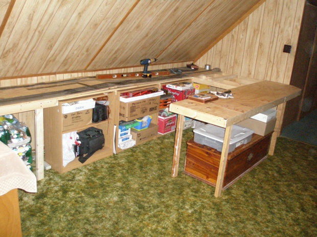

 Posted - October 10 2009 :  10:59:27 AM Link directly to this reply  Show Profile  Add toptrain to Buddylist
post 2

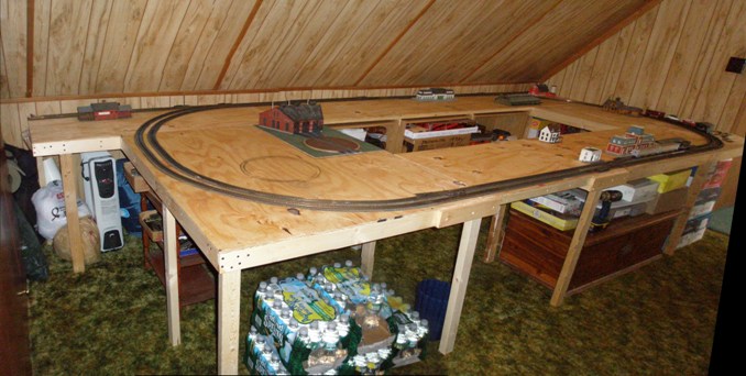

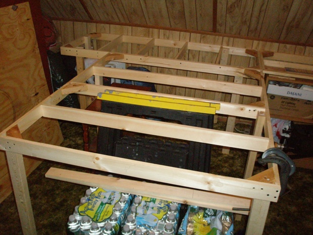

10-2 09
Here is where i was on this day. Four of the tables were built and in place. I still have 1 more to build. The old 2X8s were layed ontop of their new tables. I'll be going with a open center area 2 1/2 ' wide and 7' long. Their will be a lift out section to allow entrance to the center area. At this point I striped off all the track from the old 2X8s and put them in the basement.

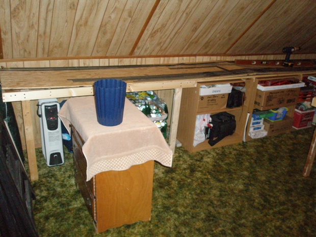

 Posted - October 10 2009 :  7:14:51 PM Link directly to this reply  Show Profile  Add toptrain to Buddylist
post 4

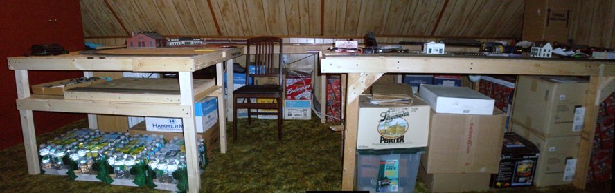

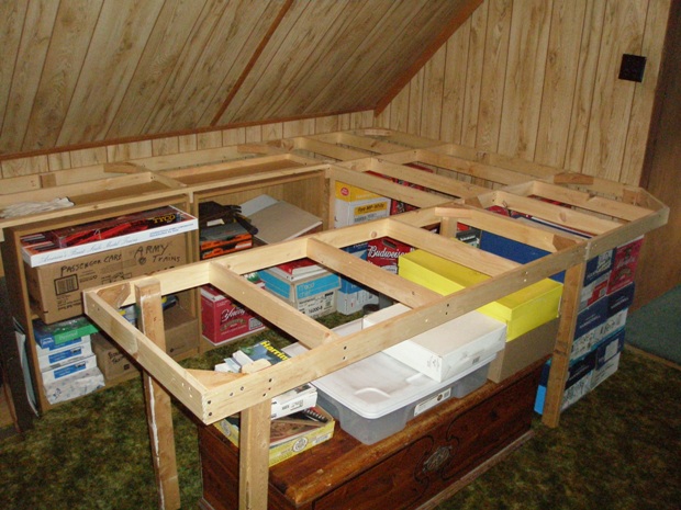

10-04-09
** Here on this date I had all the tables framed and put together.

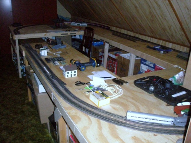

10 11 09
Today Track work for main lines is done. No wireing has been done yet. here is a view with the removial section in place

Really nice carpentry work Toptrain!

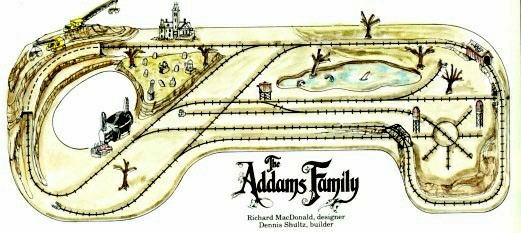

 Posted - October 18 2009 :  1:28:23 PM Link directly to this reply  Show Profile  Add microbusss to Buddylist
I found this plan on 1chan in the rail section
yes this is the 027 but still want the Classic Toy Train mag it came in so I can do it in HO someday But your doing a great job on yours too
Edited by - microbusss on October 18 2009 1:29:00 PM
Originally posted by microbusss-October 18 2009: 1:28:23 PM
That looks like it would be a nightmare to keep from short cicruiting.
- Matt -
 Posted - October 18 2009 :  1:47:20 PM Link directly to this reply  Show Profile  Add toptrain to Buddylist
post 12
the only poblum is the reverse loop. And that is kind of a regular problum.

yeah so I'll modify it a little here & there

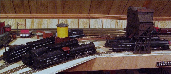

 Posted - October 25 2009 :  6:05:54 PM Link directly to this reply  Show Profile  Add toptrain to Buddylist
post 19

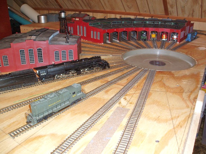

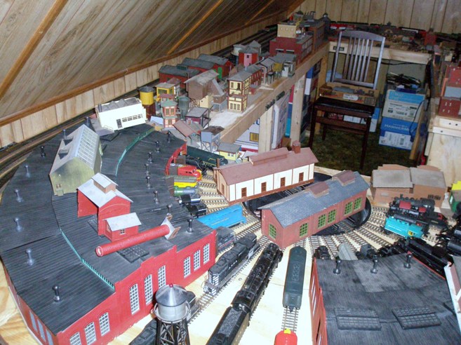

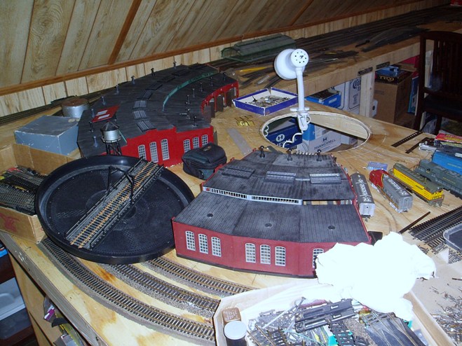

**** Here we go the roundhouse,turntable.
* As I had said I would have to install my yard entrance track. This is now done. the road bed is there. Next measure a viable space between the tracks. It is 66". Mark the centre. The centre of the turntable will be 9" from the edge of the board. Next I make another circle at a 15" radius. Now I extend the turntable centre line across the entire 66" clear space. The roundhouse segments are 10 degrees apart. 8 stalls times 10 is 80 degrees. I make a mark at 80 degrees. I make a line from the turntable centre thro my 80 deg mark to the roadbed. I placed my 8 stall round house in its location aliening the centre line as a track centre for stall #1 going cc wise. Using the 15" radius circle as a curve outline to match up my roundhouse front, sliding the round house back away from centre till the 0 deg centre line and the 80 deg. line match up with the door centres for section #1 and #8. Also keeping the space between the 15' circle line and the roundhouse even my alignment is done for doors 1 and 8. I marked the centres of the other 6 door sections. Then I removed the roundhouse placing it aside. I drew the remaining 6 lines for the track centrelines thro the other 6 sections. Placing the roundhouse back in its spot I checked all alignment marks front and rear of the round house. I now have the roundhouse properly aliened and all track centres located. I just have to mark the location of the complete rear wall. Note it thickness. then mark my centrelines to show the length of the tracks into the roundhouse. this completes the marking for the 8 stall round house. I choose a location for the 3 section roundhouse and do it all again using the marks already there.
Edited by - toptrain on November 17 2009 4:33:29 PM

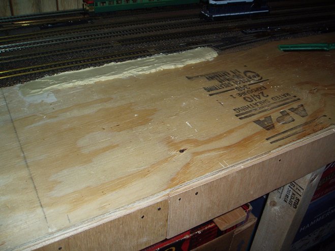

 Posted - October 30 2009 :  08:32:47 AM Link directly to this reply  Show Profile  Add toptrain to Buddylist

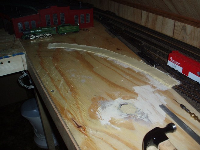

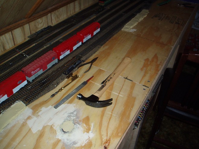

If neatness counts. I fail the test. It actualy got dirter then this.
PS still ploding on.

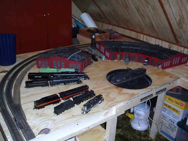

 Posted - October 30 2009 :  5:48:32 PM Link directly to this reply  Show Profile  Add toptrain to Buddylist
post 21
Now this layout has main line trackage and a yard that has ballasted trackage. My yard is consideed a high speed bypass trackage. Everywhere else the track will be directly on the ground. Round house area and service ares. I am building two ramps for now to allow all non revenue cars and railroad deliveries on railroad maintance areas.

Nice job Frank, and if you think that's dirty, you should have seen my layout! You couldn't even see the track lol.

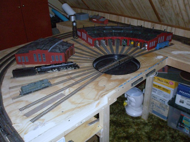

Jacob, the mess has subsided. I finished installing the round house storage tracks. If my ramps are good the turntable entrance tracks will be done.

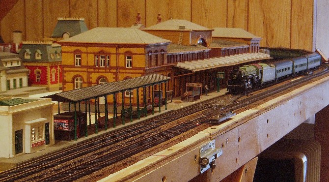

 Posted - November 02 2009 :  4:05:11 PM Link directly to this reply  Show Profile  Add toptrain to Buddylist

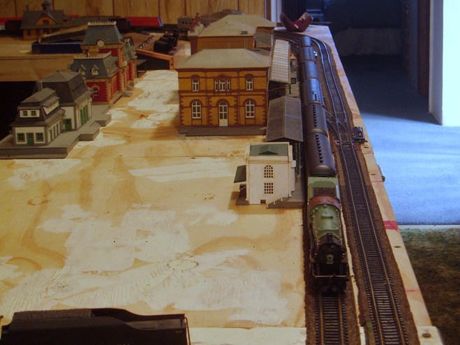

today. A play day. I brought out my Kibri Bonn station to see if it fits. Maybe I have something. I can find my other matching platform and the long Passenger trains will fit in the station.
Edited by - toptrain on November 02 2009 4:05:46 PM

Lookin' good, like the turntable so far.

Loving the size of the turn table Frank! You adding more spaces or sticking with the 21 you have? The passenger area is going to look good too. Should be plenty of room to pull in a nice long consist of cars.

With the 21 spaces. The number, 10, that are open will remain so. I may relocate the 3 section round house to a different spot around the turntable. It all has to do with taking photos. The open tracks allow for better photos. Once I paint and detail the ground around the turntable no other changes will be made. It will probably stay the way it is.

Tyco Nut
 Posted - November 05 2009 :  11:37:34 PM Link directly to this reply  Show Profile  Add Tyco Nut to Buddylist
I'm definitely jealous - this layout looks really fun! LOVE the roundhouse layout.
That station is wonderful, too!

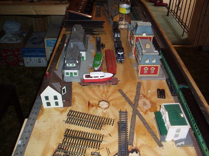

 Posted - November 06 2009 :  4:57:44 PM Link directly to this reply  Show Profile  Add toptrain to Buddylist
post 33

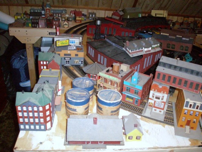

Look what happens when you just turn around. Those little people have a building boom and put up buildings everywhere.
They are on the roundhouse roofs.
They are on the turntable.
They are on the tracks, and down the center of Main Street.

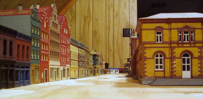

post 34

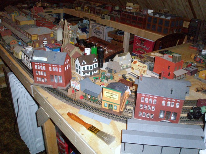

A view of main street and how it may be.

 Posted - November 08 2009 :  8:39:55 PM Link directly to this reply  Show Profile  Add microbusss to Buddylist
looking good man! Add a couple of Fast Food places too

 Posted - November 09 2009 :  3:48:55 PM Link directly to this reply  Show Profile  Click to see MM 1498's MSN Messenger address  Add MM 1498 to Buddylist
Geez that's a cool picture Frank! The side-by-side buildings really capture that "busy main street" look quite well.

 Posted - November 09 2009 :  5:51:08 PM Link directly to this reply  Show Profile  Click to see DaCheez's MSN Messenger address  Add DaCheez to Buddylist
Daaannnng your mainstreet looks good! The buildings all match up so well...my small collection of buildings on the other hand... I can't wait to see it when it's done.
 Posted - November 10 2009 :  08:28:44 AM Link directly to this reply  Show Profile  Add toptrain to Buddylist
post 38
Originally posted by microbusss-November 08 2009: 8:39:55 PM
In this time period with steam being king, fast food joints were few and only on highways. Not on main streets. My layout is spared the blight that they created. There are benefits to modeling in the steam era.

 Posted - November 17 2009 :  11:25:11 PM Link directly to this reply  Show Profile  Add Tyco Nut to Buddylist
You could always add a diner or restaurants. Those look good and go with the era.

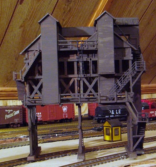

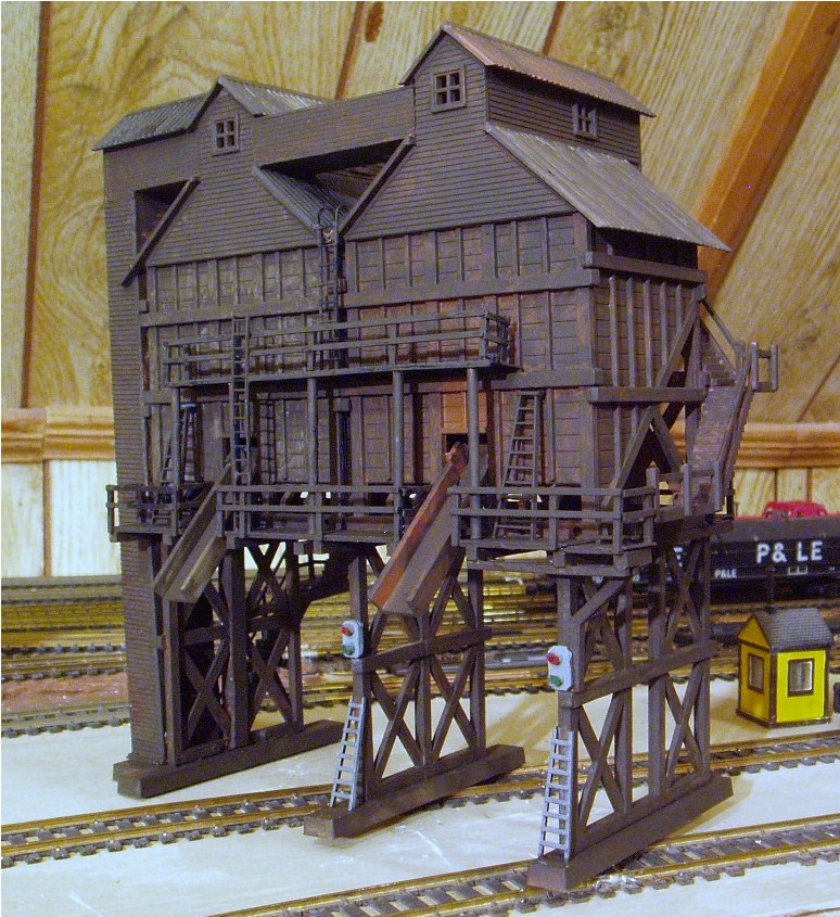

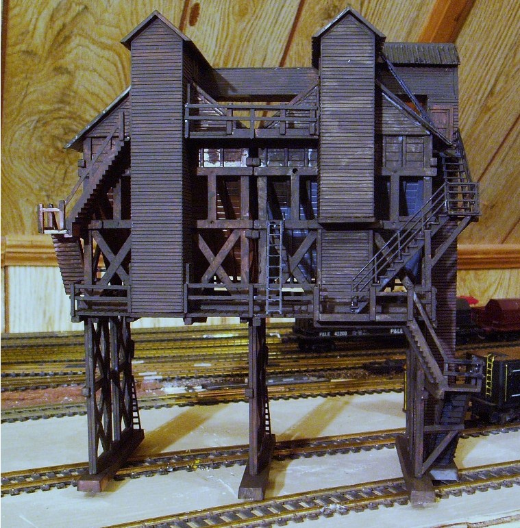

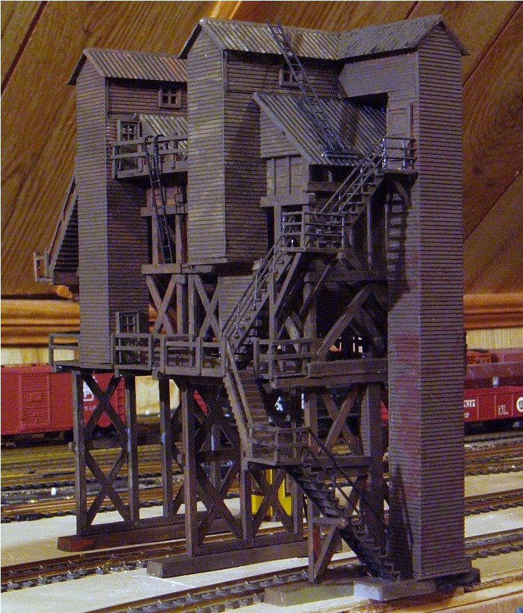

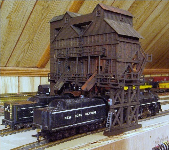

Here is my Bachmann coal tower after a little work. Some kitbashing of three kits. It took three days.
first is the front side with locos being loaded.
second is the rear at a angle showing the main entrance stairway and the stairway up to the top of the coal raising device.
Third is the rear of the towers.
Edited by - toptrain on June 14 2010 7:13:18 PM

Great job Toptrain...

That thing is amazing!
I suppose you'll need a coal tower that large, since you have so many Marx, Lionel and other steamers.

WOW! I'm very impressed and jealous. That is just awesome! Keep posting pics.

What kits did you use to make the coal tower?
Rus
 Posted - November 22 2009 :  3:45:20 PM Link directly to this reply  Show Profile  Add toptrain to Buddylist
post 45
I used three Bachmann coal towers. One was a unbuilt new kit. One was a kit that was taken apart with a few damaged parts. The last was a built up kit missing all stairways. Here is what the loco service area is looking like. I have no sand or ash equipment yet, and the track for the coal cars to load this twin hopper is not in yet.
Here is another photo of the front side with it's controling lights.
Edited by - toptrain on November 26 2009 11:38:54 AM
 Posted - November 22 2009 :  4:03:17 PM Link directly to this reply  Show Profile  Add toptrain to Buddylist
In that service area photo, two Tyco Mikados and three Marx Hudsons are being serviced.

Going back a few posts, what did you use to make those "ramps" for the track?
 Posted - November 22 2009 :  7:10:27 PM Link directly to this reply  Show Profile  Add toptrain to Buddylist
post 48
Hey Frank. That coal tower looks great!
Originally posted by DaCheez-November 22 2009: 4:49:54 PM
I used ready mix wood putty appiled with a putty knife. It was done by eye and sanded. It took about 4 applications to get it right.
Edited by - toptrain on November 26 2009 11:39:37 AM

A inspection tour of the twin coal Towers
In the photo of the rear of the coal towers you can see to the lower right the access stairway from ground level. Take this up to the first platform. Go the door on the left. Enter. This is the furthest out tower ladder access shaft to the top of the tower. The furthest out name is from the fact that coal is delivered first to the nearest tower to the coal raising device, then to the tower furthest from the coal raising device. So we have a near and far tower. Take the ladder up to the first platform with doors. There is a door to the left and one to the right. A ladder continues up from here. We take the door on the left. It goes outside the tower. a stairway goes down to a small platform and a second stairway goes further down to a platform bringing us around the side of the tower to the front platform. It is a short one and goes only to the coal shoot for the far tower. You can inspect the coal release door here. Its cable goes down lower to where a man on top of the tender can reach it to pull and release the coal to the shoot and down to the tender coal bin. Everything look OK here! Now to your right is a ladder up to a higher platform. Climb up to this platform. We see a ladder going up and one going down. We also see the cable and counter weight system for raising and lowering the coal shoots. The nearest is for this tower and the farthest for the other .Inspecting each proves them to be in good order. This platform crosses over to the opposite tower. Climbing down brings me to a small platform where the coal release door can be inspected. Finding this OK, we return to the upper platform. Now we go to the ladder going down. This ladder go to the platform between the coal shoots. This platform is only used for working on the coal shoots. Going over to the ladder going up, we take it up. Here we see the roofs over the two towers. On this end is the enclosure for the main conveyor belt that brings coal to the far tower. Now knowing the layout of these tower ladders, and platforms I know to climb up to the roof and pass under the conveyer enclosure walking to the far end and step down to the platform. Here I am between the two towers. A door to my left and one to my right. I go to the right and thro the door. here I am back on that platform with the door opposite me now that I took down to the front outside platform and the coal shoots. We are done there. Now I take the ladder up. At the top is the delivery end of this towers small conveyer belt. I see and inspect the end roller it pillow block bearings and belt tracking adjustments. I check the belt to see that it is tracking properly, centered on it rollers. Looking down I see the tower slide, and the coal that is in this tower. Back down to the platform and out the door onto the platform between the towers I cross over to the opposite door, enter and see the ladder up to this the near towers conveyer belt and slide. I go up and do my inspection. Back down to the platform, out the door, cross over to the far tower and down the ladder to and thro the tower entrance door to the platform outside. walking away from the door to the stairs going up, I take them up to a door at the top of the coal raising enclosure. looking to my left down the main conveyer, I see that the deflector is in place to load the near towers bin. Operating the local control for the deflector I watching it withdraw and extend. I use the local control for the coal raising equipment and watch it all operate. Coal comes up from below on to the main belt and heads for the deflector.I have put some coal on the main conveyer. belt.. Because the deflector is extended running the coal raiser runs the main belt and the near tower belt. I operate only the main conveyer and near tower belt to off load the coal into the near tower. Everything is running fine. It was a good test run. Now i withdraw the deflector. I run the main belt. Automatically the far tower belt also run. Everything is working right. I replace the deflector the way I found it put all switches back to remote control and off I go back down the tower. My inspection over.
Edited by - toptrain on November 26 2009 11:40:11 AM

Electrical operation of the Olear, Wapner coal tower.
This 1926 version of our model CT1926T is shown here. This tower is available in single bin ( CT1926S),a twin bin as shown, and a triple bin (CT1926T). Special orders for towers with more bins can be made. Inquiries for this can be sent to our home office.
**The electrical operation for all our coal towers is basically the same. We use 3 phase 208 volt as the operating voltage supplied to all our towers. All large drive motors on our chain and bucket coal lifting tower, conveyer belts, and coal deflectors are 3 phase 208 volt. Single phase 110 volt is for the electrical control panel, coal shoot operating motor, coal release motor, and all lighting. Of course to prevent employee theft of light bulbs all fixtures are left hand threaded.
**When a locomotive engineer wishes to load his tender coal bin, he must wait for a green light. Upon getting the green light he may proceed forward to where his fireman directs him to stop. The fireman can now go to the shoot control switch below and to the right of the control light fixture, or to a second switch which is located above on the walkway by the coal shoot. From these locations the fireman can lower the coal shoot above the tender coal bin. The first can be reached from the ladder below the control light fixture. The coal shoot can easily be seen from the upper part of the ladder. The second location is from a position of advantage on the upper walkway next to the shoot. The tender bin can be completely viewed from this location. We suggest use of the upper walkway location. Once the shoot starts to move down the control light should turn to red. This tells the locomotive engineer not to move the locomotive.
**Now to release the coal to the shoot. This can be done two ways. The release rope hanging above the tender can be operated from either a high point on the tender or from the walkway above. We suggest use of the walkway location. The tender bin can be completely viewed from this location. The fireman can now operate the coal release and fill the tender bin.
Once filled the fireman can use the second shoot lift control switch which is located on this platform on the wall by the ladder. When the shoot is all the way up and motion of the shoot has stopped, The control light will turn from red to green, signalling that it is OK to move the locomotive. Once the fireman has resumed his position in the cab the engineer can relocate the locomotive clear of the tower.
Instruction is finished. ****
