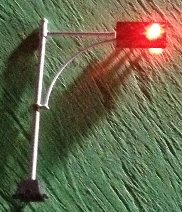

Finished one this morning... One thing I noticed during testing was when this bulb blinked on, all my highway poles dimmed just a little. I have at least a dozen blinking lights so I'm gonna hook the blinkers up on their own transformer...
Edited by - walt on June 19 2014 01:23:02 AM

Thank You, Stephen... Have a better photo of that blinking light that does have the light glare.... I'll load it when I can...
 Posted - June 18 2014 :  8:53:04 PM Link directly to this reply  Show Profile  Add walt to Buddylist
I think IF I get a set of those highway/street lights I will change one to LED just to show how much brighter it is

Thank You, Nelson... The blinking red
Color looks nicer than the yellow... The modification was really simple to do.

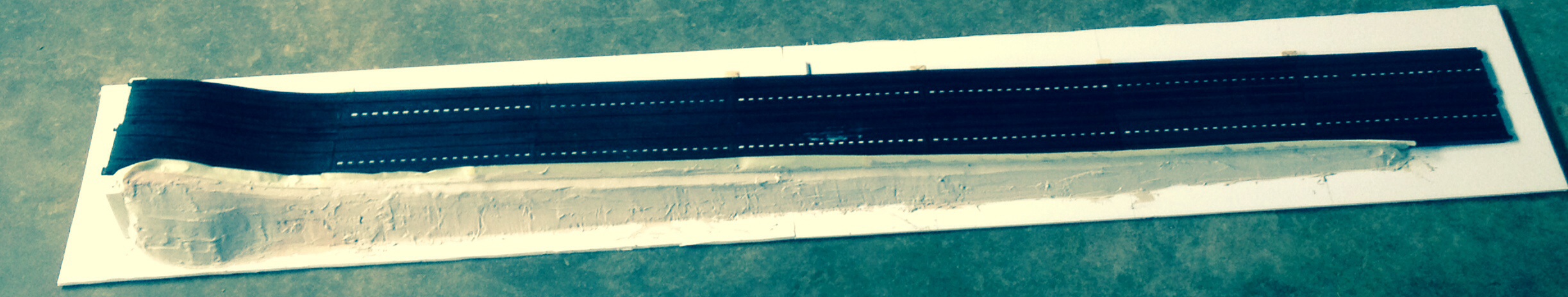

 Posted - July 05 2014 :  9:53:16 PM Link directly to this reply  Show Profile  Add walt to Buddylist

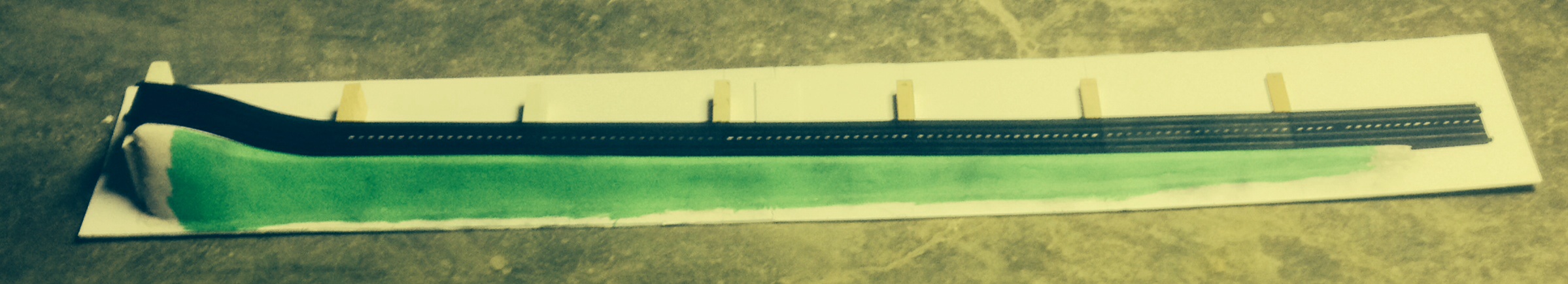

Using a hard foam board, 1/4 inch to construct my 4 lane slot car bridge over the trains. This 5-1/2 foot section is only half, or one side of the rail tracks... Will form grass/earth banking from the car track sides down to the bottom of the pillars. Going to use auto-body plastic bondo filler for this. Testing what this $28 new can will do for the hobby. Using this method, I can apply filler in my shop and no fumes will be in the house at all..
UPDATE: I have some large poster board that I had cut, shaped and glued to the roadway piers and the foam board below. I am excited about this tonight as the little section I used the body filler over turned out just as I expected ! I believe this is going to work out well... I'm laying the filler at the top even with the roadway surface. This will end up as "berm", and can be graveled etc.... I can leave it a little rough or sand it a bit, then paint and cover with grass, Etc..
QUESTIONABLE, I mixed the filler in my shop then carried the cardboard into the house/basement. NO one in the house mentioned smelling it at all.
Edited by - walt on July 06 2014 01:30:03 AM

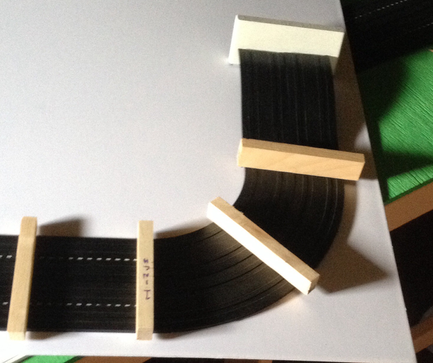

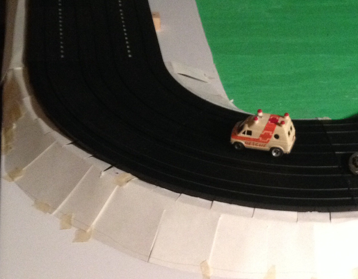

 Posted - July 06 2014 :  6:25:23 PM Link directly to this reply  Show Profile  Add walt to Buddylist
Have one coat on so far. Masking tape along the side & top of the track edge forming a nice berm along the side of the road. Later I'll remove the track and do a little sanding, then add filler where needed. I figure painting and some heavy grass etc, will top this off nicely. I will cut off excess foam board then mould the edges to the layout table...
Edited by - walt on July 06 2014 6:28:02 PM
 Posted - July 07 2014 :  11:53:05 PM Link directly to this reply  Show Profile  Add walt to Buddylist

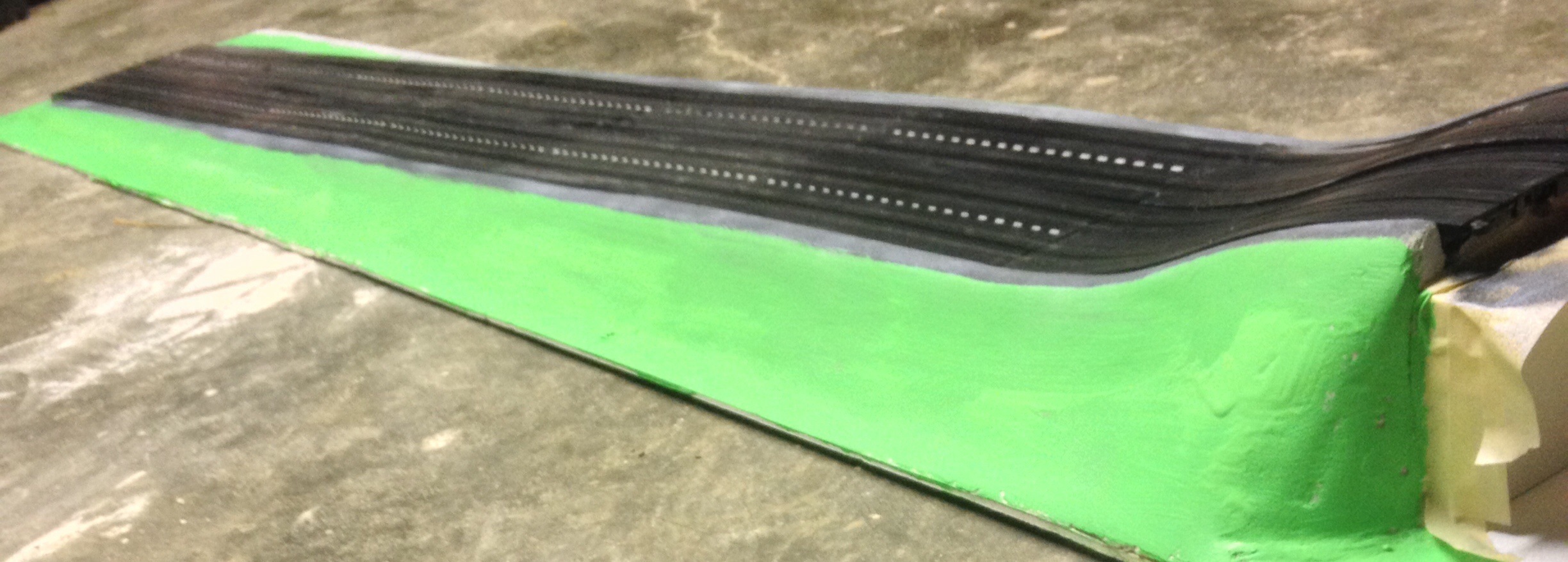

Spent some time shaping the one side. Still needs a bit of filler on each end.. The autobody filler works well for me.... Berm is flush with the roadway...should cover well with Woodland Scenic products.
Edited by - walt on July 07 2014 11:59:42 PM
 Posted - July 08 2014 :  1:12:21 PM Link directly to this reply  Show Profile  Click to see DaCheez's MSN Messenger address  Add DaCheez to Buddylist
Very clean work, Walt! I can't wait to see it finished. One thing I've never tackled in any layout is change in track/road elevation. You're going to have a super fun layout to drive!
 Posted - July 08 2014 :  8:30:58 PM Link directly to this reply  Show Profile  Add walt to Buddylist
Originally posted by DaCheez - July 08 2014 :  1:12:21 PM
Thank You, Eric! The other half of the bridge has a curve. It will be fun doing the same method to...

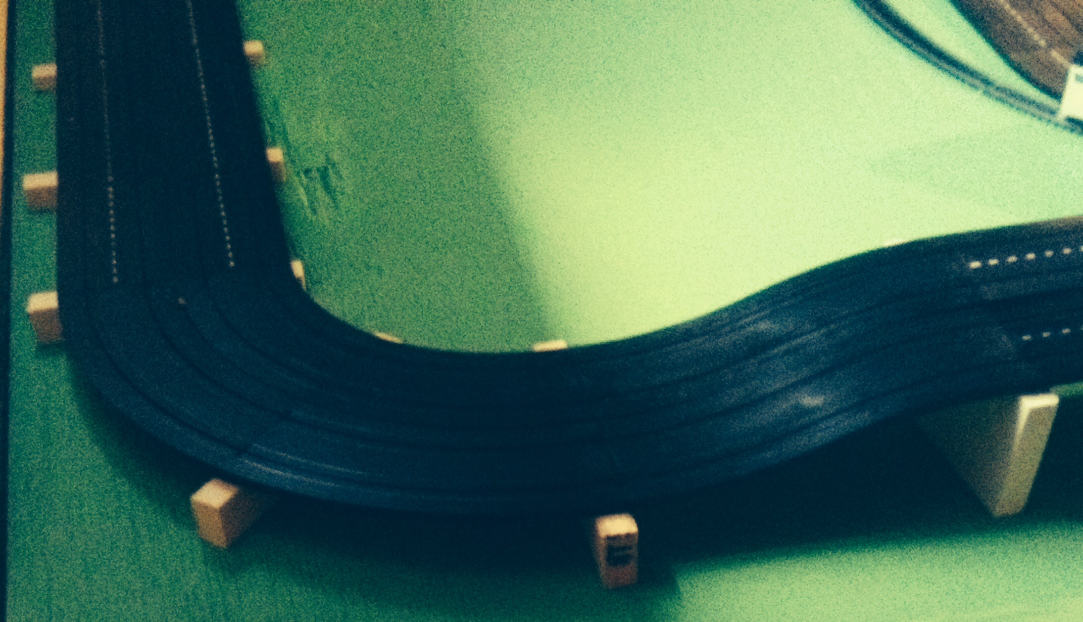

Got another foam board and have started the curved side of the bridge. I've measured, marked, centered and hope to mount the piers soon. Gonna miss more days as I'm going to Pigeon Forge, Tenn on Wednesday till Sunday night..

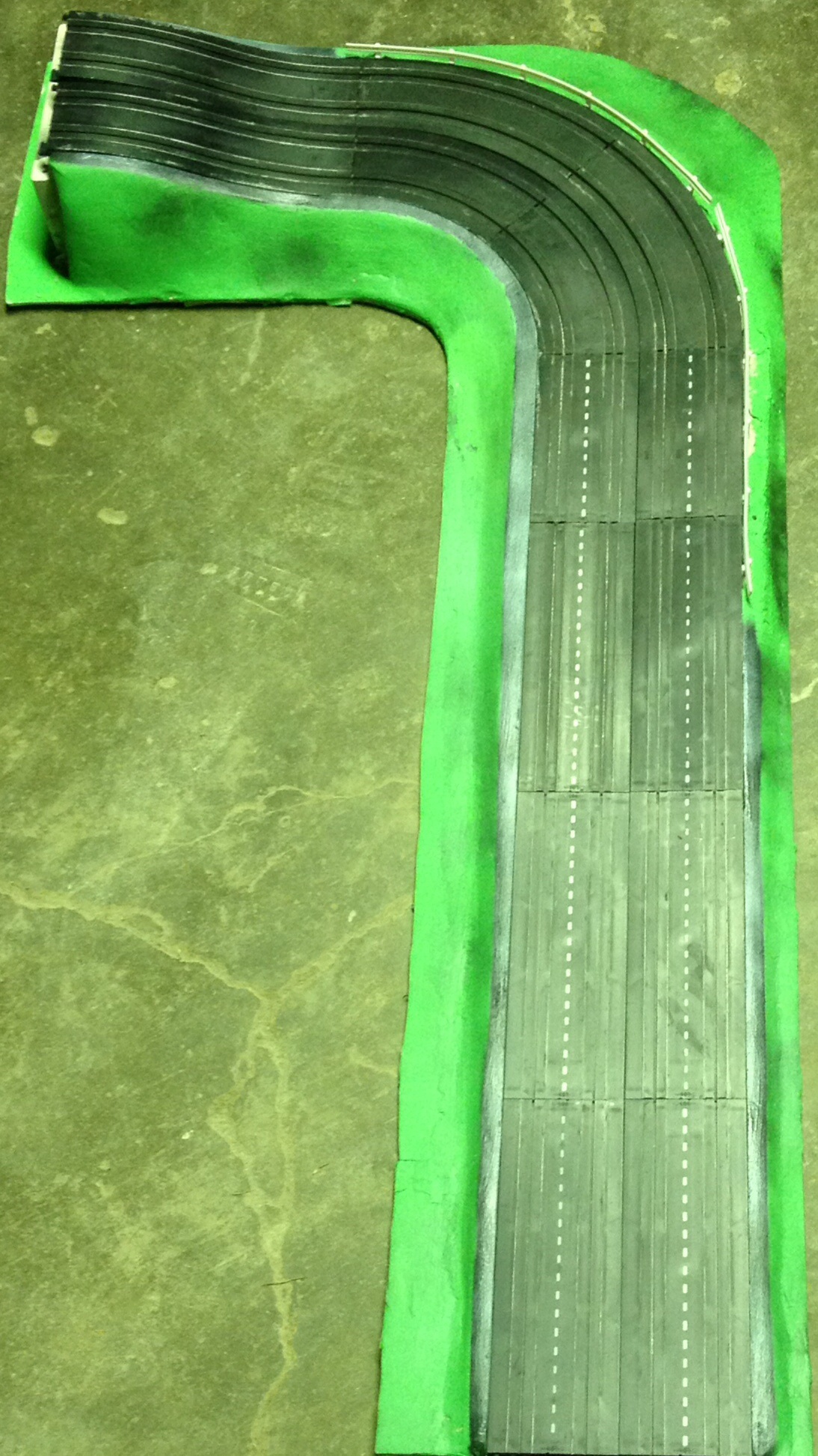

Have the first bridge half to a comfortable stage so I spent a little time on the curved half today. Maybe some Bondo on it tomorrow... I think the guardrail will get molded in on this curve...
One trick using the body filler is not to use much hardener in it. I'm using just enough to make the filler harden. This adds a little more "spreadable work time" to apply it.

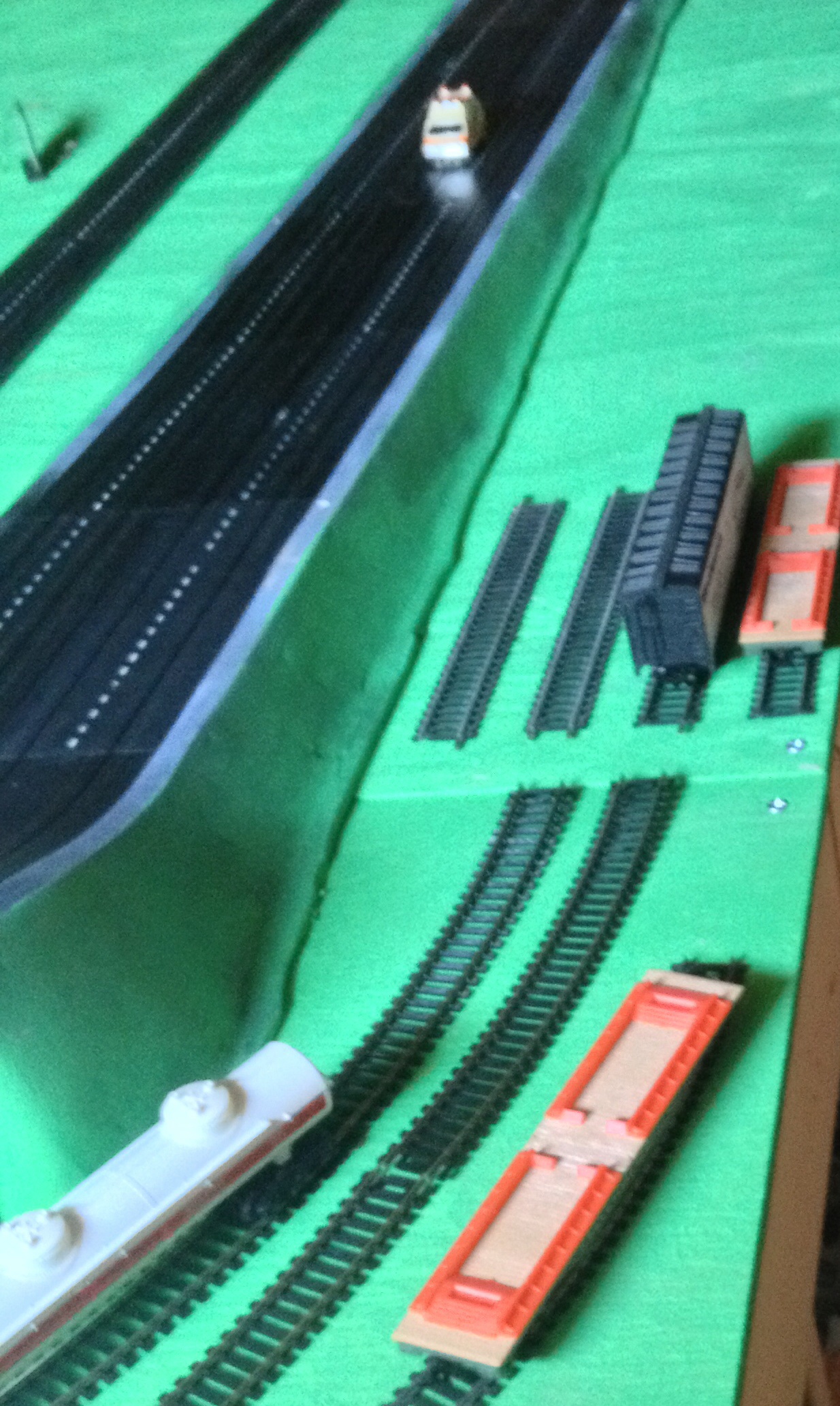

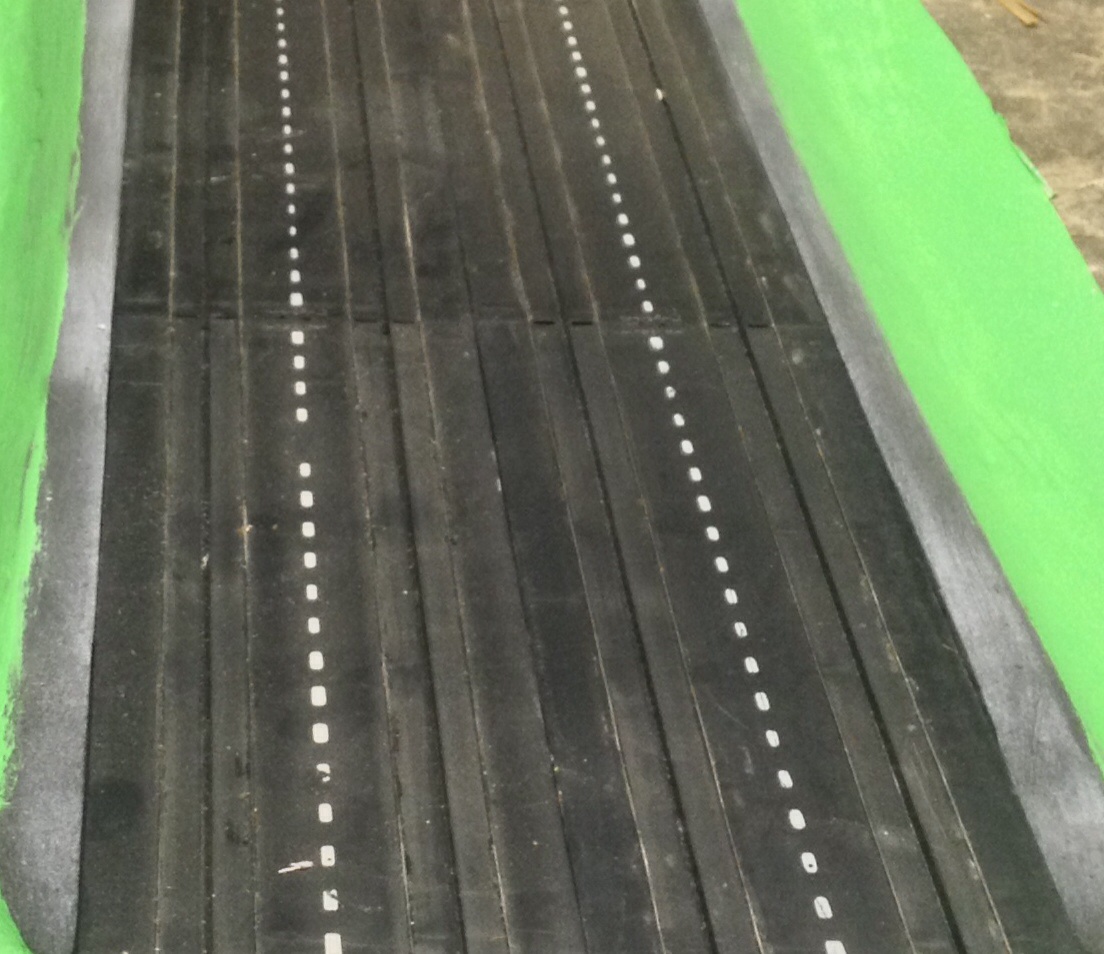

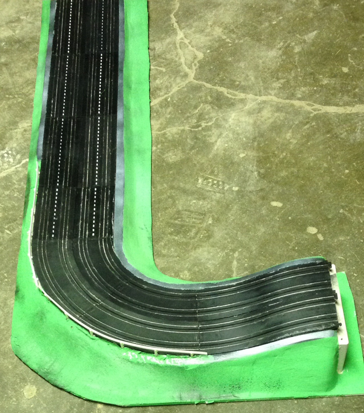

Almost have one side of the bridge complete. Will be glad to have them out of the way. These has required a lot of time. Too many trips and vacations this summer, seems like everything is moving real slow. Still exciting to think about what it will become...
I now have the hard part done on this piece. Track got really dirty so I'll have to clean it and add NoOxid again... A real quick paint job leaving the berm areas a black/white spray. A mix of Woodland Scenic products should finish this area to look good. ( I hope )
Edited by - walt on August 01 2014 5:18:44 PM
 Posted - August 01 2014 :  10:49:15 AM Link directly to this reply  Show Profile  Add walt to Buddylist

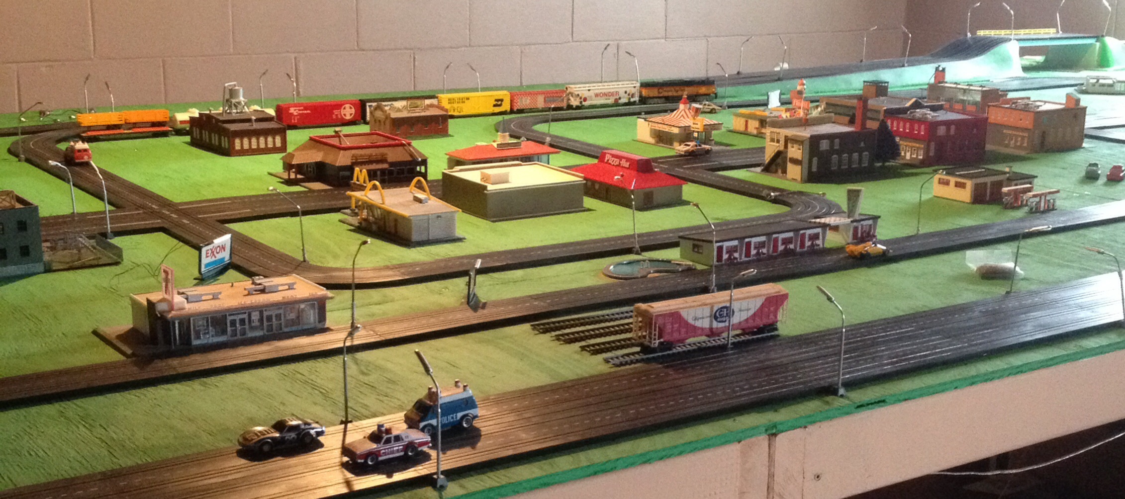

Finally got this half of the bridge grade back on the table top. A couple of pics, one with light poles with their wires thru drilled holes, but pole are not mounted yet. Bottom will be moulded onto the board when done. Can't wait until the Woodland Scenics get on!!!
Edited by - walt on August 01 2014 2:05:25 PM
 Posted - August 01 2014 :  11:53:55 AM Link directly to this reply  Show Profile  Add kovacste000 to Buddylist
Your layout is looking a little bit better every time you post a photo of it.About you having a ton of vacations, I'm the same way. My family almost always seem to be planning to go on some big vacation all the time during the Summer so I don't have as much time as I would like to work on my model train stuff.
Edited by - kovacste000 on August 01 2014 11:55:16 AM
 Posted - August 02 2014 :  4:09:53 PM Link directly to this reply  Show Profile  Add walt to Buddylist
A pic during working with this section. I don't leave the track on all the time, but it still gets plenty dusty.... This section has been easier as I learned what not to do on the other half...
 Posted - August 08 2014 :  12:48:47 AM Link directly to this reply  Show Profile  Add walt to Buddylist
Finally have the hard part of the bridge grades finished. A quick shot of paint and placed the dirty slot car track on before the paint was dry.. I'll trim bottom foam board and mount to train layout table soon. Gotta make a woodland scenics purchase before long!
Edited by - walt on August 08 2014 12:58:40 AM

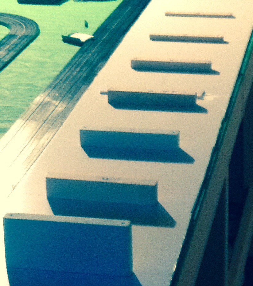

 Posted - August 10 2014 :  4:32:54 PM Link directly to this reply  Show Profile  Add walt to Buddylist

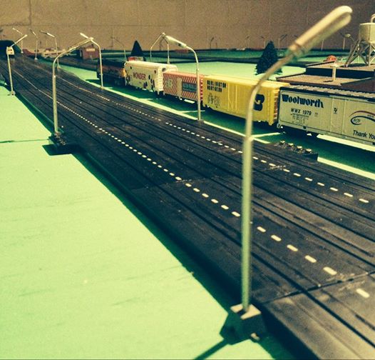

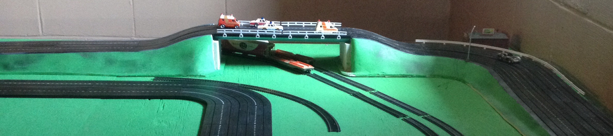

A couple of pics after placing the bridge grades back on the table top. Track still dirty but mocked this pic up quickly.
 Posted - August 10 2014 :  5:41:40 PM Link directly to this reply  Show Profile  Add kovacste000 to Buddylist
This layout is coming across really well, walt.Every time I check this thread it just seems to look better and better.

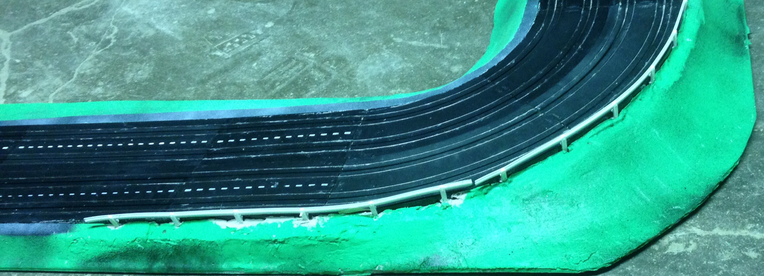

Thinking of painting the guardrail on the bridge either yellow or silver....
I have also decided to change the railroad a little at the bridge as seen in photos. originally I was going to square them under the bridge for a large rectangle. Had a little more room under there so I'm going to angle them out a bit, leaving room for one of my side tracks to go down a space between the slot track and bridge grade...(also seen in pic)

A pic of the side with the bridge at the far end. Drilled and placed more light poles, not wired yet..

A distant photo of the layout in the dark. Have 48 fluorescent poles working now. Pic is most of the long 4 lane, around the curves & over the bridge & on back some... A few cars are visible on the long straight...
Edited by - walt on August 23 2014 02:00:55 AM
 Posted - August 23 2014 :  08:15:27 AM Link directly to this reply  Show Profile  Add scsshaggy to Buddylist
Originally posted by walt - August 23 2014 :  01:48:03 AM
That looks pretty good. It reminds me of flying at night and looking down on the rows of street lights in the full-size world.
BTW, what did you end up doing in terms of lights per transformer and how many lights in series after all your experimentation?
 Posted - August 23 2014 :  10:16:33 AM Link directly to this reply  Show Profile  Add kovacste000 to Buddylist
Originally posted by scsshaggy - August 23 2014 :  08:15:27 AM
It does actually.
 Posted - August 23 2014 :  3:12:03 PM Link directly to this reply  Show Profile  Add walt to Buddylist
Thank You, Don
I ended up using only 16 lights per transformer. This leaves them at a fairly bright yet realistic look. I take two light poles, and connect one wire from each pole together. The other two wires go to the power wires. Basically saying running 8 pairs of lights per transformer...

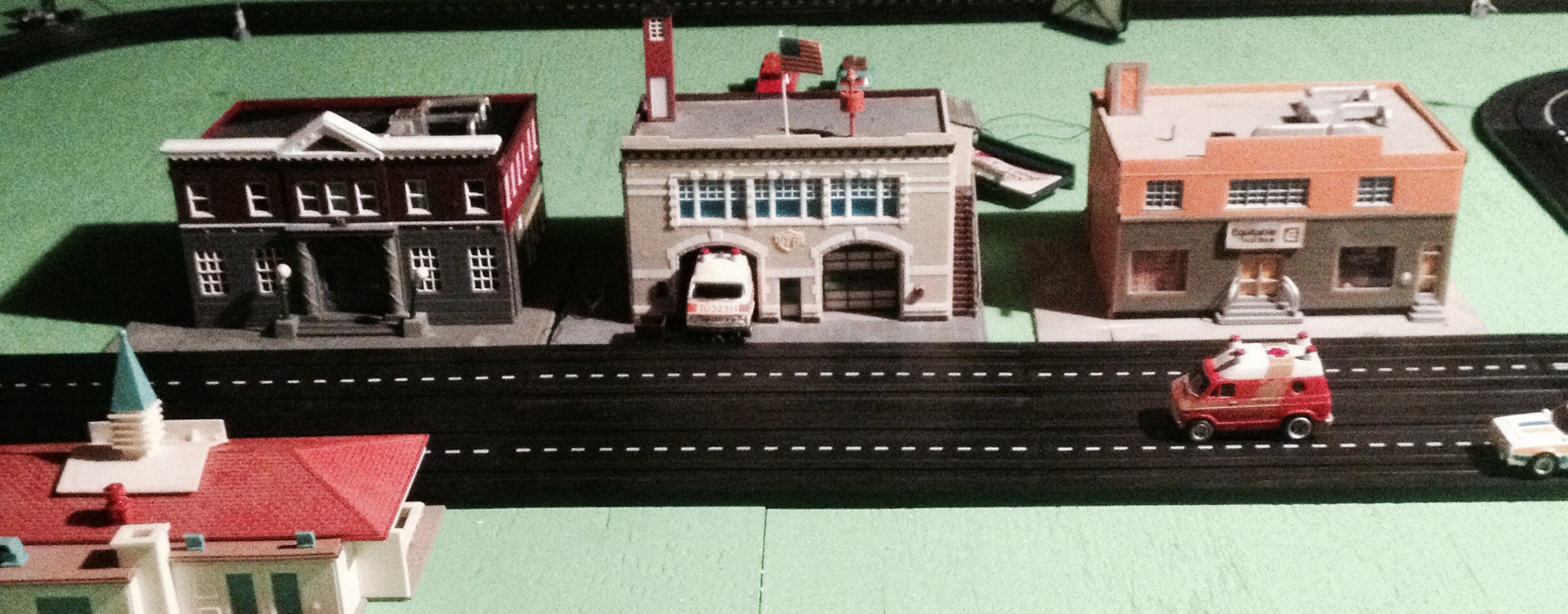

Messin' with some buildings trying to decide what will be where.
2nd pic is 3 Life-Like Buildems... Police Dept, Fire House and Bank...
 Posted - August 24 2014 :  10:57:44 AM Link directly to this reply  Show Profile  Add kovacste000 to Buddylist
That looks just like a town scene from the 1980's.
 Posted - August 25 2014 :  01:21:58 AM Link directly to this reply  Show Profile  Add walt to Buddylist
Originally posted by kovacste000 - August 24 2014 :  10:57:44 AM
Yeah, Stephen... I'm there in the 70s to 80s era! Only one shown in this pic (theater) but I'm thinking of where to put the 8 Tyco Center Street Series buildings... The street with these buildings in the photo is right in the "center" of the layout... Should this become, "Center Street" ???

Put up 16 more Tyco Fluorescent light poles and have 15 them wired and working. Have only 16 more to have the complete 4 lane section finished. Then have only 19 Life-Like Expressway poles to wire around the 2 lane sections...
I Like This Photo... After the roadway lighting is finished there will be buildings & homes lighting inside and exterior, billboards, and signs...
Pic of trying to figure out what section the buildings will be placed...
Edited by - walt on October 11 2014 01:11:24 AM
 Posted - September 02 2014 :  3:06:26 PM Link directly to this reply  Show Profile  Add gmoney to Buddylist
Is there a four track mainline planned for that area there in the foreground?
