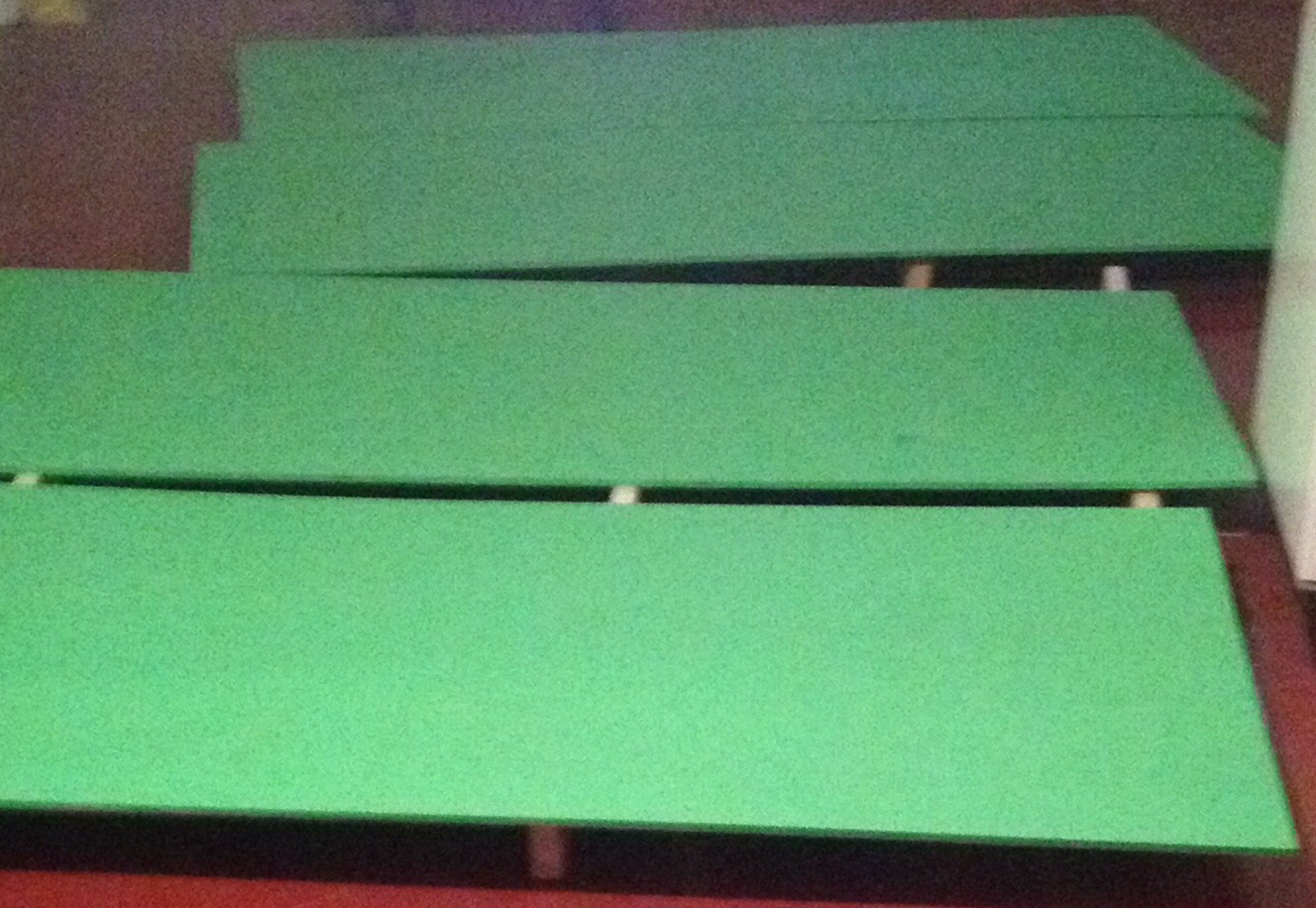

 Posted - February 23 2014 :  12:50:49 AM Link directly to this reply  Show Profile  Add walt to Buddylist
Got home and spent some time in the basement painting the 5- 4X8 sheets of plywood... Tried to load a photo but it was large and wouldn't load. Maybe I'll crop a photo tomorrow...

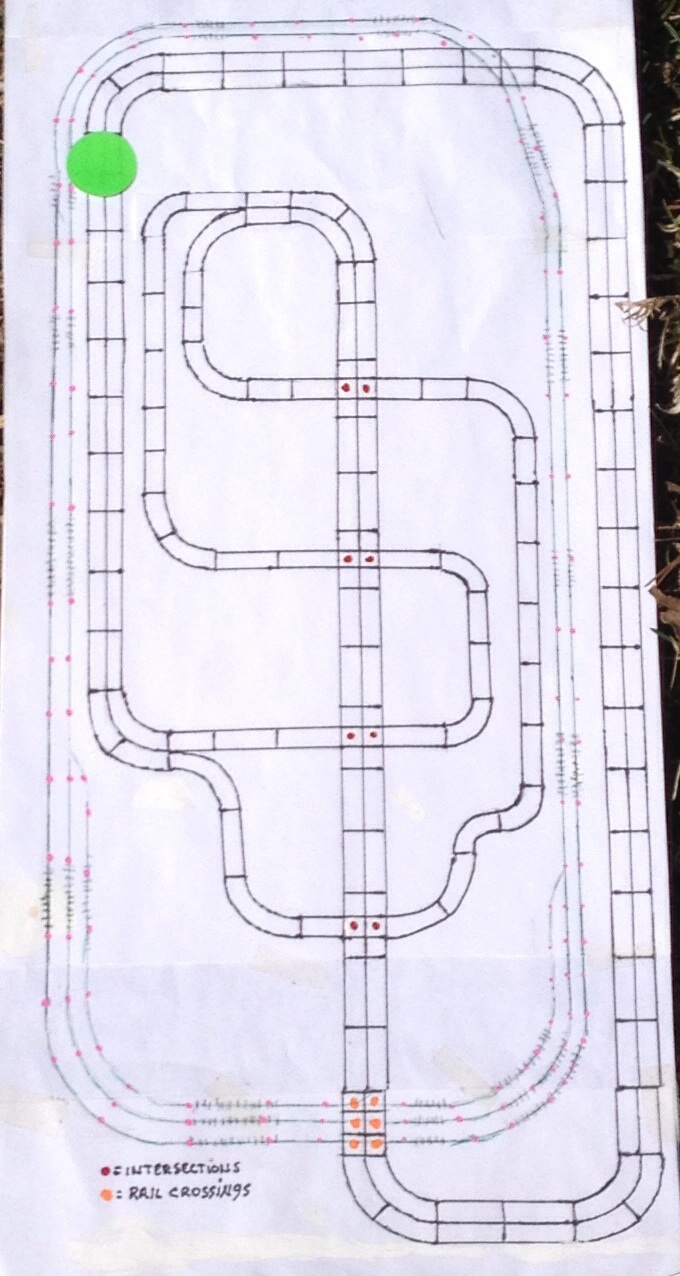

Superb track plan. I tried doing something similar, but I was using some cheap Chinese brand of slot car, and the slot cars quickly suffered loose drive gears and the conductivity of the pick up on imbedded rail was miserable after but a few weeks. No amount of cleaning was able to restore reliable conductivity. My other headache was that the slot cars shot about as fast as bullets, making them very hard to view.
I have no familiarity with Tyco slots, and hopefully you will be able to surpass these obstacles.
One idea I never got to was wiring the train tracks to hand held slot car throttles- having the trains race each other, and the cars.
I will look forward to seeing your future work and hope it is a banger!

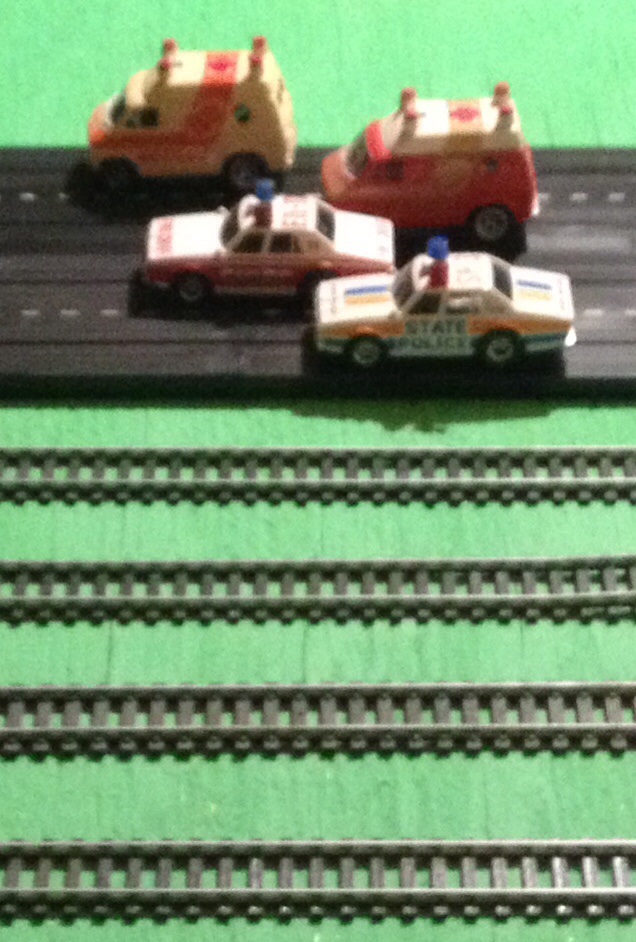

 Posted - February 27 2014 :  10:59:10 AM Link directly to this reply  Show Profile  Add walt to Buddylist
Hi, Jeff
Was able to spend a little while at home last night second coating a few studs. Should get some assembly done this weekend for sure...
I plan on using the AFX cars on my layout. I have a few of them already. Slot cars can be pretty quick, but I beLIEve that is the purpose...
I run my two main railroad tracks in opposite directions. I never had many issues with my smaller similar layout in the 70s... I feel that I can comfortably make this work..

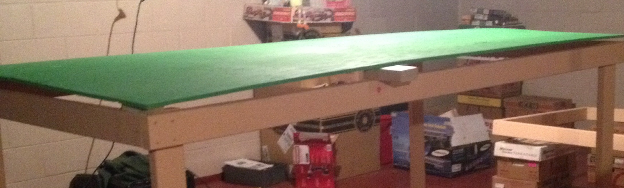

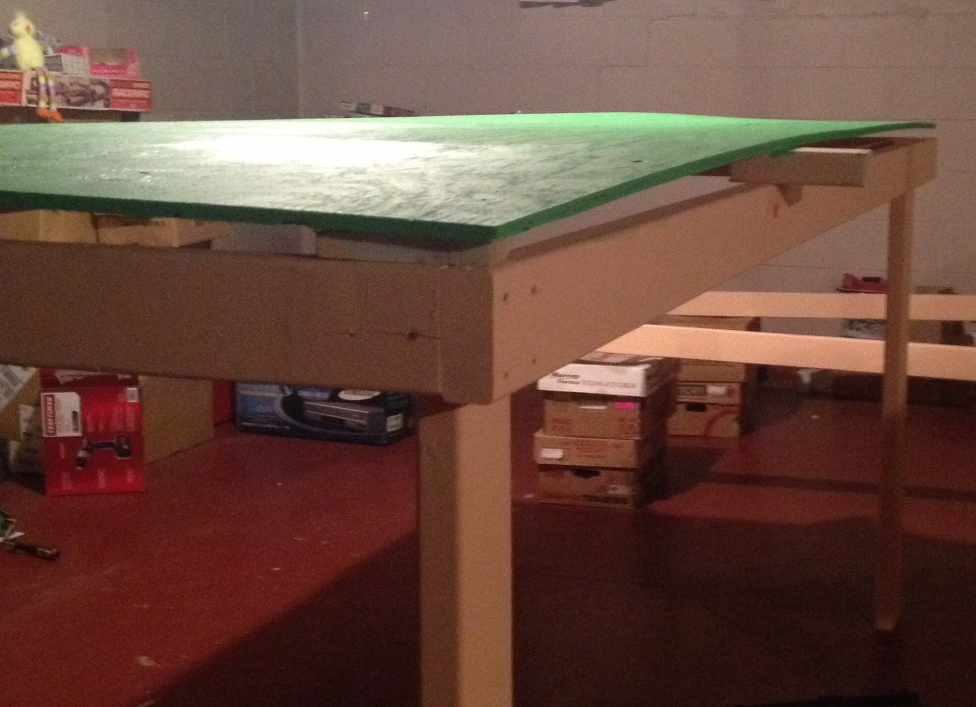

I assembled one table of 5 this evening. The top sheet is not screwed down yet as I have the one 2X4 to paint. Also need to make sure the green edge is totally covered. The ends and middle will be a table like this one. The second and forth tables will bridge between the other tables without legs. May do another tomorrow if time permits.
UPDATE ; Only managed the one table section this weekend but did get the green edge done and some peach touch up... So 1/5th of my bench is done...
Edited by - walt on March 01 2014 8:42:38 PM

Got all 3 of the legged 4x8 tables standing tonight and one of the sections that will be bridged between the standing ones. Leaving only one more section to assemble. Shown in pics is the crazy time I'm spending painting the green edges before mounting the plywood. Waay too much time being killed here.
 Posted - March 08 2014 :  08:17:38 AM Link directly to this reply  Show Profile  Add JNXT 7707 to Buddylist
walt I admire you for your patience on the benchwork. You know at first glance though I was thinking "look at the rolling landscape"

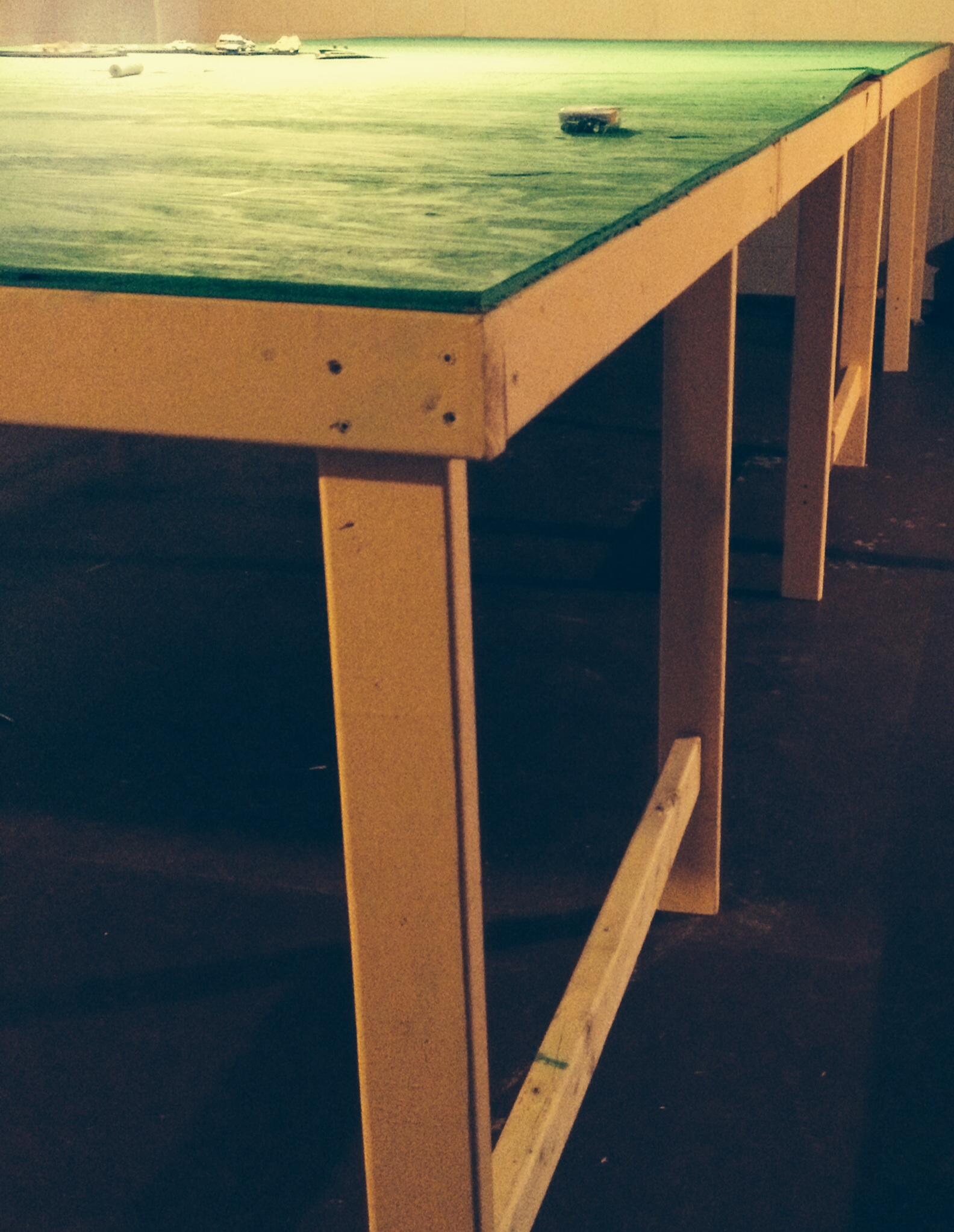

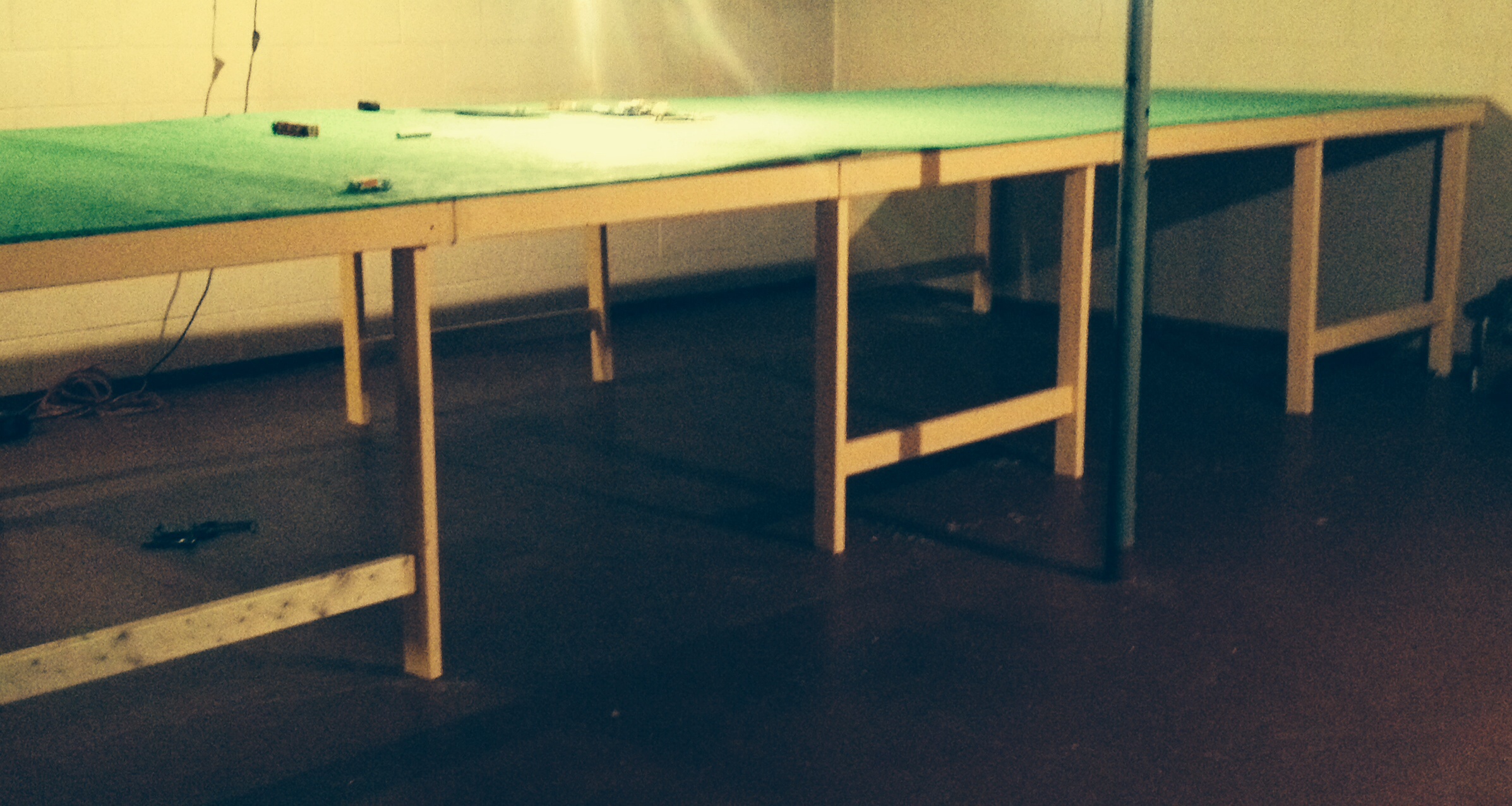

A shot of 3 sections (12X8) sitting together as I was working last night. The middle section plywood is off cus I had bought 3 new studs to build it (due to warped others). Got most of the painting done and ready to assemble all 5 sections next weekend...
 Posted - March 16 2014 :  5:32:42 PM Link directly to this reply  Show Profile  Add walt to Buddylist

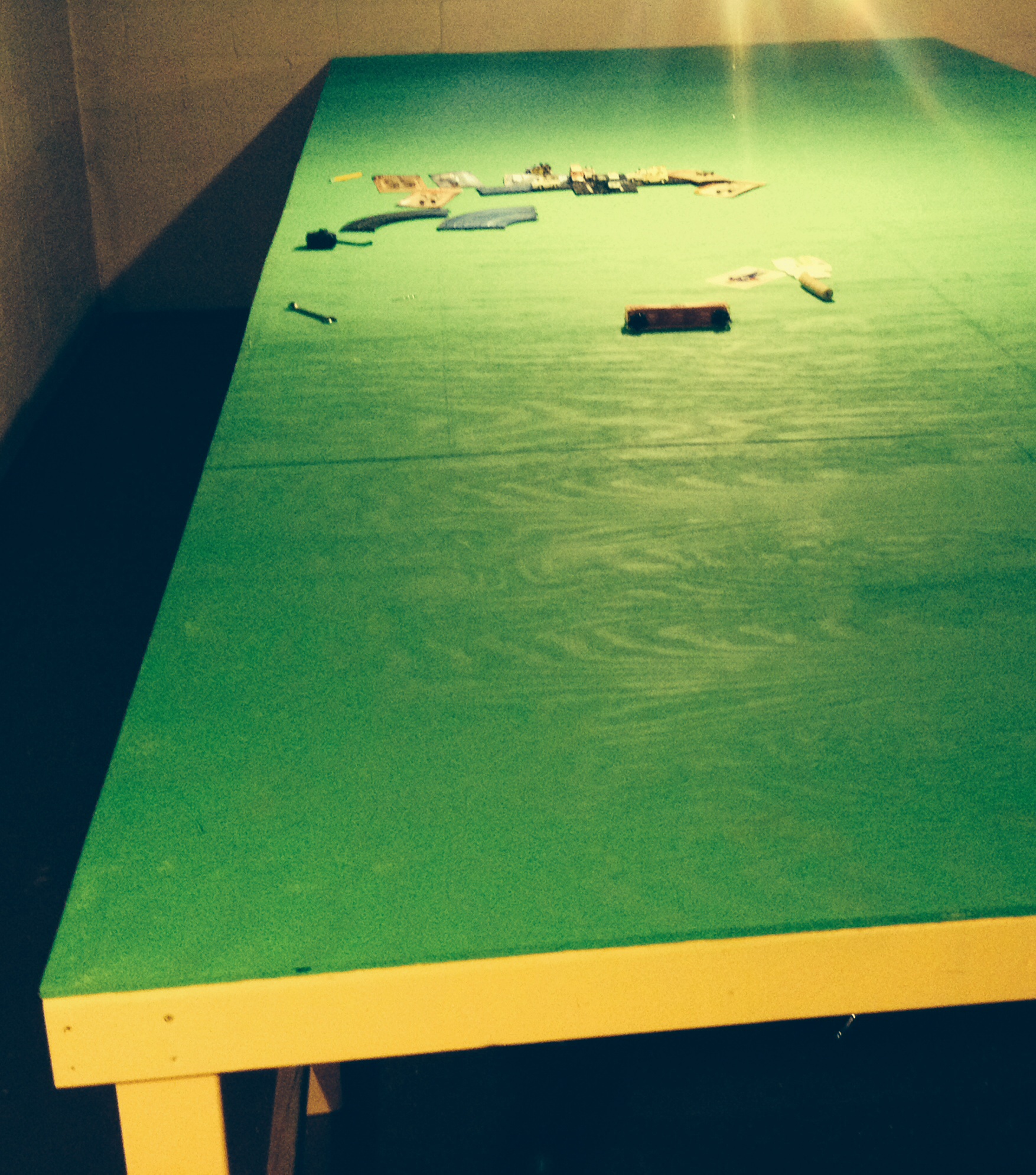

Got the bench done about 3 o'clock on Sunday. Since photos I placed 12 screws around the edges of each 4X8... Need a tiny bit of peach paint to apply...
A pic across the 20 foot, a few slot cars, etc on the table ...
Edited by - walt on March 17 2014 12:21:59 AM
 Posted - March 16 2014 :  9:12:12 PM Link directly to this reply  Show Profile  Add Barry to Buddylist
That's gonna be a nice spread Walt. I hope there's an area where the street lights get burned out so the drag racers will have a place.
 Posted - March 17 2014 :  12:47:00 PM Link directly to this reply  Show Profile  Click to see DaCheez's MSN Messenger address  Add DaCheez to Buddylist
Very clean work! It's coming along nicely.
 Posted - March 17 2014 :  1:09:38 PM Link directly to this reply  Show Profile  Add kovacste000 to Buddylist
Good job so far!Looking forward to seeing it when it's done!

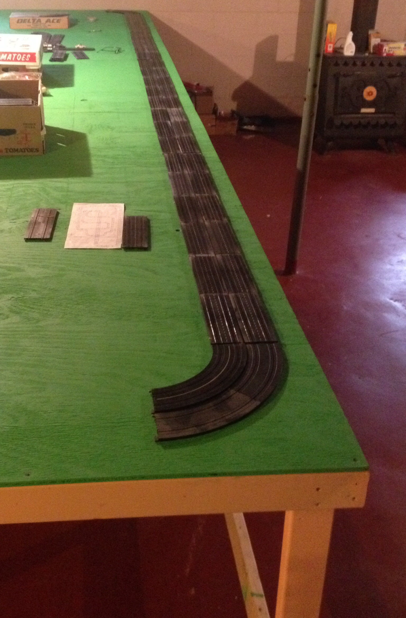

 Posted - March 17 2014 :  7:42:53 PM Link directly to this reply  Show Profile  Add walt to Buddylist

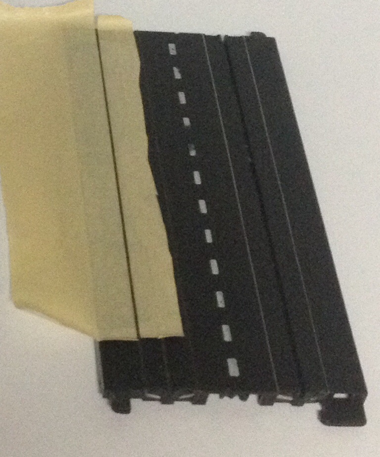

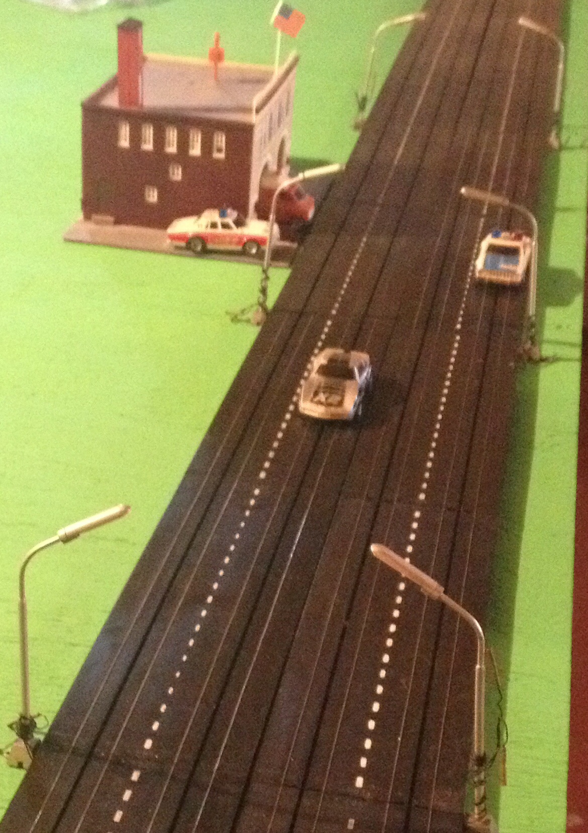

Thank You, Eric, Barry & Stephen... Had a few minutes today and layed out the almost 20 foot straightaway. Track is so dusty from long storage that I brought it with me to clean each piece. Waiting for the weekend again!
Edited by - walt on March 17 2014 8:48:21 PM
 Posted - March 18 2014 :  02:23:41 AM Link directly to this reply  Show Profile  Click to see DaCheez's MSN Messenger address  Add DaCheez to Buddylist
Ahhh, now that's a beautiful sight! I like how all of your straights have the dotted center lines. You're catching up to me in terms of layout progress. My progress unfortunately is only going to slow down...it's getting warm enough outside to work on my 1:1 car...not that I'm too disappointed!
Looking forward to your updates!
 Posted - March 18 2014 :  10:59:44 AM Link directly to this reply  Show Profile  Add walt to Buddylist
Hi, Eric... I liked the painted detailed track better than the plain. All of my track has the paint other than my 12 inch curves that have none. I believe I've seen some 12s with paint over the years. I will watch for some and buy them if they exist. The detailed track was made from 1963 - 1971. Cleaned quite a few pieces late last night.

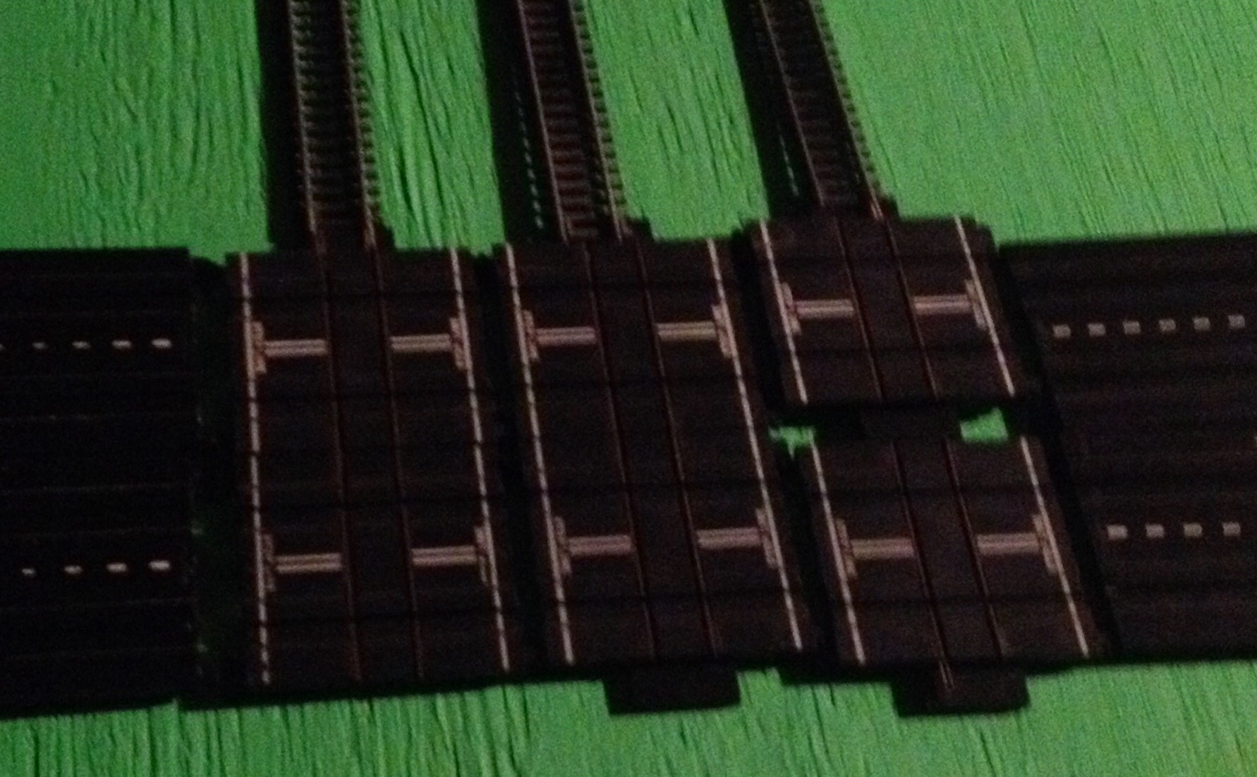

 Posted - March 20 2014 :  11:48:35 AM Link directly to this reply  Show Profile  Add walt to Buddylist

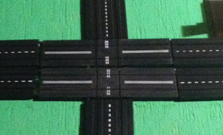

Had an hour late last night and layed down some cleaned slot car track. I still have to shine electric contacts on the ends. Won't snap track together until I'm sure of what fits where. Trying to figure where the underpass needs to be ...
Edited by - walt on March 20 2014 12:05:35 PM
 Posted - March 22 2014 :  12:27:10 AM Link directly to this reply  Show Profile  Add walt to Buddylist
Got the full slot car track layed down and I believe this is what it will be. On Saturday, I need to dig my girder truss bridges out and make sure the look and fit well. I actually used all of my 9 inch straight pieces (I was afraid of this) but have a lot of 6 inch straights to fall back on... I took some pics of the whole layout but can't crop one enough to load here...

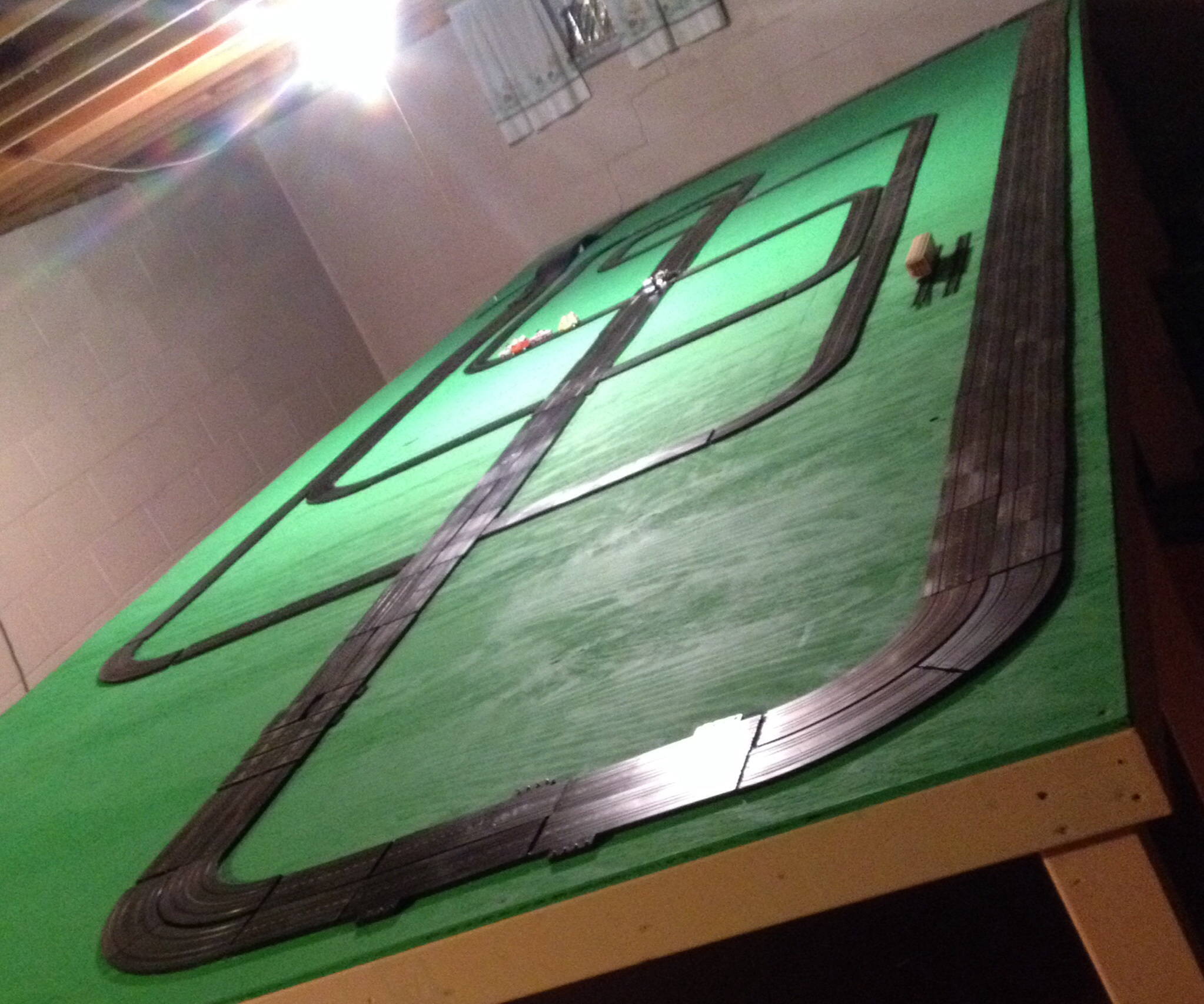

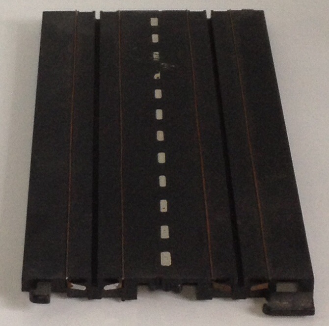

 Posted - March 22 2014 :  6:42:07 PM Link directly to this reply  Show Profile  Add walt to Buddylist
Doing Everything from phone right now. I did manage to get a photo to load. It's hard to get a good photo of the whole layout. Spent some time today cleaning the electrical contacts on the ends of each piece of slot car track. Also have connected the long 20 foot straightaway on the right side , it's done.
Cleaning The electrical contacts became a project using an emery file. Had to be a better way. Thankfully I have a large cutting wheel that I cut automotive custom frame pieces with that cleaned the contacts in record time.
Edited by - walt on March 23 2014 01:08:57 AM
 Posted - March 22 2014 :  8:28:28 PM Link directly to this reply  Show Profile  Add gmoney to Buddylist
I hope there's something left of the contacts!
Thanks for the overall pic. Looks really cool. It could get interesting at the intersections once you have some city buildings in place! How about installing those Hot Wheels cameras in the cars and driving while looking only at the video monitor!
 Posted - March 22 2014 :  9:07:28 PM Link directly to this reply  Show Profile  Add JNXT 7707 to Buddylist
Walt that thing is CRAZY....and looks cool as heck. Looks like a blast to drive on, especially with the way the road splits apart and comes back together. Amazing. Can't even guess yet where you plan on putting the railroad tracks, looking forward to seeing more
 Posted - March 22 2014 :  11:40:22 PM Link directly to this reply  Show Profile  Add walt to Buddylist
Thank You, Glenn
That metal cutter would cut one of those tracks in half in about 2 seconds! I've found electric tools that run fast can be controlled by using a short extension cord with a fan controller in it... Had the large cutting wheel running VERY slowly
The intersections and train crossings are a blast. Even have to try to place the buildings where the more expensive ones doesn't get blasted in an intersection crash! Have the Hot Wheels Camera Car in mind for sure! Knew I had to have one of those the day I saw the clip that Metalsmith1 put on the forum not long ago...
Thank You, Jerry! Should be a riot as it grows with the buildings, light ups and landscaping. I found a decent drawing of the plans that will better show at least the two main railroads. I'll try to put it on here on Sunday evening... One thing I really like is the
long four lane straight on the right... that will have the Tyco Fluorescent street lights for some good ole night time street racing!!!
NOTE I plan to us 4 transformers, running each lane on its own power pack.
Future plans call for better overhead lighting, Nikon camera pix instead of iphone, Hot Wheels Camera Car clips and any other form of pix & movies to share this fun with others... Daytime pix, night time pix, ect... Feels like it's 1975 again guys!!
Edited by - walt on March 23 2014 12:47:36 AM

 Posted - March 24 2014 :  1:32:46 PM Link directly to this reply  Show Profile  Add walt to Buddylist
Here's a little better plan on paper showing the two main rails marked with small pink dots. Opposed to this plan I have extended the slot car track clear to the end of the table.(at top of photo)
This leaves the railroads girder bridges going over the slot track at the large green dot. I also left one foot on the left side bare, for turn outs and side tracks.
 Posted - March 27 2014 :  3:52:21 PM Link directly to this reply  Show Profile  Add walt to Buddylist
A pic of one of my dirtier pieces of slot car track. I have cleaned the left contacts but notice how dis colored the right ones are. The track gets a general surface cleaning with shining the contact rails on the surface...
 Posted - March 27 2014 :  8:20:39 PM Link directly to this reply  Show Profile  Click to see DaCheez's MSN Messenger address  Add DaCheez to Buddylist
That's some rusty track you have there, Walt! Are you using any chemical cleaners or just the metal cutter? The slotcar track I used on my layout just needed a good wipe-down with some WD-40 and Windex. The TT track on the other hand....that involved power tools.
 Posted - March 27 2014 :  10:13:37 PM Link directly to this reply  Show Profile  Add walt to Buddylist
Yes, Eric.. I used a nasty piece to show what a difference the clean side made. I have a lot of 6 inch straights and won't even use this one. Most of my track has no rust but the contacts are a bit dull. Cleaning every piece and thinking of getting some electrical contact grease and using a tiny dab on them. . Only the metal cutting wheel to shine these contacts. Have a slot car contact rail cleaning eraser for the surface rails...

now clean off one side of road but leave the other side icky & take a pic
 Posted - March 28 2014 :  02:16:27 AM Link directly to this reply  Show Profile  Add walt to Buddylist
There ya go Ben. I have about 20 pieces here. The end contacts have already been cleaned. Not home tonight so I used the masking tape, emery file method. Rub the tops of the rail clean, then lay the file along each side of the rails to clean. Fortunately I'm a long time custom car builder leaving me many ways of cleaning metal. Those not limited to sand, glass or other media blasting, oxysolve, cutting wheels of many sizes. My career and results, depend on extremely clean metal...

 Posted - March 31 2014 :  11:31:23 PM Link directly to this reply  Show Profile  Add walt to Buddylist
Brought 6 of the road & rail crossings to clean this week. Not bad for 40 plus year old track. Also have the 4 bridge track sections that will make up the underpass, and 6 of the 8, road & road crossings (intersections). Have 25 of the 9 inch straights here too.. Cleaned most of the contacts on the ends of the track earlier today... This is one of those " no fun" parts of the hobby!
