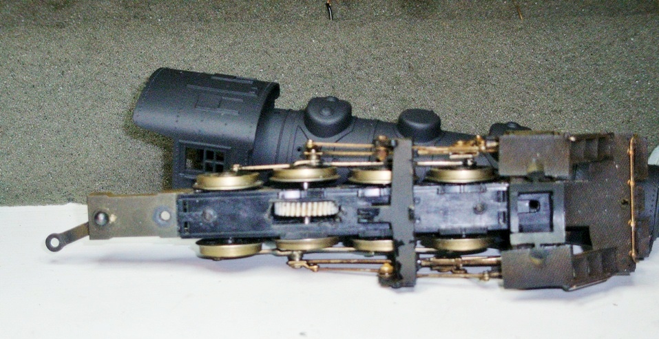

 Posted - September 30 2012 :  11:40:37 AM Link directly to this reply  Show Profile  Add Redneck Justin to Buddylist
There's a couple members who have had luck using a CD-ROM motor in place of the original motor. Mantua's 0-8-0 is loosely based on the Tyco 2-8-0/0-8-0 series. I believe with some work and the right parts, a motor could moved into the firebox/cab area. Just not sure what gear combo would work.

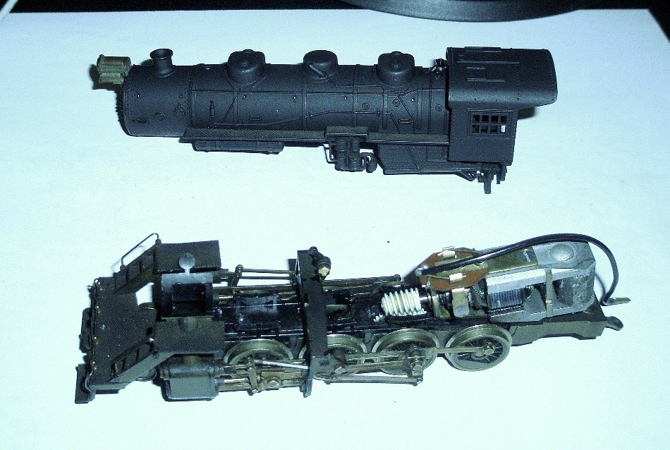

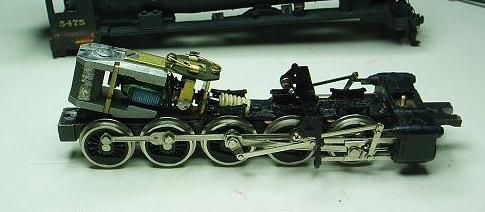

 Posted - September 30 2012 :  4:07:33 PM Link directly to this reply  Show Profile  Add toptrain to Buddylist
Just mount a motor on the loco drive frame.

 Posted - October 03 2012 :  4:47:46 PM Link directly to this reply  Show Profile  Send JRG1951 a Yahoo! Message  Add JRG1951 to Buddylist
One solution to this topic was covered here.
http://www.tycoforums.com/tyco/forum/topic.asp?TOPIC_ID=11842

 Posted - October 03 2012 :  4:52:33 PM Link directly to this reply  Show Profile  Add toptrain to Buddylist
This is another one done that way.
