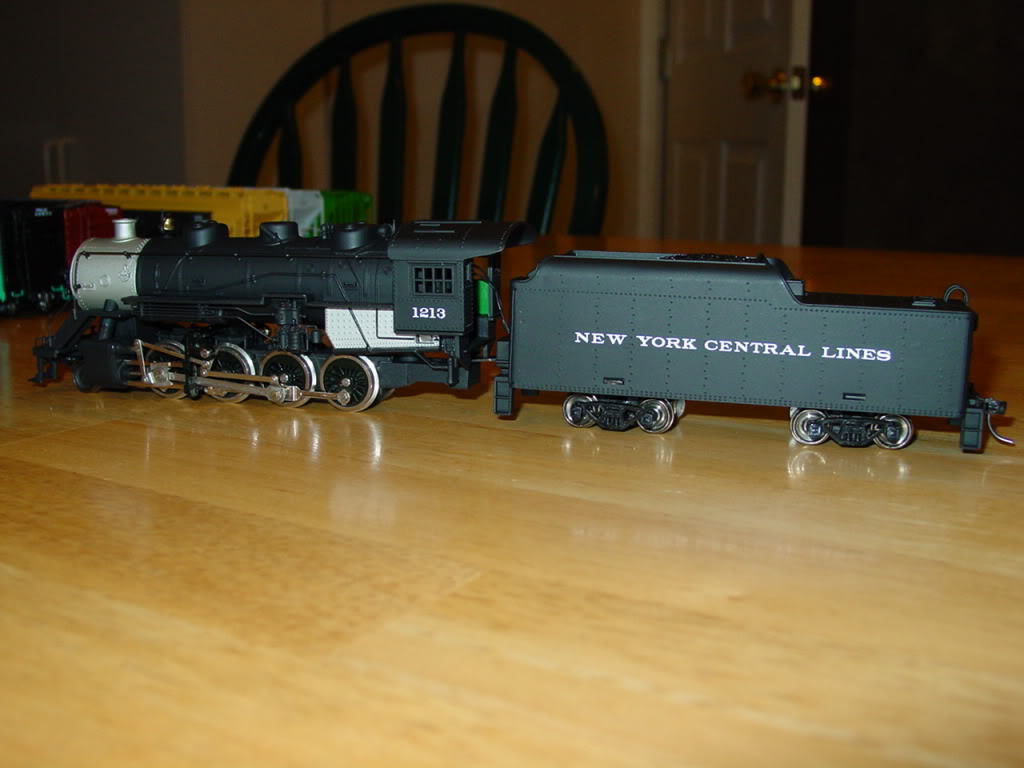

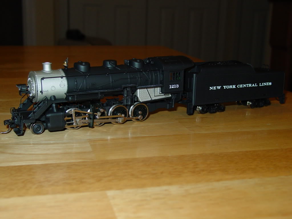

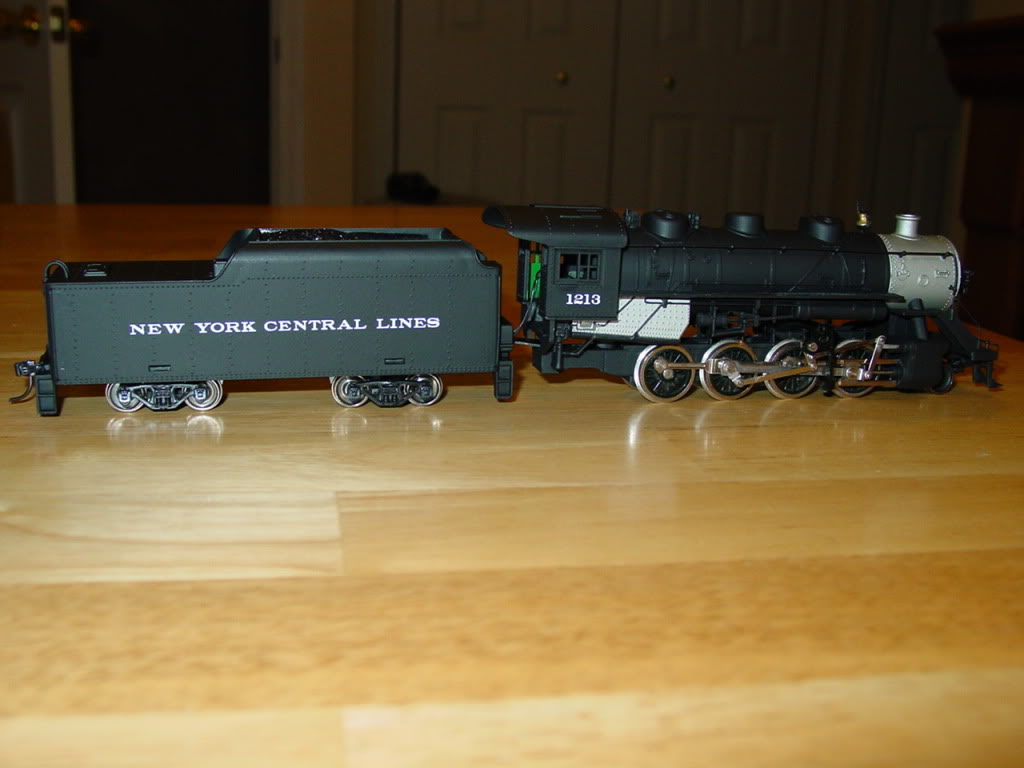

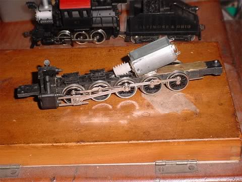

Darth Santa Fe here! I already posted my introduction in the appropriate forum, but I thought a better intro would be one of my finished projects.
This is one I did a while ago, and I think it's been linked somewhere around here before by another member when I put it on the MRR forum. I bought a junker Chattanooga at a train show a few years ago, and getting it to run up to my standards seemed hopeless, so I did a complete rebuild!

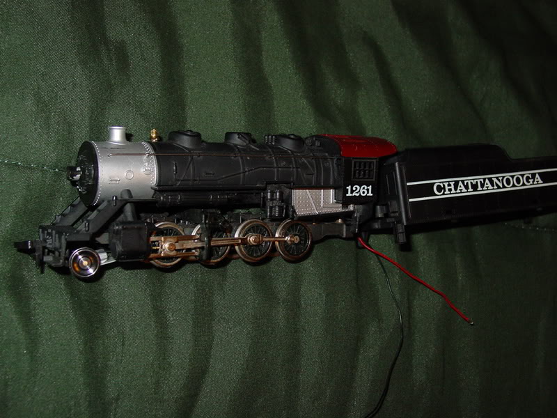

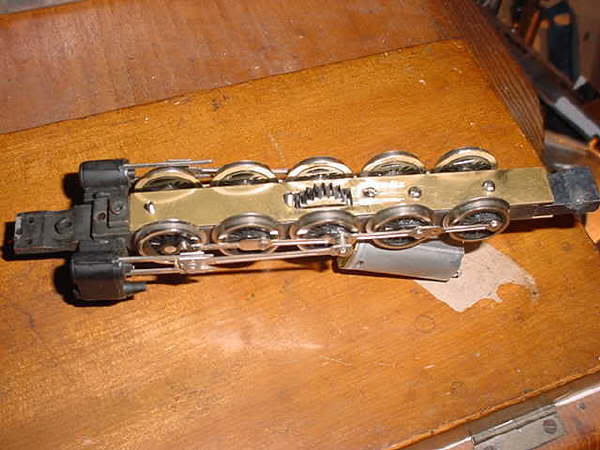

Here's what I started with, minus the PT drive unit and with a front axle added. Didn't look so good...

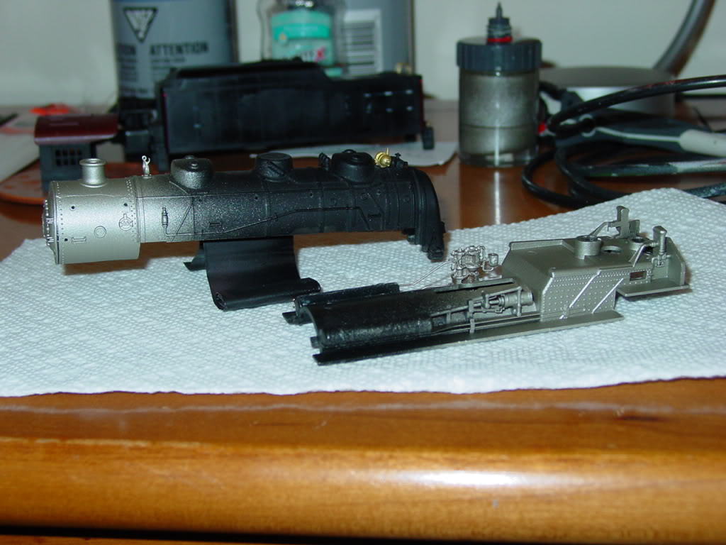

The replacement chassis in its early stages. I've since added better truck retainers, a constant forward lighting circuit, and removed some of the weight (too much drag for the small motor). The trucks and frame are built completely from scratch, the gearing and sideframes are all Athearn, the wheels are Intermountain 33" freight car axles, the motor is a 7-pole coreless type by Maxon, and the flywheels and universals are NWSL. It's not a heavy hauler, but it sure is smooth, and it's got more power than the old PT motor!
Added some detail, and then got lazy for about a year and made little progress.
Finally kicked myself into "finish this up you slacker!" mode and started on painting, and...

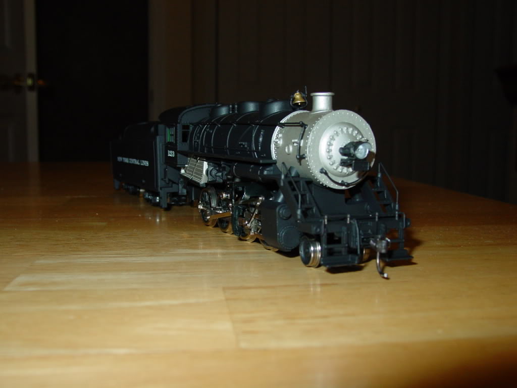

Finally finished! I get the feeling the NYC didn't have anything like this, but I don't really care. The Tyco Chattanooga was a fantasy steam engine built from the Mantua USRA 0-8-0 molds, so might as well have fantasy paint for added fun! All this to make a cheap plastic steam engine run a little better...

Still looks great, Darth. I'm surprised you had to remove weight, since even small can motors can pack quite a punch. How many ounces did you put in it?
Also, how do you go about balancing the flywheels? Do you just mark the high spot with a marker, or do you put it on a shaft and rest it across parallel razor blades and mark the heavy spot as when balancing motor armatures?

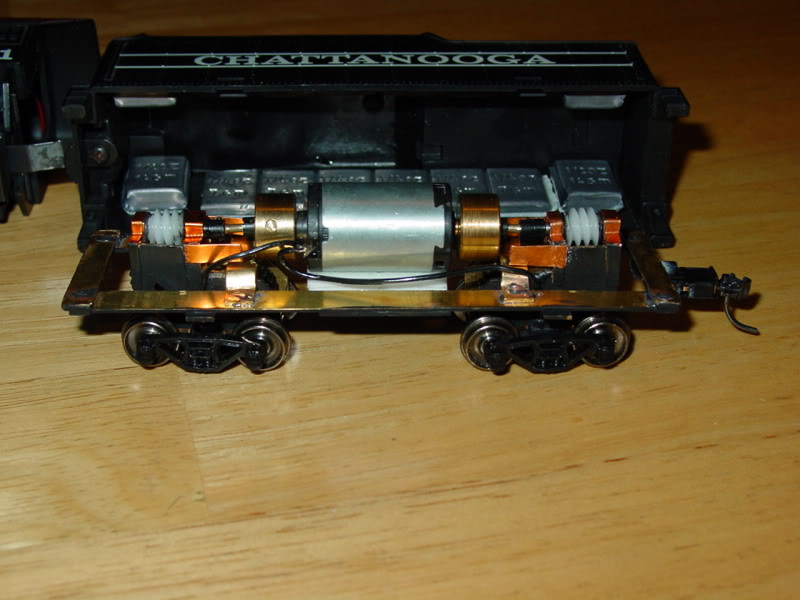

Darth, that tender drive is sweet! It never occurred to me to use Athearn components but it makes total sense now that I see it. Great work! - Thomas

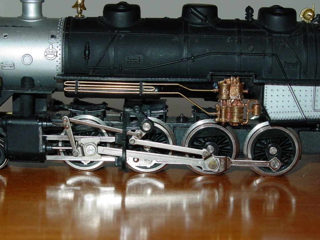

Thanks a lot everyone!
My Chattanooga didn't originally have a valve gear or front axle, so I made the front truck from scratch, and Nelson (NickelPlate759) was kind enough to sell me an extra valve gear he had.
The motor is actually smaller than it looks in the picture. The torque is about double that of a typical N-scale motor, but about half that of a small HO motor. I had 5oz of lead in the shell, and the chassis weighs a few more, so combined with the 12:1 Athearn gearing, the weight was just a little too much for the small motor. Removing 2oz seems to have given it a good power to weight ratio, and it doesn't run like it's loaded down anymore.

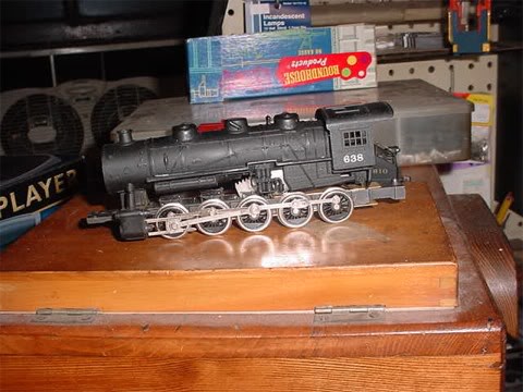

Well to answer the question on the TYCO 2-8-0 and even the 0-8-0, They sold the "set locomotives in sets, without valve gear.....The locomotives that had complete valve gear were the single locomotive shelf sales. Which is what partly classed them under their marketing at TYCO as "high end" which did give them more sales as the self locomotives and not the set locomotives had more detail.....
 Posted - July 10 2012 :  9:11:55 PM Link directly to this reply  Show Profile  Click to see EM-1's MSN Messenger address  Send EM-1 a Yahoo! Message  Add EM-1 to Buddylist

Now for a question, what type of gear box did you use to mouth the Barber trucks too? Needless to say thats an impressive set up, but my question is, is what kind of pulling power does it have?

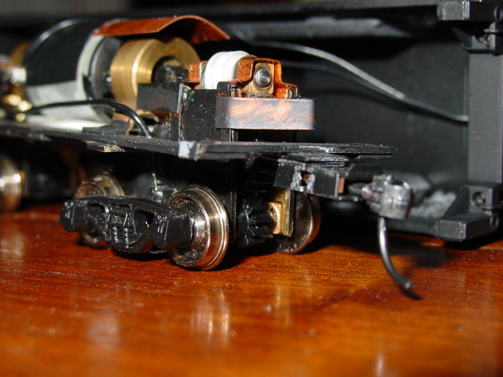

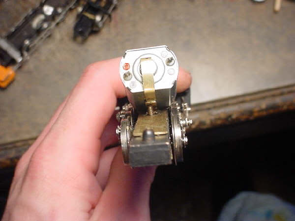

 Posted - July 10 2012 :  10:00:25 PM Link directly to this reply  Show Profile  Add Darth Santa Fe to Buddylist

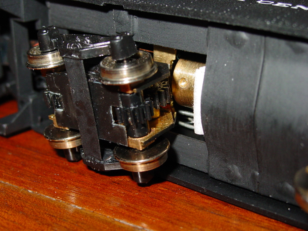

Except for the gears and wheels, the trucks are made completely from scratch using brass sheet and tubing. The sideframes are mounted by hanging them off the needlepoint axles, kind of like you'll find in some of the old Hobbytown, Lindsay, and brass diesels.
I haven't tested the pulling power, but I think it can haul at least 20 free rolling cars. I usually make it pull about a dozen 40' to 50' cars around the layout without any trouble.

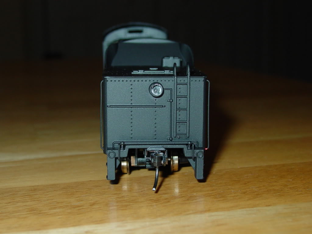

The repowering job you did on your 2-8-0 tender is outstanding. Could you expand and show pics of the trucks? I would love to see some detailed info on how you built those trucks, as I have a tender powered loco made in Brazil that I would like to repower. It's a Model Power 2-8-0 that had a terrible drive in it just about like that original Tyco drive.
My first HO loco purchase back in the 70's was a Tyco Royal Blue. That awful tender drive only lasted about 3 months so I put the engine on my shelf where it sat for many years. I used to look at it and admire it, thinking that some day I would find a way to get it going again. Then one day I discovered that IHC had used the very same boiler for their 2-8-0. That gave me the idea to place and IHC drive under the Royal Blue, thereby putting the power back under the engine, instead of the tender, where it belonged. I did just that and now it is one of my best running engines ever. I reworked the oringinal tender with IHC trucks and scratch built a new frame for it. Everytime I run it, it gives me fond memories of my first loco purchase.

I too would like to see an expanded picture of what the trucks under that tender looks like as its a VERY interesting and not to mention GREAT looking design!

 Posted - August 21 2012 :  11:18:20 PM Link directly to this reply  Show Profile  Add Darth Santa Fe to Buddylist
My account is setup to receive e-mails, so I don't know why it isn't working?

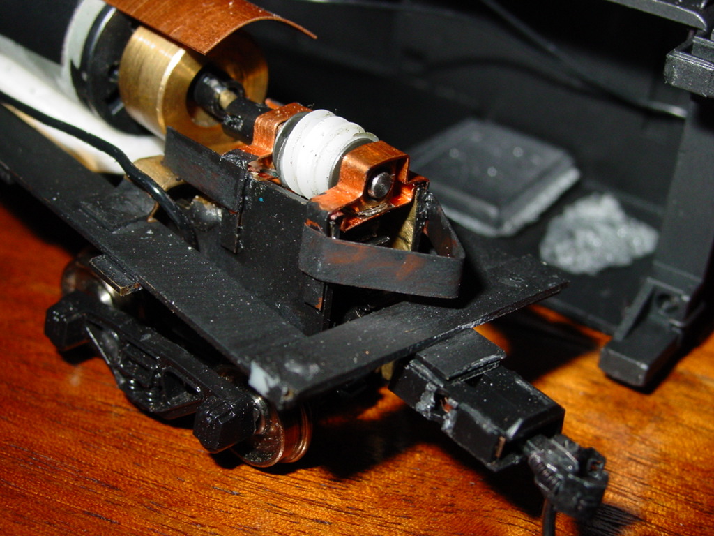

Anyway, here are the photos!

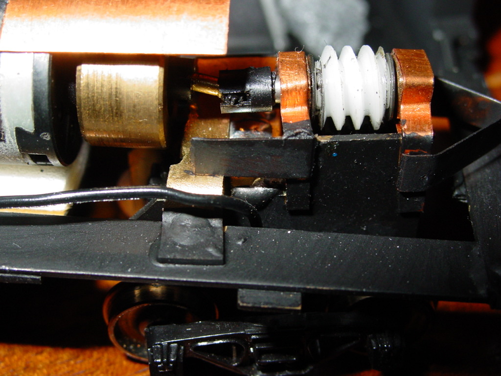

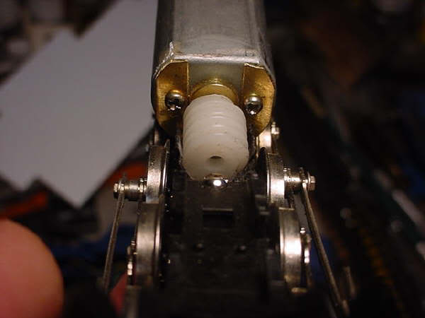

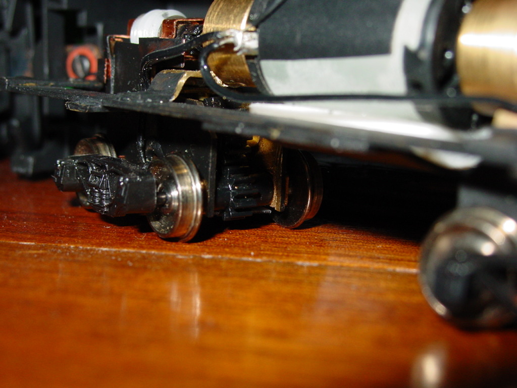

I added V-shaped bars to the end of each truck as a secondary retainer, because I was having problems with them falling out. Everything's worked perfect since!
The trucks are basically compressed Athearn F7 trucks. The worms drives a 23 tooth gear, which drives the first axle and a set of 16 tooth idlers to the second axle. It's kind of hard to get good photos, but I think you can see how I did it for the most part.

The sides of the trucks, interior, is that made of sheet brass? The sections that hold the internal gearing before the axle gears? It looks to be painted......

Many thanks for the photos and explanation of how you made those trunks and also for the video of your nice engine. Now comes the hard part, to see if I can duplicate something like that for my project.

Ray,
I have too! Have a look at this:
Yes, I'm always at it! I took 2 TYCO 0-8-0's, and made it into a 0-10-0, to be a B&O U-1....
Its designed like a Mantua 2-8-2 or 4-6-2 is done with the motor.....
I must say tho, this little thing runs really well in its current condition, I have along ways to go on him as well!
The motor and custom made mount:
This is the way the motor is tensioned to keep good gear mesh:
ENJOY!

 Posted - August 22 2012 :  7:46:27 PM Link directly to this reply  Show Profile  Add Ray Marinaccio to Buddylist
THAT'LL WORK.
I do like the idea of a better tender drive that can be used with smaller locomotives though.
Ray

Ray,
It was alittle bit of work to make that 0-8-0 into a 0-10-0, but then to add in the power drive on the drivers and not the tender made the job even more intense but, I guess if anyone would try such a task, it would have been me!

 Posted - September 01 2012 :  12:58:29 PM Link directly to this reply  Show Profile  Add Darth Santa Fe to Buddylist
EM-1, I considered putting the drive in the engine, but the tender repower seemed like the better option after close examination of the whole thing. Except for some sheet mylar and copper here and there, the frame and trucks are all brass. Nice 0-10-0 project, by the way!
rgcw5, I've actually had that same idea before! After thinking more about it though, the difference in drive wheel size between the engine and tender would make it difficult to match the gear ratios very well.
Richard, just take your time to do things right, and I'm sure you can make something great!
Ray Marinaccio, that's a great repower in your Chattanooga! It looks like yours came with a metal weight in the engine? Mine only had a huge plastic smoke unit filling the boiler, so I wouldn't have been able to give mine a repower like that. In fact, I left the boiler in mine empty all together (except for a couple parts to screw into), so its only actual weight is the metal frame.
Originally posted by Darth Santa Fe - September 01 2012 :  12:58:29 PM
Thanks Darth,
Of all the Tyco 0-8-0 and 2-8-0 locos I came across, only a couple had that metal smoke generator.
I probably would have went a different route if I didn't have the metal weight.
I did put a NWSL 36/1 gearbox in a 2-8-2 kitbash using the Tyco 0-8-0 chassis, it took a fair amount of filing on the frame though and cost a bit more.
anyway, looking at your truck designs is giving me some ideas for a set of new trucks for the MDC box cab/climax locomotives.
Ray
