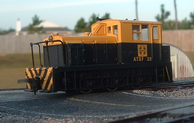

Geez Bob! I draw the line at swapping a realigning gears lol. Got a picture of the loco this chassis is pulling around?
 Posted - May 22 2011 :  12:06:28 AM Link directly to this reply  Show Profile  Add shaygetz to Buddylist
Originally posted by ChrisC - May 21 2011 :  11:45:55 PM
Gotta admit...bringin' these boogers back to life better than they were built has a certain appeal....
