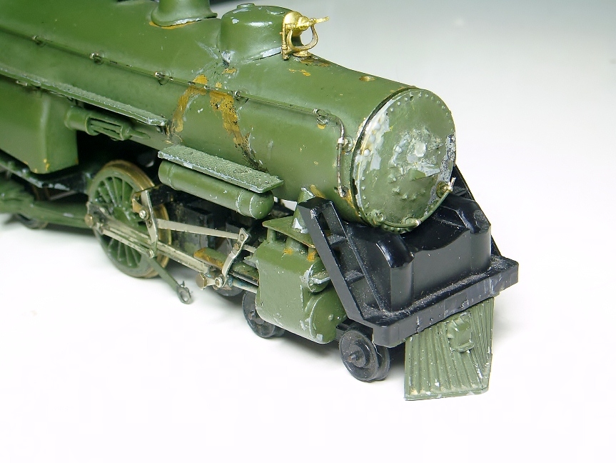

 Posted - April 27 2011 :  4:45:51 PM Link directly to this reply  Show Profile  Add toptrain to Buddylist
This is the new front pilot. Nothing is written in stone here. I am now on a hold till next week after the New Hope PA train show. What ever I can get there will be purchased from Bowser next week.
Edited by - toptrain on April 29 2011 11:42:01 AM

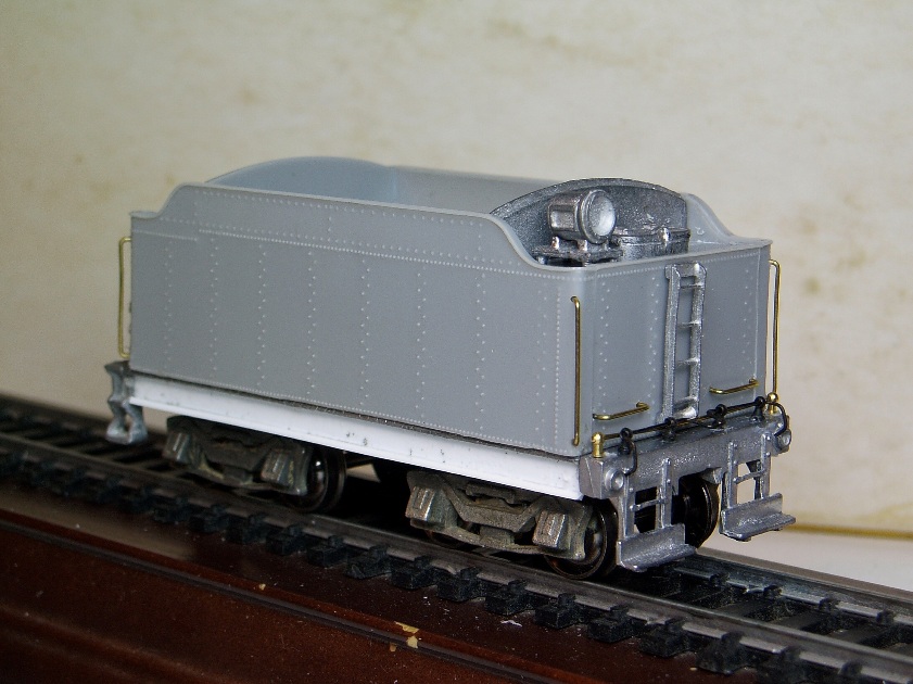

 Posted - July 28 2011 :  11:11:17 AM Link directly to this reply  Show Profile  Add toptrain to Buddylist
* Like with all thing, I do, I always change my mind. I will just work on the Reading Atlantic back date to a 4-4-4. Restoring with detail changes. Everything I do to this loco relies on what I can get, and what I can make for it. I hope to get it back to the original 4-4-4 as built. I did get a nice front pilot from Bowser. The Selley #466 is much closer to original. I have tried to strip paint from boiler and tender bodies. I'll have to get a soft brass drimel brush to remove the rest of the paint and also buff the metal surfaces. A break in the very hot weather has allowed me to work up in the attic. Here is a up dated photo.

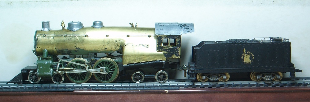

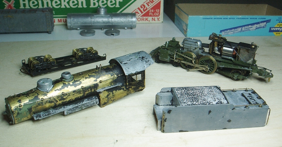

 Posted - September 14 2011 :  7:41:20 PM Link directly to this reply  Show Profile  Add toptrain to Buddylist
Here is where I am today. I must be working in slow motion. Drive has been broken down cleaned, frame cleaned and repainted black. Rear truck changed to a 4 wheeler. All walkways have been removed and placed in a parts bag. will not be used on this engine. I really dont like the cab. the window is wrong and there should be 2, not 1 on each side. More paint to remove still. I dont like the tender either.
AHHH here is a photo.
Frank
Edited by - toptrain on September 14 2011 7:42:47 PM
 Posted - September 14 2011 :  8:06:05 PM Link directly to this reply  Show Profile  Add toptrain to Buddylist
Things I somehow need to change.
Edited by - toptrain on January 31 2012 11:02:39 PM

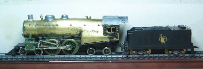

 Posted - September 15 2011 :  9:44:12 PM Link directly to this reply  Show Profile  Add toptrain to Buddylist

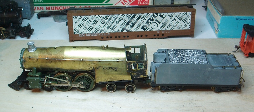

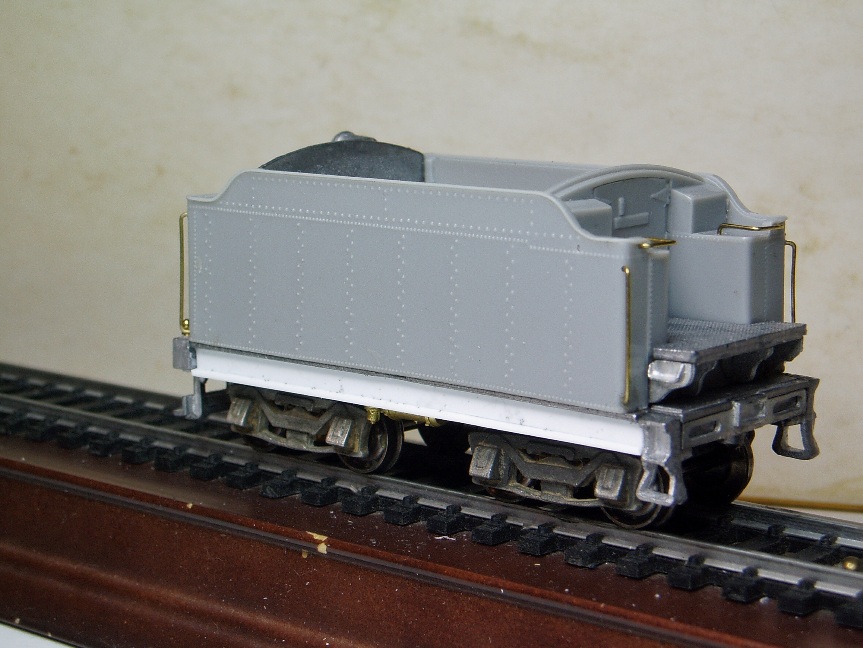

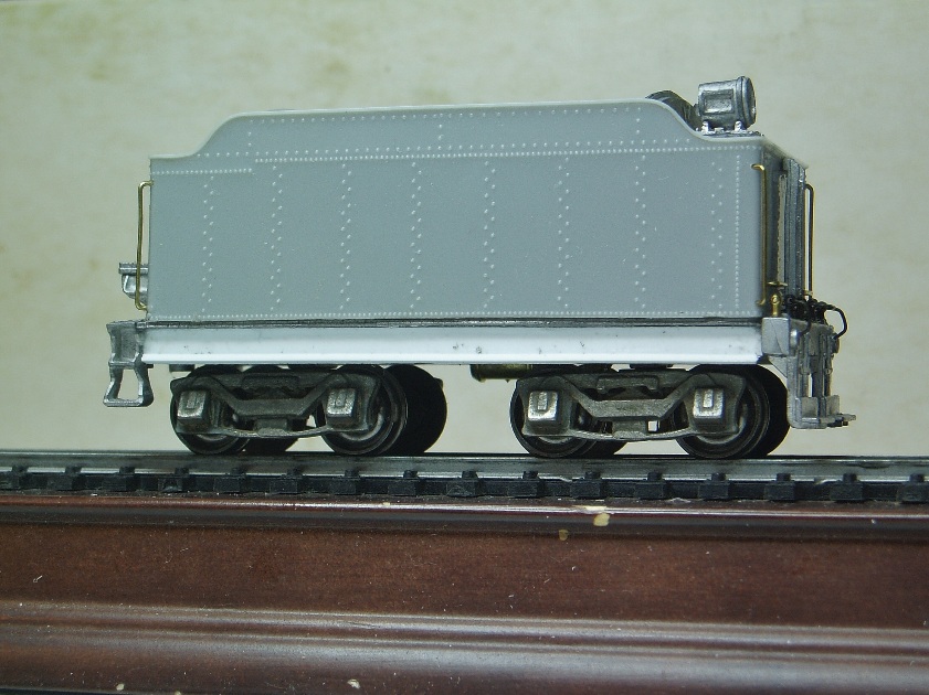

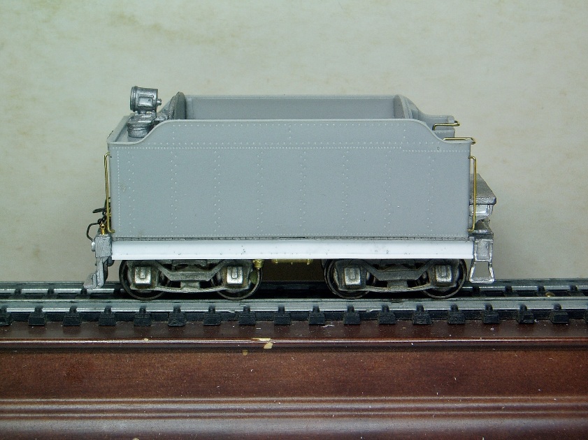

9-16-2011
Well I have a photo today of my progress. No Laughting out loud unless you really have to. It is OK. Let it out or you will hurt yourself.
The tender is from a CNJ 4-6-0 I kitbashed a few years ago. The 4 wheel spoked trucks are from Rivarossi Casey Jones.
Edited by - toptrain on October 01 2011 8:48:28 PM

 Posted - September 24 2011 :  09:50:00 AM Link directly to this reply  Show Profile  Add toptrain to Buddylist
* I finally have the boiler cleaned. At this time awaiting delivery of detail parts from Bowser. Once I receive them another order will be sent.
* I am now trying the make brackets to hold up boiler side walkways. I realize that once installed they must be a part of the boiler. If not they will join the boiler to the frame. A problem I can't have. If I make it removable it won't be solid. They will be part of the boiler. Everything soldered together.

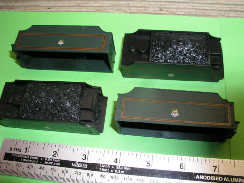

 Posted - September 24 2011 :  10:08:46 AM Link directly to this reply  Show Profile  Send catfordken a Yahoo! Message  Add catfordken to Buddylist
looking like you are really getting stuck into this frank,its looking a lot better,ken
just a thought are these closer to what you need
Edited by - catfordken on September 24 2011 10:14:36 AM
 Posted - September 24 2011 :  10:33:01 AM Link directly to this reply  Show Profile  Add toptrain to Buddylist
Kenny ; They have the right lines on top, but to short. The Mantua is also to short. I may have to use 2 tender bodies to make 1. I am giong to make a cab. Maybe I also have to make a tender also. There was a company reciently that made die cast tenders. My son used one on his CNJ 4-8-0 camelback. Got to talk to him.
* frank

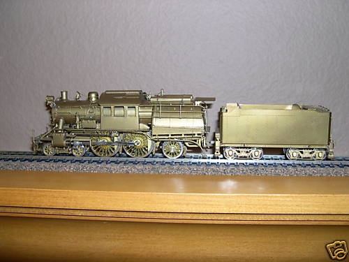

 Posted - September 24 2011 :  11:10:06 AM Link directly to this reply  Show Profile  Send catfordken a Yahoo! Message  Add catfordken to Buddylist
nice model frank,this is the brass version,prefer your boys ken

 Posted - September 24 2011 :  12:05:21 PM Link directly to this reply  Show Profile  Add toptrain to Buddylist
Kenny ; do you see how it is raised up underneath. The photo of the 4-4-4 shows that. I can do that to either the dia cast one, or maybe a Mantua one. As long as I can get the right look.

 Posted - September 24 2011 :  12:13:08 PM Link directly to this reply  Show Profile  Add toptrain to Buddylist
Kenny ; You can see from your photo, a entire frame extending past the tender body on both ends. it is not as wide as the tender body. It should not be too hard to do.

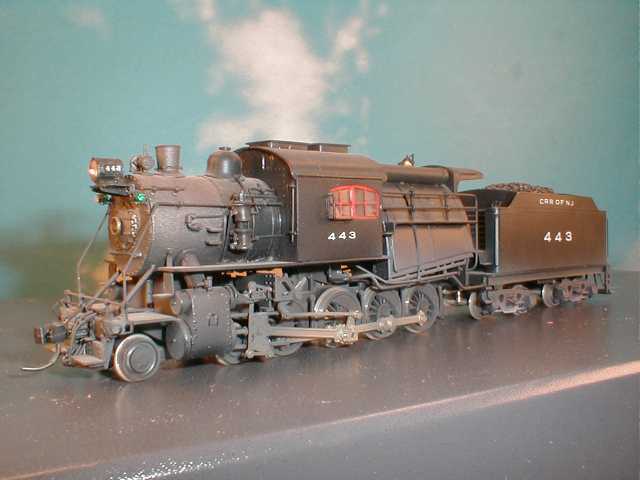

I love that Camelback. Was that one of your projects?
I've had trouble with Bowser orders before, too. I was surprised, but it would make me think twice before ordering from them again. I'll probably just try to get it through my LHS rather than deal with them directly.
 Posted - September 24 2011 :  10:52:04 PM Link directly to this reply  Show Profile  Add toptrain to Buddylist
Frank,
Originally posted by NickelPlate759 - September 24 2011 :  10:42:30 PM
Nelson : Once in 25 years aint bad. My son steve ( E-paw) built the camelback.

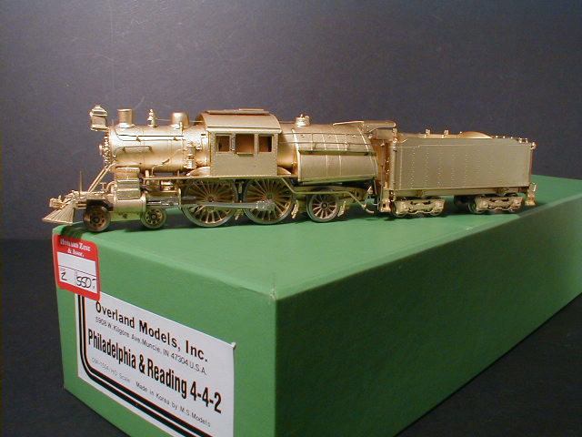

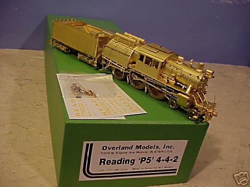

 Posted - September 27 2011 :  09:05:55 AM Link directly to this reply  Show Profile  Send catfordken a Yahoo! Message  Add catfordken to Buddylist
hi frank i have 2 p5`s listed in my database,one by cb and other by omi (overland) ken
p5 cb
p5 omi
p5 omi 2
Edited by - catfordken on September 27 2011 09:23:12 AM

 Posted - October 03 2011 :  6:32:12 PM Link directly to this reply  Show Profile  Add toptrain to Buddylist
Nelson ; it is not the cab on the 4-4-4, it is for the P7 , 4-4-2. I have to try to make a new one. My drawing is in S gague so conversion isn't that hard. I am still stumbling around.
My new cab will be 1 scale foot longer. Wooten firebox cabs for rear cab locos are usually notched. The original cab for the p7 is notched. The cab for the C1 isn't. Pluss like I said it is longer
Edited by - toptrain on October 06 2011 3:49:51 PM

post 9
As to a class name. This was the first 4-4-4 class of locomotive made in the USA and it was 1915. It was named the Reading Type. Four were made and ran for around 4 years. Not just because of some vibration when in a HIGH Speed turn but the glaring fact that the PRR had made a answerer to it, and was making as good time in each run as the Reading. The Reading needed a faster loco. So the Reading redesigned the four C class and made the P7 class of Atlantic. The only 4 that were ever made. Yes they put the Reading on top again.
* A little catching up.
* I have assenbled the tender, and installed a beam along the bottom sides of the tender as the Reading tenders have. This caused me to raise the tender floor. this added to the Reading look.
Edited by - toptrain on June 29 2016 8:36:47 PM

 Posted - October 19 2011 :  7:41:29 PM Link directly to this reply  Show Profile  Add CNVIATyco to Buddylist
Well Done! I never can asemble resin kits. The fragile parts get me.
 Posted - October 19 2011 :  7:43:23 PM Link directly to this reply  Show Profile  Add NickelPlate759 to Buddylist
Very nice looking tender, Frank. Not a cheap kit, though.

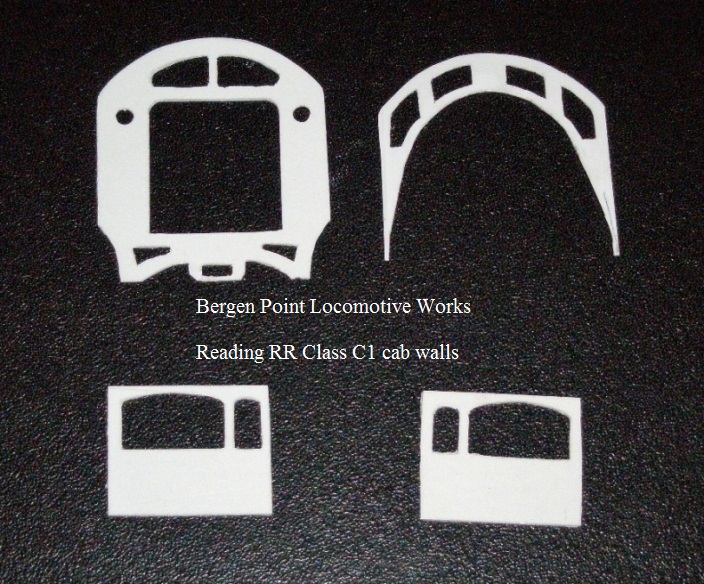

post 10
* Catchup two !
* * Having made a mistake on my first locomotive cab, and knowing the analogy " Your learn from your mistakes" I am wishing, and hoping this saying to be true. On my first cab try, I took the measurements placed on the loco design drawing and considered them to be true. I made a scale print of the locomotive drawing by scaling it down to where all measurements matched the measurements noted on the drawing. Now my base locomotive is a Mantua Reading P7sa. To date it. It would be 1917 to 1940s. I am rebuilding it back to its as built in 1914 and 1915. There were four built in these years.
* Things I didn't take note of (see), while making plains for this first cab. I do see it now ! The Reading as built photo of #110 shows a very rounded Wooten fire box. The model doesn't have this feature. it has a sort of a wooten fire box. Not the same as in the prototype photo. The front of the models fire box is the same, a well rounder wooten. The rear at the backhead is tapered in with some flat surfaces coming down from the arch at the boiler top to where the another bend brings the edges in. Well my little hammer and anvil has reshaped the fire box rear section to as close to a rounded wooten as in the photo. Next I used a contour gauge to reproduce to exact arc of the fire box. Transferring this shape to a piece of plastic sheet. I rescaled the drawing to match this arc. matching it to the drawing print as I scaled it up and down till I had a match. In other words I made a bigger cab.
* I went to work on the front 4 windows and reproduced them nicely in my new front cab wall. 1 wall down 3 walls to go.

post 12
* OK ! New cab parts. Fresh out of the builders shops. Still a little flashing to remove.
Edited by - toptrain on June 01 2020 10:07:49 AM

 Posted - October 20 2011 :  3:24:51 PM Link directly to this reply  Show Profile  Add CNVIATyco to Buddylist
Nice! Looks Good so far!
