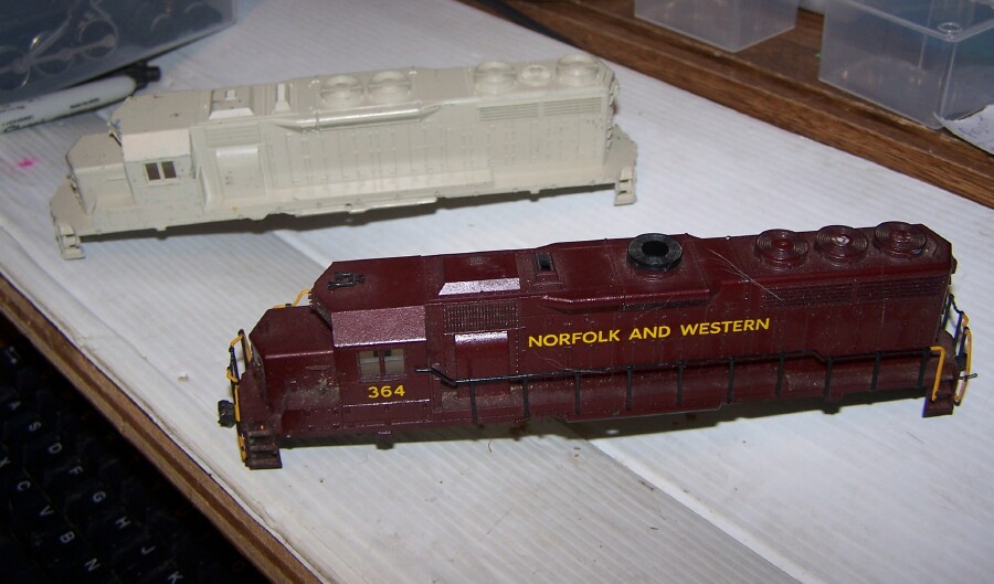

I'm trying to identify this unpainted shell, I had it marked tentatively as a GP-35. The Norfolk and Western is an Atlas, and I believe also a GP-35. What is unusual on the unpainted shell is that there are TWO fans in the middle area. I can't find any prototypical or 1:1 engine that matches this one with 5 fans on top instead of 4. Otherwise it's a dead ringer for a GP-35. The whole shell is molded, the center top part does not come off like on an Athearn. I've looked at GP-38 (-2), GP-40 (-2), and definitely not those. So I'm perplexed as to what exactly it is,and who made it. Has screw-mount coupler tower attachments instead of pockets.
Working on the N&W Atlas, it's missing a truck bottom plate that holds on the axles, and also the axles. Found nothing in my stash of junk-box purchases to fit. I may have the axles somewhere else,but will probably have to locate an Atlas replacement bottom plate.
EDIT 2/22 , 7:32 AM - found a truck! Woo-hoo! Has the axles and bottom plate, broken mounting tabs for the chassis , but I will just switch the plate, sides, and axles to the existing truck, so I should be able to get this guy rolling again. The color of the side frames may be off a bit, but otherwise should be compatible. Haven't tried it yet, I'll do that when I get home from work. FINISH EDIT
This may be a fantasy paint scheme, I did some N&W roster research, and didn't find any GP-35's on the one site I checked. Oh well.

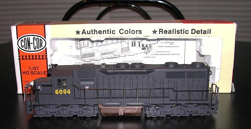

Hi Jerry. The unpainted shell based on your Picture and the fans. It would seem to be a Atlas / Roco Shell of a SD35.. Later Con-cor also used the shell...
Here is a picture of a Concor SD35 showing the fans... Carl

Sure looks like it to me! Thanks, Carl! I was looking for the wrong model, then, it is an SD instead of a GP.

Yep, dual fans in the Dynamic Brake area are a reliable give-away for an EMD SD-series.
Incidentally, your N&W unit might be a reworked SD-40, since the 3 radiator fans are all the same size. Obviously the single DB fan is a unique feature. Interesting loco either way.
 Posted - February 22 2011 :  1:29:30 PM Link directly to this reply  Show Profile  Send AMC_Gremlin_GT an AOL message  Send AMC_Gremlin_GT a Yahoo! Message  Add AMC_Gremlin_GT to Buddylist
Originally posted by spiderj76 - February 22 2011 :  10:41:40 AM
the DB fan on top of the N&W unit actually looks like PO mounted a black fan on top of an existing one ( double-stacked ). I'll have to examine it closer , you may be right. I'm still learning models and variations of them, so I'll check it out more to see what's up with my NW unit. Thanks for commenting on that observation.

Actually, I just had a headsmack moment: that N&W is actually a GP-40. All that talk about dual fans and I completely missed the obvious, ha!
The radiator triplet fans make it a -40 (-38 would have two; -30 and -35 have two large with a smaller between).
Looking carefully at the DB "blister", it's not an SD because it's not long enough to house both fans properly. Also, the SD-40 series had those famous, oversized porch/balcony pilots.
On a 2nd-gen EMD without dynamic brakes, you won't have the blister or mid-mount fans in the first place, so you have to rely on axle count and radiator fans as your first clues.
So it looks like someone took a standard Atlas GP-40 and stacked another fan on the DB unit.
The undec unit IS an SD-35, as Carl pointed out.
