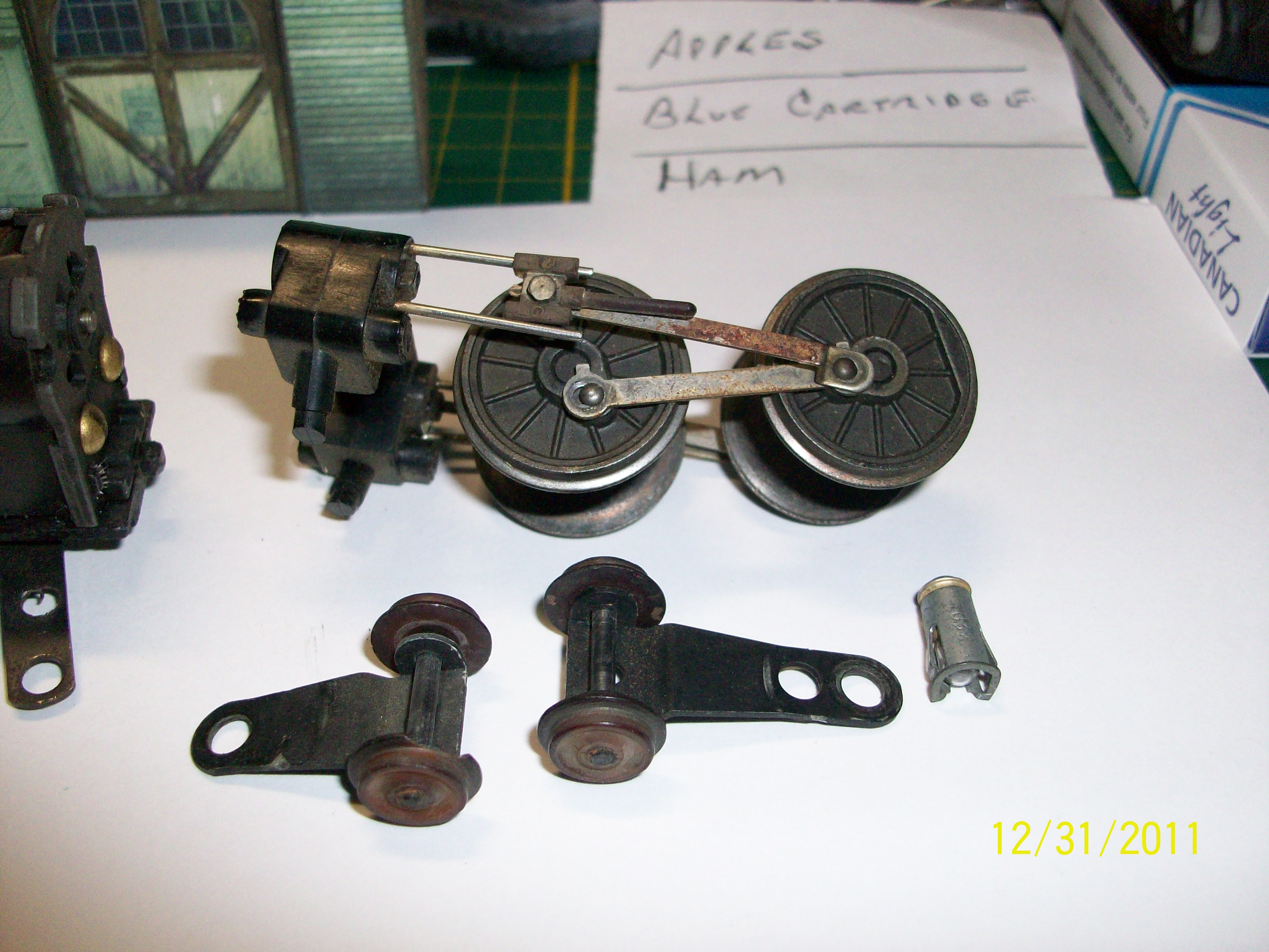

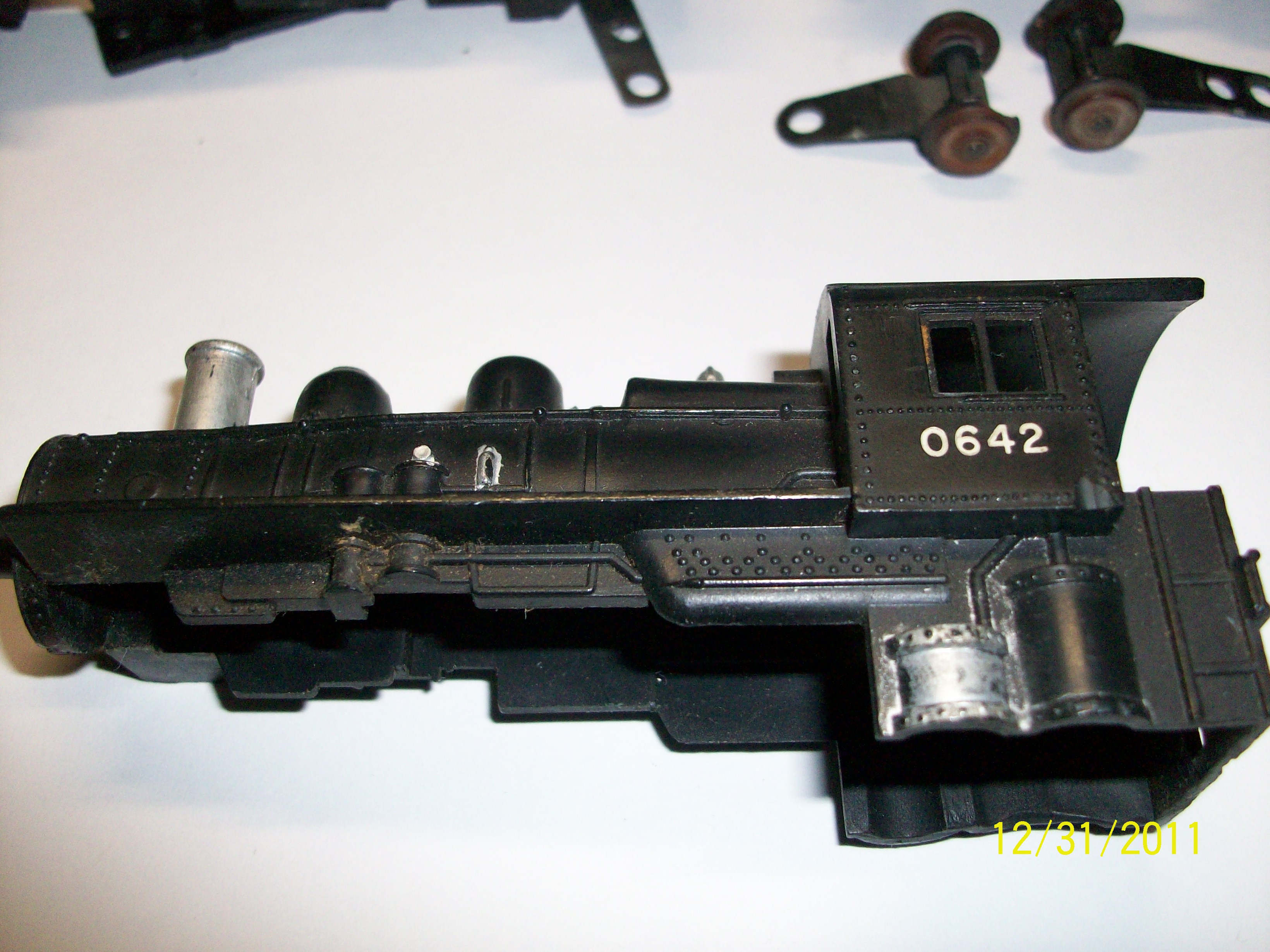

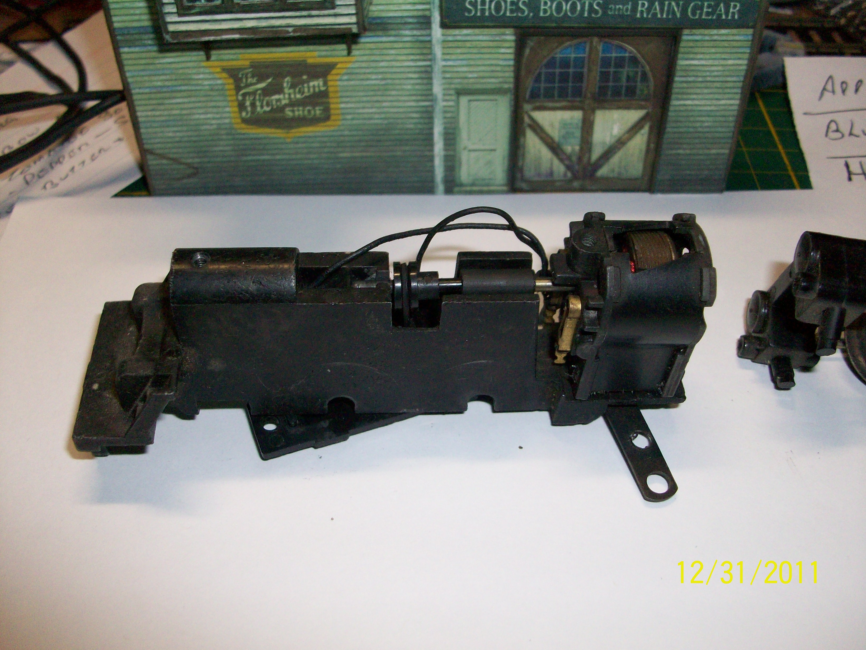

I got this is a deal and cannot find any markings on it. It is belt driven with strange little head light. I don't have a tender but if I can find out what make it is I should be able to find a tender in my junk box.
Any help would be great.

It's made by Lionel,from the early 60's.

Carl's right. The cab number is the Lionel number, if you want to look up info on it.

Now I need to find a tender. The engine works but slow I will need to give it a good cleaning and it should run great. This is my first lionel !!!
Are the belts easy to get??

It's just an O-ring, Ken. If you still have the old one, you can go to Home Depot and pick out the right size. I did the same for an old Revell switcher.

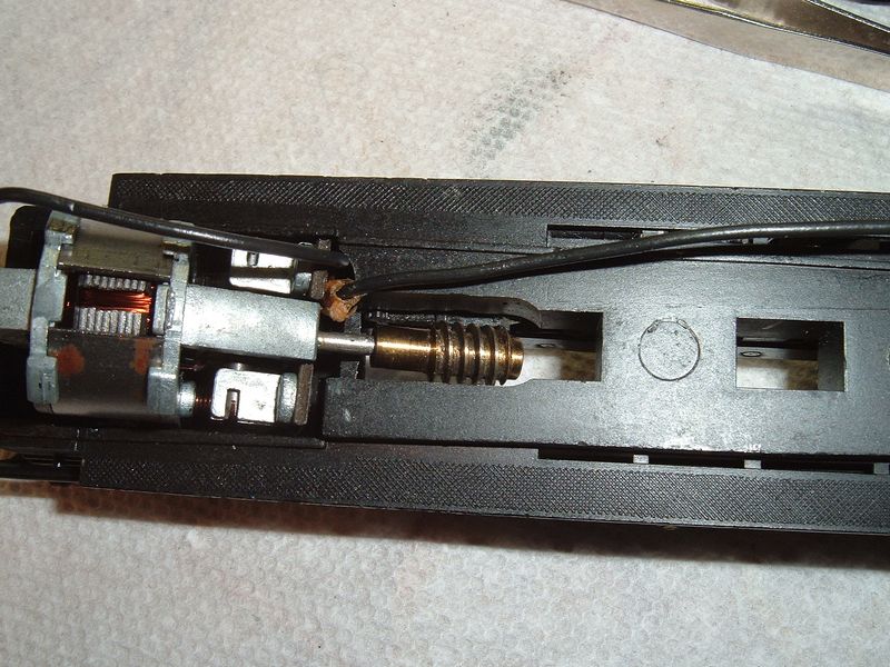

Nope, that's the Lionel motor. They were in everything from their Husky to their Pacifics. The Athearn motor was the unblackened weak open frame Hi-F motor.
Irv didn't have enough patience with steam. If he had waited a few years until they came out with their much stronger Jet motors (with the oval ring magnet), they would have performed much better. The Hi-F motors were weak in the early geared diesels, too.

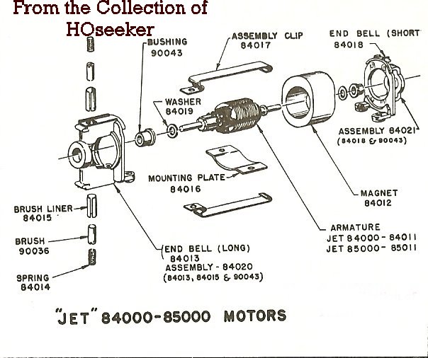

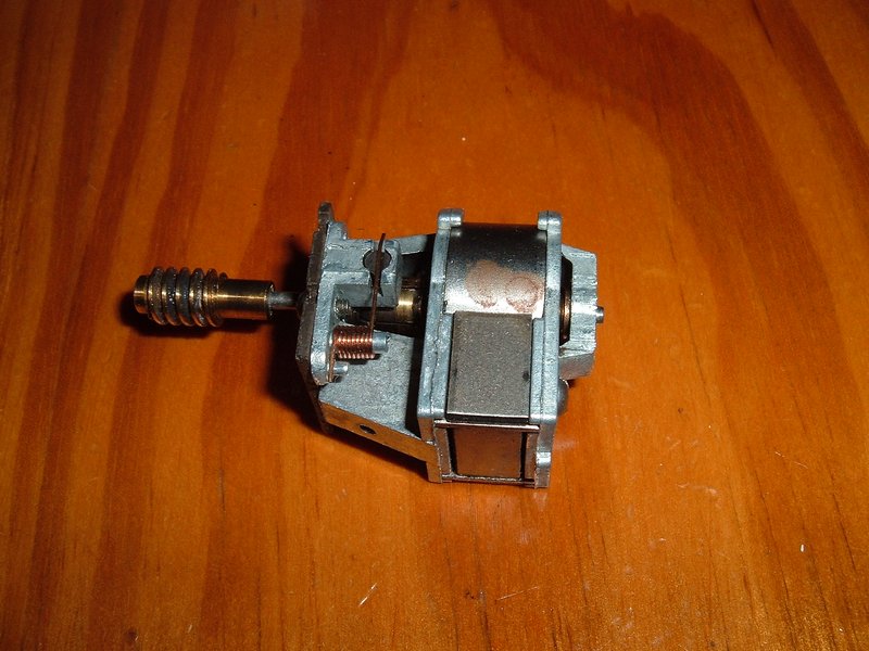

My pics are to show the Hi-F motor that was used in their 60's steam. Here's a diagram of the Jet motor. Must be a drawing from the 60's, because it uses the metal mounting plate instead of the rubber mounts.

Nelson, I confused the 0-6-0 with the 0-4-2T......
I have both a Lionel 0-6-0, and then the 0-4-2T by Athearn...... The frames look REALLY similar tho....Amazing how much of that was done, but I don't recal seeing the "Hi-Fi" motor having an angle mount on it.......
Good thought tho, I wonder if the jet motor armature would fit the old Hi Fi? Interesting as if I recall the armature was the issue on the Hi-Fi motors! I might have to give that a try!

John, they re-tooled the front end bell for their steamers to put the motor on the diagonal.
The Jet armature wouldn't fit, in fact the Hi-F armature is very short. It's almost a pancake motor. The only way to improve them is with a neodymium magnet transplant, which I have yet to do to one of these.
