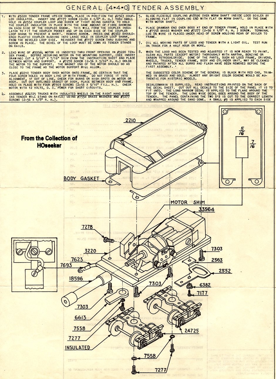

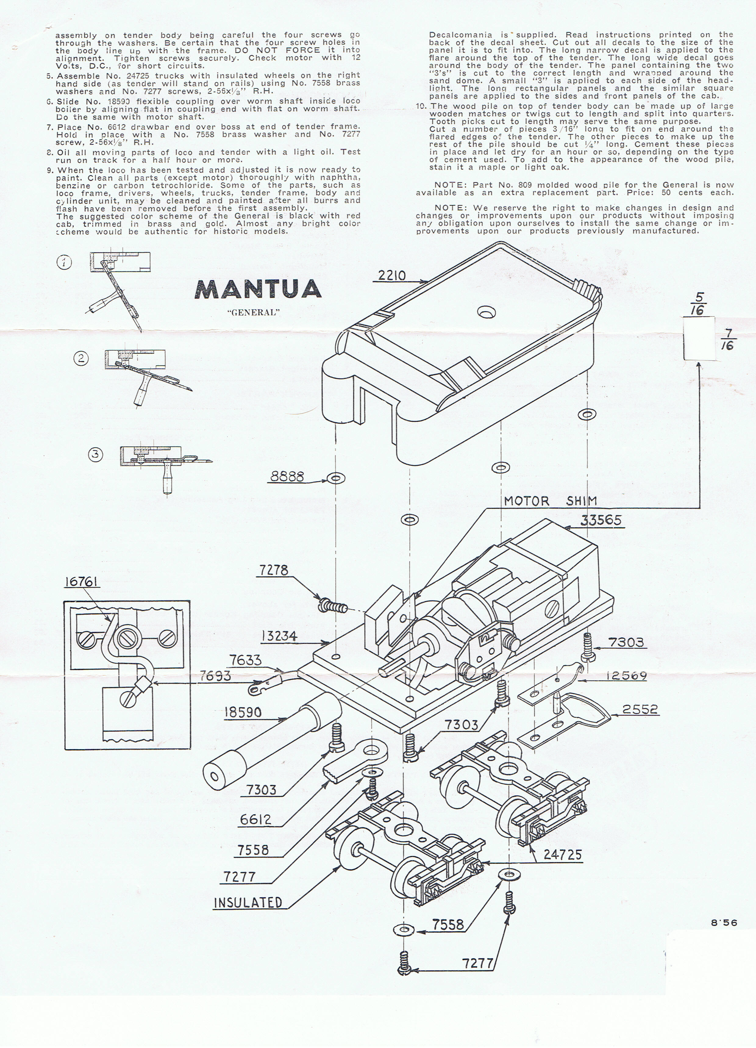

hi ken there were to version of the general tender,one with a gasket and one with 4 spacers/washers in line with the screw holes i think it will be easier to get spacers/washers ken
spacers/washers
gasket

Hi Ken,
Thanks for the info. I have that same info but if I put washers I will still have a thin gap between the frame ans the wood box. I thought if I had a gasket that would fill the space. I can grind off the logs on the bottom of the wood box and it will fit the way it should. Thanks again.

 Posted - February 13 2011 :  3:20:11 PM Link directly to this reply  Show Profile  Send catfordken a Yahoo! Message  Add catfordken to Buddylist
the gap is a good air vent when locos flat outken
