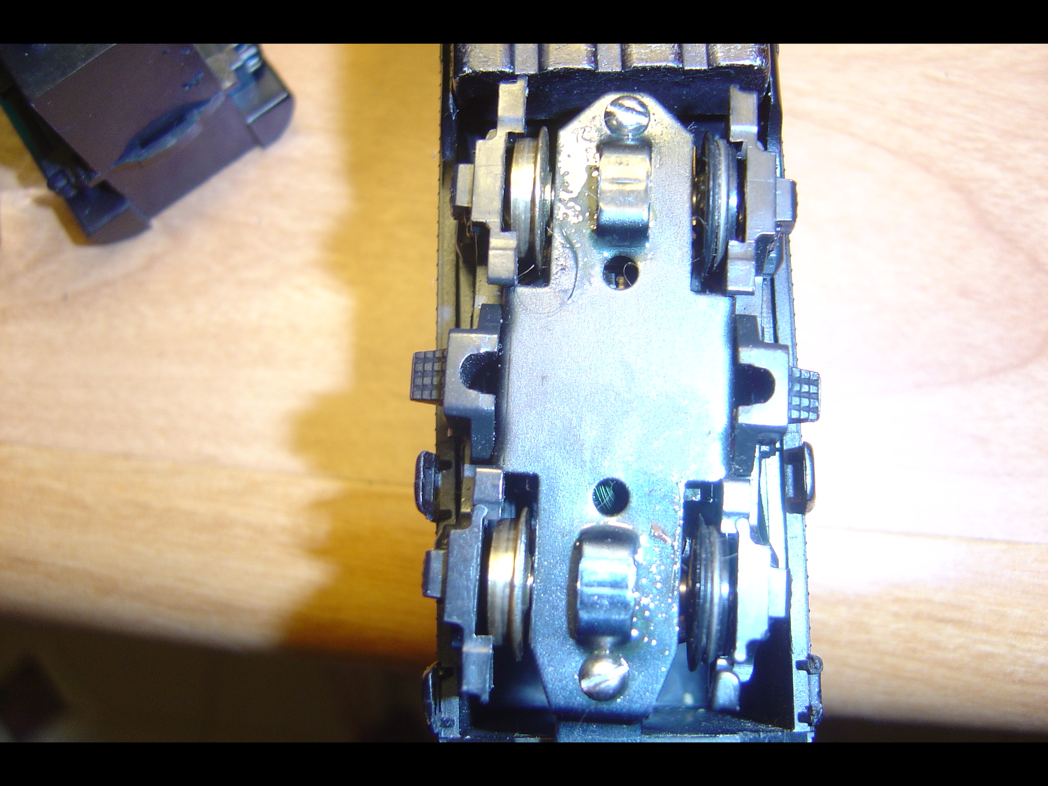

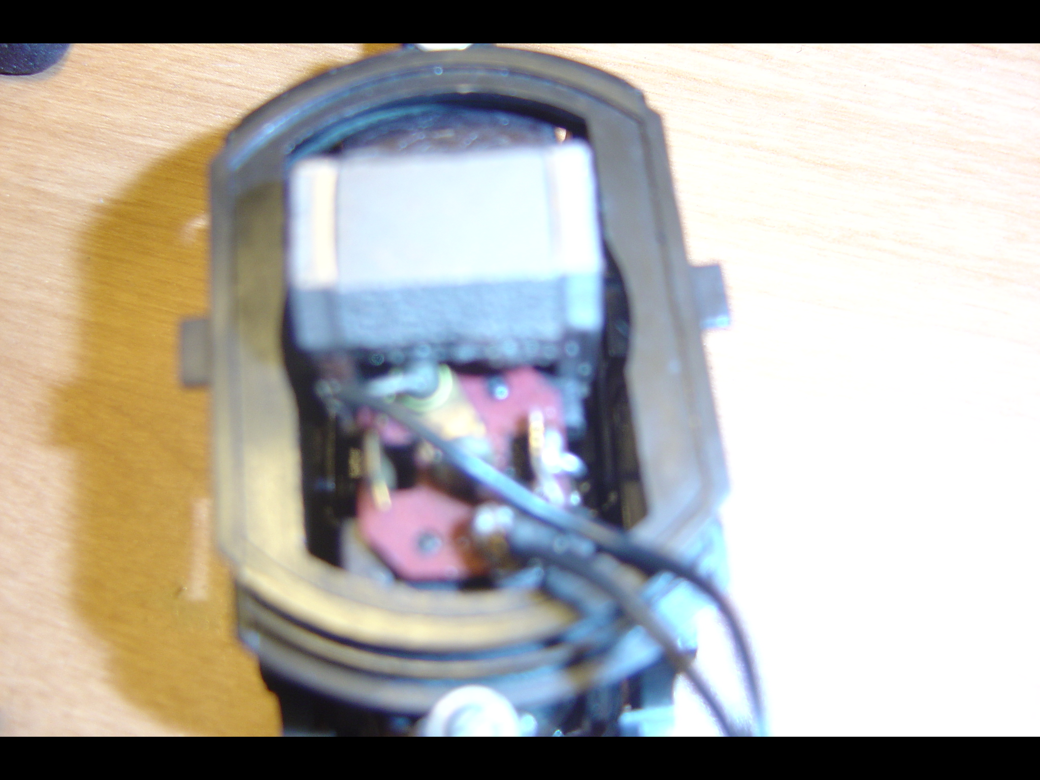

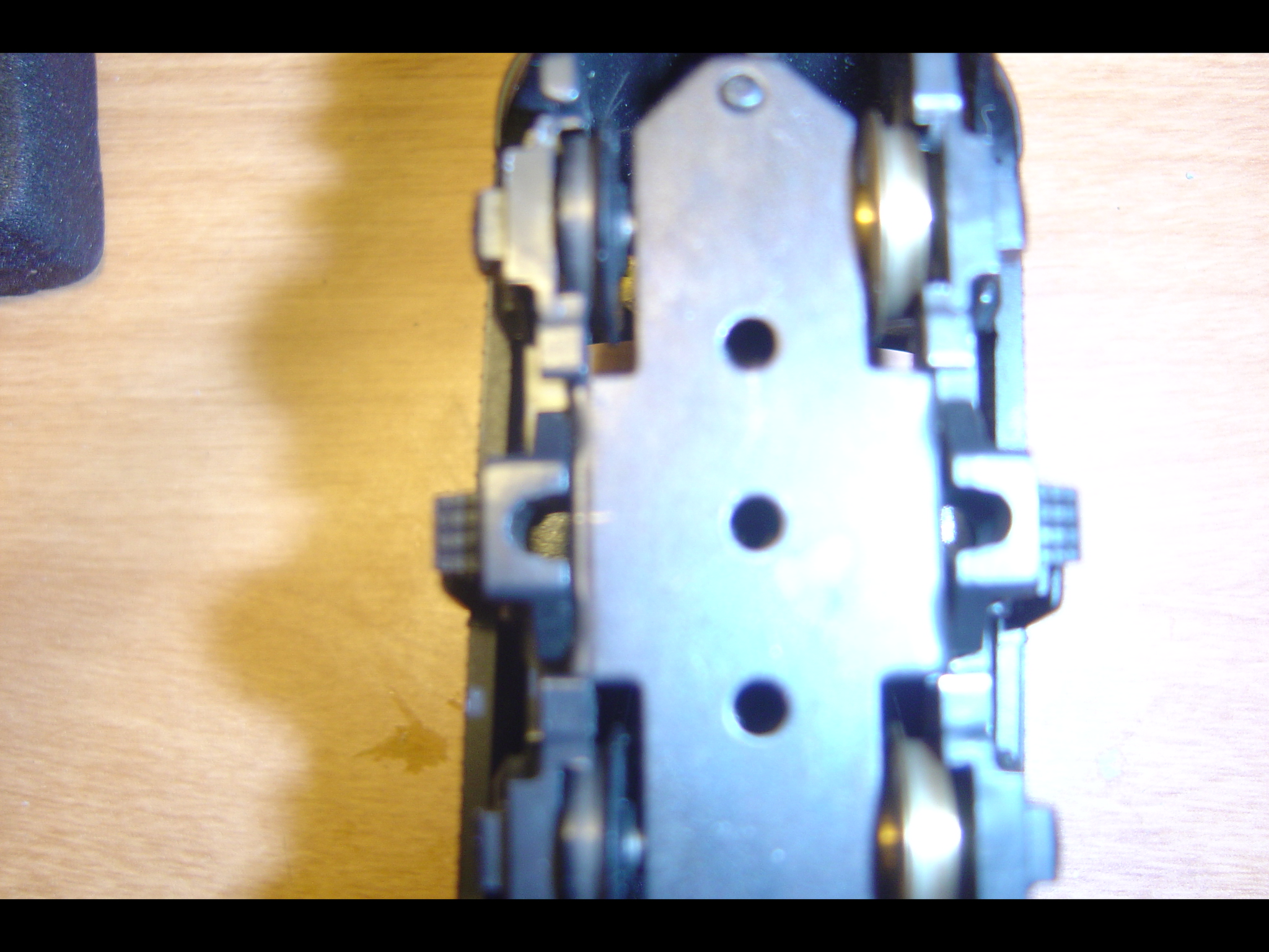

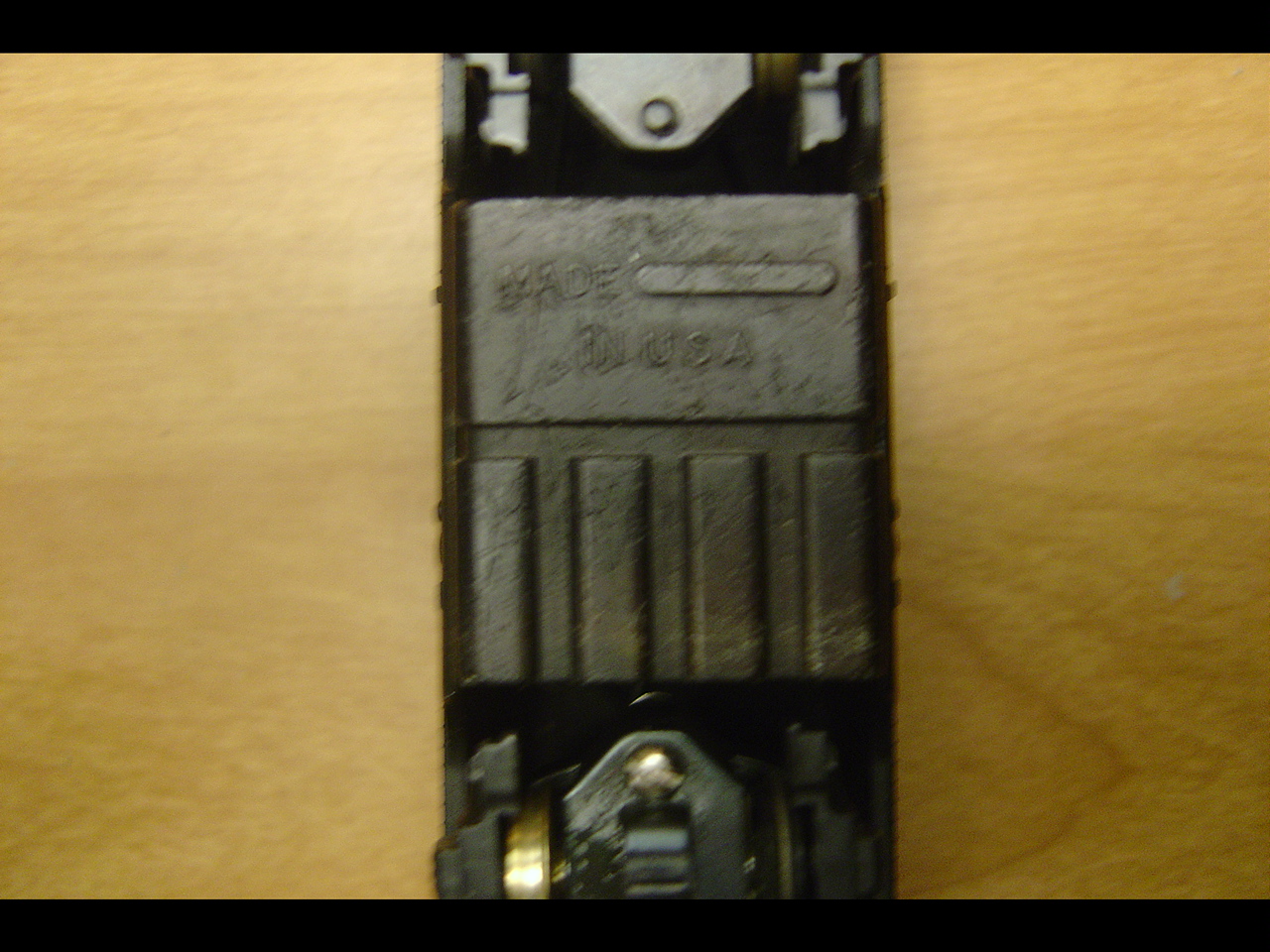

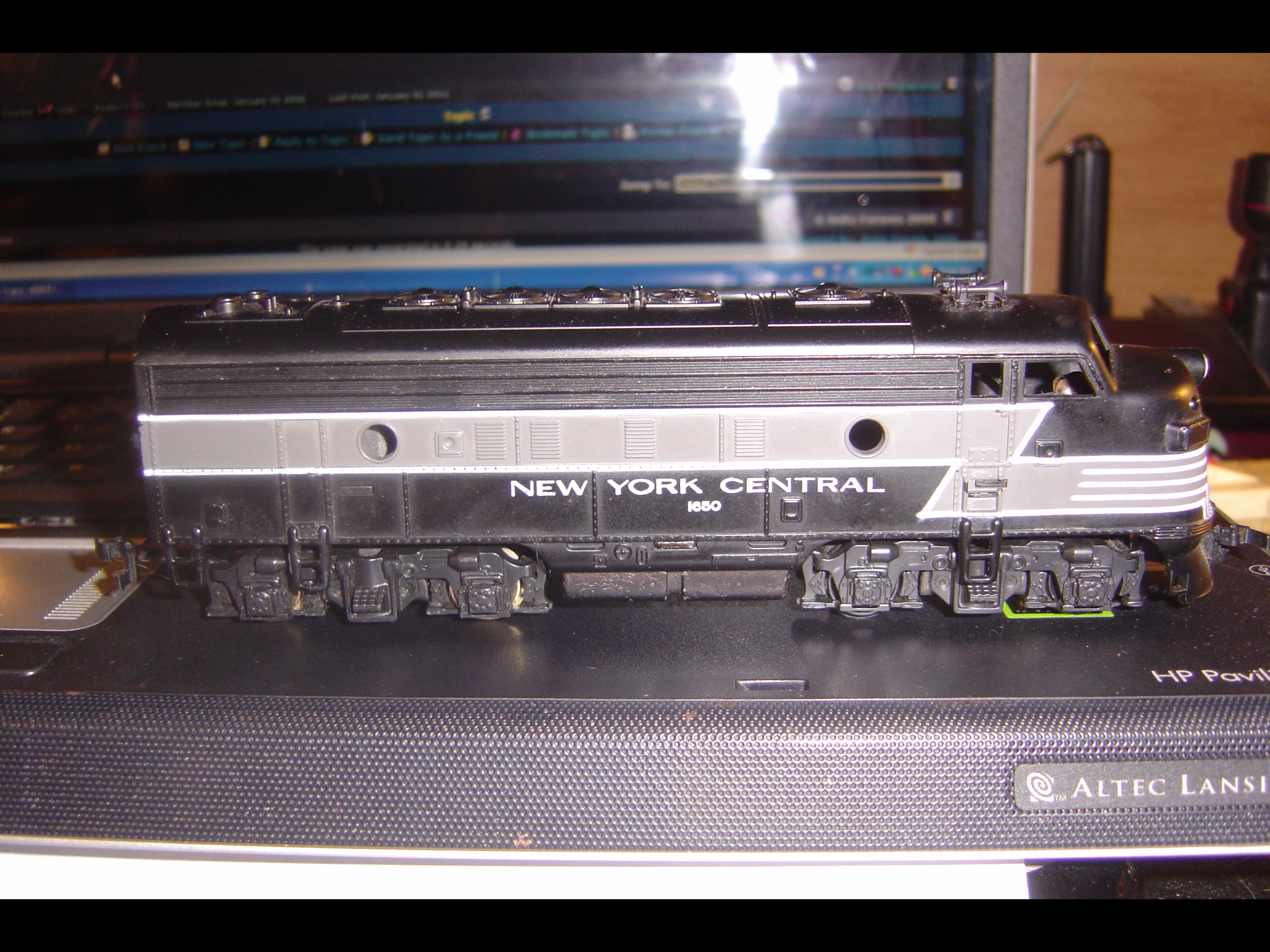

The engine
The Front Truck made of metal
The Rear Truck made of metal
The Motor
The weight marked Made in USA

Your train is a Mantua /Tyco. It has the MU motor. By the USA made stamp on bottom -It was made in NJ - approximate time frame for this would be mid -late 70's production is my guess
see spiderj76 for a better detailed description

That's the former "Tyco" F-unit, as remade and sold by the "New Mantua" sometime after 1978, in the USA. It was one of the assets the Tyler family bought back from Tyco, and the blankout on the weight covers the "by Tyco" text. New York Central was a new roadname in this release, never before available. The non-flush stirrups certify this is a reworked version of the classic Tyco shell. It also features the revised, serviceable version of the MU-2 motor: fastened together with screws instead of rivets, you'll be thankful if you run it much.
Tyco continued offering an F-unit of their own at the same time NewMantua's was available, but it was newly created and unique tooling. Once Tyco got that, Mantua used this version exclusively. Although for a brief period immediately before/during/after the sale, Tyco did buy some of the New Mantua F-units and sell them as "Deluxe Tycos". On the flipside, a lot of Mantua's rolling stock never did cover up the Tyco name embossing, unlike your loco above.
