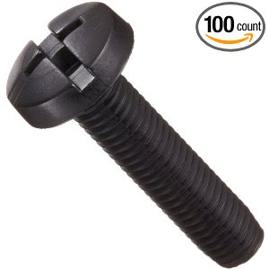

Well, I just placed an order for 2-56 nylon screws thru Amazon, looking at the motor there is only one spot that needs insulating from the chassis, so I really don't think this is going to be a hard conversion to do, actually. But it WILL require 2-56 nylon screw for the top motor brush plate. I really don't see what all the fuss is about with this conversion, it looks to be easy with the insulated screw, which is really the only sticking point. You won't find 2-56 nylon screws anywhere but a specialty parts house most likely. But with the Internet, they're easily found and purchased. I'll keep the Forum up to date on my progress.
And I also intend to solder in series a 1/2 amp fuse to protect the Decoder from over-amperage damage. I'd rather lose a fuse than the decoder. So, looks like next week before I get the screws in, then a few weeks before I can run down to my club layout to try it out. But this should be a fun experiment to try and see if a Tyco can handle DCC duties.

I've been working on the same thing. I used the plastic screws that come with Kadee #5 couplers, they're 2-56 and easy to trim to the correct depth for the PT block. I have a PT wired to a Digitrax DZ123 decoder. It's just a bench test stage now, but it works. The plastic screw insolates the motor. Right now it runs well, my next step will be to drop it into a shell and wire up the lights. Let me know how you make out...........Tom
Oh, I did not use an inline fuse. Seems OK but I like your idea of the fuse.

I've been working on the same thing. I used the plastic screws that come with Kadee #5 couplers, they're 2-56 and easy to trim to the correct depth for the PT block...... Let me know how you make out...........Tom
Originally posted by eaglerock109 - January 07 2011 :  4:52:28 PM
Dang, you mean I coulda gone thru my Coupler packets and got "free" 2-56 screws? I never paid much attention to that. I'll have to look thru my collection now, to see if I still have Kadee #5 packet. I don't think I do. I did buy one of those bulk packs with #5's, but that doesn't have screws in it, I've got it in front of me. Oh well. Either way, I'll get mine rolling along soon.

The first step is to cut the plastic 2-56 screw to the correct length and replace the metal screw on the brush cover plate to isolate the power ging to the brushes. This is the screw closest to the wheels of the locomotive.
