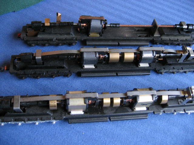

The top engine is a single motor DD40.
The middle pic is a earlier DD40 with the larger flywheels.
The pic is a DD40 with the newer motors and smaller flywheels.
These are all Athearn DD40's.

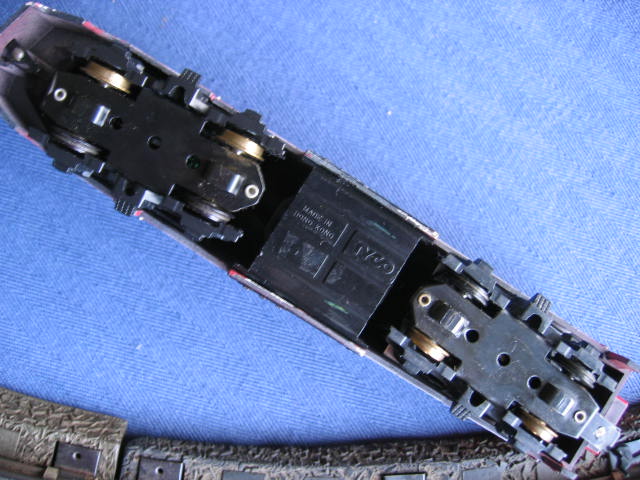

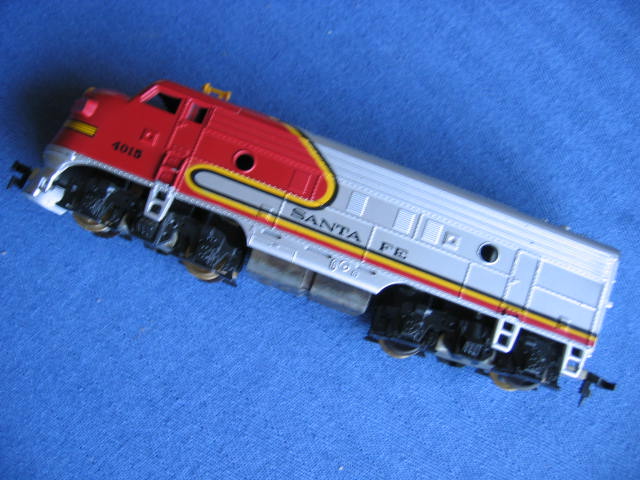

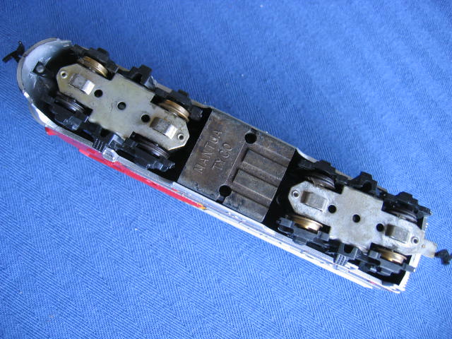

Here are two pics of my original Tyco SF F9 which has a double motor. Notice that the MU trucks are metal and not blue. This indicates that it is circa the early 60's.
Edited by - AF Kid on December 14 2010 10:48:15 PM

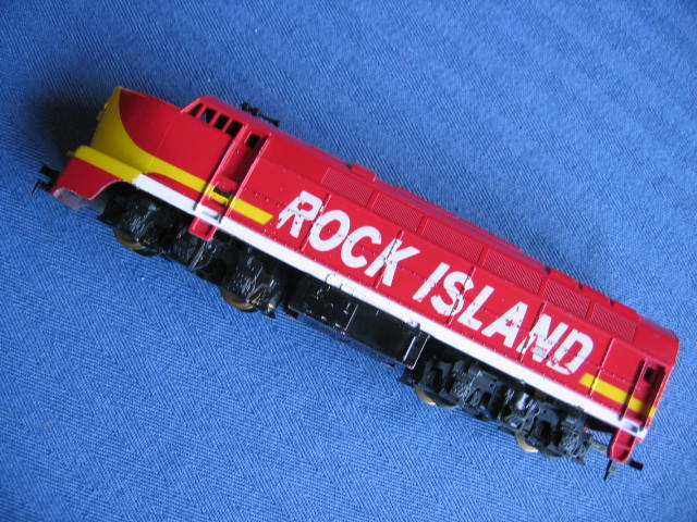

This is sad..... My layout is a 4 foot long test track, as I don't have room for a layout.
The pics below are of a Tyco Rock Island Shark, that I converted to a double motor. The front motor frame has to be contoured to fit the inside of the shell.

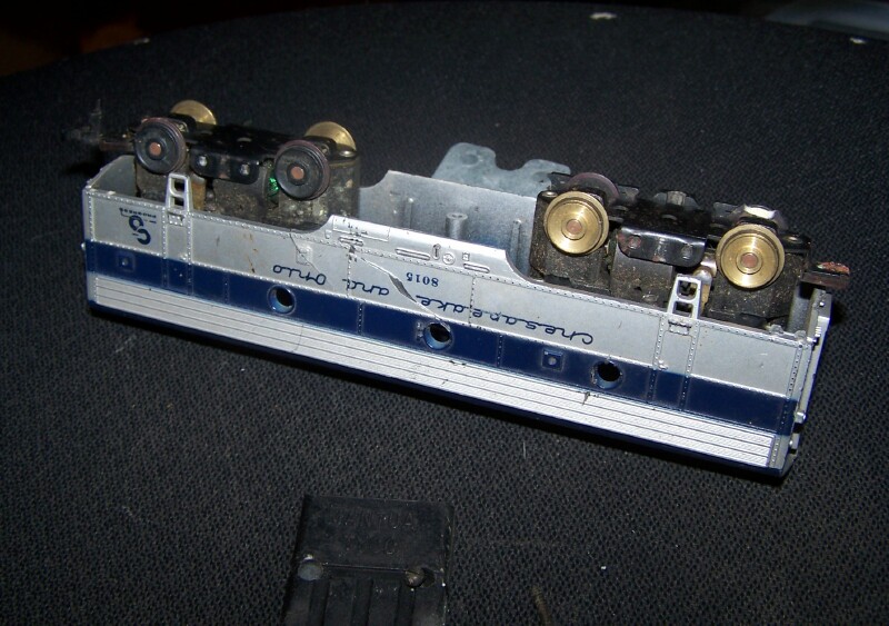

I just bid and won on a metal Mantua C&O B unit, and it appears to have dual motors, judging by the bulges on the bottom of the trucks. I missed the A unit, though. Oh well. It only had bulges for the gears on one truck. should be interesting to see what I get in the mail.
 Posted - December 25 2010 :  5:45:21 PM Link directly to this reply  Show Profile  Send AMC_Gremlin_GT an AOL message  Send AMC_Gremlin_GT a Yahoo! Message  Add AMC_Gremlin_GT to Buddylist
Here's my B unit acquisition. The shell has taken a beating, but it does have two motors. I haven't tried it yet.
Due to the shape of the shell, I may transplant it to another Mantua shell, when I find one with the screw-down holders. the end of this B unit is broken out, and would be a challenge to fix, much as I like the C&O livery. But at least I found one of these rare and reclusive units, from someone on Ebay that had no idea what it was, so I got it for around $10.
