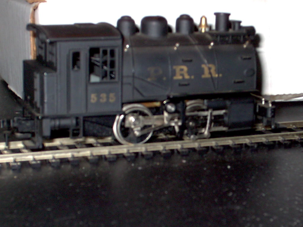

I have a nice Mehano 0-4-0T..put it on the test track the other day
and I thought it would fly off into the floor...VERY FAST
Is there any way to gear this down or re-motor...anything to slow it down
Thanx..

hi
Dont know if that will work on mine...
Mine has a can motor in the cab...worm gear on the armature
facing the drivers....I like your idea though

 Posted - November 28 2010 :  4:34:24 PM Link directly to this reply  Show Profile  Add caboose 1 to Buddylist
here's the loco.....IHC/Mehano

Originally posted by caboose 1 - November 28 2010 :  4:50:51 PM
Not enough to make a difference. The problem is with the gearing, not the voltage. You don't really want to drop the voltage, as then the engine would probably be very balky since it's probably a 3-pole motor, and would be a headache to get it started with lower voltage. Sometimes it's the worm gear, it's got what I think is called a double helix thread, it's very coarse, so it makes the engine run fast. If you swap it for a single-thread worm, it will cut the speed in half. The double helix actually has two separate threads, whereas the other is a single thread cut, and less angle, hence less speed. Check your worm gear, and see if you can follow one thread around, it skips a thread around a 360 circle. if so, that's your problem with the speed. But dropping voltage is NOT the answer.

AMC has the right idea. You may be asking yourself, "Where can I get a different worm?"
Try NWSL, (Northwest Short Line). Measure your worm and shaft and see if you can find a match on the NWSL web site.

 Posted - December 01 2010 :  02:08:46 AM Link directly to this reply  Show Profile  Add NickelPlate759 to Buddylist
Ted, what's the diameter of the worm? I have some single lead brass Atlas/Kato worms that are great replacements for Mehano twin lead worms, but the diameter has to be close to the original to keep the proper gear mesh.
I'm surprised that's a speed demon, because most Mehano steam is geared lower than their old Rivarossi counterparts.
