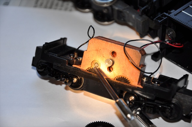

Here are pics of the motor and gear

If it broke at the shaft, that usually means a broken shaft, not the gear, and the housing is then toast. Does the gear come off easily? It should almost fall off if the shaft is broken. I can't imagine the gear splitting. You'll have to give a better description of the issue before we can determine the fix. The tender drive engines are a bit different than the regular ones, from what I hear. I have parts for the regular engines, but I"m not sure I do for the tender drive versions. Once we see a picture of it, we can probably figure out what to do.
There are no new parts for Tyco trains, only NOS or used ones these days. They're considered not worth fixing by the general model train hobby. I just bought some used engines and parts from a fellow train club member, who was divesting himself of his "toy" train junkbox stuff. So I have some parts. Once I can see what you need, I may can help. Try to get a picture or 2 posted so we can figure out what you need.
 Posted - November 27 2010 :  1:30:31 PM Link directly to this reply  Show Profile  Add shaygetz to Buddylist
I have one of those blocks you're welcome to...just PM me a mailing address and I'll have it off to you. Looks like you'll be able to salvage that bull gear by carefully pushing the broken pin out.

Hey guys thanks for all the help! Based on your explanations, I am sure the shaft is broke as the gear just falls off the motor.
