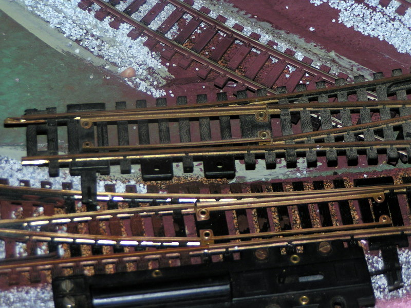

had a couple of switches from years ago like 25 yrs.
used them in my current construction. They were so badly tarnished it created a dead section.
Didn't feel like removing and replacing with new.
Sprayed them with C L R followed by brushing with a tooth brush, followed by rinsing with water. Shop vac everything up..
Tarnish gone and electric contact made. Note before and after switches
I used CLR as it contains a mild acid but vinagar, citric, oxalic would work as well

Looks like quite a difference! I wonder if CLR would have the same affect on steel track Some of the steel track I bought for my turbo trains is pretty badly rusted. This looks a lot easier than sanding and polishing all the rails

That's my hope. I'm not sure how much track will be left after the rust is gone, but hey...it's worst a shot right?
