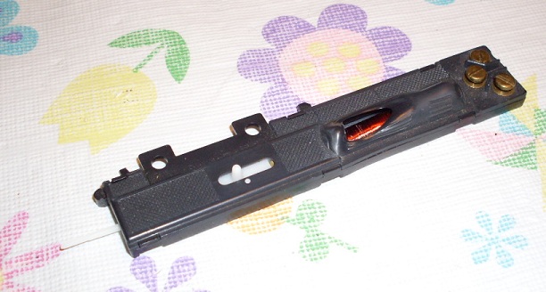

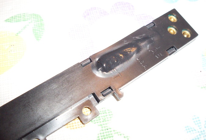

Two nights ago I was running some trains and noticed a burned plastic/electrical smell. I thought somebody was burning trash or something, thought nothing of it, and it went away. I forgot about it until last night, when I went to operate a switch and nothing happened. Inspection of the Atlas switch machine revealed this:
It's completely melted a hole in the top, and it's sagging through the bottom. I'm sure I hadn't even operated that switch the night before, because it's on a siding where I park my passenger train. After I took the switch machine off and made sure the wires were secured and separated, I pushed the switch lever a couple times. I noticed that the power light on the transformer flickered as if a switch was attached, but nothing was attached to it. I'm thinking the lever is bad, maybe sticking or something.
Anybody seen this happen before?
 Posted - August 29 2010 :  7:18:06 PM Link directly to this reply  Show Profile  Add shaygetz to Buddylist
Your switch lever stuck, not common but it does happen. That's why many modelers go to momentary pushbuttons.
 Posted - September 17 2010 :  3:56:10 PM Link directly to this reply  Show Profile  Add toptrain to Buddylist
Even pushbuttons go bad and remain shorted giving the same results.
