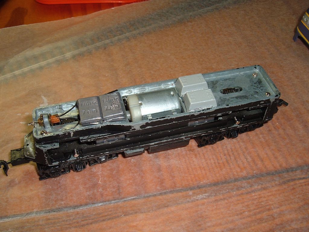

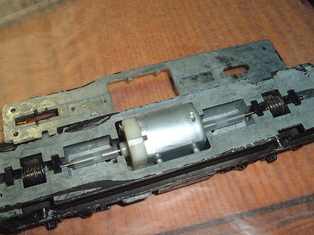

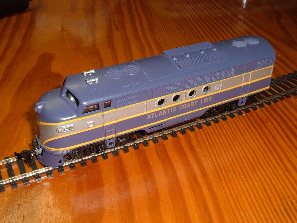

 Posted - August 26 2010 :  4:40:12 PM Link directly to this reply  Show Profile  Add NickelPlate759 to Buddylist
Here are a few shots of my AHM FT with a Mabuchi motor installed (old IHC stock), and the couplings replaced with RC fuel line tubing. I had to grind some metal away from the ribs beside the motor to get this to fit, but otherwise it was a very easy conversion.
I also added 4 more ounces of weight to every available space in the frame, so now this thing pulls like a super-weighted Athearn F-unit, and has better speed stability.

Nice looking EMD-FT engine. I have a few of those motors lying around so that looks like a doable project. The RC fuel line is a great idea. Old aquarium undergravel filter tubes could probably work quite nicely as well. Running like an Athearn is the impression I got after I cleaned and lubed up my GP-40. It is alot quieter but has that heavy growly sound to it as it moves along. Indeed they built the engines back then with hobby quality in mind. (Compared to some of the pre-Spectrum/Plus stuff they put out in train sets during the mid 80's). Lots of metal and gears!!!
 Country: USA  ~  Posts: 67  ~  Member Since: October 30 2007  ~  Last Visit: November 03 2013 Alert Moderator  Go To Top Of Page
 Posted - August 26 2010 :  9:56:21 PM Link directly to this reply  Show Profile  Add NickelPlate759 to Buddylist
If you have a hobby shop nearby that sells RC vehicles, silicone fuel line tubing is the best. Get the smallest diameter. Most aquarium tubing is large stiff PVC, I think.
