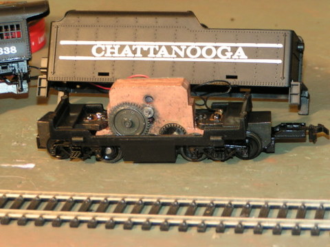

all of a sudden it stopped and started making a whirring noise.
Took the tender apart and the small drive gear had slid off the shaft enough to be out of the drive train. Pressed it back on and no more than 30 seconds it whirred again.
I''ve put a couple of drops of super glue on the shaft. so far so good.
any other suggestions
 Posted - July 23 2010 :  9:14:47 PM Link directly to this reply  Show Profile  Add NickelPlate759 to Buddylist
The Super Glue is the way to go, but you may have to do it more than once. Degreasing the gear & motor shaft with alcohol first helps the CA to stick.
choochin3
 Posted - July 23 2010 :  11:38:29 PM Link directly to this reply  Show Profile  Add choochin3 to Buddylist
Super glue is one way to reattatch a loose gear.
I use JB Quick 2 part epoxy.
First I degrease the motor shaft,and gear,then I rough up the motor shaft with a small file to give the JB Quick something to hold onto instead of a polished motor shaft.
Put the gear on the motor,and mix up some JB,and apply.
You only need a dab of JB,and it cures in only a few minutes.
So far I've had no problems using this method.
Hope this helps.
Carl T.
derfberger
toby & Dindi
 Posted - July 24 2010 :  7:41:47 PM Link directly to this reply  Show Profile  Add derfberger to Buddylist
thanks
forgot about cleaning first and roughing up the shaft.
If it pops off again will do the process thoroughly
producer1105
 Posted - August 12 2010 :  02:05:30 AM Link directly to this reply  Show Profile  Add producer1105 to Buddylist
new to this forum. anyone know where to get replacement tooth gear for Chatanooga Tender. This is about 44 teeth, 18mm dia., and has inner gear of 8 teeth 4mm on one side and smooth gear, 3mm dia. on the other side?

producer1105
 Posted - August 13 2010 :  02:49:20 AM Link directly to this reply  Show Profile  Add producer1105 to Buddylist
how does one find a replacement for the main (large) tooth gear?

producer1105
 Posted - August 13 2010 :  03:10:41 AM Link directly to this reply  Show Profile  Add producer1105 to Buddylist
are you talking about the big gear the the pinion gear spins?
Originally posted by smokie - August 12 2010 :  12:16:58 PM
yes. it is the biggest gear in the tender. 44 teeth? 18m o.d. has one inner hub with 8 teeth and one inner hub on the other side which is smooth. Hard to find replacement part???

producer1105
 Posted - August 13 2010 :  5:50:31 PM Link directly to this reply  Show Profile  Add producer1105 to Buddylist
The big gear in the center of the photo of the first post in this topic is the gear I am looking for. Take any leads I can get. And thanks for helping on this.
