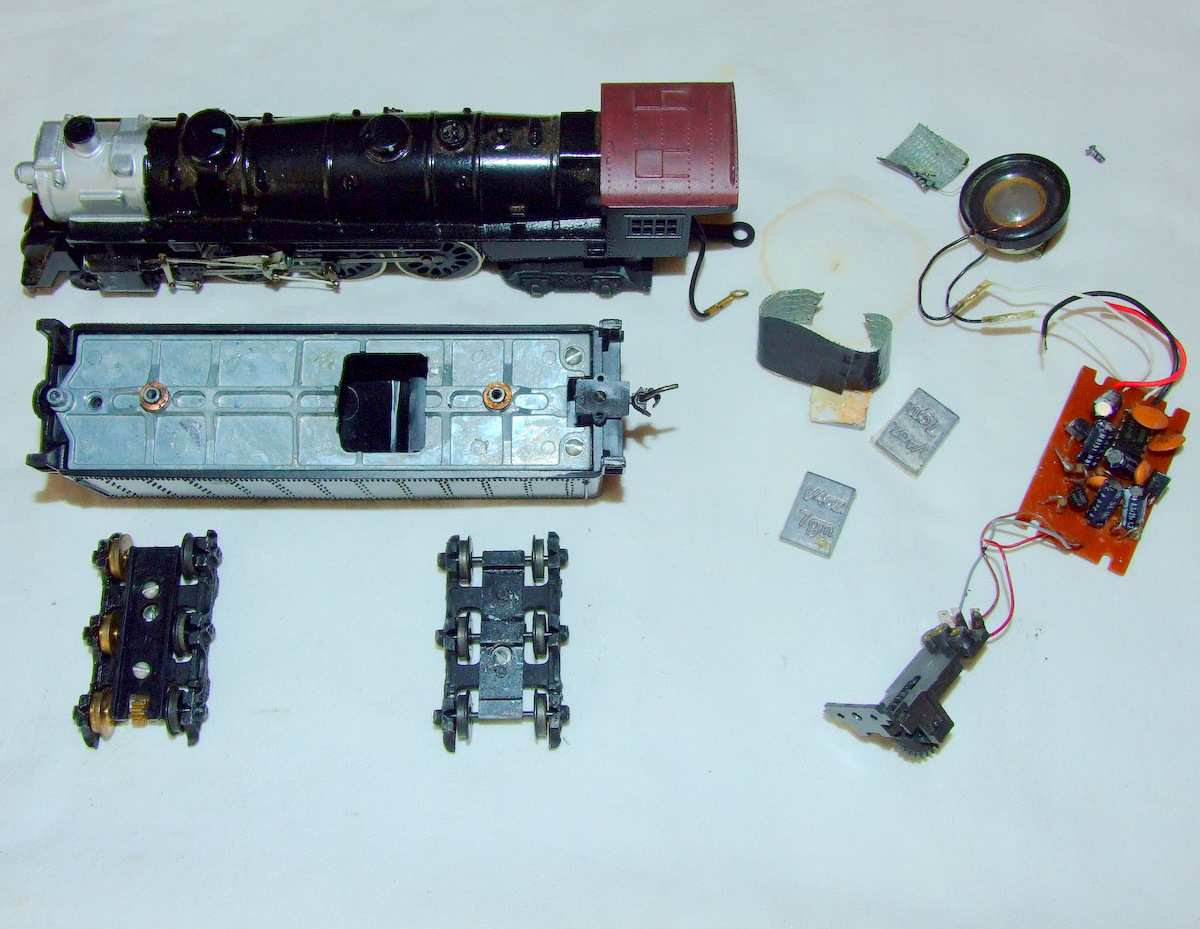

just got this off ebay mantua hudson,supposed to be genuine mantua sound system?,hole in tender does not seem,right to rough,not a screw in sight to hold it in place,plus loco was supposed to be as it left factory,which i do not believe due to finish and lack of handrails full stop ken
Edited by - catfordken on July 13 2010 6:22:04 PM
 Posted - July 13 2010 :  08:39:10 AM Link directly to this reply  Show Profile  Add toptrain to Buddylist
Good morning Kenny ; Yep that is one of Mantua's sound systems. Will that be a PGW painted Hudson or Pacific.
Edited by - toptrain on July 13 2010 08:40:08 AM
 Posted - July 13 2010 :  08:44:23 AM Link directly to this reply  Show Profile  Add toptrain to Buddylist

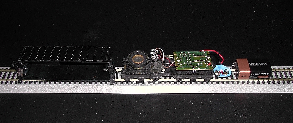

Ken it came with a battery connection. yours doesn't seam to have it. The red and black are proably the wires to connect to it. I am glad you showed this. I have two in boxes I have to find now because, I may have forgotten to remove the batteries.
Edited by - toptrain on July 13 2010 08:47:22 AM
 Posted - July 13 2010 :  08:55:42 AM Link directly to this reply  Show Profile  Send catfordken a Yahoo! Message  Add catfordken to Buddylist
morning frank,yep its not what i bought it for,supposed to have been mint,but as you can see its only good for a repaint,guy says thats the way he bought it from states, in Huntington Beach,CA in the 90s ken
Edited by - catfordken on July 13 2010 6:21:32 PM

Hi Ken. Here is picture of one assembled. Uses a 9 volt for power. Carl

hi frank/carl many thanks,it works when connected to battery and the cog is turned,is everything held in with tape or what ken

hey frank or carl would love a big shot closeup of the workings to sound unit ken

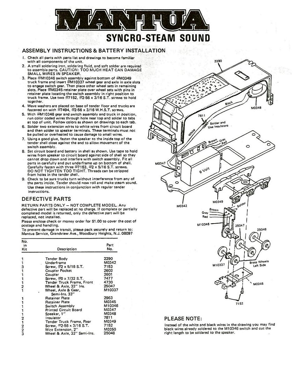

Hi Ken. Here is the Instructions for the unit. Sorry my scanner is dying. . I have to sell one of those 1975-76 Tyco Catalogs so I can buy a new one.. Carl
Update: got my scanner to make a better Copy..
