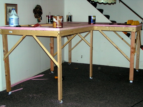

last night construction came to a screeching halt when after putting up the first frame i realized I'd never be able to reach across a 4 ft span.
Right now it's 4 ft high. I could make it 3 ft but still can't reach across. I really don't want to leave an aisle in the back as i will then lose sq feet and i wanted to paint scenery on the walls.
The table in the picture is 4x7. I intended to have another running 90 degrees 4x6. I was going to cut in 1 foot by 2 ft where the L meets but still won't be able to reach across.
Reducing widths means no 22 in radius
I see so many 4 x 8 layouts, how do people deal with access.
Trap doors might be an option.
I plan to have an elevated track maybe 2 running the length of the 10 ft along the wall. Maybe part of it inside a mountain.
The attached layout is just a start. Where the track crosses in the middle would be over pass
I even thought of casters and rolling out when necessary..
Then there is the body harness and sky hook attached to the ceiling
your help and input greatly appreciated

My layout is a similar shape, but I have room to walk all around it. You could move it away from the wall a foot or so, and nail on a short backdrop that you can paint.

...when after putting up the first frame i realized I'd never be able to reach across a 4 ft span.
There's always those reachy grabbers sold in stores. Either hard plastic fingers, or rubber discs on the ends , $10-20. My train club has one ( I donated it ), and it's come in very handy since our layout at many points is 6-8' deep.
...(1) Trap doors might be an option.
....(2) I even thought of casters and rolling out when necessary..
...(3) Then there is the body harness and sky hook attached to the ceiling
fred
Originally posted by derfberger - July 10 2010 :  10:20:30 AM
You forgot (4) holding the child outstretched over the layout, while your arms tremble and tick after 20 seconds....
Anyway, 1/trap doors is a good option, although for a 4-foot space, that may be overkill.
2/casters is good, although you'll then need to spend extra $'s on the bracing to prevent layout flex while rolling an L-shaped layout around. Since your layout is not too huge, this can be a viable option. Just costs more for GOOD casters ( not the little dinky 1" wheels, you need 3 or 4 inch wheels on Heavy duty casters to take the weight of the layout. Don't skimp here! )
3/skyhook, well, they make handicapped ceiling rail to help paraplegics get into bed, tubs,etc. so this MAY be an option, albeit expensive. Would be fun to see you do it! Don't think your wife will like THAT expense, though! A CHEAPER alternative might be to steal one of those Amusement center crane games, where you deposit quarters and spend $30 trying to win a .99 cent stuffed animal. Just have the claw come down out of the ceiling to pick up your derailed rolling stock. Of course, the consequent drop into the receiving bin may negate any monetary savings you had over the Paraplegic rail system. Maybe some foam in the bin will help....
4/holding squirmy child, well, we know when you finally let go and drop, you'll have modeled
a weather phenomena known as the Microburst, because everything under it will be flattened. Good for a one-time creative "burst" of scenery change.
Most home layouts I've seen, they leave room behind, but since you don't have that much space, I'd say either roll-out or an extension grabber may be your best options. A small portable 3-foot stool is also a viable alternative, IF you design in hand-placement areas on the layout so you can bend over, put your hand on that one (supported by design underneath) spot to reach to the furthest corner. Just watch out for microbursts!
That ladder can go skidding out from under you at any time.
Oh, <edit> , I forgot 5/mechanics engine bay cradle. I've seen them somewhere, they make a rig where the auto mechanic is laying on a cradle stretched out over the engine bay so he can work on the back part of the engine, without touching the car or leaning on the engine. I think it's designed like an engine hoist, so you'd have to have clearance under the layout for the legs to roll under it. Would make it very easy to work for long periods of time on your layout at the back parts, unless you have to keep getting up for detail items. LOL.
Edited by - AMC_Gremlin_GT on July 10 2010 11:00:29 AM

If that is the size of the frame work, put some wheels on it and pull it out when you run it, or work on it.

well i want back down in the basement and put our 4 ft step stool up against the frame.
If i dig my toes in i can reach across the 4 ft. For most needs this will work assuming my feet don't slip out from me and i put my head through the foam. . putting trains back from a derail will be a challenge as I'm all thumbs when it comes to re railing.
The kid idea isn't a bad one.
There are a couple in the neighborhood i'd like to take a handfull of hair and with the other
the seat of the pants and hold them off the ground

What is under that stairway? If there is a storage space, can you cut access panels or doors in the wall? Anyone remember "Laugh In?"

I'm going with casters, all kinds and weight capacities at H D. Should easily roll out when required

As soon as i saw the bed casters i knew i had the answer. Incredably easy to move away from the wall.
The height right now is 4ft 4 in. I was debating to cut down to 3 ft as a bit high for grand kids to enjoy. The first time i had to "crab crawl" under the table to add a brace i knew it will stay at the present height. At 3 feet i'd need a auto dolly to run wire etc. Kids will have stools to view

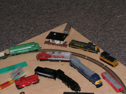

P S S a pic of some of my garage sale/bartering collection so far
 Posted - July 17 2010 :  10:26:20 PM Link directly to this reply  Show Profile  Add walt to Buddylist
That big CSX is cool

 Posted - July 17 2010 :  10:29:30 PM Link directly to this reply  Show Profile  Add derfberger to Buddylist
yes but as a neophite didn't realize i'm limited to 18 in or more when i got it as part of the house sale. will have to keep it to the outside tracks and out of the switch yard which will have 16 radius
Originally posted by walt - July 17 2010 :  10:26:20 PM
Yup, I have a similar one,looks like either a Dash 8-40cw or a C44-9W, not close enough shot for me to tell.

 Posted - July 18 2010 :  3:57:43 PM Link directly to this reply  Show Profile  Add microbusss to Buddylist
*steals the bottom of the SeaLand container* kidding Is that a RED PC caboose? very odd

 Posted - July 23 2010 :  8:22:25 PM Link directly to this reply  Show Profile  Add derfberger to Buddylist
thanks but it's giving me fits.
I've never had such a long engine before. I've set up a circular test track 18" R. The CSX runs O K.
Now i have started my lay out and the outside track has 22" R except one place where the 22 transitions into a 18. Half the time the CSX derails when it hits the 18. I'd like to run a parallel track which means 20" curves
I don't want to limit my layout to 22 in but at the same time i'd like to use the CSX. I could drop down to 20"R when needed
Also have acquired lots of 18" curves that i'd like to use.
One thought is to go with 23, 21, and 19 R. The 23 would require a guard rail as really hugging the edge of the boards again eleminates the 18" pieces
What do people do with limited layout space and these long engines..
How do they deal with switch yards with 18" R turn outs/
Thanks
 Posted - July 23 2010 :  8:50:11 PM Link directly to this reply  Show Profile  Send AMC_Gremlin_GT an AOL message  Send AMC_Gremlin_GT a Yahoo! Message  Add AMC_Gremlin_GT to Buddylist
Originally posted by derfberger - July 23 2010 :  8:22:25 PM
Um, you don't try to fit a size 10 foot into a size 8 shoe? Basically, if you're running a short-radius layout, you're self-limiting yourself to those power units that can negotiate the tight curves, ie switchers, Branch Line units, etc. Just as you can't run a Big Boy on branch lines. Your only hope is to have a transfer area between railroads , which could be a few straight lines and some longer turnouts to transfer consists, and just use the long diesel there as a haul and dump unit, with no other interaction on the layout except at the transfer yard. That's about the only acceptable use I can think of for your short-radius issue. You can hide the in and out track behind trees, etc.
Jerry in Virginia
derfberger
toby & Dindi
 Posted - July 23 2010 :  8:55:32 PM Link directly to this reply  Show Profile  Add derfberger to Buddylist
thank you Jerry
guess i should have been a bit more selective when visiting garage sales.
I'm still learning
