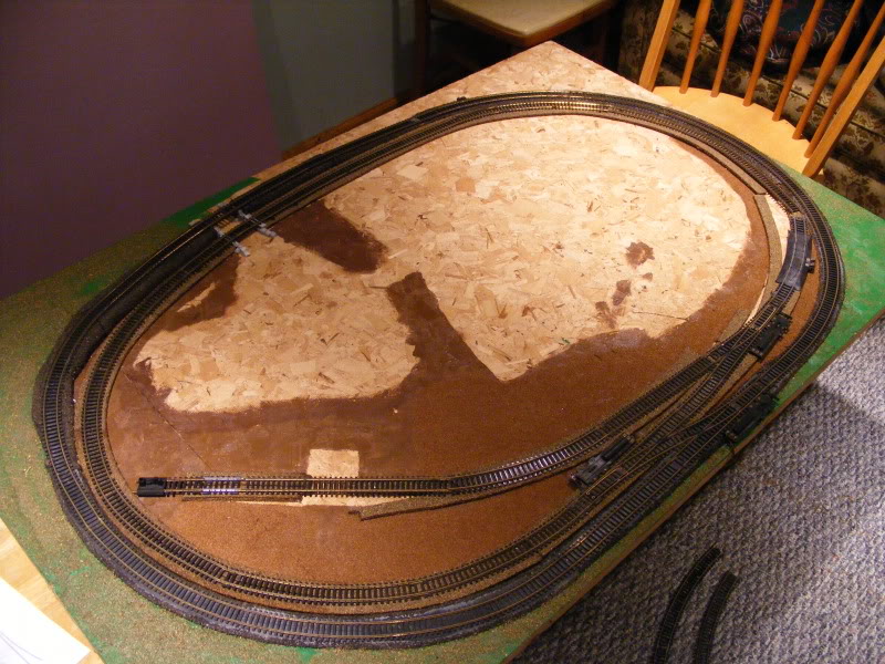

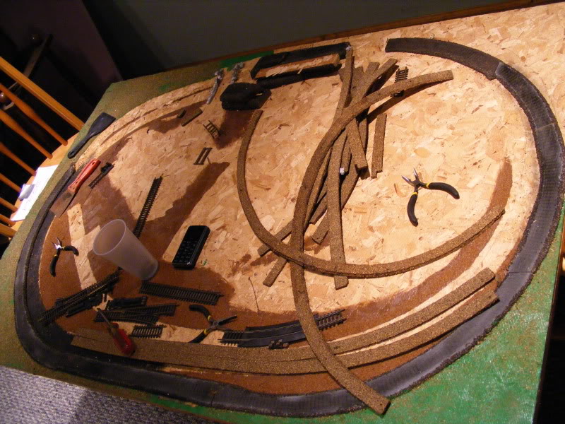

I've been posting this over on another forum, I finally get a chance to post it here as well! My brother calls me last week, tells me there is a train layout sitting out by the road nearby his house with the words "FREE" on it. Size was roughly 3x5, which is small by all standards. However I've been wanting to do a diorama to practice scenery & weathering on. Plus its free and can actually run trains in a loop so what the hey. I pick it up and drag it home.

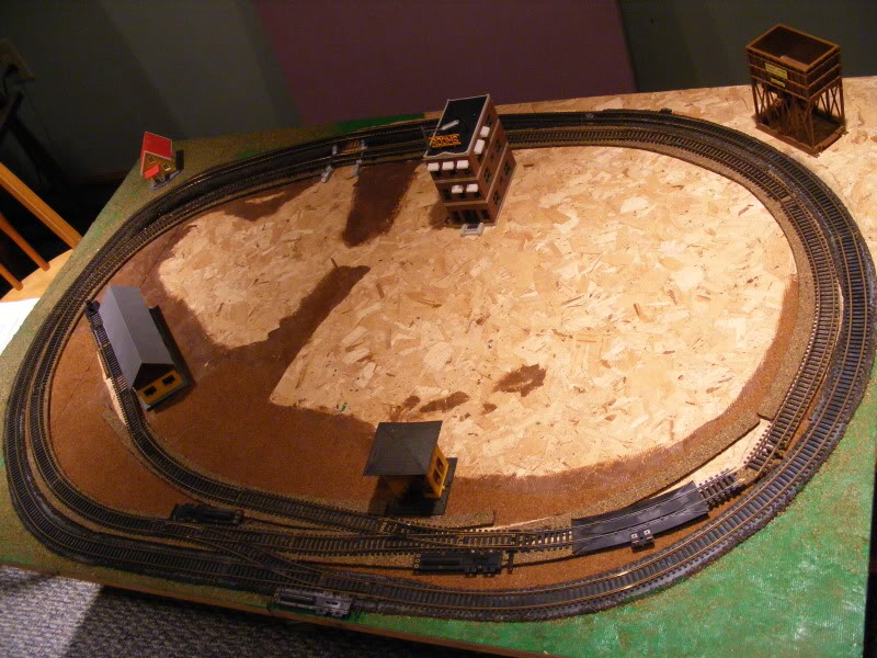

What the picture doesn't convey, is that the outside loops are TIGHTER than 18", I don't even want to guess what the inside one is lol. Had this neat little bridge thing in the corner, the stones were actually painted styrofoam cubes and they pulled off the look quiet well.
And a shot with some of my old buildings on it since I was just playing around. Notice while the inner loop had a cork roadbed. The outer loop has painted black wood for its roadbed.

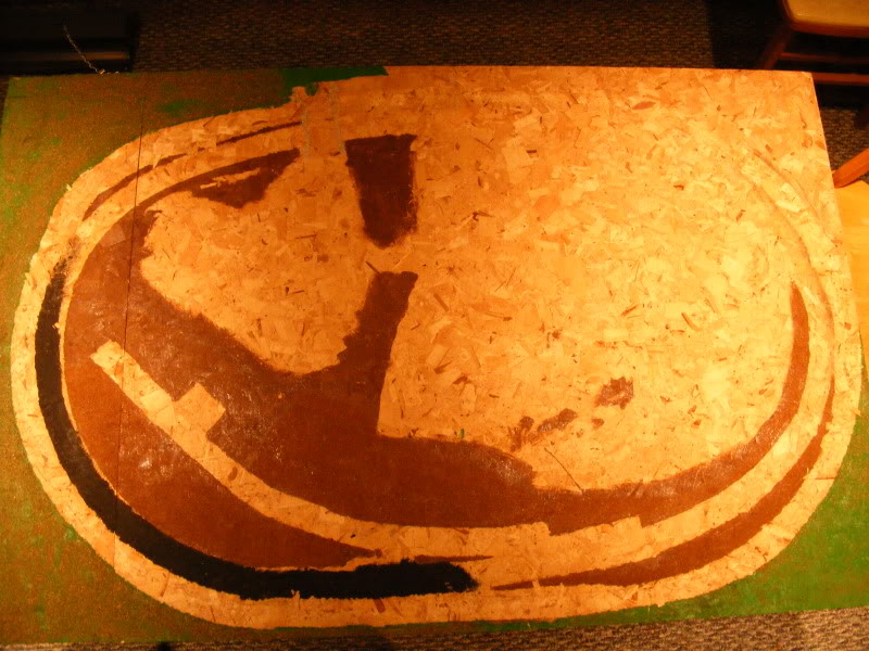

Obviously, I think its time to abandon the original ROW.

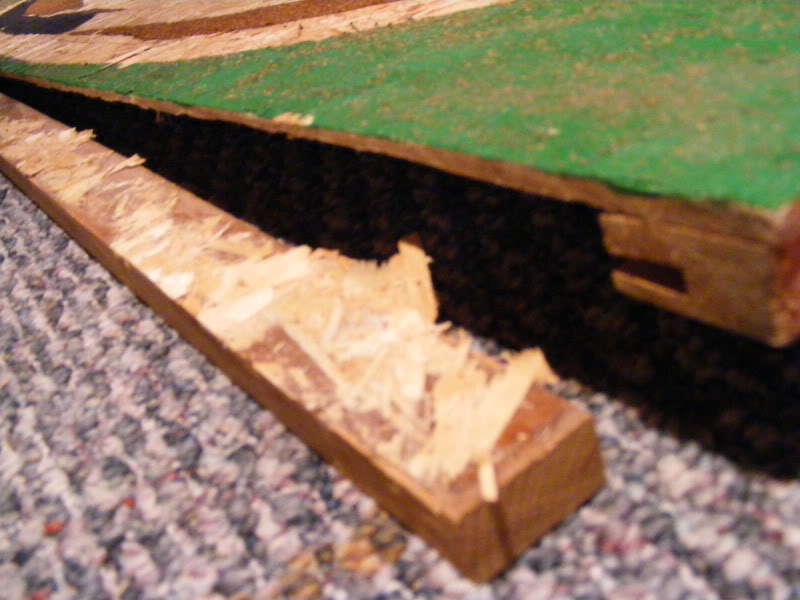

The wood roadbed was a pain to pull up. I'm saving most the brass track, I'm trying to do this project for cheap so I might reuse some of it and a little extra I had of my own. If its too much of a pain I'll just goto the local hobby store and get nickel silver stuff. All 3 switches go the same direction so that's not helping either. Next up is that pink foam you can see in the background of the photos. I have more of it. Guess where its going to end up?

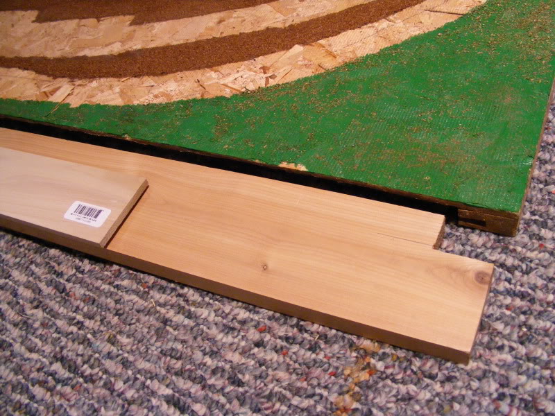

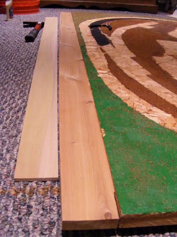

I needed to make the whole thing just a tad wider to at least support 18" turns. So I carefully removed the nails and did my best to separate one of the supports on the one side which was held on with some glue.
The new piece of wood was cut & notched to work around the existing braces on the underside. You can also see the spacer piece off to the left to make the whole thing level with the existing surface.
The new extension was both glued and nailed back into place. And I didn't get a pic but I glued the spacers on also. The leftover spacer material I think I'll use on the underside and corner braces to help reinforce the whole thing and make it a tad more solid.
The cost of materials so far has been pretty well under control. The wood I bought for the extension was only a few bucks, it was the cheapest Home Depot had haha. Plus I'll use most all of it.

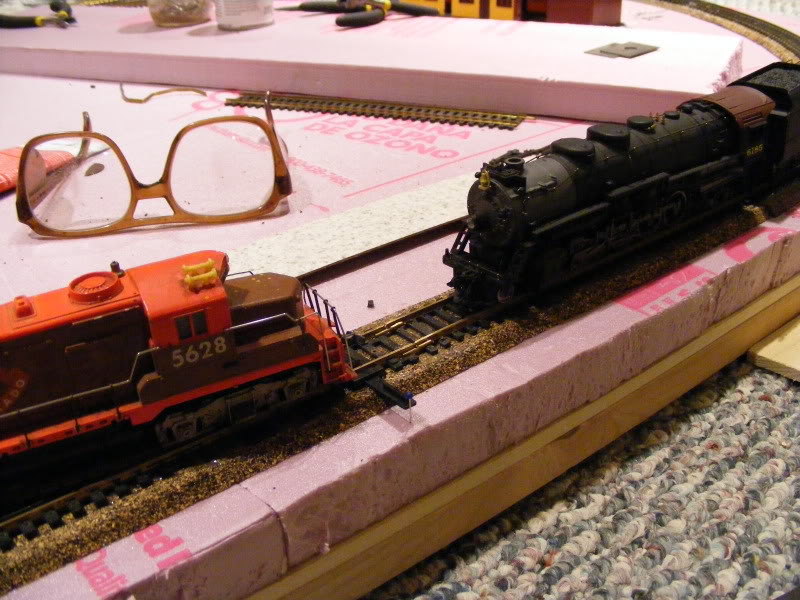

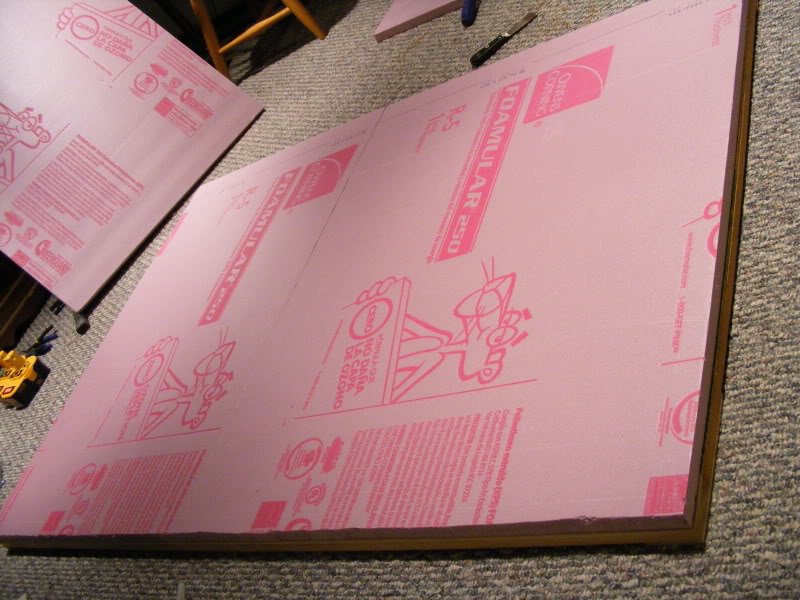

Next step, the foam base!

Made a run by the hobby shop yesterday. Bought some ballast and two sections of cork. I also bought a nickle silver switch and swapped it with a brass switch off Rental Layout, so everybody wins haha. Aside from the corners I reinforced the corners on the underside to make the whole heap a little stronger. Won't get a chance to touch it again till sometime next week, but the hard part is over now I can move onto track laying!

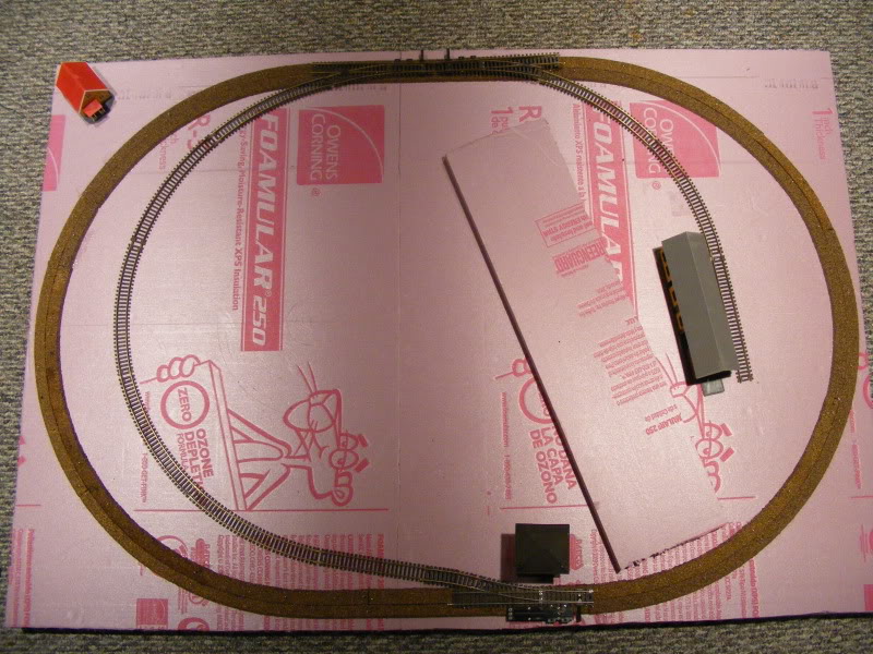

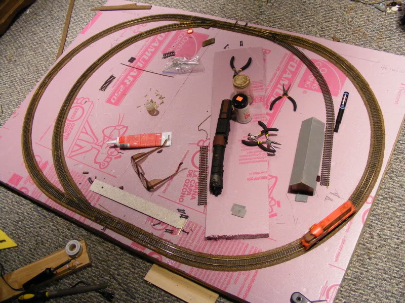

Got some roadbed down & mocked up a few things tonight.
First off I'm really happy with the spacing from the edge, its pretty much exactly what I wanted. The roadbed is held down with adhesive caulk. You can't see it in the pictures, but there are many pins holding the curves of the roadbed in place so that whole deal is going pretty well. The passing siding will probably end up a tad closer to the main when its done. The foam block across the middle is a possible location for a hill. The buildings are just there to check out how everything fits together. And so far its matching up with the vision I had in my head perfectly. I have to get some more cork since I don't have enough to do the sidings. And I'm still wondering if I should glue or nail the track in place.

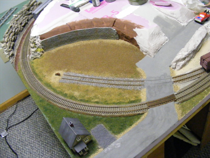

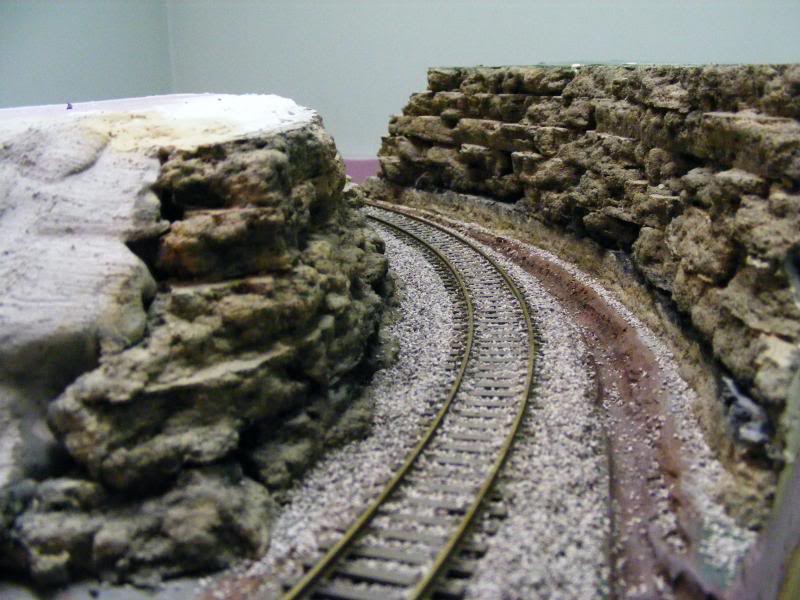

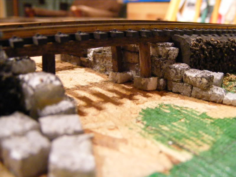

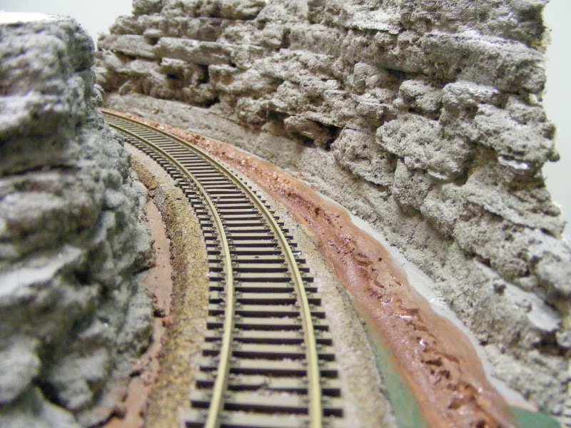

Coming into winter, been pushing things around on the layout again. I sorta ended up around here last winter I just never posted the updated photo. Got a little past this point (shaved the foam into hills) but then hit a few road blocks that kinda scared me away.

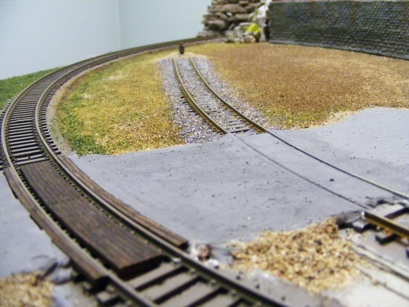

Got over a few rough spots with the layout and pushed forward a little. Sorta looks like this now.

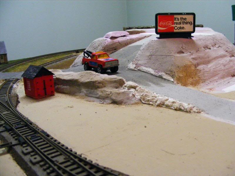

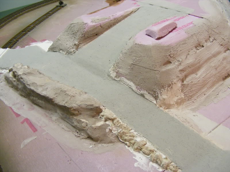

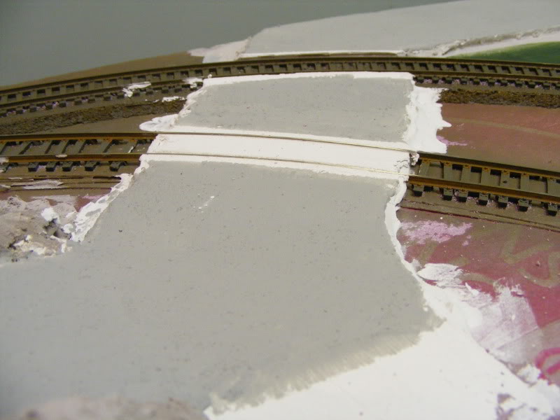

Roads were laid down with this stuff called Dry-Loc. Its a paint for basements that has sand or something gritty in it. Makes a great road texture and starts off a good color to boot! Though I've been playing around I'll eventually paint the road a shade darker or two. Check out the crossings (one of the things that were giving me fits). And below that just some close up of the roads going up & over the hill.

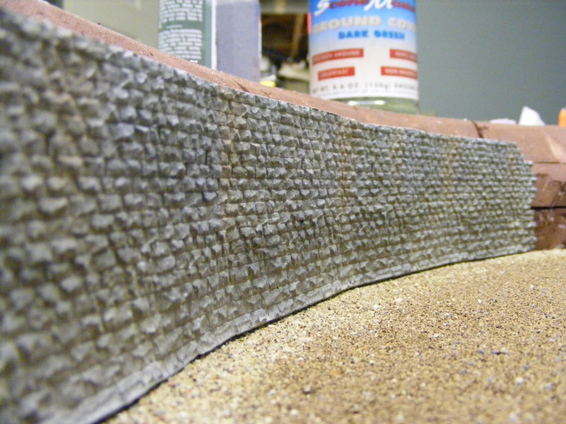

Other thing that gave me fits was the wall I needed to build for the one section. A friend gave me a supply of 3/16 wood dowels so I figured awesome I'll build a cribbed wall or something out of them. No dice, just not worth the hassle I was going through. The round dowels refused to be stacked into something resembling a wall on such a odd curve. SOOOooo a trip to the local hobby shop I found this stick on wall from Chooch Enterprises. Sticking it to a piece of foam core board kept it ridged. Yet with a few cuts in the back it let get get around the odd curve of the surface I needed to cover. Its a bit short, but I can make the rest work.

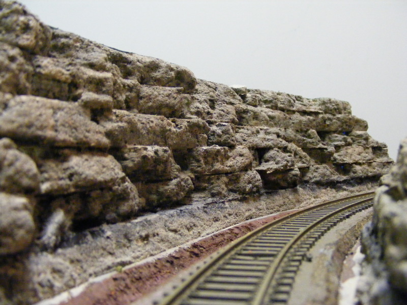

This part is coming out really cool. The ceiling tile rocks. Its already a different color from this picture it now has a tan wash over it. Rock faces/cliffs around here are like a dirty tan color so I got them pretty close now.
Actually working on buildings now. Which I like because I enjoy models for than scenery. However I'm having a hard time rehabilitating models that are molded bright colors lol. Stay tuned!

 Posted - January 06 2012 :  12:28:48 AM Link directly to this reply  Show Profile  Add ChrisC to Buddylist
The Dry-Loc sounds interesting, how small a container does it come in? Might want to check that out myself.

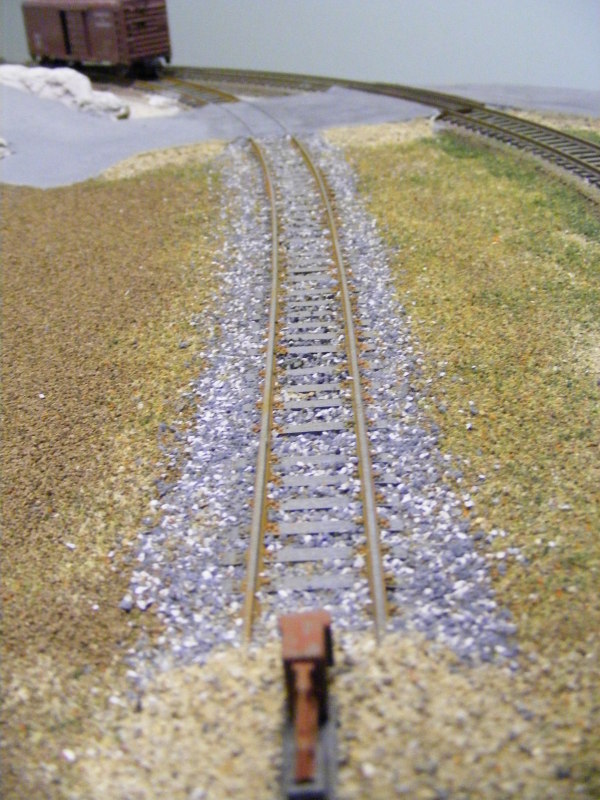

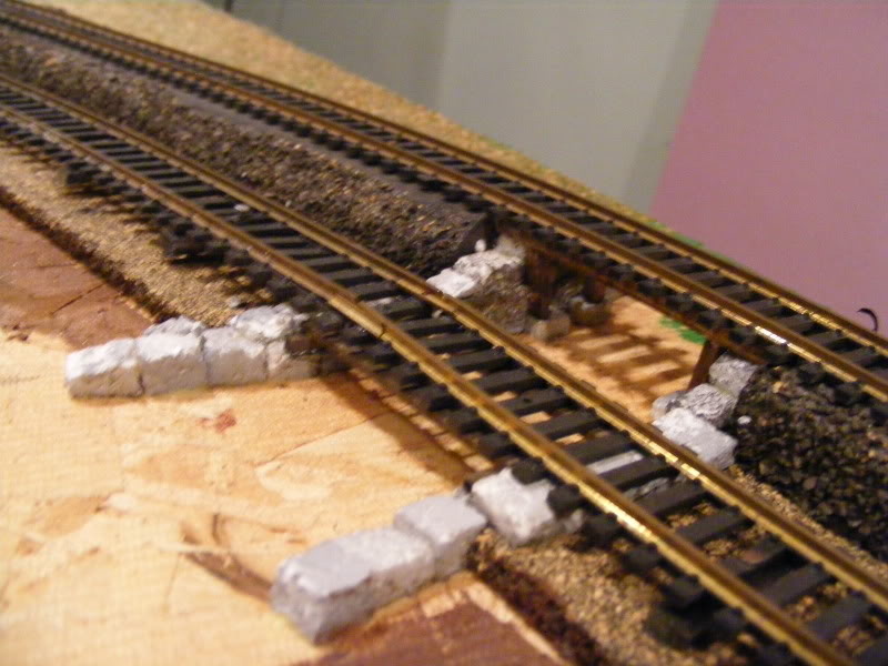

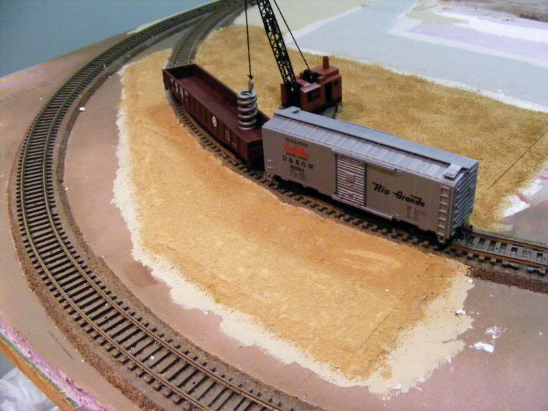

So to bring everyone up to speed I have in fact started on the ground cover. I looks pretty good thus far. However I'm having issues with my spray mixure to bond it to a solid surface. I've either mixed it with too much glue and it doesn't spray right, or too much water and it doesn't bond enough. While I to work that out I resprayed the brick wall that will be going in. Its now more of a grey color. It needs some dry brushing, chalk, and it should be ready to go on the layout. In a few days I should be ready to show some updated pictures of all of this. In the meantime, he is a teaser pics of the cut through the rocks and its new tan-ish looking color. Check out the coal seam along the bottom! It also has a few light color washes on it, but the pictures aren't doing it justice. Next step for these will be some rock talus & small plants along the rock faces.

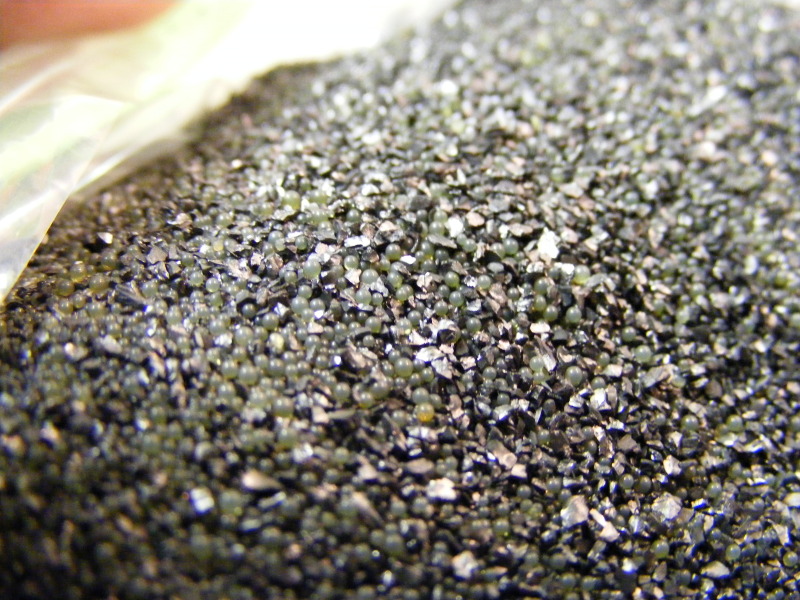

Here are two fun tips I've sorta picked up on so I'm going to pass them on to anyone else who can use them. Looking for cheaper ground cover lead me to use some sand from a bag of tube sand in my garage. I had to strain it through a screen to get some of the larger rocks out. I also put a magenet in the bag with the sand to pick up any magnetic pieces. So watch for that if your using sand from a unknown source. For this reason I've been keeping it away from the tracks when using it (and the spots near the tracks are getting glued down heavily). Obviously you don't want trains picking stuff up.

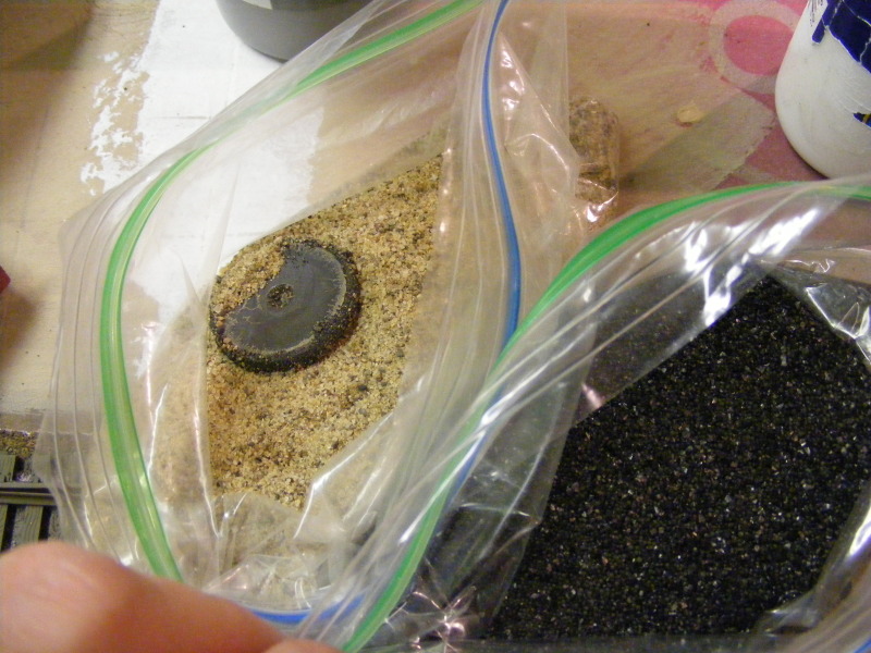

You probably saying "Neat sand, what's the black stuff the looks like scale coal?" I found that one on accident. Its the insides of a Brita water filter. However, when you view it up close it looks like this.
Strange little balls appear. I've tried various methods to remove them like pouring the mix into oil to see if the black flakes are heavier/lighter than the balls. No avail so far. However if you lump them into a pile. Bond them with a bonding agent to make them soild. Then go back and dry brush black over the surface you can make very convincing coal piles to the causual observer.

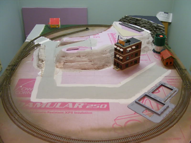

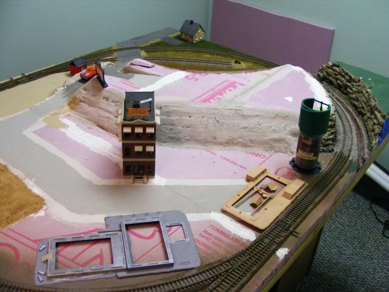

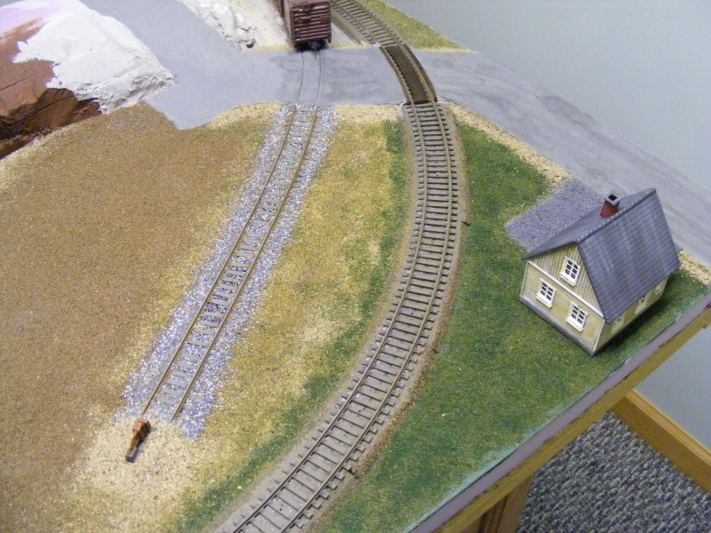

Initial ground cover down. Wall mocked up in place. Roads partially ink washed. Its slowly moving forward Rock formation looks MUCH better from this angle.
Spur needs some washes or chalk or something to blend the ballast in a little bit. Eventually weeds will grow here.

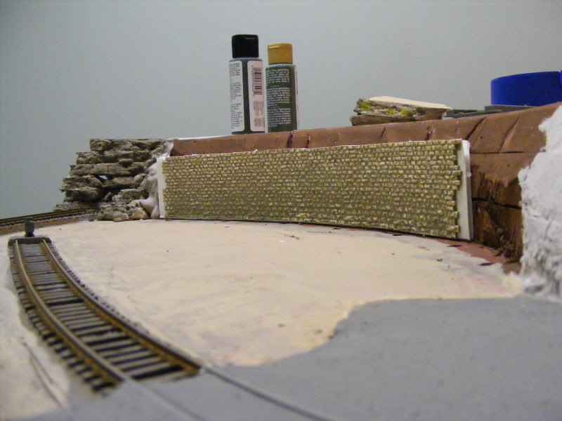

If you look at the earlier photos I totally resprayed the wall a different set of colors (yes I said colors). Then ink washed & chalked it a little. Looks pretty good I think. Covering the bare ends will take a bit of work, most likely with weeds & bushes.
Soon as I get some supplies later this week I'm going to start rebuilding the warehouse that sits here. Doing the buildings as I go is a nice mental break.

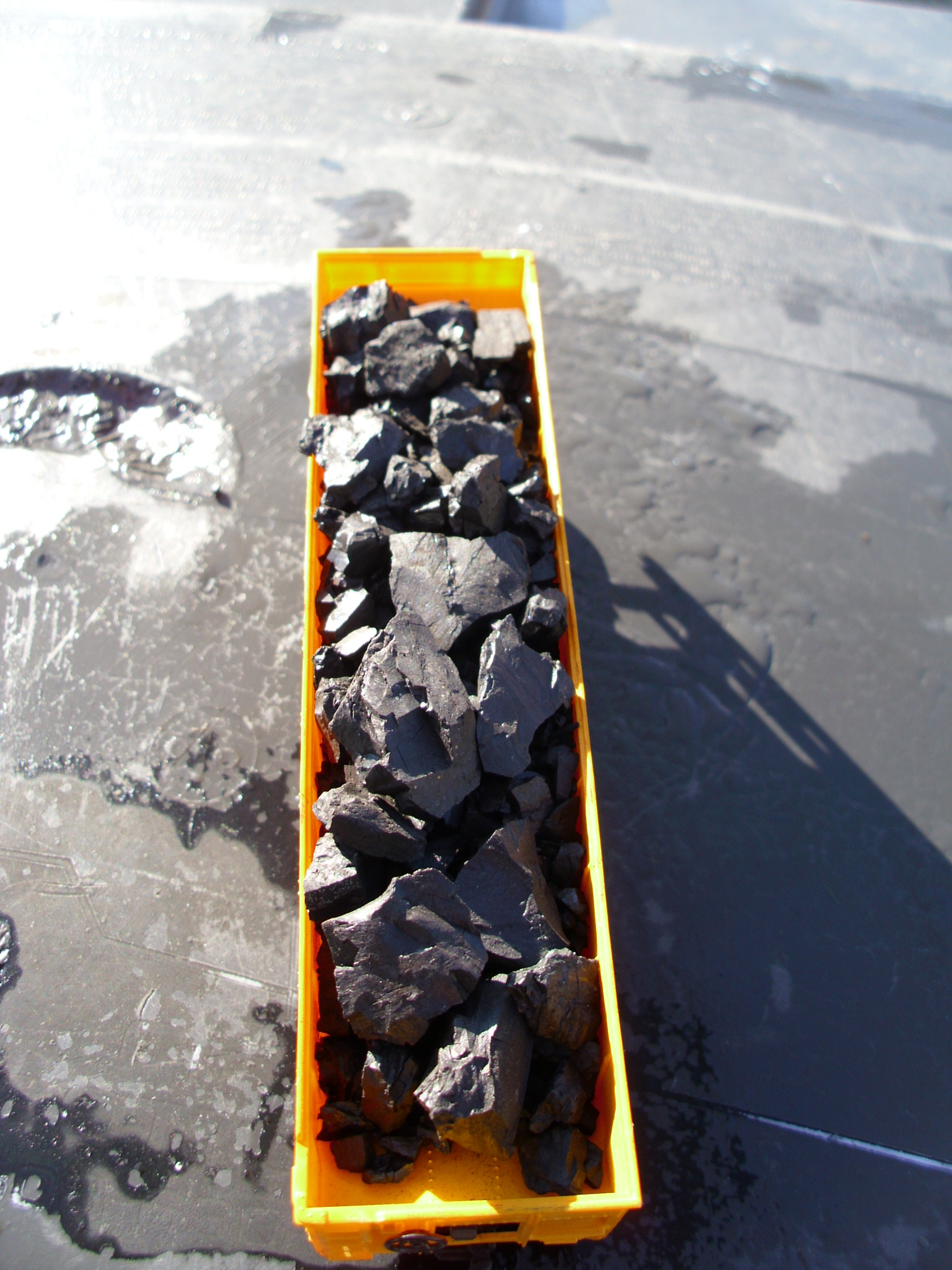

 Posted - January 27 2012 :  8:41:56 PM Link directly to this reply  Show Profile  Add microbusss to Buddylist
Why buy the coal when REAL coal will do?
All you gotta do is find a recent coal train derailment & get some
Mine came from a friend as he used to burn coal in his wood stove

As for the contents of the filter, the black stuff should be activated charcoal, and those are probably resin beads mixed in, which you find in water softener tanks.

Let's go over why.
First was the size. It's 18" radius (maybe a hair under) and it runs RIGHT along the edge. During testing on the track work years ago one of my larger engines picked a switch and toppled off the layout. Thankfully it was on the ground when that happened, but it stays in the back of your mind as a "what if". As as high as the layout sits now I don't want to see any loco take the plunge. Not to mention there is at least a 1/4 of my fleet that won't even run on it and that irks me that they are shelf queens. We have this same problem over on my friends home layout (see the thread labeled "The rental layout") because neither of us have big enough turns or good enough trackwork.
Second was the design. It was very efficient I thought for being a loop. But for the room it was in it was a terrible use of space. I really struggled with the idea of adding onto it. And I just couldn't reach a happy medium on how to situate the layout if I did a expansion off it. I was also running into space issues as I began to arrange where buildings would go down the road. No matter how well I arranged things it felt a bit forced to me I guess. Like I was just cramming stuff on there.
And finally was just things I learned building the layout. Thing's I would do differently with the track work, scenery, etc. It was the first time I ever laid track so there were a few things I'd do differently if I went to do it again. And some of the scenery ideas I was going after were giving me fits as well.
What was worse was while the building of the layout was going on I couldn't even run trains on it. I sprayed the track brown long ago, but figured I would clean the rails when I was done ballasting the whole thing. Well I was so wrapped up I was ballasting it in sections so basically for the past few years I've only run trains on it barely a handful of times. Really takes it down a notch.
So with all that in mind here are some of the photos of where the line ends for this layout.

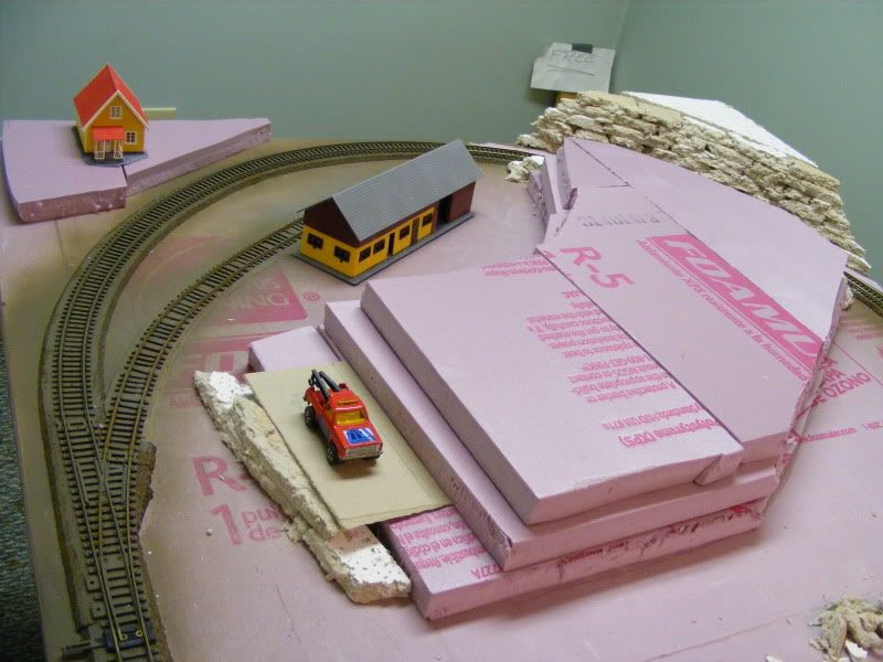

I started laying the ground work for the scrap yard I wanted to put in. I used foam core board to raise the land up to the track level then covered it with some dirt I collected outside.
I was pretty proud of these two road crossings and the lowered spur next to the mainline. However it took me forever on the crossings to get them to work together since they were at different levels.
Ballasted the track between the rock cut!
Shot of the side of the layout. The tower was going to sit here. Really got a little too carried away with trying to make the terrain be interesting here. I had so many different materials involved I really was at a loss sometimes on how to finish it haha.
Trying to arrange the base of a few buildings. Everything was positioned at a angle and it looked weird to me. Plus any business I had to be served off the inner passing track couldn't be positioned too close to the track. Normal people would have seen nothing wrong with this lol.
With that, we say goodbye to the old layout. I learned a TON off it. The best learning experience I've ever had in model railroading by far. But I got too ambitious for my own good. If anyone lives near Western PA and is looking for a good small layout PM me I'd like to see it maybe go to a loving home. Will trade for locos lol.
