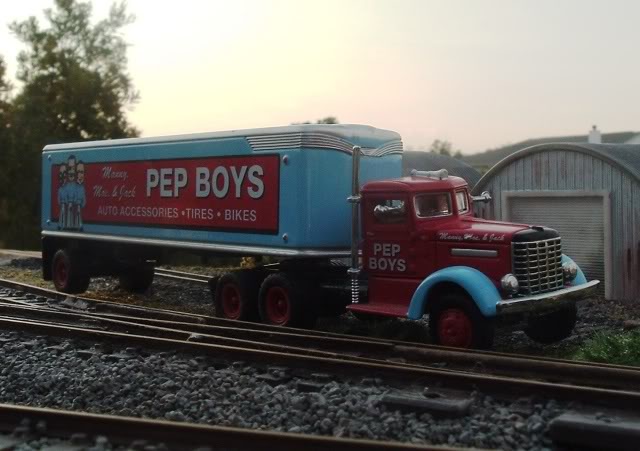

 Posted - November 04 2009 :  8:21:49 PM Link directly to this reply  Show Profile  Add microbusss to Buddylist
neato guys Hey shaygetz niiiice UP plow What's the Pep Boys truck look like? Is it HO?
 Posted - November 04 2009 :  10:59:33 PM Link directly to this reply  Show Profile  Add shaygetz to Buddylist
Thanks, it's from the Matchbox Collectibles Series of trucks from about 10-12 years ago. I got several for $5 a pop at a flea market...about the same as you can get them for on Ebay now. They're acceptable for HO, purists would really only have a problem with their road width...about a scale foot wider than normal. Other than that, they're near spot on for HO.
Edited by - shaygetz on November 04 2009 11:01:28 PM
 Posted - November 04 2009 :  11:02:40 PM Link directly to this reply  Show Profile  Add microbusss to Buddylist
wowee zowiee I likes! gotta find some Is it HO tho or close?
