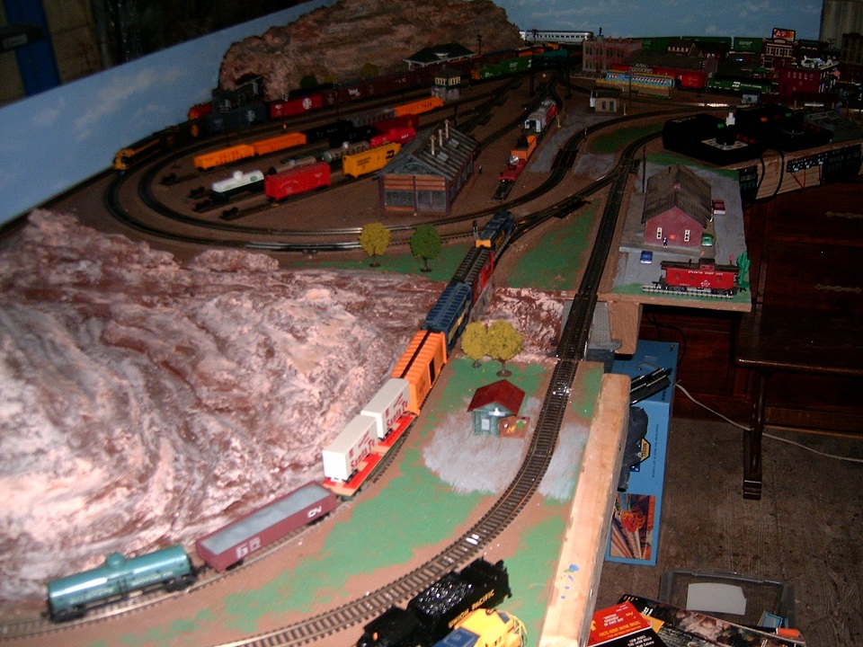

I call this my "current" layout because it's really just a fun setup for me and my daughter. We'll probably move in a couple years, so we'll start over.

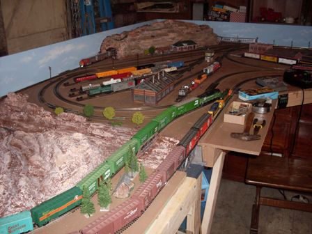

This first image is a look down the left side of the layout. The layout is an L-shape, 12 ft. on each long side. You can see there isn't much scenery other than the mountains. In the background is a tunnel.

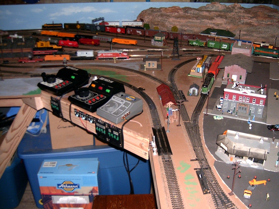

This next picture shows the other side. Again, not much scenery yet, but there are some structures.

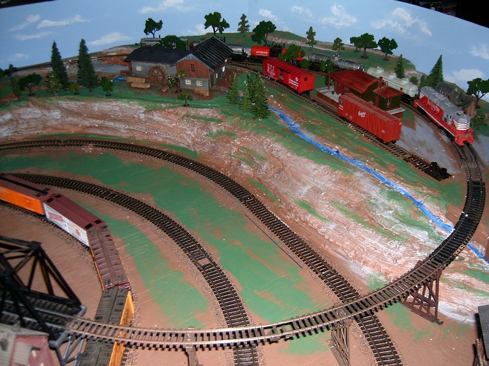

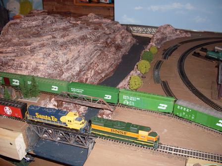

The last shot is a close-up of my "river" on the far left side of the layout. I just left a gap in the benchwork, and tried to round out the sides with foam and plaster. It looks better than in the photo.

Very nice for operating trains. The backdrop is a nice touch.

Nice looking layout! Will look good once you get a little more scenery down. Nice shape too I like the track plan.

Nice layout! The mountains and river look really cool. It looks like it's a good size too. Thanks for posting pics!

Love it! How did you make the mountains? I saw you mentioned foam . . . Are they just painted then? They look great.

I have my own method for the mountains. Other methods may be better, but this is what I came up with years ago and it works for me.
I start with 4x8 sheets of plain white styrofoam insulation. A sheet costs about 5 bucks at Menards. I trace out the outline of the mountain, then score and break it to leave a rough edge. After several layers of this, I have the rough shape of a mountain. Then I use a knife to scrape, smooth, or shape things as necessary. The whole thing is held together with toothpicks and those skewers you use for shish kebabs. (did i spell that right? oh well.) There's a lot of crumbly mess involved in getting the right shapes.
After that's all built, I use the cheapest hobby store plaster I can find to cover the whole thing. Just mix it up and smear it on. I use my hands. If you're a neat freak, you'll want to use rubber gloves. The trick is to use your hands and the rough edges of the foam to simulate layers of rock.
Once that's dry, I hit the whole thing with dark brown (or whatever color) spray paint. Then I do a sort-of drybush thing with acrylic paints...the cheap wal-mart apple barrel types. Basically I just layer up the colors until I'm happy. The I add some grass and such to add life to the scene. I haven't done that yet on this layout.
Like I said at first...it's probably not the best method. I've seen better work with that pink styrofoam and other materials, but this is cheap and works for me.

AS others have said -- nice layout. Like how your train yard is.

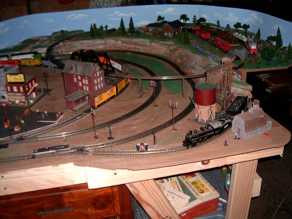

Here are some updated pictures of my layout. It's still not much to look at, but I just remodeled one end and I'm happy with the results. I added a third loop of track so I can run three trains at once. The pictures are a little bright because of the camera flash, and I'm not finished painting things yet, but here it is:
This is the newest section. The new track is elevated, and runs on trestles over the rest of the layout. Notice the sawmill that I purchased from Brian. It sits right next to an abandoned spur with a rundown depot.

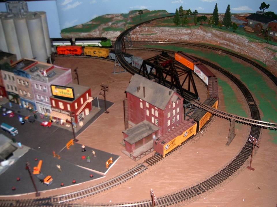

Moving left we see the trestles, bridge, and brewery. Still needs landscaping.

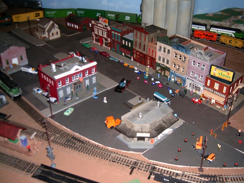

Downtown has really exploded over the last few weeks. Woodlawn Station and United grocer came from Brian, the other new ones came from the garage sale lot last week. The downtown has also become the domain of a 6 year old girl and her box of Micro Machines.

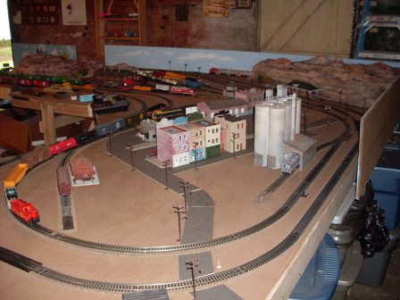

The yard and command center.
The other end of the layout, with the river, some mountains, and a siding. Life-Like's "Whistle Stop" looks good when painted up, and there's a new depot. Still need some landscaping.
Another shot of the new section, this time you can see the coal tower and water tower, and the barn my daughter put there.

ok why is there Micro Machines on Main St? Is someone having a R/C race?

That's a pretty good explanation! My wife suggested that the shriners were having a parade with their little sand buggys. I'm just happy because it keeps my daughter from moving all the buildings around.

hehe course the 1960s Batmobile from Hot Wheels is good too We can't all be serious about model railroading True?
 Posted - June 18 2010 :  2:19:57 PM Link directly to this reply  Show Profile  Add walt to Buddylist
Where the 60s Batmobile is can't be bad at all. Being an auto/mini truck customizer & painter, I believe the old Batmobile is one really neat piece of customizing. I would actualy like to own one for display. To see one in real is a treat...

i notice you don't use cork road beds.
Other than cost any reason>? What is the material under your track?
I was thinking to save on buying cork to mount directly to 2 inch styrofoam sheets

No, look closer--most of it's corked. It's just not ballasted yet because of the time and expense. I only skipped the cork on the new upper level and one end that I added on. You'll get different answers, but I would tell you that you certainly can skip the cork if you have to. I still use nails, but a lot of people use white glue and just glue the track in place. My daughter's 6x4 layout has no cork at all, and it works just fine.
