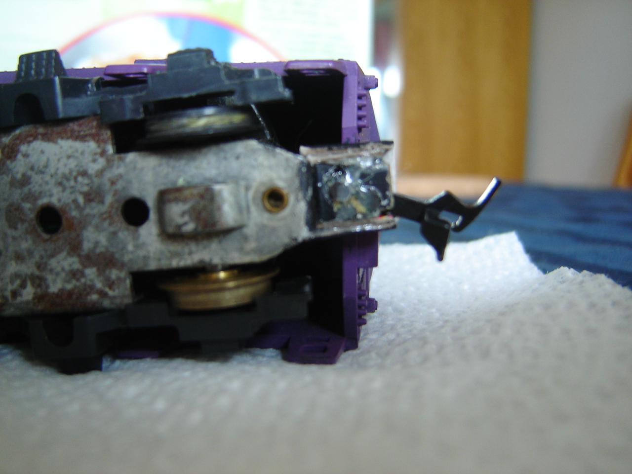

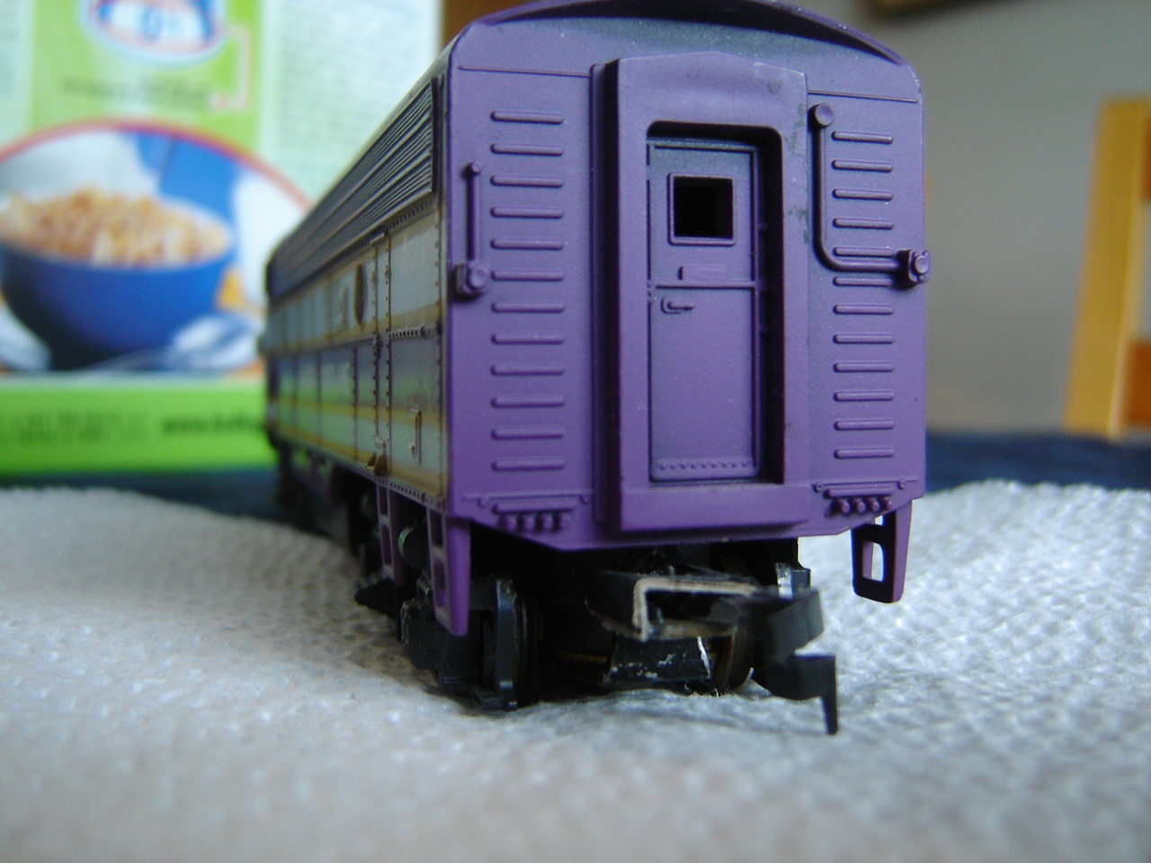

 Posted - May 30 2009 :  2:19:30 PM Link directly to this reply  Show Profile  Click to see DaCheez's MSN Messenger address  Add DaCheez to Buddylist
Hey Mike. The pics are a little blurry, but they should illustrate what I've done. This was my first attempt, so it's a little messy, but trust me...this coupler works perfectly.
The cereal box cardboard was folded to the same shape as the original pocket. I glued this over top of the tab. For the pin I took a plain old track nail, and cut the pointy end off to make it the right length. I then put the coupler in and stuck the nail in from the bottom, securing it with a drop of glue. For some reason this engine has an Athearn coupler on it...I don't remember why, but I think a Tyco coupler should work. If you're using an Athearn coupler you'll need to put something in between the nail and the hole in the coupler to keep the coupler from moving in and out.
If you did this with a piece of metal, you would probably get a much better result.
-cheez
