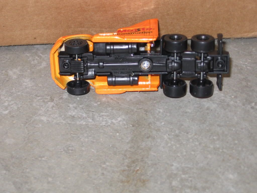

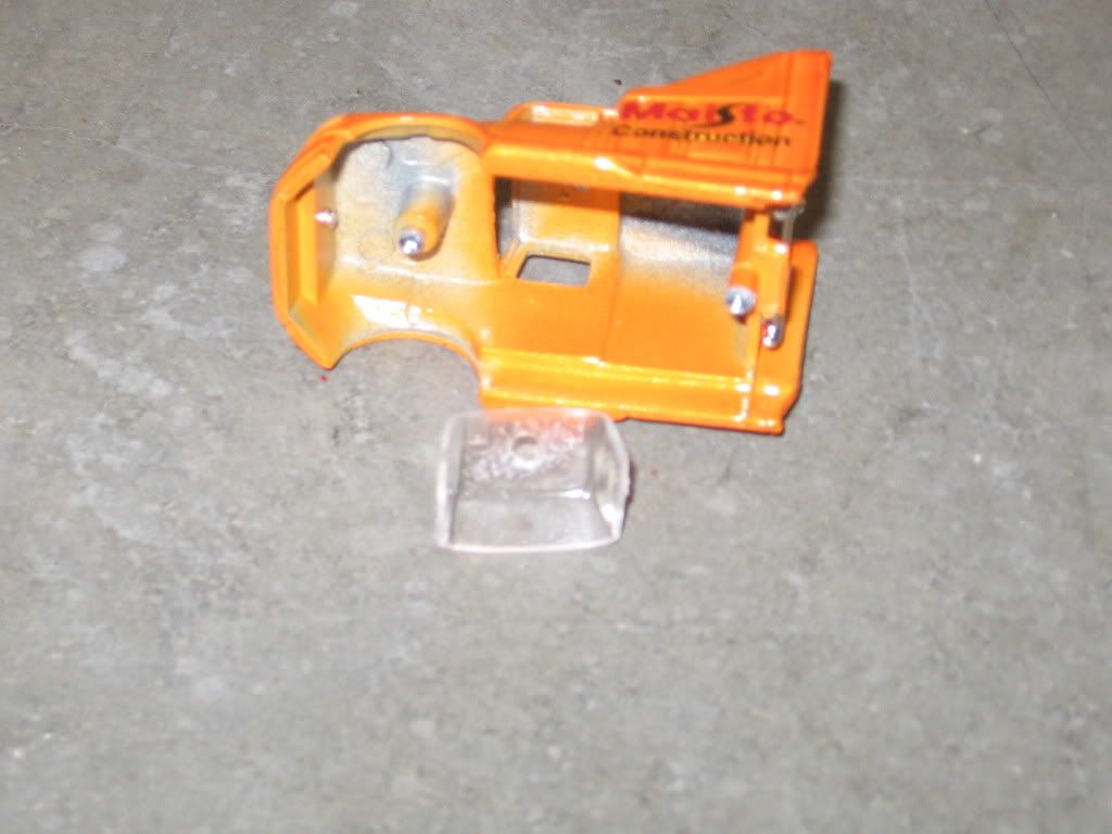

FInally- some results. good news and bad news. bad news: three words. MOLD. RELEASE. AGENT good news: the mold worked! It couldn't have gone better. It was amazing to pour in a liquid and then 90 seconds later remove a solid! The mold material is actually called Make-A-Mold, an alginate impression material. It picked up every little detail. Plus, it only cost six dollars with a 40% off coupon from hobby lobby. It also came with a little bag of plaster that you can use to practice with. First of all, I had to disassemble my truck cab, by drilling out two rivets and unscrewing two screws:

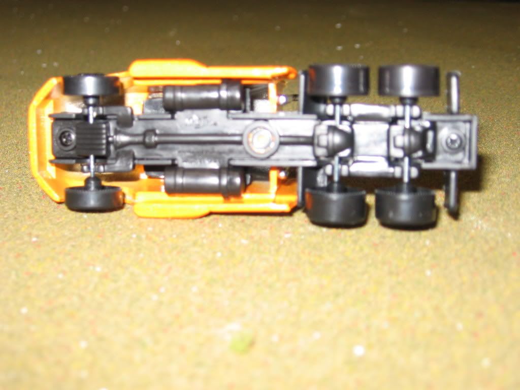

after one rivet and two screws:
I used a 1/8" drill bit for the rivets.
After two rivets and the screws:
I decided to take the windshield off too (just another 1/8" rivet):
I left the smokestacks on, since they were so tiny and would have been hard to mold by themselves.

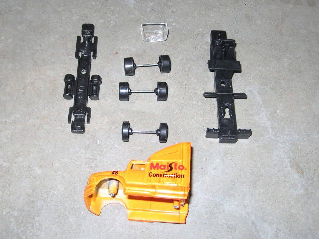

All of the pieces disassembled:

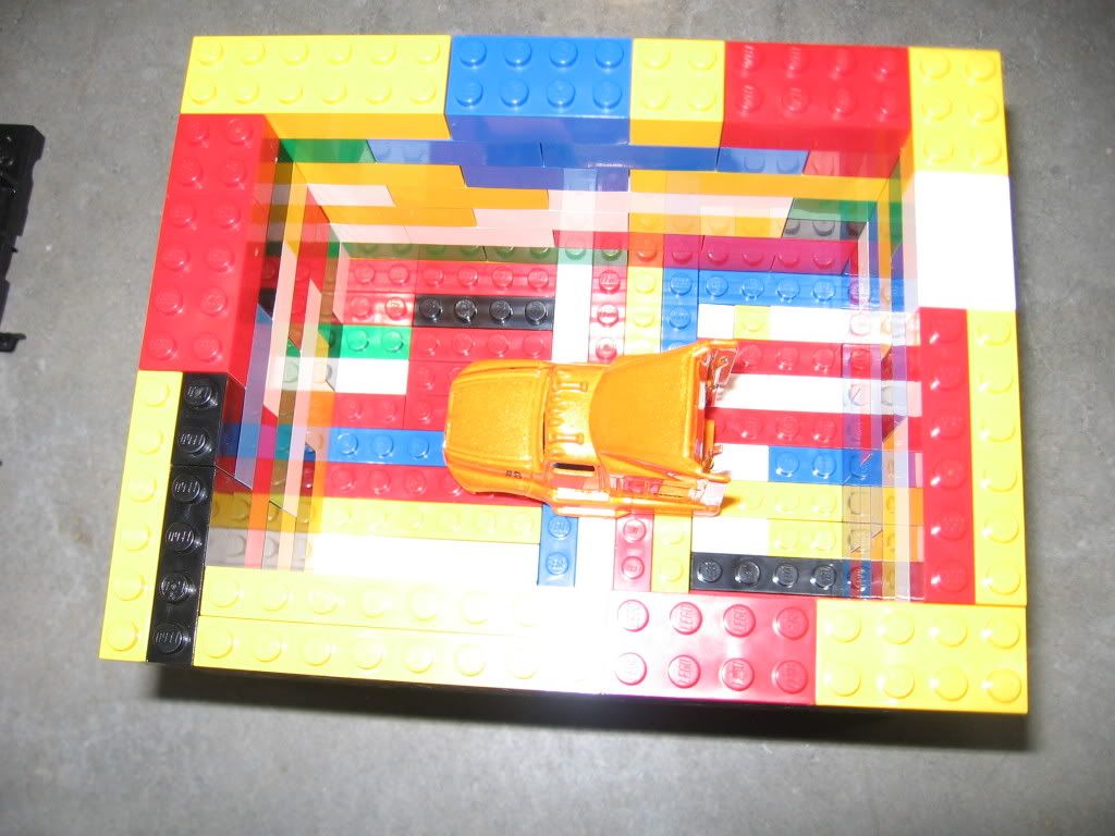

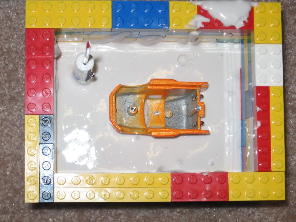

Heres my mold box I made out of legos, just like the website said to:

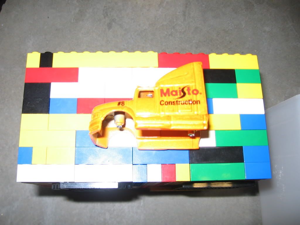

I mixed the first bag of Make-A-Mold, and mixed and poured it as fast as I could (it sets in 2.5 minutes) and stuck my cab and a screwdriver handle in (to make it easier to align the mold),
and in 90 seconds I pulled out my cab to reveal a perfect mold half.

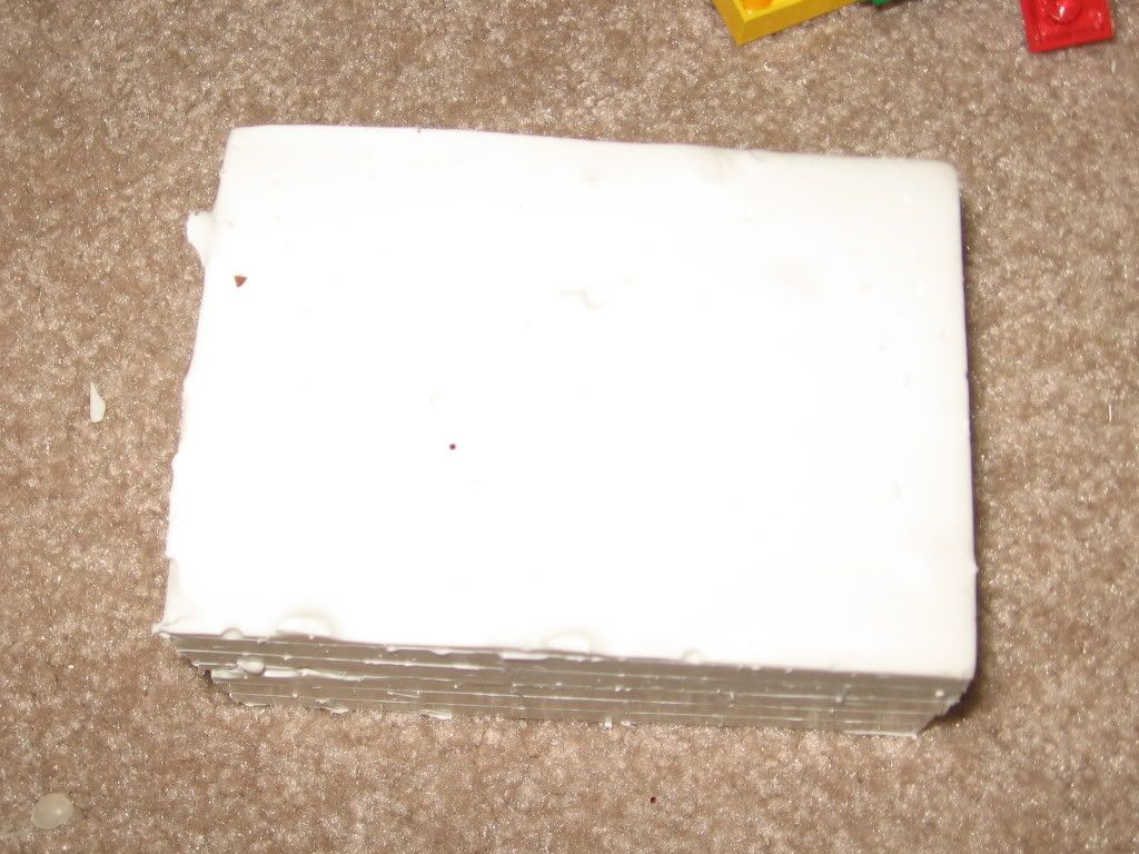

I replaced the cab, poured the second half, and removed the mold:
The lego pieces have little letters on each bump,and the detail in the mold was so extreme you could cleary read the word lego on the mold material (although it was backwards)

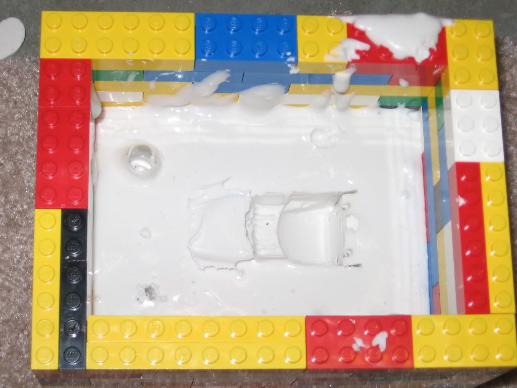

Now back to the bad news. I drilled a hole in the top of the mold to pour the plaster into, I mixed and poured it, set it on top of the dryer so it would vibrate, and 15 minutes later I pulled apart the mold and . . . the plaster was stuck to the mold. I guess I did need mold release stuff after all. I tried to force it out, but that only ripped the mold. So I'm going to try to make another mold, and this time ill usee mold release agent.

Plaster isn't a good material choice for a thin part like this anyway. It doesn't have much tensile strength. Go with resin for casting parts.
