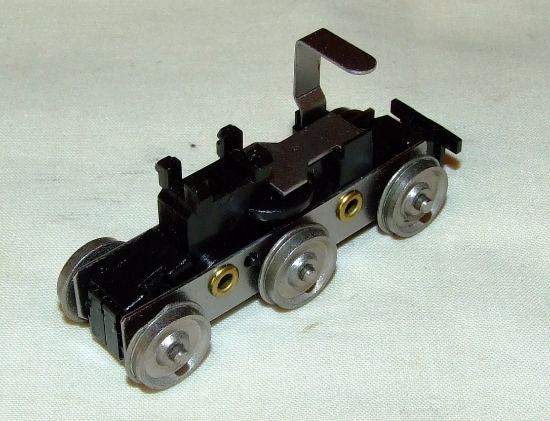

i have an athearn powered dash 9,which needs a new axle and wheels,as one is squared?,as i do not replace wheels often are all power truck wheels by athearn same size ken
having had a good look at the power trucks,the cogs are very worn i think due to running without lubing,but that wheel looks unrun ken
looking for 2 power trucks for dash 9
Edited by - catfordken on February 21 2009 10:36:53 AM
 Posted - February 21 2009 :  12:19:43 PM Link directly to this reply  Show Profile  Add shaygetz to Buddylist
Yes, they should all be the same size, I have a two axle truck with that same configuration you're welcome to cannibalize.
Ray Marinaccio
RayAvatar
 Posted - February 21 2009 :  12:22:34 PM Link directly to this reply  Show Profile  Add Ray Marinaccio to Buddylist
Part #40019 is the wheelset for the Dash 9.
Ray
 Posted - February 21 2009 :  1:23:49 PM Link directly to this reply  Show Profile  Add NickelPlate759 to Buddylist
Looks like you need a replacement wheel too, Ken. The one in the foreground has a broken flange.
Edit: Just saw that you mentioned it, Ken. I was thinking gears only.
Edited by - NickelPlate759 on February 21 2009 2:13:36 PM
choochin3
 Posted - February 21 2009 :  10:16:47 PM Link directly to this reply  Show Profile  Add choochin3 to Buddylist
I had the same problem with an Athearn dash-9.
Chipped flanges on three wheels.
I replaced them with some Athearn wheel I had laying around.
Just take the sideframes,and the plastic bottom plate off the truck,and then just swap 'em out.
