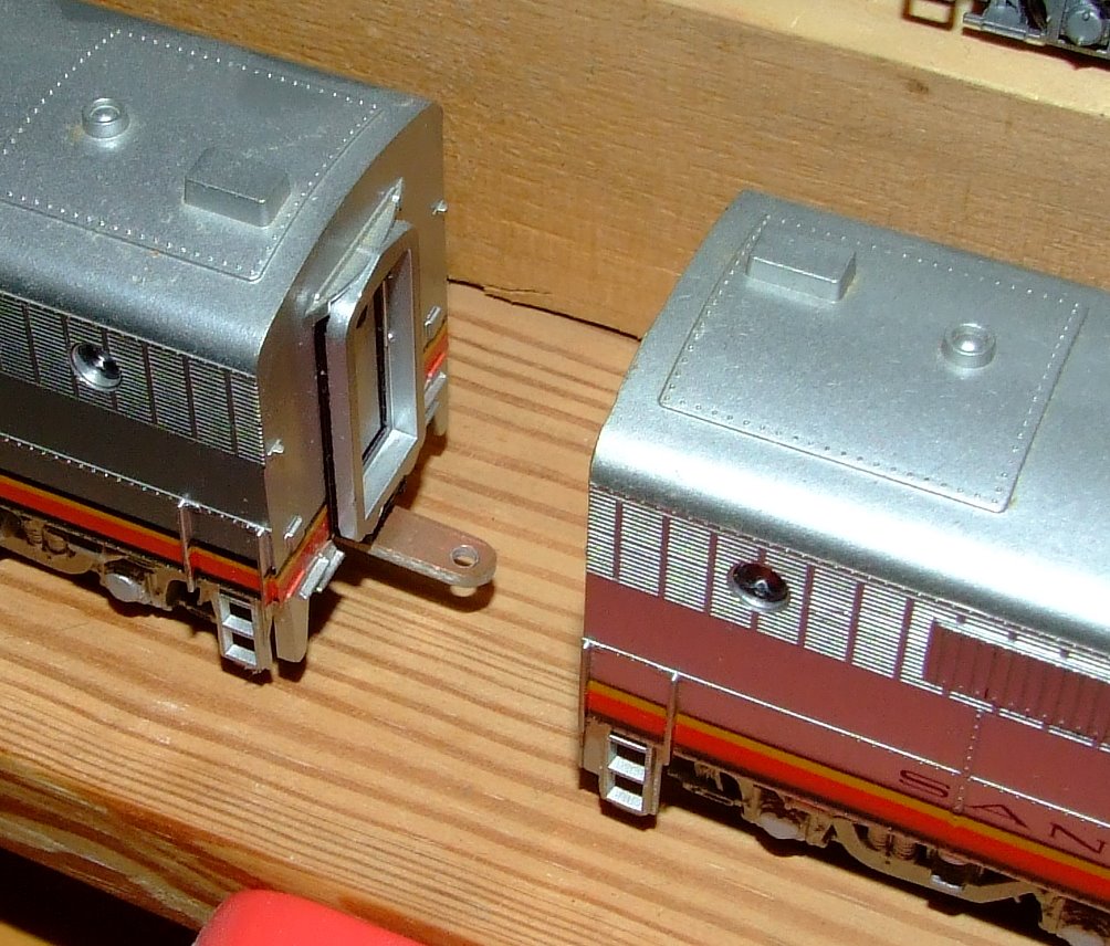

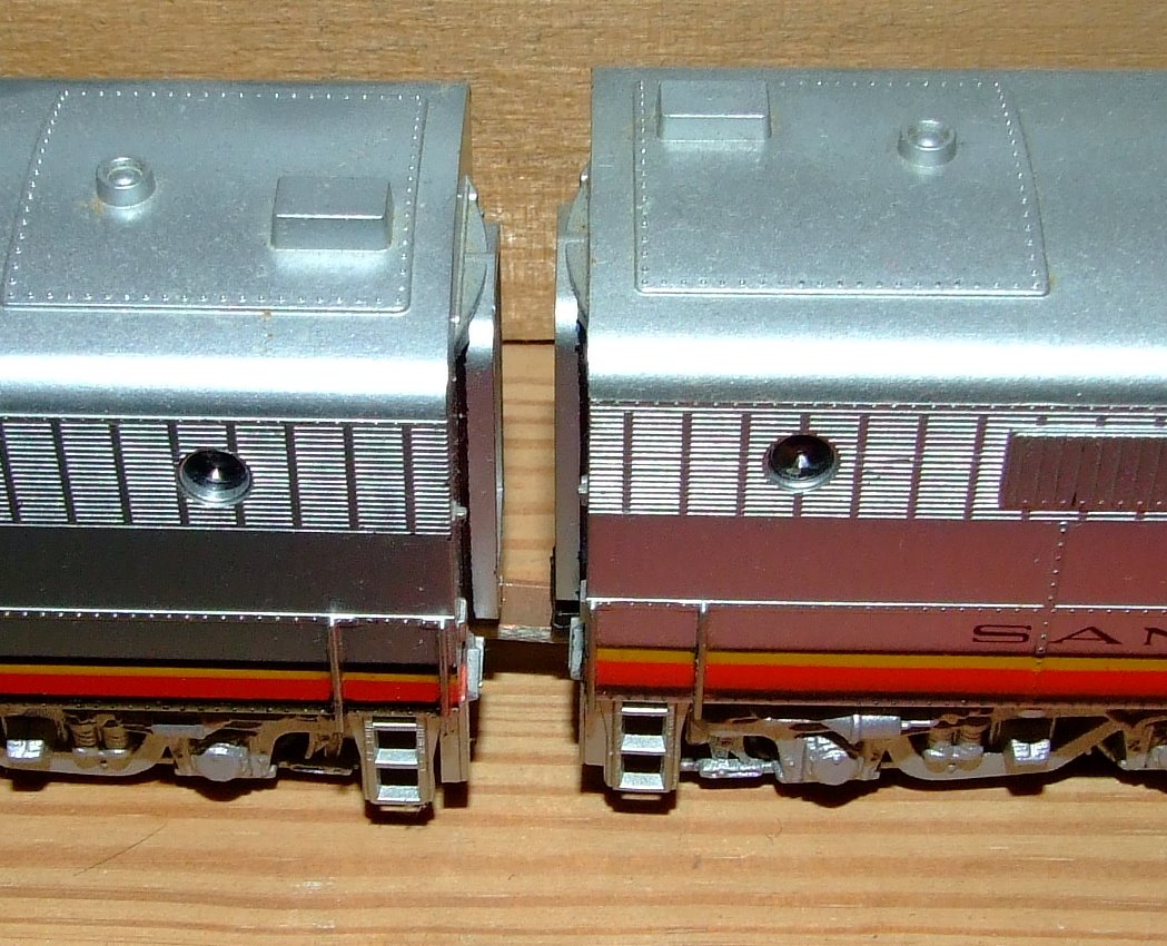

Hi Ray , Hi FosterG
Here is the result of Rays sugestion, i dont think you can put them closer together!
I was using an IHC coupler. many greetings - Erich

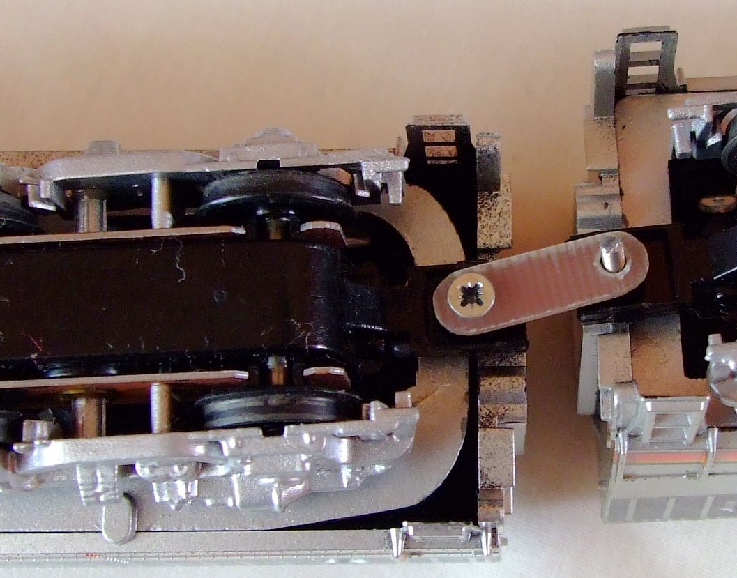

 Posted - January 17 2009 :  1:22:06 PM Link directly to this reply  Show Profile  Send catfordken a Yahoo! Message  Add catfordken to Buddylist
i did this to a pa1/pb1 set up and works very well am sure it would work on anything else ken
one screw going up and glued to stop coming loose.and one coming down but left long to slip into drawbar

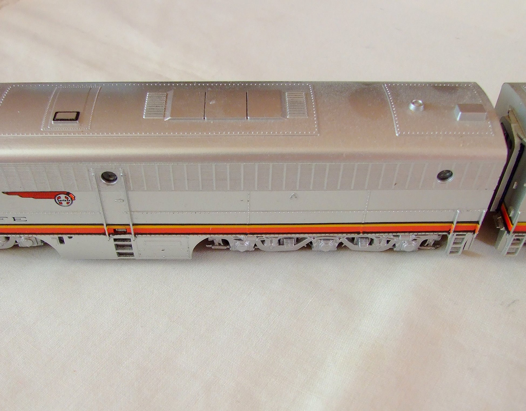

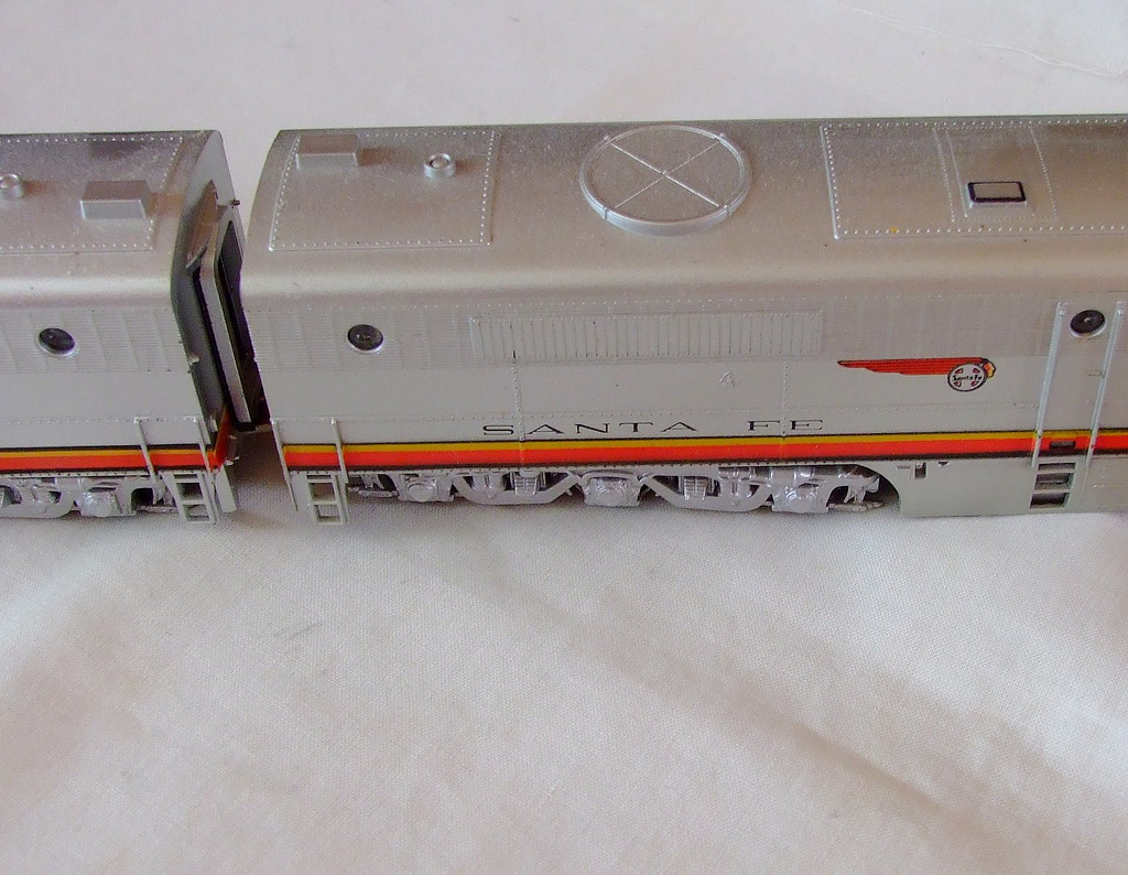

On a SF Warbonet Unit the Indian looks to the front. You can take this as a reference for other roadnames. - Erich
 Posted - January 18 2009 :  07:42:58 AM Link directly to this reply  Show Profile  Send catfordken a Yahoo! Message  Add catfordken to Buddylist
on a-b-b-a setup,the indian on b unit faces its a partner a unit,so you end up with 1 indian facing left and 1 facing right as per erichs photo
