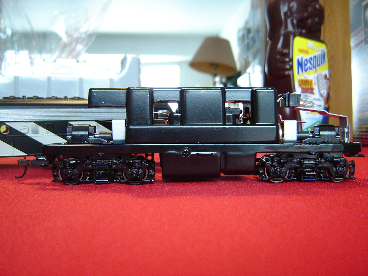

BTW, have you guys ever seen one of these monsters? It has a massive weight encasing the motor!
 Posted - January 04 2009 :  3:26:10 PM Link directly to this reply  Show Profile  Send catfordken a Yahoo! Message  Add catfordken to Buddylist
hi cheez the weight has been around a long time but one with a painted finish like that is a new one,i have three f7 chassis like that with the older motors as spares ken
 Posted - January 04 2009 :  3:49:40 PM Link directly to this reply  Show Profile  Add GoingInCirclez to Buddylist
The Athearn drive hasn't really changed much at all since the 70's. So if you've taken one of those older ones apart, the new ones (using the classic tooling) are very much the same.
Given the additional symptoms described, I'd say the truck gears are the problem. Clicking is a classic sign of a split gear. Confirm this then request a replacement. Or heck, your idea might get you an entire spare truck out of the deal... But the funny thing is you could use a 70's gear as a meantime replacement.
That beefy weight used to be an option! Athearn formerly sold a "Super Power" F7/9 and the sole difference was the presence of that weight.

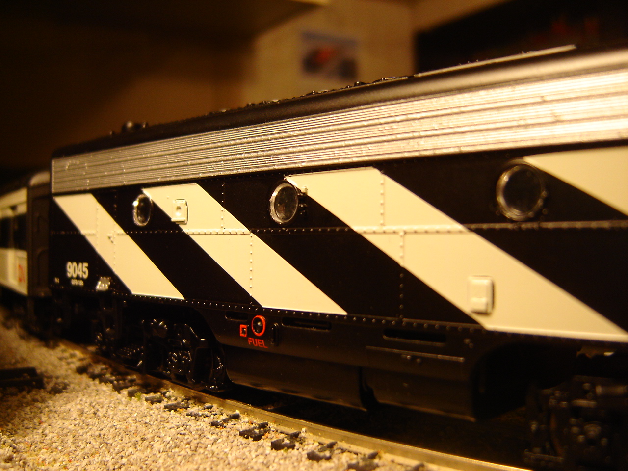

Taking it to the hobby shop wasn't a total waste of time though. I swapped the B-unit and the shell on the A-unit. (I know...weird right...exchange everything except what I went there for.) The first A-unit had some ugly paint flaws and the silver strip on the B-unit was very rough. The new B-unit is a little better, but not great. (All the B-units looked like this BTW).
