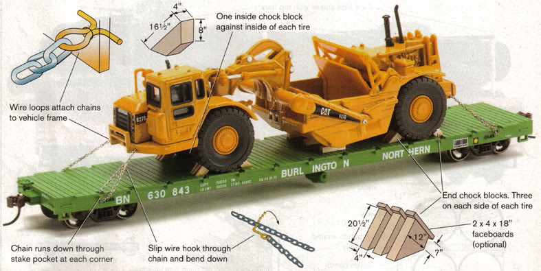

I got the idea for my project from a June 2005 Model Railroader magazine article. The article is Chains, Chocks, and Shackles: Realistic Loads for Your Flatcars and Gondolas by Jim Hediger.
Here's the model from that article that I'm using as my suggestion...

 Posted - November 20 2006 :  11:42:26 AM Link directly to this reply  Show Profile  Add Tony Cook to Buddylist
This weekend I picked up the A-Line brass chain (#29220); Midwest Micro-Cut Scale Lumber (#8002 and #8024), plus some brass wire from Detail Associates (#2503) to make loops to hold the A-Line chains. I hope to put together a very well detailed Flat with Cat.

Got one of my Flat Cars with Loads done today.
Decided against the Wabash Flat Car for the Cat and went with a Santa Fe. The Flat Car is the lowest of low Bachmann standard line, non-Silver Series, that I picked up recently for $5.99.
Is it legal to put a die-cast $20 Norscot Cat on top of a $5 Bachmann Flat Car???
Anyway, I cut the wood strips and made the blocks for the wheels. That's A-Line's brass chain holding the front and rear of the Cat. The Cat is glued in place with CA cement. In fact, all the detail work is done with CA. The Cat is clean and new, but the Flat Car got a weathering with those weather chalks. The Flat Car required a spray of flat finish before the chalks would stick to it.
The plastic friction-style wheels supplied with the Flat have been swapped out with Bachmann Silver Series roller bearings. And Kadee Whisker scale knuckles are in place of the Bachmann EZ-Mate knuckles.
The Bachmann Flat Car was fairly light, so the heavy die-cast Norscot Cat was a good match.
