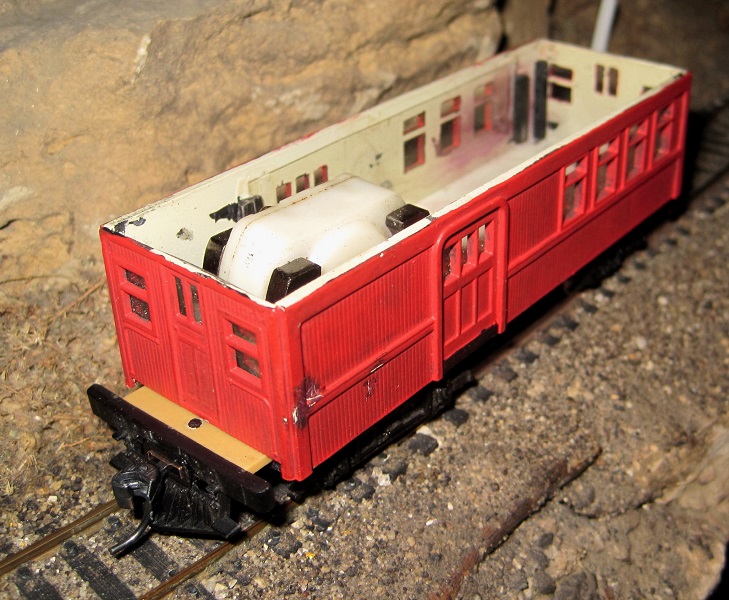

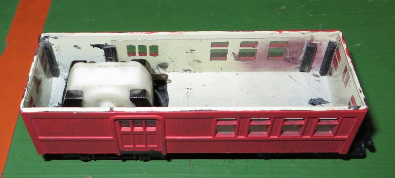

For some time, now, I've been wanting to build a doodlebug. It's not so much that it's important to the operation of my layout. I just wanted to build one.

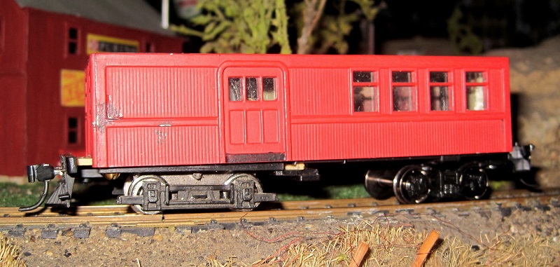

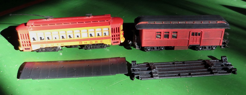

My starting point was a Bachmann street car and an MDC shorty combine.

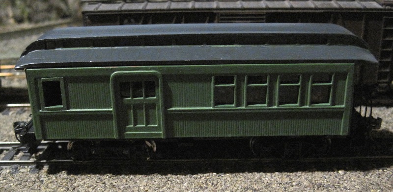

Originally I planned an arched roof, but later decided on a clerestory roof, so the extra roof wasn't used.
I had an extra underframe, so I left the one from the combine car intact, in case I wanted an assembled one in the future.
I used the power truck and its mount from the street car, and the body of the combine.
I also had a pilot from a Mantua Pacific (minus the steps and air pumps) around and used that on the doodlebug.

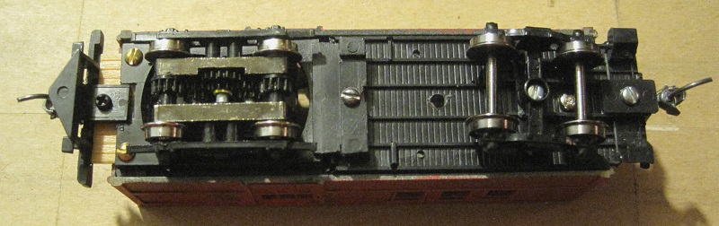

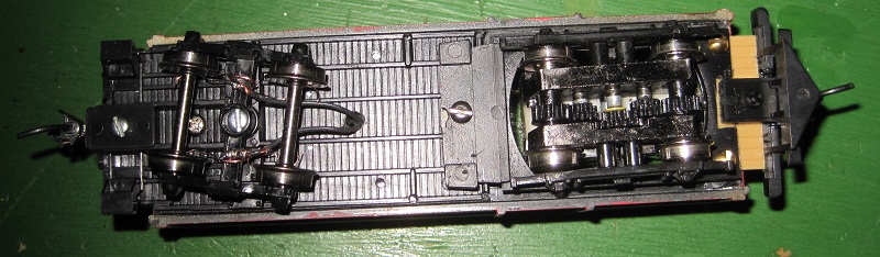

I used the rear half of the MDC underframe and an archbar truck for the rear wheels, platform and coupler pocket.

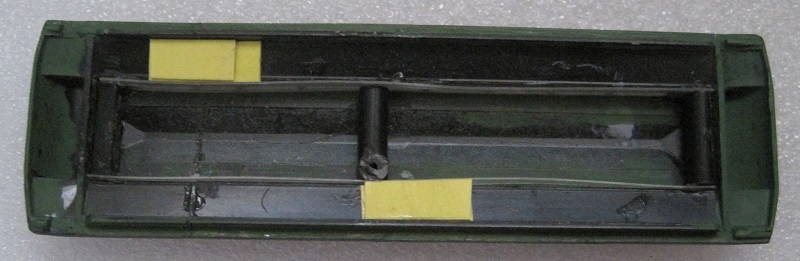

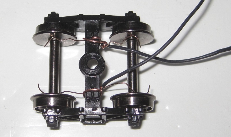

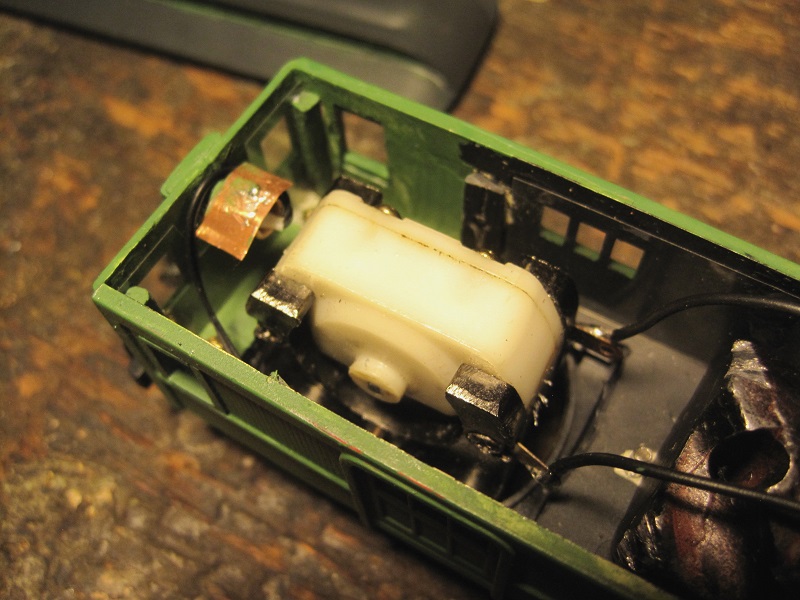

For more electrical pickup, I made wheel wipers by soldering a copper mounting wire and some flexible insulated wire to some .010" phosphor bronze wire. The end of the copper wire is wrapped around the flexible wire's insulation to keep the wire from bending and fraying at the solder joint.
I drilled holes in the truck bolster and inserted the copper wire then wrapped it around the bolster to secure it. The bronze wire is bent to touch the wheel backs.

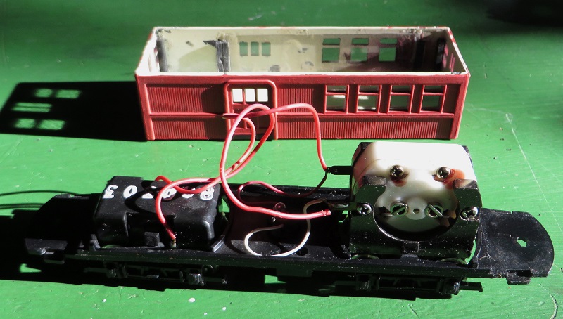

Here's the rear truck mounted on the car.

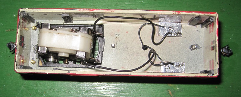

This shows the connections between the rear and front truck inside the car.

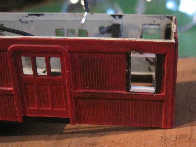

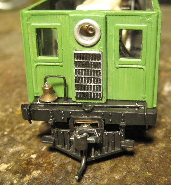

Side windows are cut in the front and then framed for the moterman's cab.
The holes were drilled and then carved rectangular with a hobby knife.

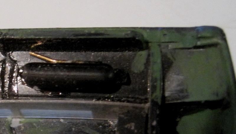

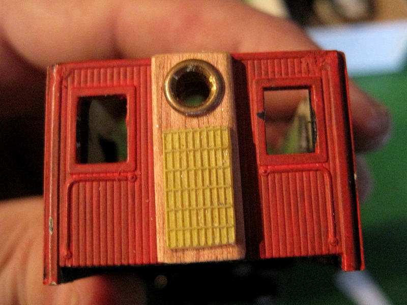

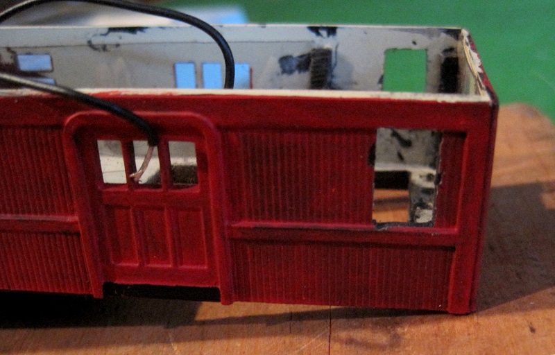

The headlight will get hot, so I used an old hollow brass rivet for it and mounted that on wood to protect the plastic car body. The yellow grill is a piece of roof walk from a scrapped out covered hopper. It'll represent the radiator. The wood part is epoxied to the plastic body.
I soldered on a piece of copper for a heat sink and then inserted the light bulb.

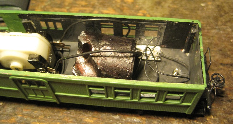

Here the light bulb leads are connected and a weight is added. The inside is painted black so it's harder to see in the windows.

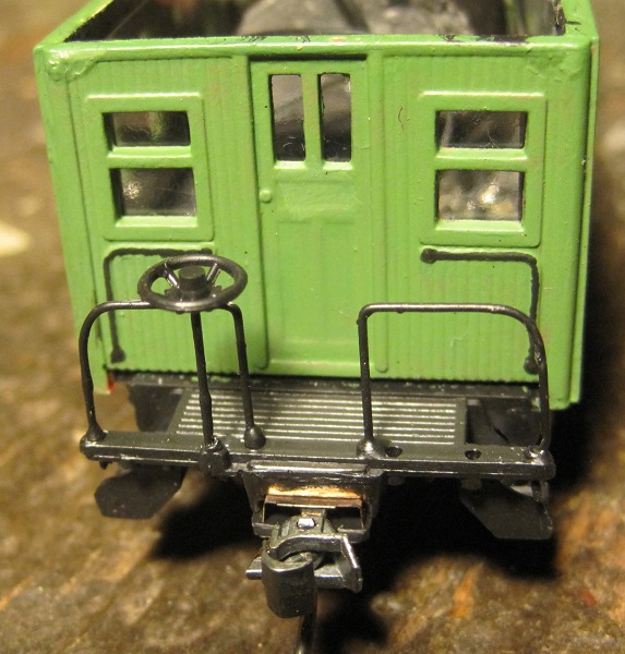

Wire railings and a brake wheel are added to the rear platform.
Here's the front again. An uncoupling lever and an air operated bell are added to the pilot. The bell is an old Mantua bell with a hole drilled in the top and a wire added to represent the air pipe. This sort of bell is mounted rigid and the air only moves the clapper.
A couple of tanks hide the general lack of underbody detail.
The clerestory roof was shortened up a bit to reduce the overhang in front where there's no end platform.

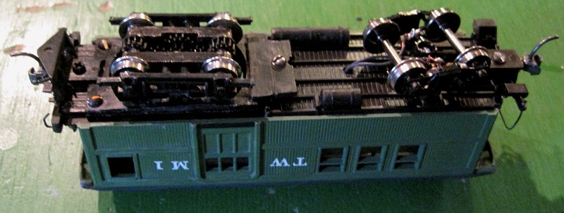

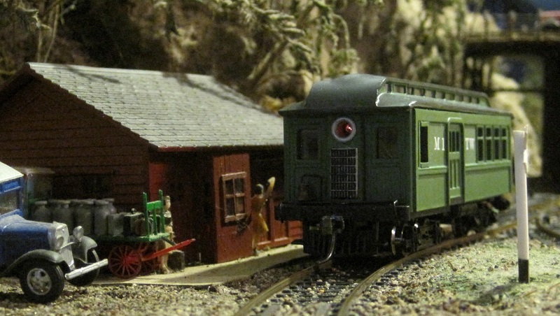

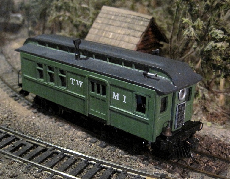

The car is lettered TW for the Tabor and Waldo and numbered M1.
In the early days of doodlebugs and other self-propelled cars, numbers were prefixed with an M for motor.

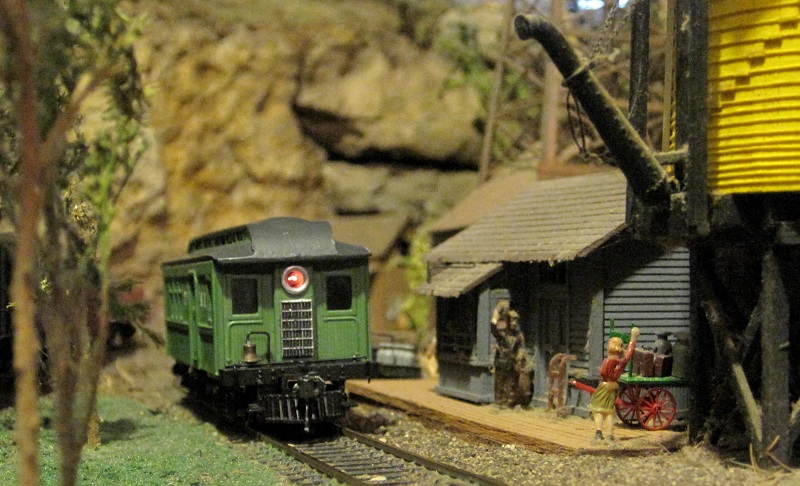

Doodlebug M1 makes a stop at Tabor depot.

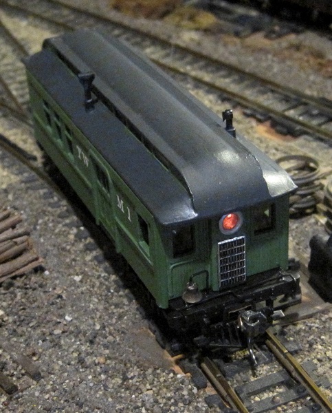

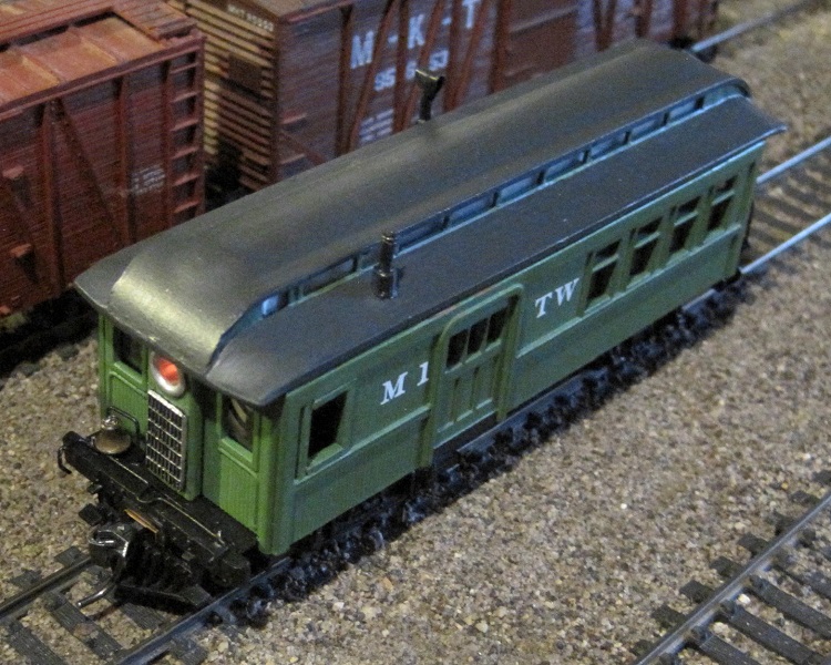

One little suggestion, add some exhaust stacks on the roof.
Originally posted by Srenchin - January 10 2018 :  9:46:44 PM

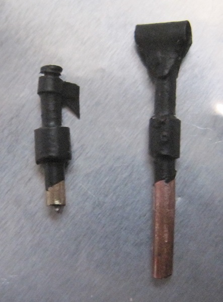

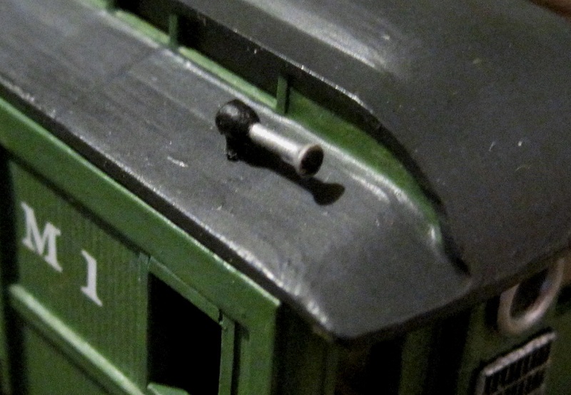

Contemplating that featureless roof, I think you're right. I looked at pictures of how various doodlebugs handle exhaust. Most just had straight stacks out the roof. These would need tin cans over them when not in use to keep out the rain.
Strasburg's doodlebug has a single exhaust pipe with one of those flappy covers on it like they put on tractor exhaust pipes. It has a tar paper roof, so people traipsing up there to put a can on the exhaust would not be good. This is pretty similar to what I have going with the clerestory roof on mine, so I chose to follow their lead. Theirs also comes out the middle of a sort of roof vent in the center of the clerestory. I didn't think this vent was strictly necessary for mine, because my clerestory still has windows. I'll run the exhaust out a pipe with a double walled flue, instead. Aesthetically, I think it would also look better alongside the clerestory than on top, and so it shall be.
Another feature of Strasburg's doodlebug is a smoke jack from a coal stove. Apparently, the heater core from the engine is not enough. I plan to follow their lead with the stove.
This meant modeling an exhaust pipe with the flappy cover (I bet that has a real name, but I don't know what). I ended up using a small piece of brass tube for the pipe, and a pin head for the round cover. The pivot and mounting strap are thin copper soldered around the tube. The wider part that protects the roof from the hot exhaust pipe is the hollow plastic shaft of an ear swab.
The smoke jack models the type where the rain cover is just a piece of sheet metal bent above the end of the stove pipe. The stove pipe is copper wire. The rain cover is thin copper soldered to the end. The wider double walled flue is part of the ink tube from a used-up ball point pen.
This view shows how the smoke cover fits on the smoke jack:
The exhaust pipe and smoke jack will go in holes drilled in the roof. I've glued extra layers of plastic to the inside of the roof so a deeper hole will hold them straighter:
I'm now waiting for some paint and glue to dry before final assembly.
 Posted - January 12 2018 :  4:14:27 PM Link directly to this reply  Show Profile  Add scsshaggy to Buddylist
Glue and paint are dry and things are assembled. Here's the end result:
The roof does look a little less plain.

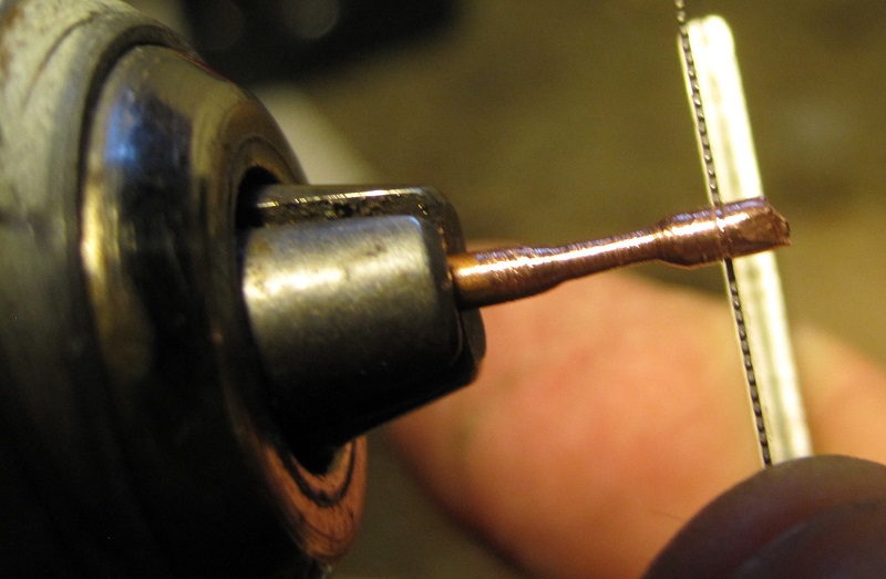

 Posted - January 22 2018 :  5:11:37 PM Link directly to this reply  Show Profile  Add scsshaggy to Buddylist
Shakespeare notwithstanding there are those who think sound and fury do signify something. For their comfort and edification, motorcar M1 now has an air horn:

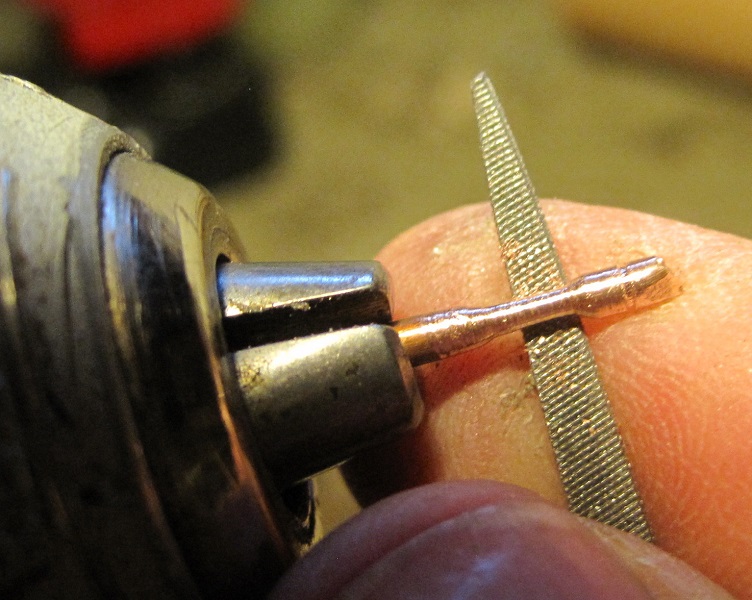

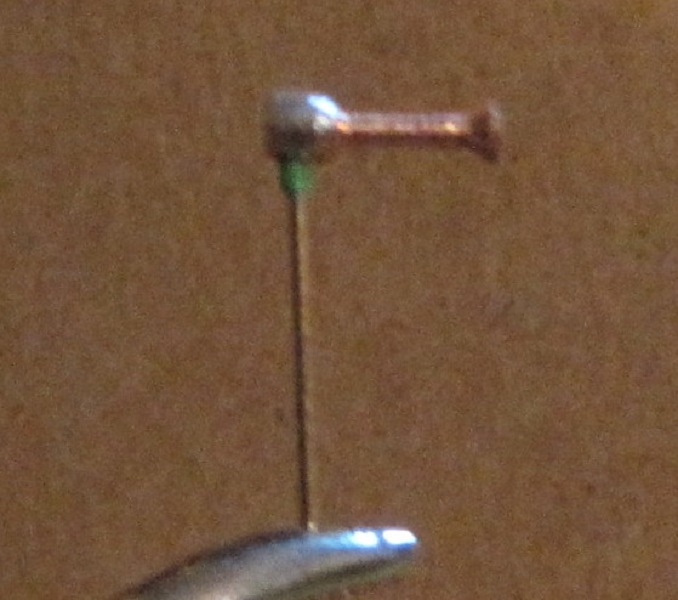

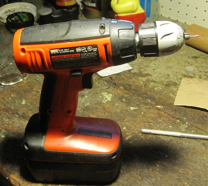

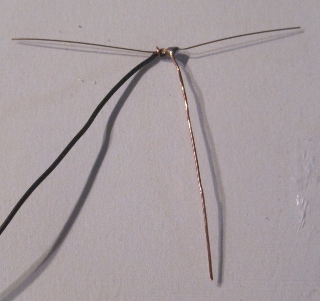

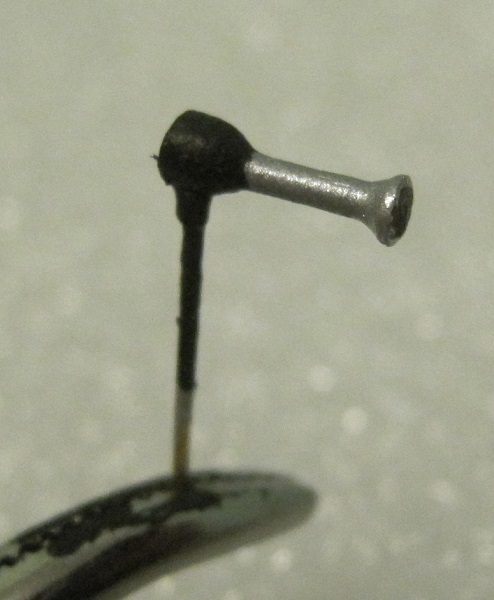

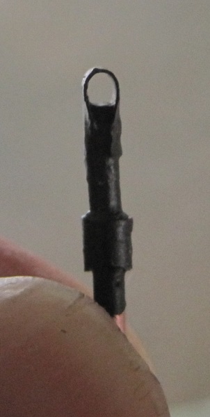

I wasn't at all sure this would work, but I thought I'd give it a try. To get an air horn for doodlebug M1, I decided to turn one from a piece of heavy copper wire. I chucked a piece of wire in a drill:
As the wire turned, I filed it into as close to a horn shape as I could manage:
I held a razor saw to the wire to cut some excess off of the ends:

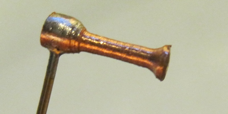

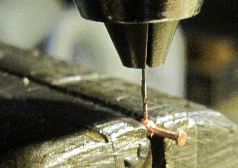

To mount the horn and to represent the air line to the horn, I drilled a .020" hole and soldered in a wire:
I added a collar of insulation from phone wire to space the horn above its mounting surface:
Here's the horn, finished and painted:
The mounting wire is threaded through a hole in the roof and bent to brace itself between parts of the roof and a piece of sprue glued in alongside it.

Check out this little doodlebug running in this video!
Edited by - Srenchin on August 09 2019 9:38:15 PM
 Country: USA  ~  Posts: 821  ~  Member Since: December 26 2009  ~  Last Visit: August 23 2026 Alert Moderator  Go To Top Of Page
 Posted - August 10 2019 :  10:02:59 AM Link directly to this reply  Show Profile  Add Chops124 to Buddylist
Glad to see this thread up again; it would do John Allen proud.
A lot of fun seeing this remarkable kitbash swim effortlessly from point to point
and over the landscape on its daily rounds. Favorite scene is it pausing at the
little red depot across from the Ford pick up dutifuly paused, that and the trestle
crossings, where it assumes the flight of a large bird. I'd reckon this to be one
the best videos of the year.
 Posted - August 10 2019 :  8:28:24 PM Link directly to this reply  Show Profile  Add scsshaggy to Buddylist
