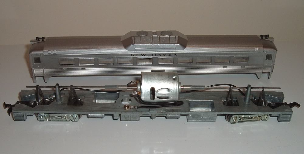

If you can take apart the Athearn Coors refer, sand smooth the body ends, removing the paint completely. The ends are covered by the roof/refer part... you may notice that the ends bow out. Any paint on the body ends will increase the bowing.
Trim around where the ends/ coupler mount/ chassis meet. The chassis coupler mount should fit snugly into the body clamp so the "end bottom tab" is slotted into the chassis.
Also trim around the roof-lock at the door location on the body and the roof.
The Booth-Kelly Logger has a knuckle at its pilot, while there is a "Magic-Mate" coupler at its rear.
The Magic Mate coupler will hook up to both knuckle and horn-hook couplers. Use a magnet to uncouple knuckle couplers fitted on freight cars.
Horn-hook equipped cars are not so hard to uncouple from these.

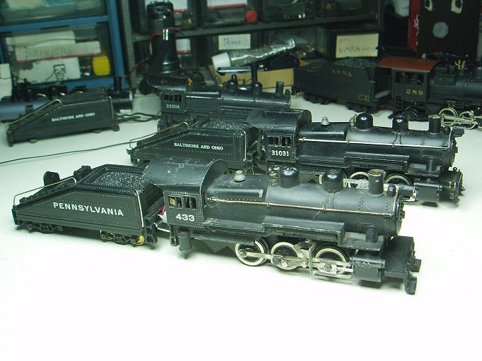

31031 and 433 are back on the road again.

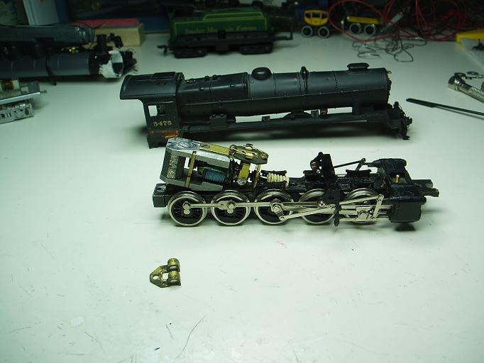

 Posted - December 16 2008 :  8:44:11 PM Link directly to this reply  Show Profile  Add NickelPlate759 to Buddylist
Frank,
How did you add the extra axle bearing to the back of the frame? Did you mill it out?

Nelson : I took the easy way out. The back end of the frame is already milled upward alowing for the thickness of the new axel. All I did was make a bracket of what I had laying around. The side rods are one piece, so I cut two set down from 4 axel tp 3 axel. Cuting away the one section that goes to the fourth axel. The side rods now join at the center axel where the gear is and main rod ties on. The side rods have a larger hole here to alow for the sleave that goes over the retiner bolt and spacer that goes between the main rods and side rods. Once I had all 5 axels together and droped into the frame it was easy to line up the bracket and drill the frame for the bracket retainer screw. Their is no binding in this drive. When placed on a track it rolls very freely.

Ray : It is just started. Big problum! Because of the valve gear I have to remove and raise boiler walkway. I haven't even started to even figure that one out yet. It may be easier to just replace it with something else.

 Posted - December 20 2008 :  3:42:03 PM Link directly to this reply  Show Profile  Add NickelPlate759 to Buddylist
Frank, I'd like to see a picture of the bearing you made. Did you use some scrap brass?

Nelson : The part I used was from a old street car and trolley drive. The axel bearing and retainer. I bent it a little to hold the axel tighter.

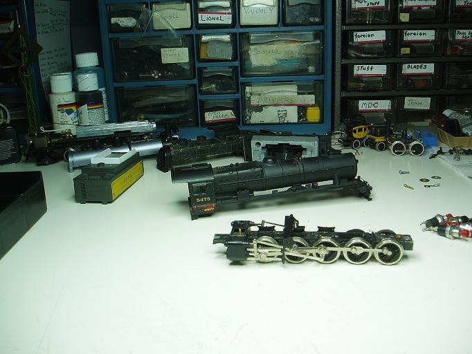

Here is the work bench to day showing the kit bashed decapod drive.

 Posted - December 23 2008 :  7:46:11 PM Link directly to this reply  Show Profile  Add NickelPlate759 to Buddylist
Good thinking, Frank. I wouldn't have thought of that myself. Have you run the chassis yet?

The drive runs just fine.

Here is the kitbashed decapod . It needs some dullcote.

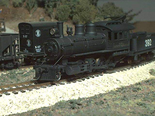

***** The Kitbashed Decapod *****
The boiler is of a British desige. The sand dome is from a Tyco 2-8-0. The pilot is from a Backmann PRR K4, as is the cab. The sand dome has been replaced with one cut out of a Tyco 2-8-0 boiler. The tender is a Backmann. It has been modified for tender pickup. Bowser axels and wipers are added, also my own style of quick connect for the transfer of power from the tender to the motor is added. The drive is a modified Tyco 2-8-0, the smoke unit and excentrick is removed and a Tyco 0-4-0 gear added. The motor is from standard tyco steamer. The bell is Athearn. The headlight is a Bowser/Selly. The boiler front is from a Model Power pacific.

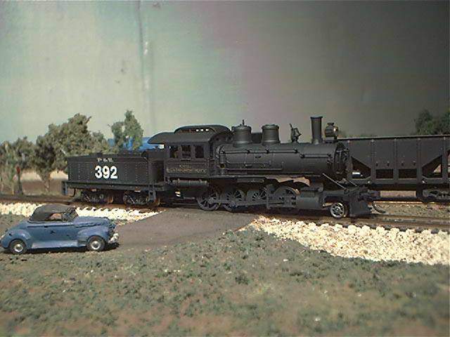

 Posted - January 21 2009 :  10:45:10 AM Link directly to this reply  Show Profile  Add Ray Marinaccio to Buddylist
Here's the kit-bash loco I have been working on.
Ray
martin67
 Posted - January 21 2009 :  10:49:30 AM Link directly to this reply  Show Profile  Add martin67 to Buddylist
Hi,
whats the "223" numbered engine in the background (behind the green decapod)? Looks rather european, like a Liliput Cl. 62.... Got some pix?
Martin
Edited by - martin67 on January 21 2009 10:50:22 AM
 Posted - January 21 2009 :  12:35:48 PM Link directly to this reply  Show Profile  Add toptrain to Buddylist
Locomotive 223, A liliput 4-6-4t
Attachment: CNJ 223b 008.jpg.JPG ( 31489bytes )
 Posted - January 21 2009 :  12:42:26 PM Link directly to this reply  Show Profile  Add toptrain to Buddylist
Ray : It looks great! lots of questions.
1- Is that a AHM Casey Jones body ?
2- The drive, what or who's? it looks like a Model power 2-8-0 or MDC. I'de favor MDC. pins and not screws or bolts hold on rods.
3- Does it run or is it a static model ? If MDC it runs.
4- The Tender if it runs, what or who's ?
Edited by - toptrain on January 21 2009 12:50:44 PM

 Posted - January 21 2009 :  6:38:39 PM Link directly to this reply  Show Profile  Add Ray Marinaccio to Buddylist
Originally posted by toptrain-January 21 2009: 12:42:26 PM
It is the AHM Casey Jones body with a little modification on a remotored MDC 2-8-0 chassis and an Aristocraft (New One) tender.
I runs realy nice.
Here's a link to some construction photos.
http://www.2guyzandsumtrains.com/Forums/viewtopic/t=5373.html
Ray
 Posted - January 21 2009 :  7:49:18 PM Link directly to this reply  Show Profile  Add toptrain to Buddylist
Ray : Congratulations you've done it again. more very good work. The body is a excelent length size for the drive The plate makeing up the floor-walkways was a excelent idea. It came out very well.
The tender looks like the tender for the 2-4-2 Columbia. It all goes together very well. Doesn't look kitbashed.
Edited by - toptrain on January 21 2009 8:02:22 PM
